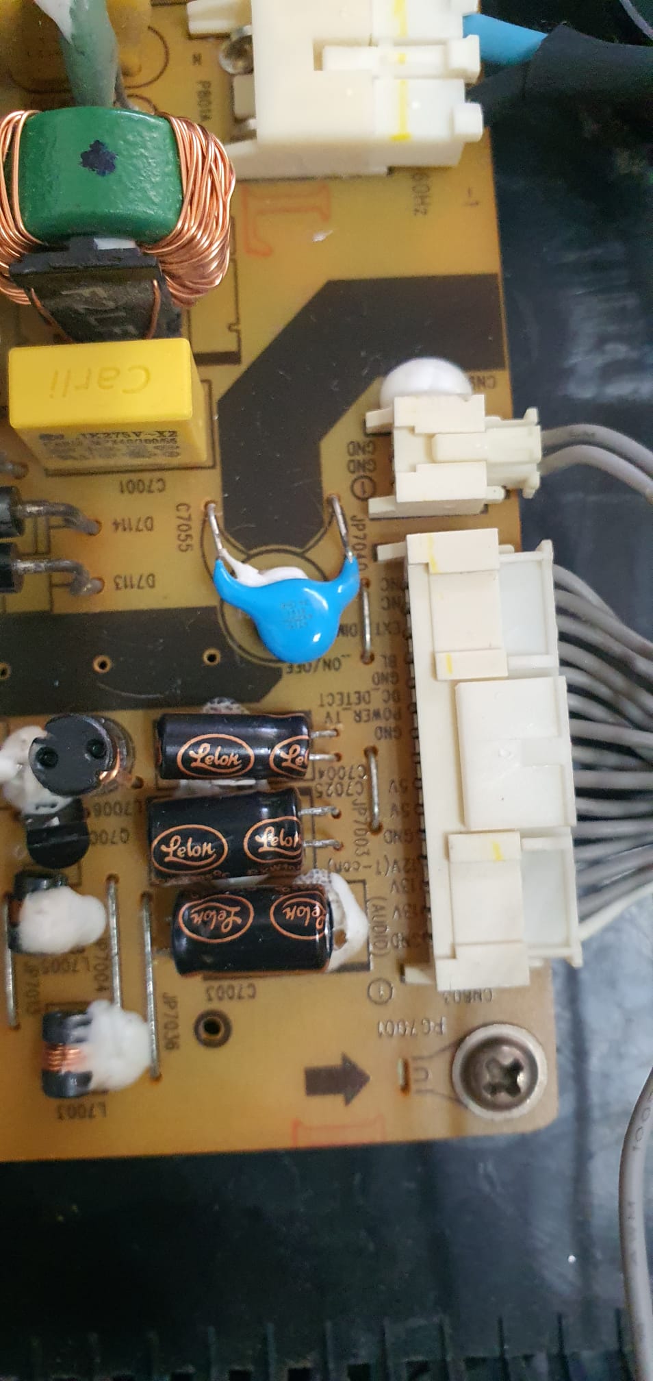

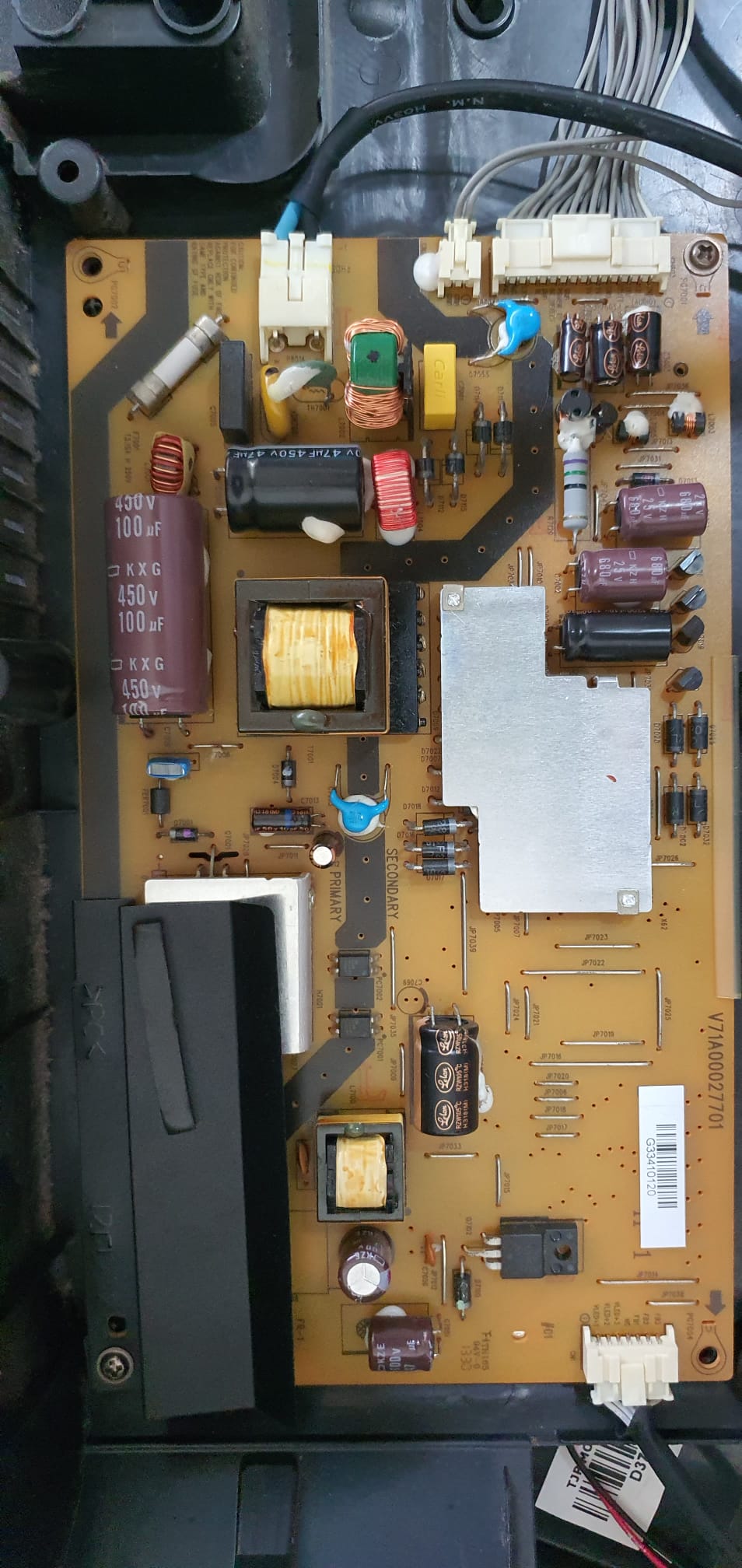

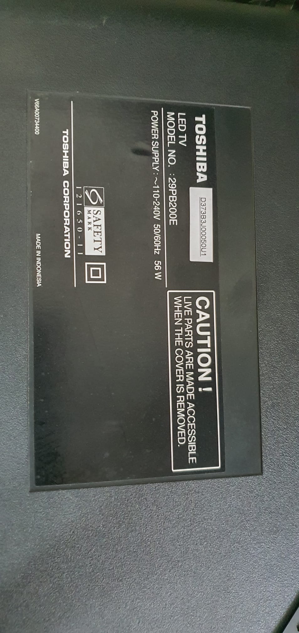

    Hi All
    I had a Toshiba LED TV which was not working.
    There were no screen or display / sound.
    This happen just as usual, turning on the television, and there were no screen display on it.
    Only Power LED.
    Remote control seems to be able to capture and process/
    Things I had checked.
    LED Strips is turning ON When startup.
    Voltage are not fluctuating.

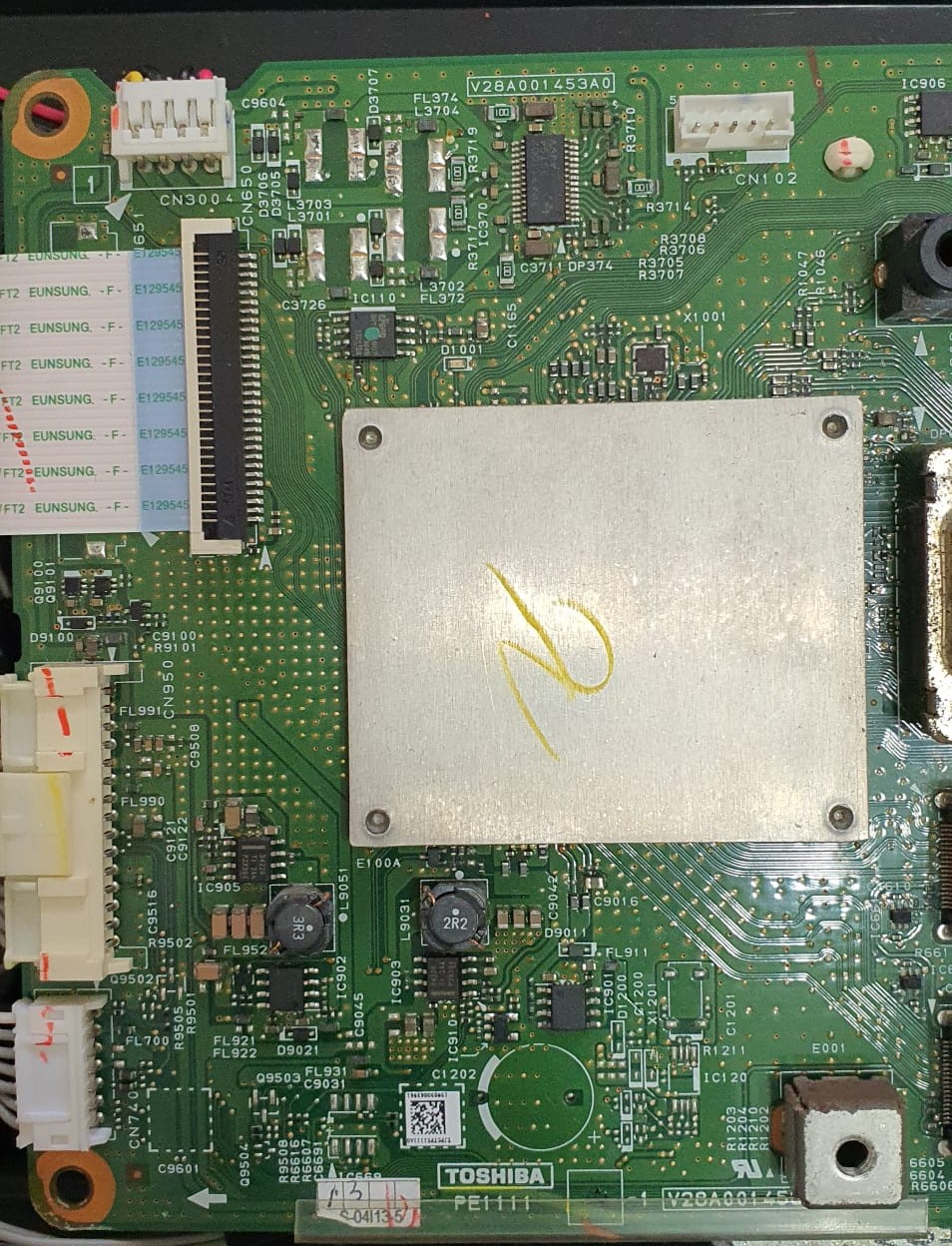

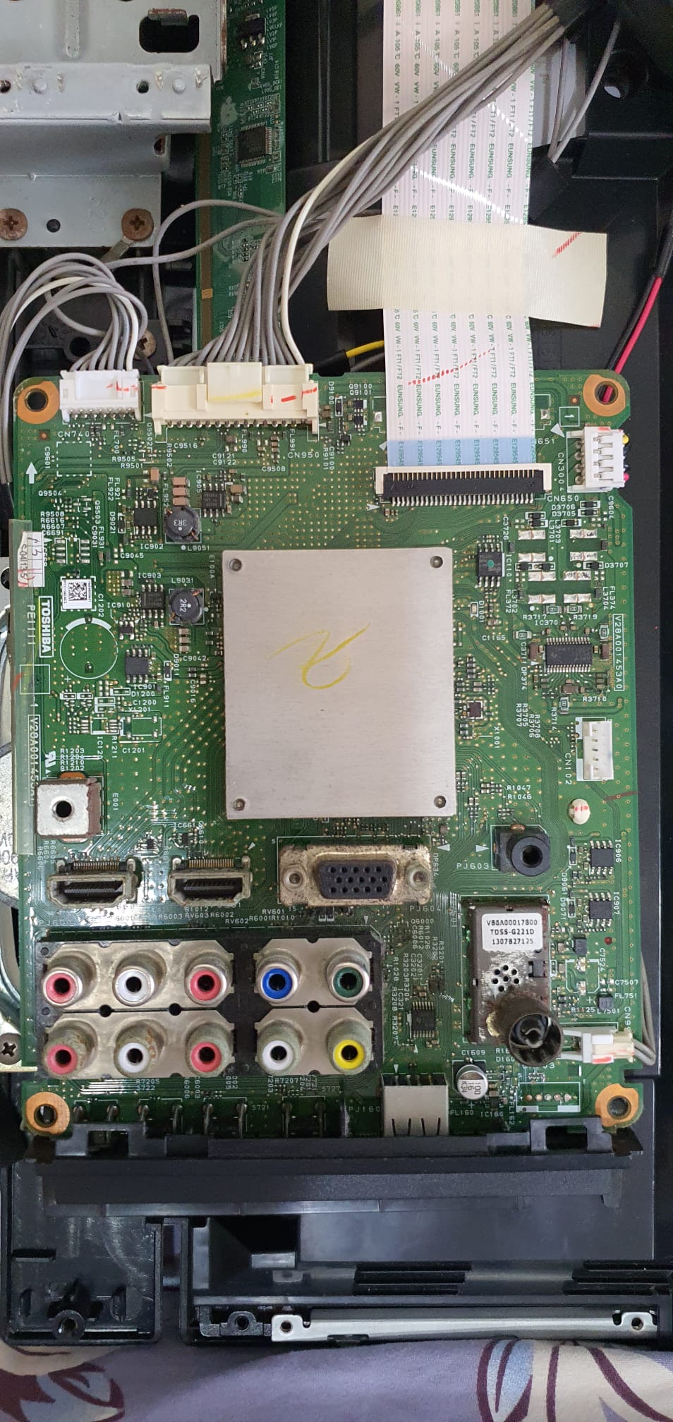

    Check on the board on the common diodes, no shorts.
    Disconnected T-Con connector from mainboard, but seems the board is not turning ON.
    Output Capacitor is still within the range of value
    Had checked on the powersupply output.
    13V and 12V (TCON) is missing.
    had disconnected the powersupply cable to mainboard, but there are no voltages still.
    Any guide or help is much appreciated.
    Thank You
  • dick_barton
    • Aug 2015
    • 6643
    • Wales
    Re: Toshiba 29PB200E LED TV - Black Screen
    Do you have the 5V supply?
