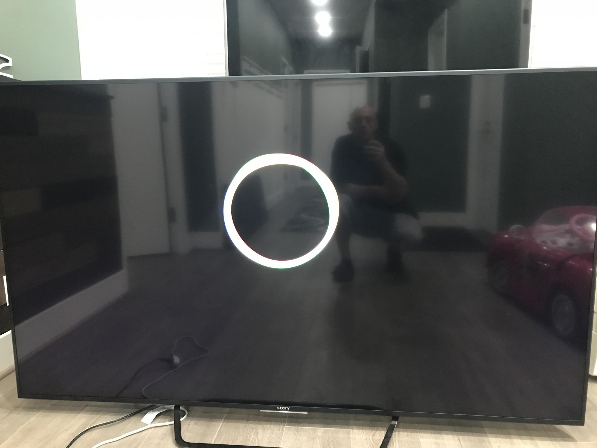

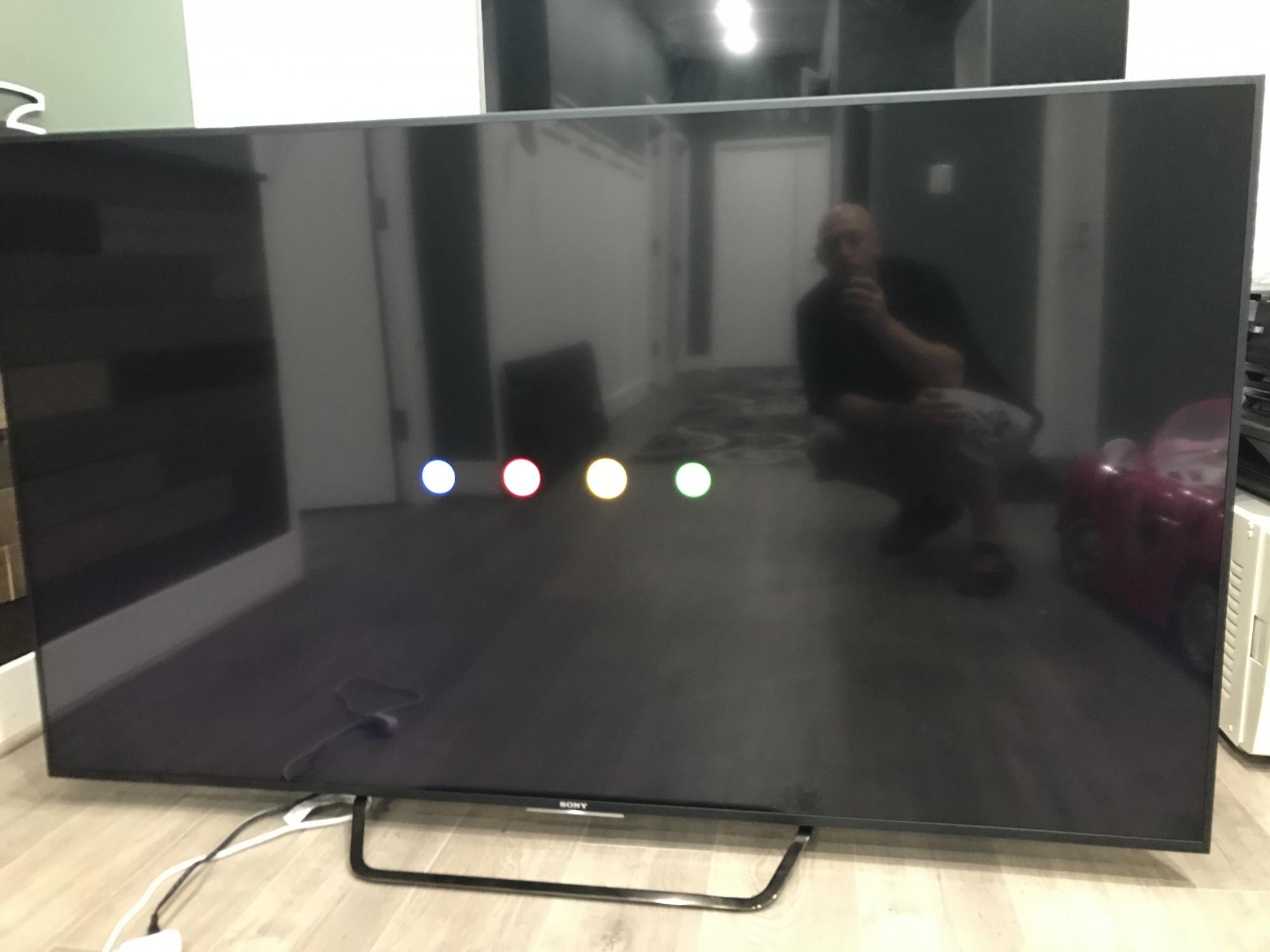

    Sony XBR-75X850C Mainboard EMMC memory chip
    Need a little help here. Story is the tv was dead. No power, No led, no backlight, nothing.
    Replaced EMMC from an eBay seller. Tv powered on and flashed amber/ green led. Updated firmware via usb. After 20min or so white light flashing and update appears to be done.
    However tv keeps rebooting (boot loop) as soon as the Android startup screen comes up. Tried hard reset holding down power and volume - button. Tv restarts and screen freezes on this circle image.
    Boot loop on these models is usually a sign the EMMC memory chip is bad or going bad.
    Did I miss something or this is a used chip maybe? Reprogrammed and reballed?
    Any help or suggestions would be appreciated.
