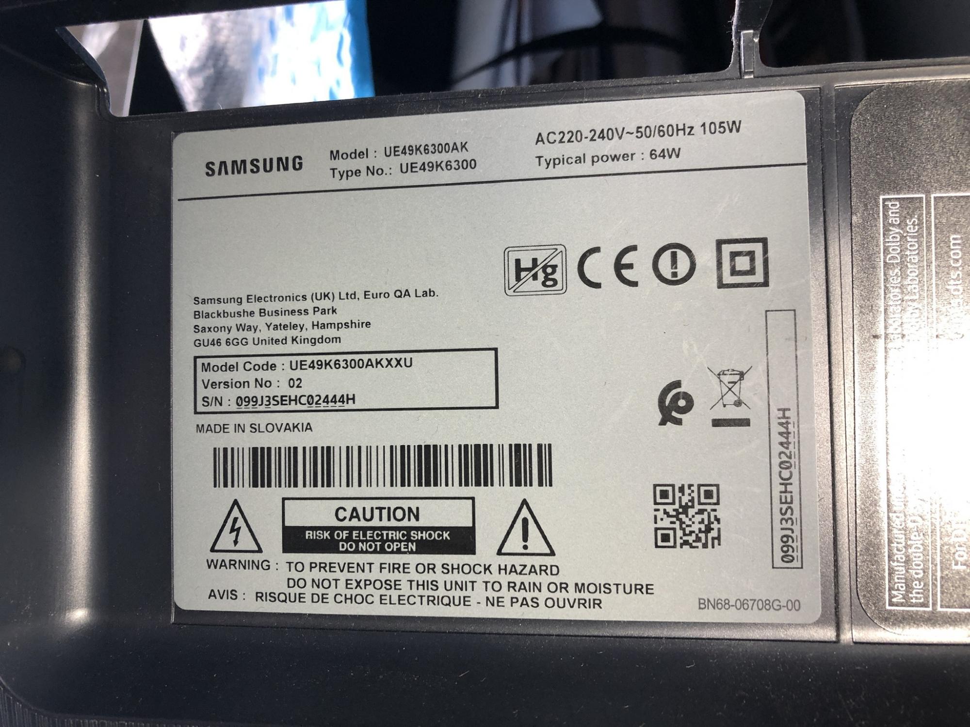

    Samsung TV - UE49K6300AK
    Hi People
    I have been given very cheaply an immaculate Samsung TV - UE49K6300AK.

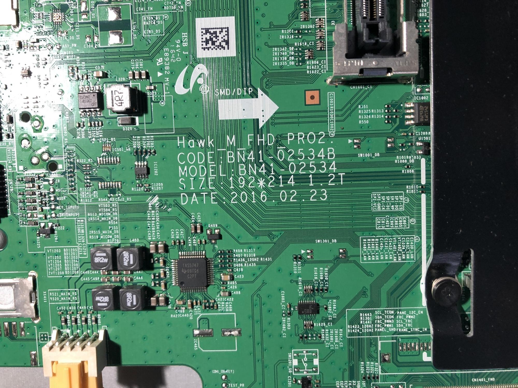

    The Main PCB is Info
    Hawk_M_FHD_PRO2
    Code: BN41-02534B
    MODEL: BN41-02534
    Date: 2016.02.23

    Photos of the PCB

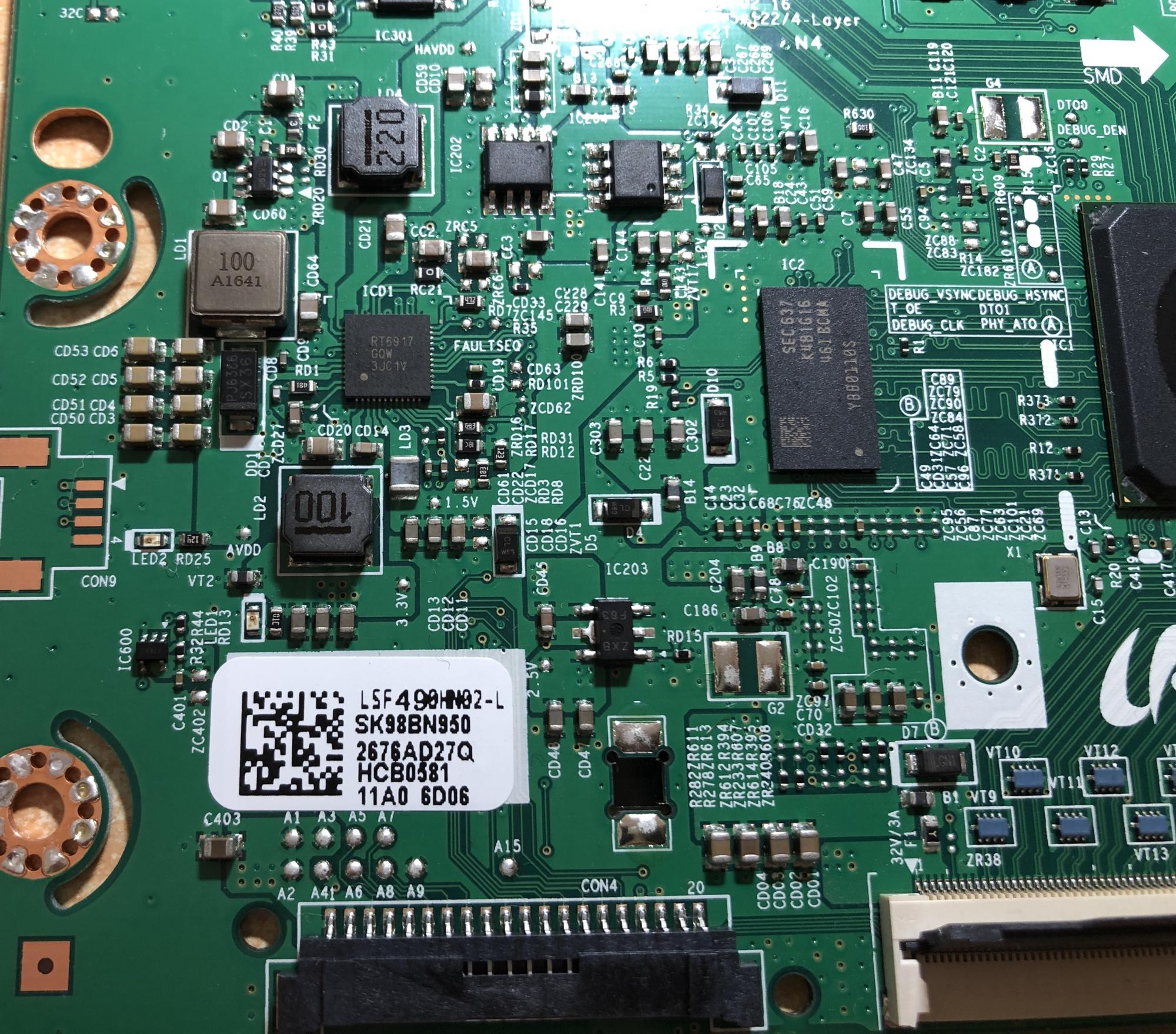

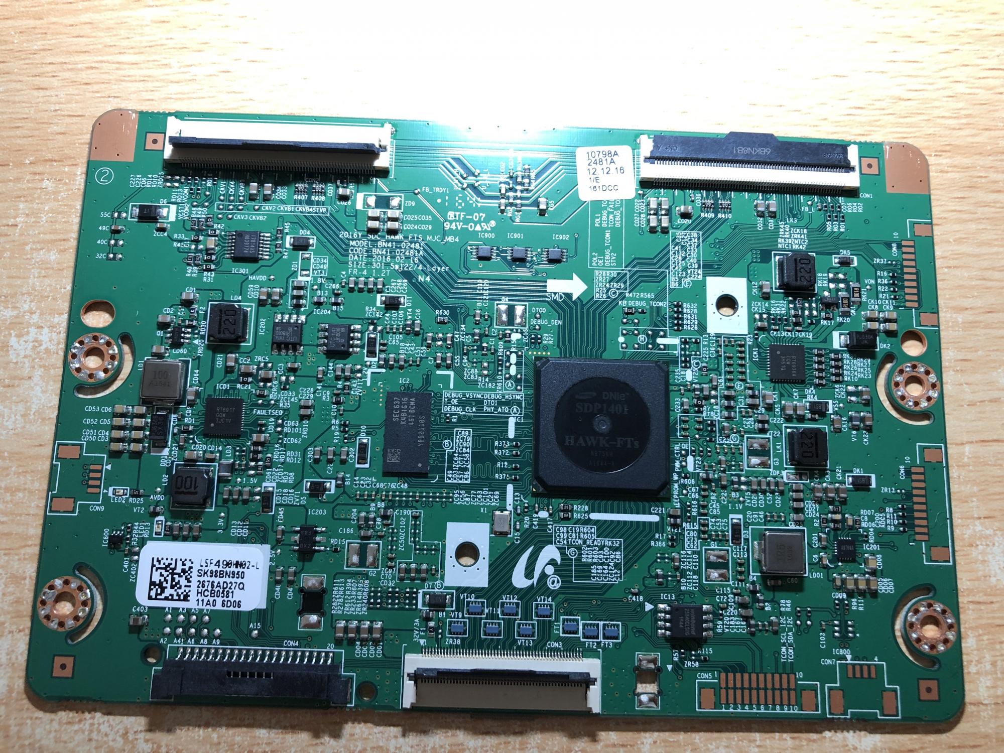

                        Hi Tiki and Vince - I have disconnected 1 TCon Cable at a Time and it is the same.
                        There doesn't seem to be any Graphics when I connect it to a Laptop, or when I try and scroll through menus nothing shows up.
                        I will Photograph the TCon in a minute and upload it

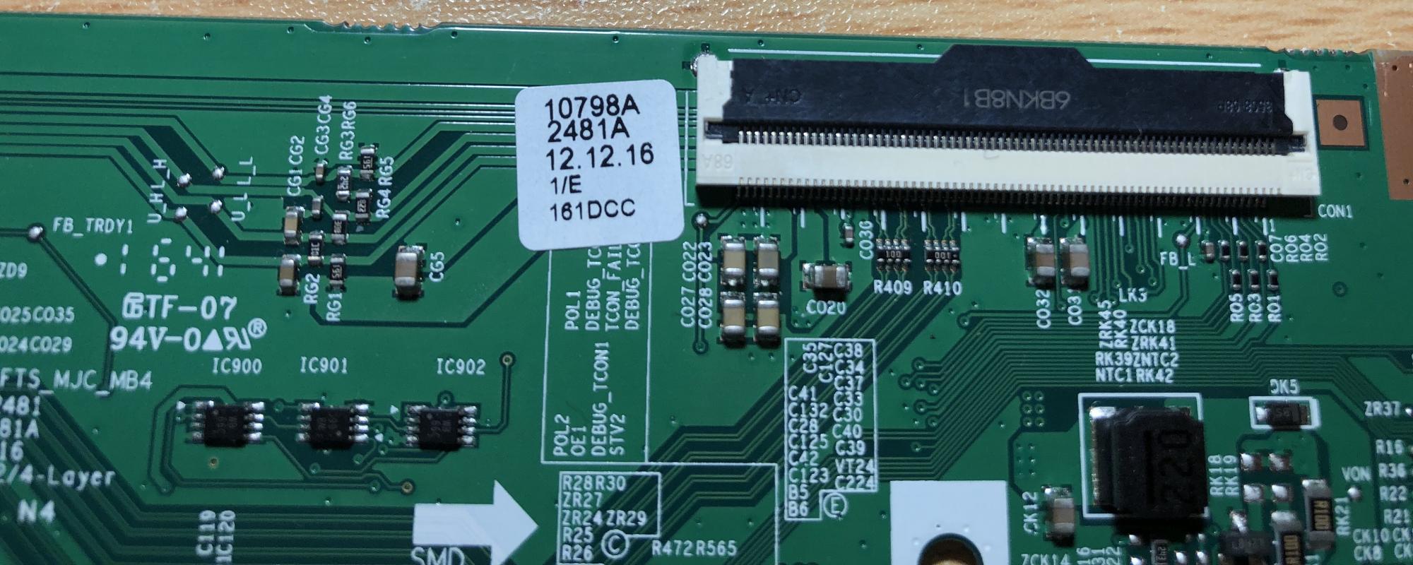

                          Re: Samsung TV - UE49K6300AK
                          Here

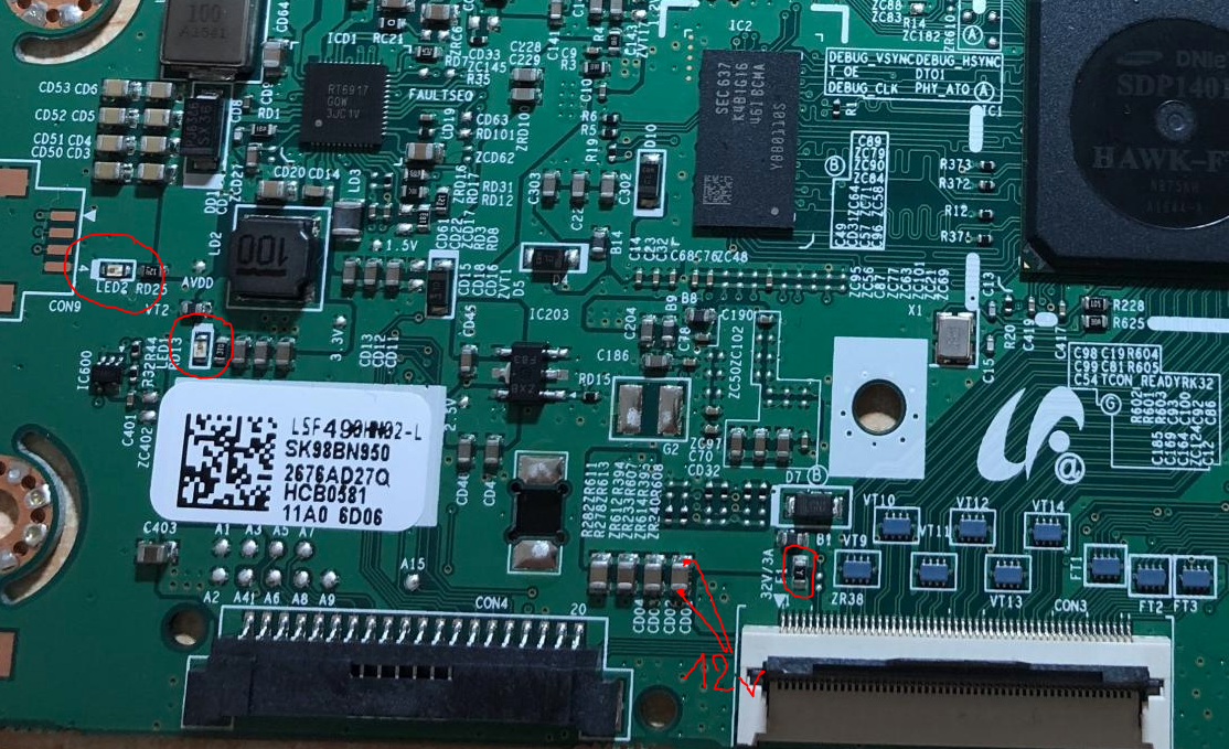

                            did you gheck the voltage on both sides of t con fuse (just too the left of lvds cable conector).
                              Check the voltage at 12v. and the LEDs on the T-con are on.
                                Hey Lotas Thankyou
                                I only saw 1 Fuse, but let me check, and will update you know
                                  Lotas, How did you know those were fuses?
                                    Lotas sorry to keep posting, but 1 of the LEDS glow with the meter on Diode mode and the other dosnt.
                                    What would that imply please?
                                    Top on Glows
                                    Bottom one dosnt glow
                                      Was it from the Photos?
                                      only one is a fuse 2 are leds 1 is a capacitor
                                      on the led that does not light swap your multi meter leads around does the led now light?
                                        Hi Vince
                                        it still dosnt light with the leads swapped around
