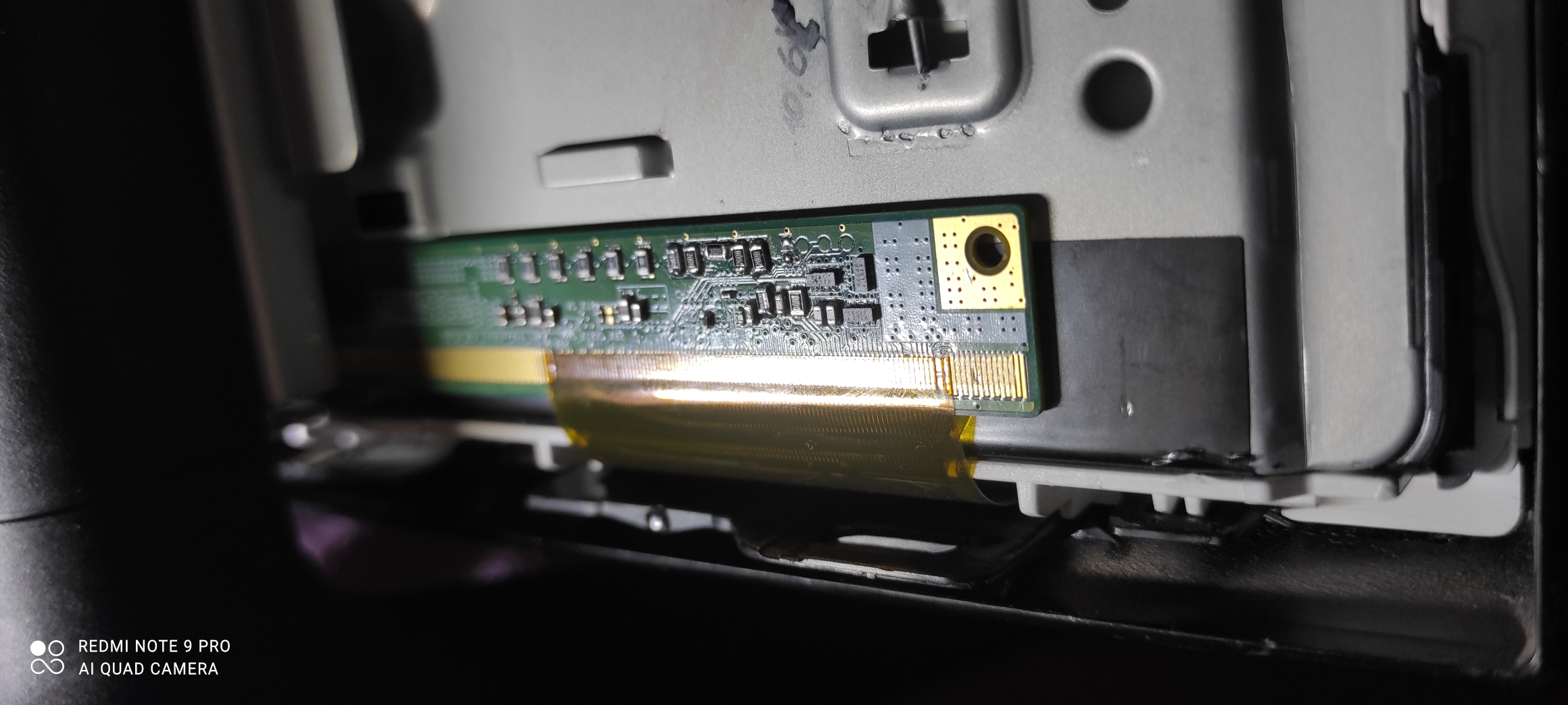

        Good day. Thank you very much for your answers. We have located 4 pieces of resistors overheating, everything looks OK. I soldered the resistors out, measured OK. I soldered back, the picture jumped up and after a while it starts to shake at the bottom. So I soldered out one 59A resistor and the TV got a nice picture. It worked normally, but this morning I turned on the TV and after a while it fell into restarts. I can't measure 6514A parts. Can you advise me how? Are they diodes? How to measure? Thank you for your interest and time

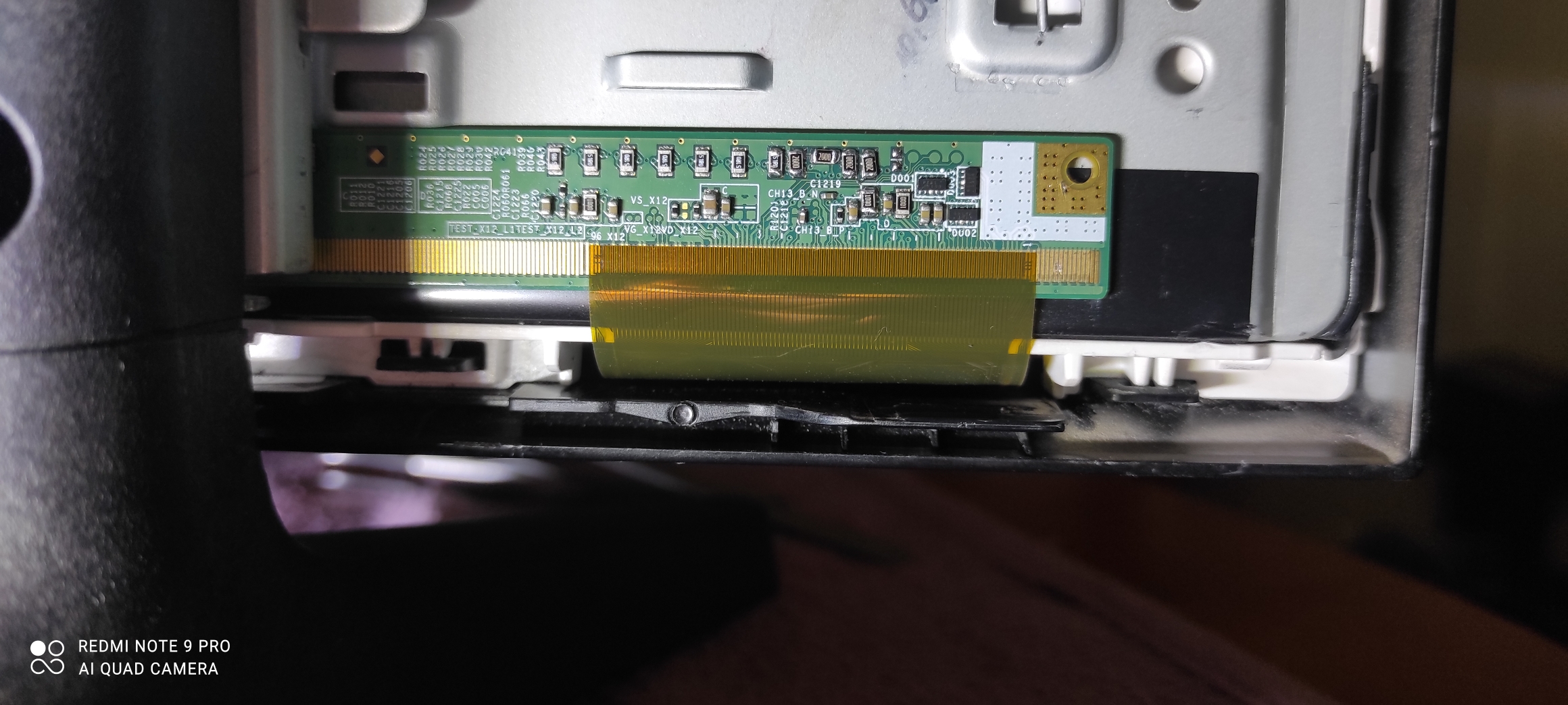

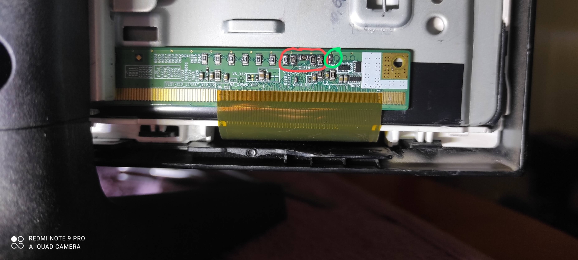

          you did not tell where are the resistors, and if the image shakes vertically, get a photo of resistors and where them are..
          • peterkos2
            • Nov 2020
            • 43
            • Slovensko
            Re: Samsung UE 50 RU7092 restart
            Foto
            I soldered the circles out and the red ones back and the green ones not
            • Davi.p
              Hobbist Tech
              • Sep 2009
              • 4333
              • Italy - Milan

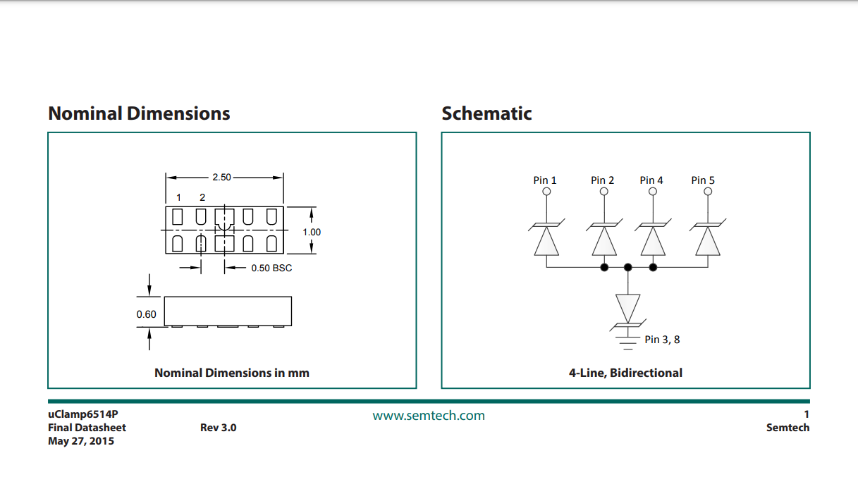

              ok now more clear, from the many threads here on badcaps on various models, also Sony but with Samsung panel, the main culprits are those or one of those diode packs D001/2/3/4, them are overvoltage protections that are to be removed to see if situation improves, first test them all in diode mode, only if you find a leakage you'll remove it, those are connected in some way to those resistors you've felt hot, if i under stand diode packs have one common anode (central pins) at gnd or connected to resistors, the other ones cathodes ( connected to gate drivers clocks), them are tvs diodes, hard to find in those format, but are to be replaced after all.

                Thanks, I just don't know how to measure the diode test-10pin
                I don't have a better datasheet
                • Davi.p
                  Hobbist Tech
                  • Sep 2009
                  • 4333
                  • Italy - Milan
                  good! Is better than nothing... If i remember opposite zener are used in fact for overvoltage suppression, if you put multimeter in diode mode, between pins 1,2,4,5,6,7,9,10 and 3,8 must read open both ways..

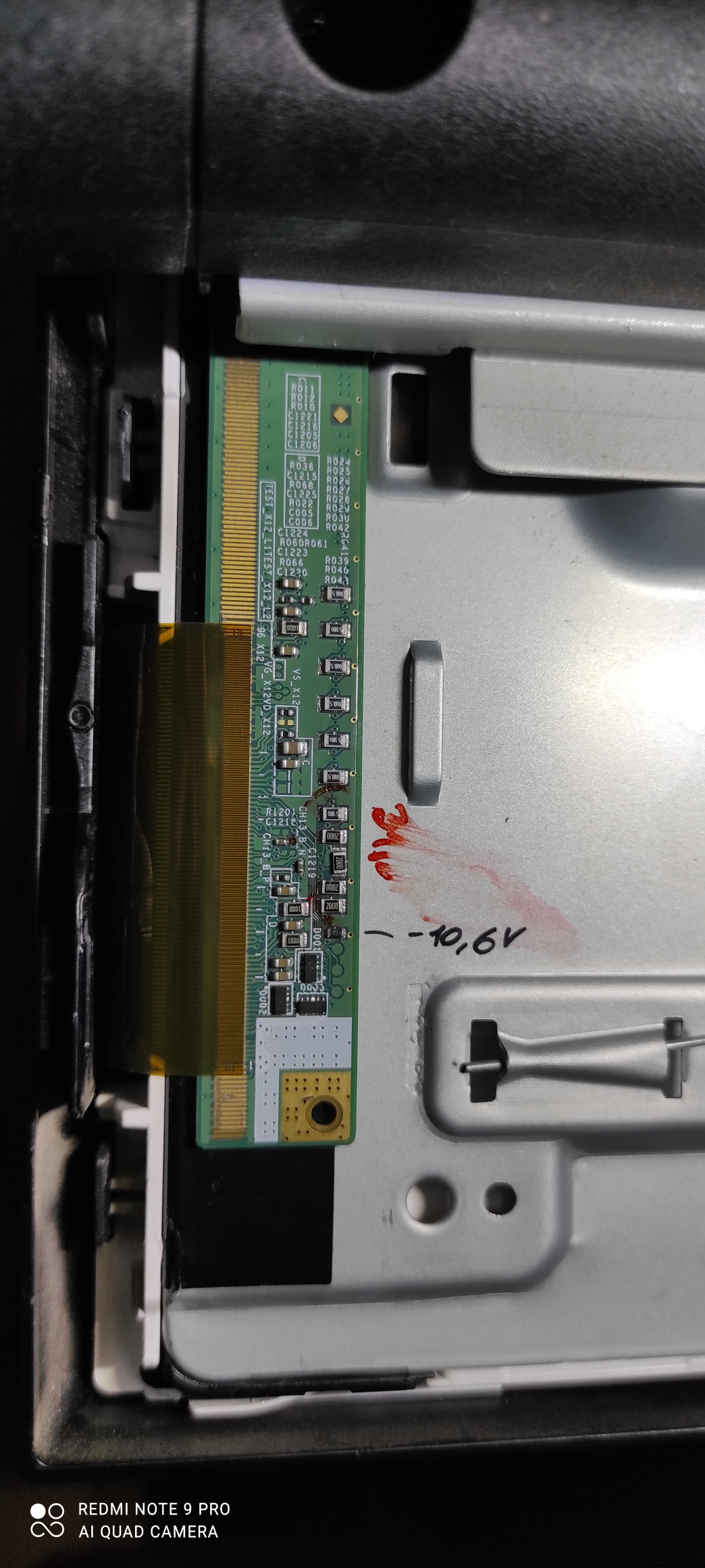

                    So the error is there and cannot be corrected
                    Thank you all, at least I'm a little smarter
                    But the question is, it didn't actually start somewhere in the glass
                    • Davi.p
                      Hobbist Tech
                      • Sep 2009
                      • 4333
                      • Italy - Milan
                      The damage came from the electrical supply much probably.. destroyed the chip within the glass
