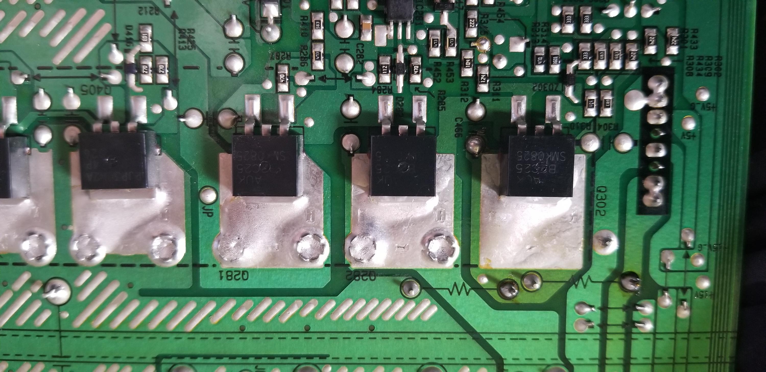

          You got some part numbers wrong. For q302, q281 and q282 is SMK0825, an IGBT.
          RJP30H2A is an IGBT, nothing comes up with RKP30.
          SF20D400SD2 is a diode.
          If they are suspect of being shorted, then they have be desoldered from the board and tested off-circuit.

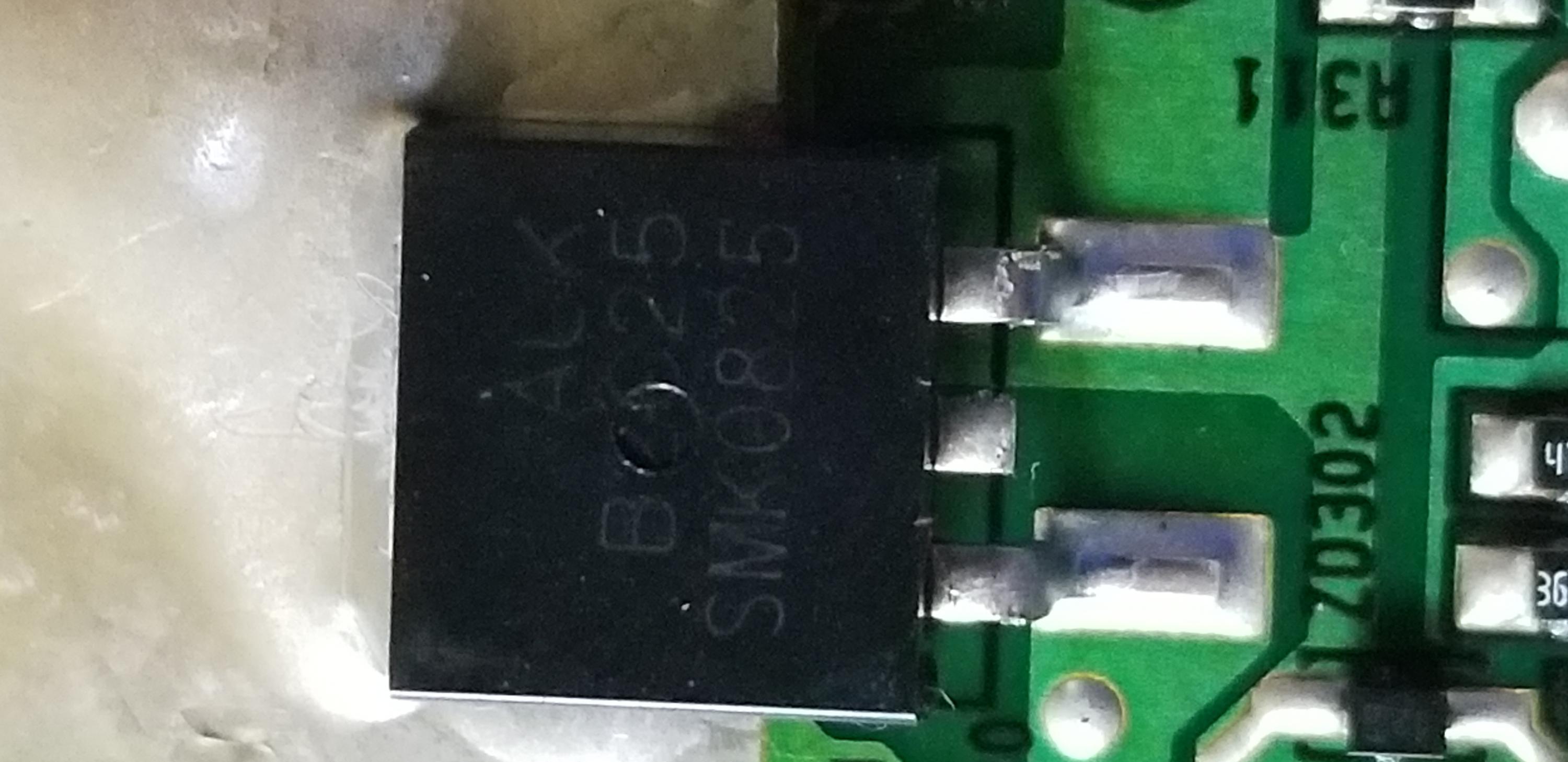

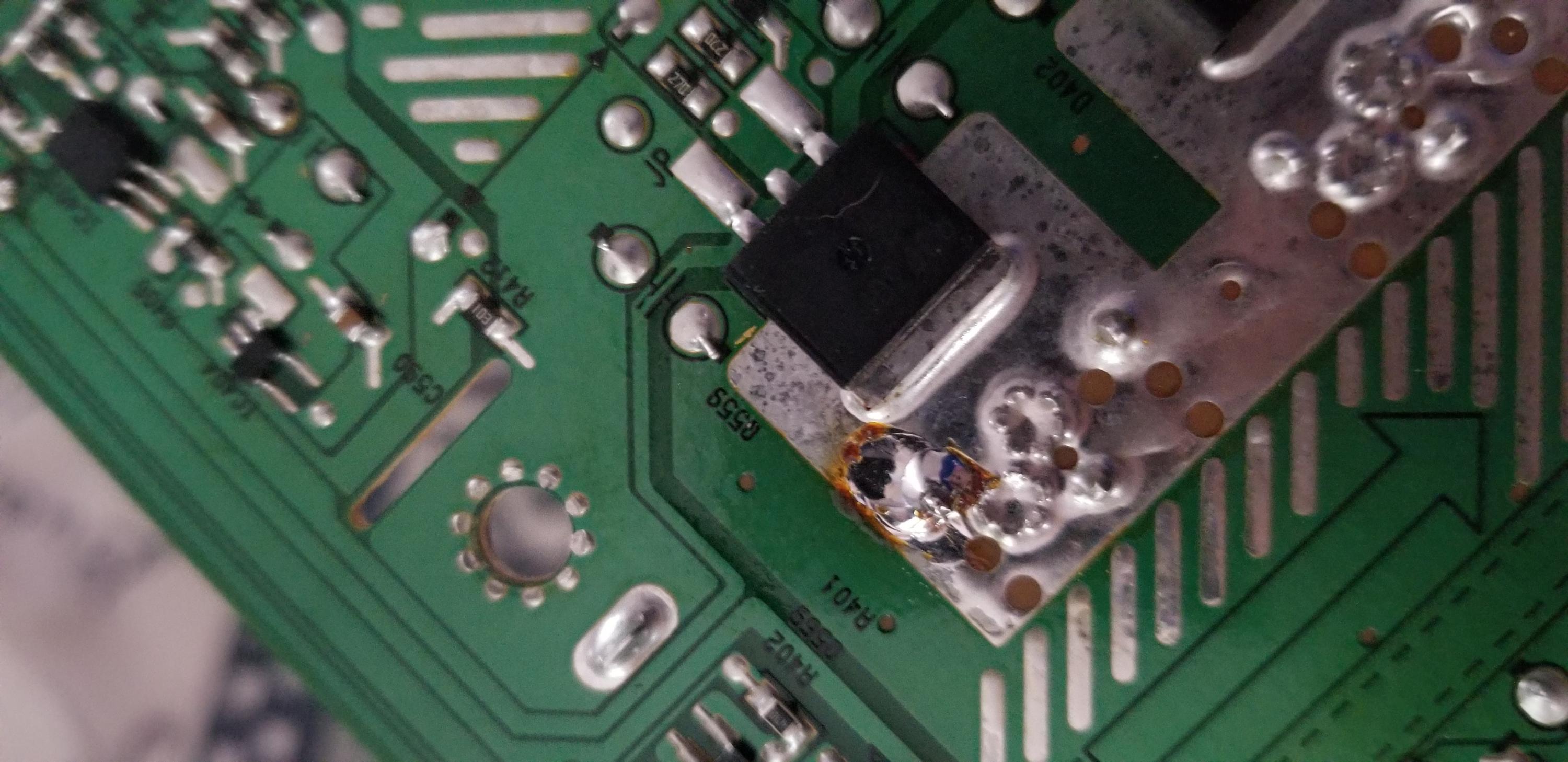

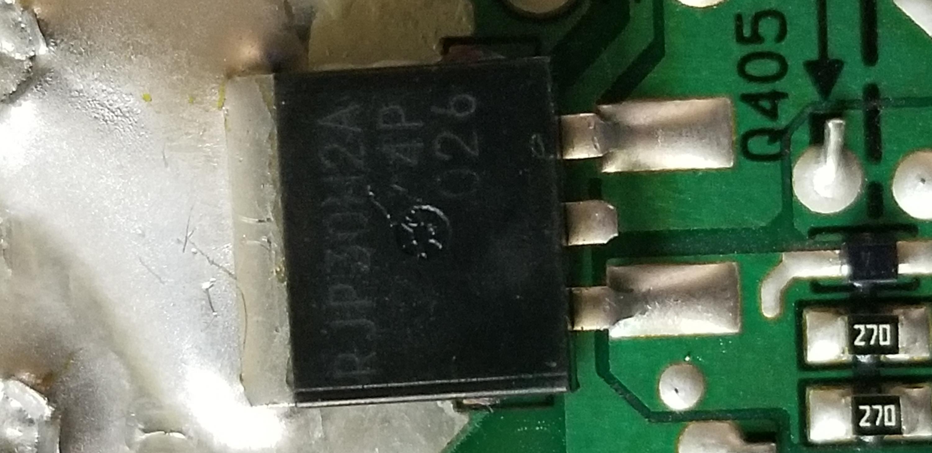

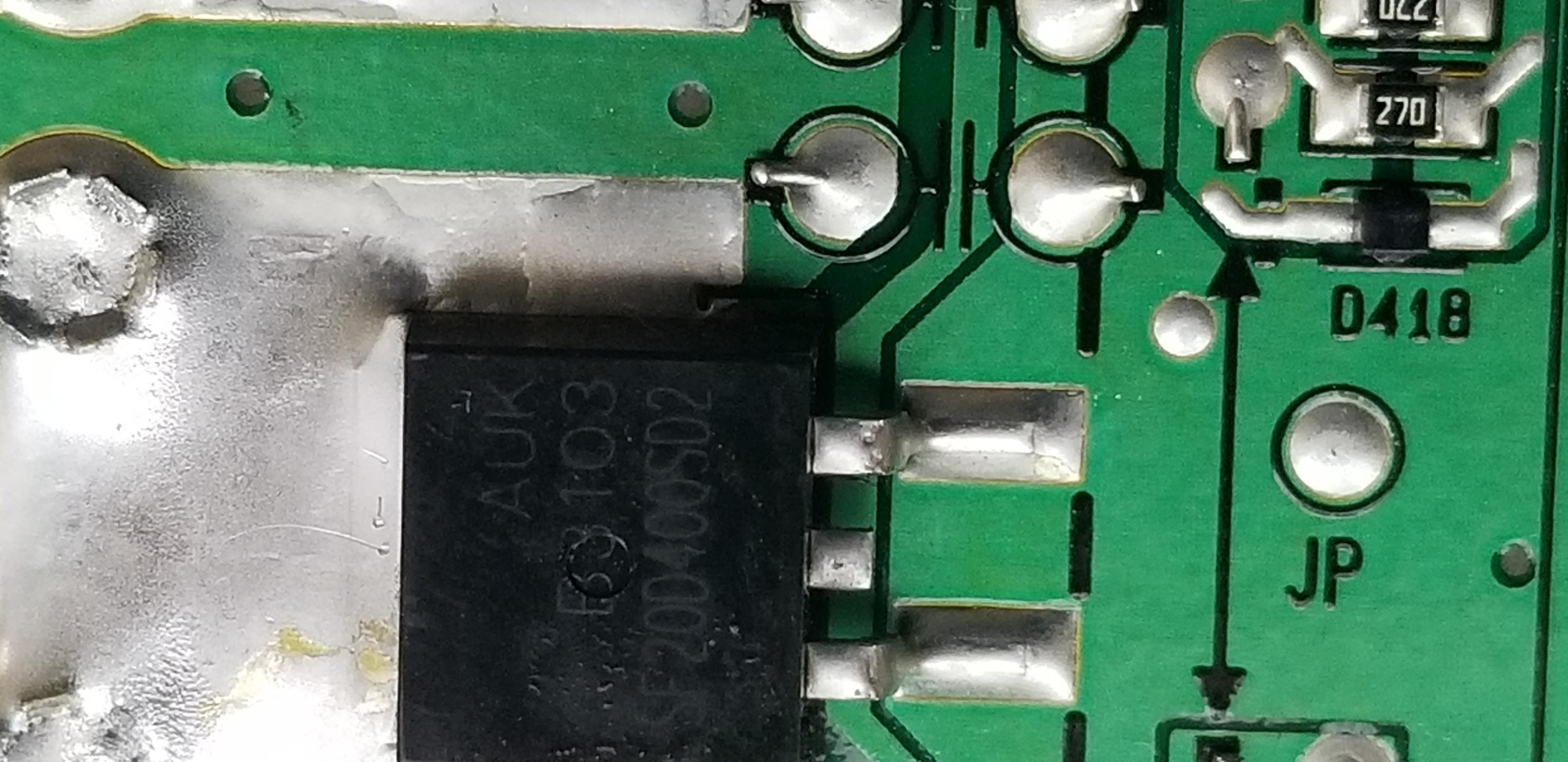

            Heres pics of the 3 different components and the writing on them . Where can I get these? Thanks also is there something else i should check?
            • dick_barton
              • Aug 2015
              • 6643
              • Wales
              Re: Lg 60pa6500 black spots on tv
              You can check SF20D400SD2 as Biruslapio says since they are dual diode pack which your meter can test. Unfortunately the best way to test them is if they test short on the board to desolder them and test again.

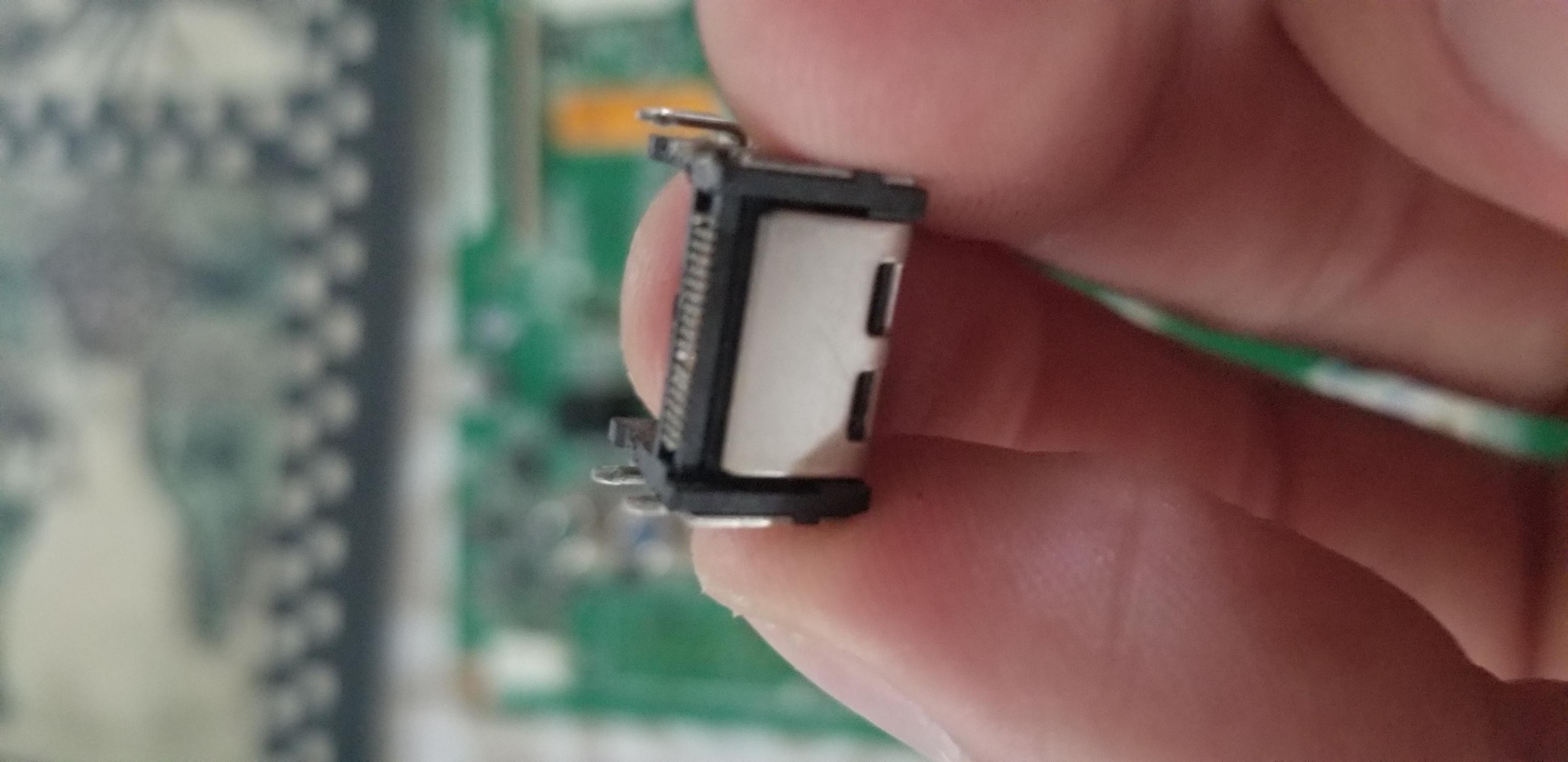

                                  #36
                                  For the main board should I just get another hdmi port and which one am I looking for thanks

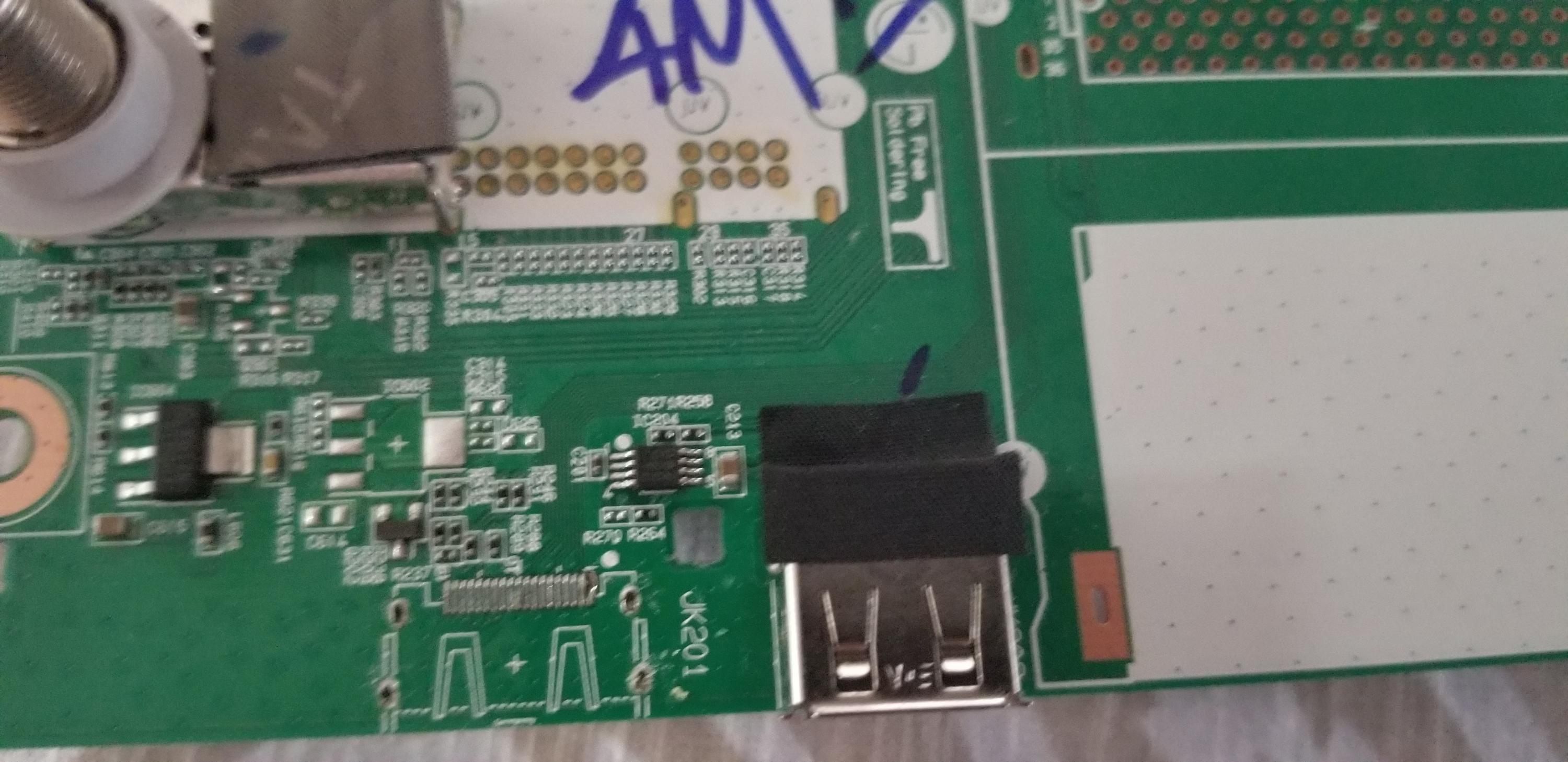

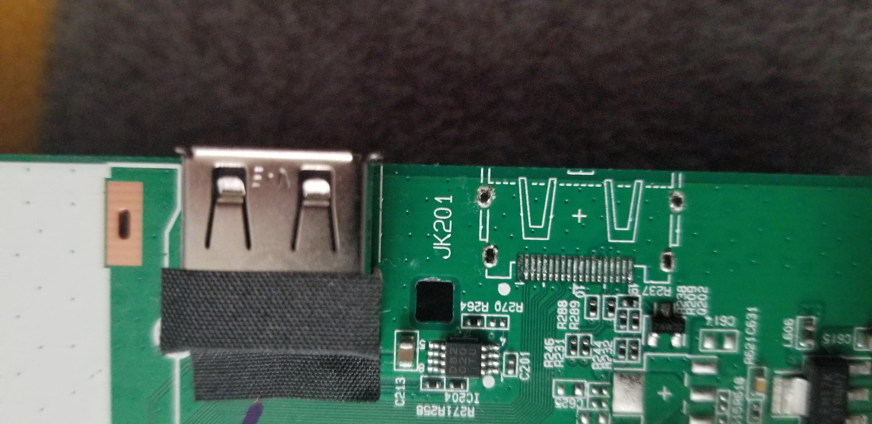

                                  • mmartell
                                    • Oct 2013
                                    • 3189
                                    #37
                                    If you see any shorts where the hdmi port came off run your iron over them to remove them. The board will still work fine without the port there provided the cpu isn't seeing a short.
                                    • pansatdishman
                                      • Jun 2013
                                      • 110
                                      #38
                                      Yeah the board isn't working without the hdmi, and I see the board is missing one trace for it
                                      • vinceroger69
                                        • Mar 2012
                                        • 6714
                                        • uk
                                        #39
                                        The main board should work with the hdmi port removed can you upload a picture of the missing trace area
                                        • pansatdishman
                                          • Jun 2013
                                          • 110
                                          #40
                                          Here
