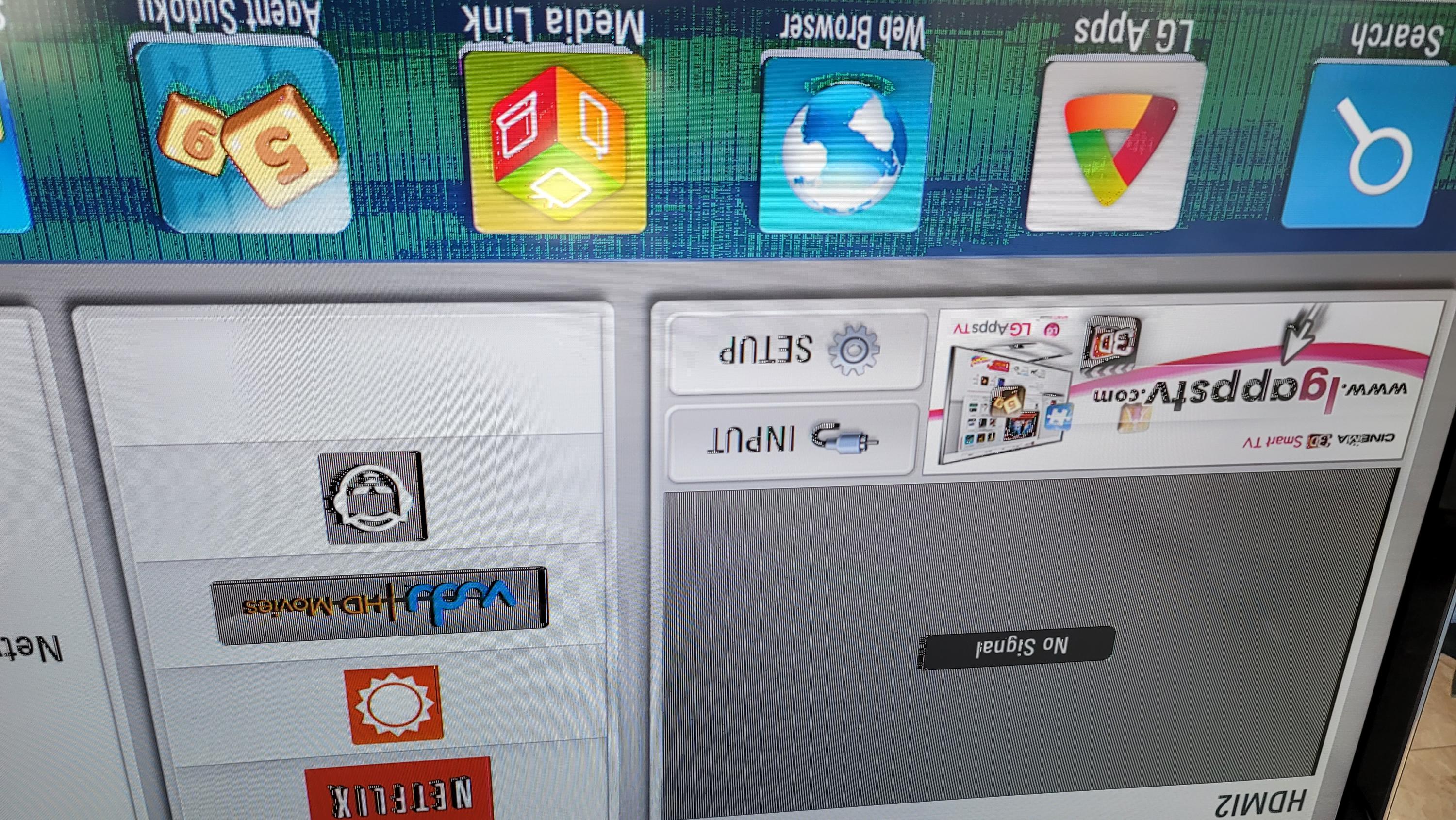

    47LW5600 Lines
    I have lines on the screen, I have already replaced the T-Con. Do you think replacing the main board could fix it? I got the T-Con from shopjimmy.

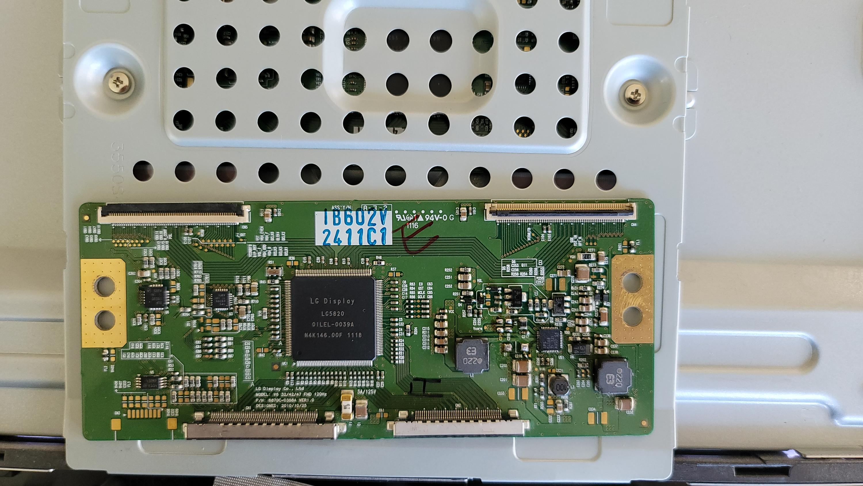

      Re: 47LW5600 Lines
      Was the old T-CON also?
      It looks like RAM or CPU, try to heat up a little CPU with a hairdryer

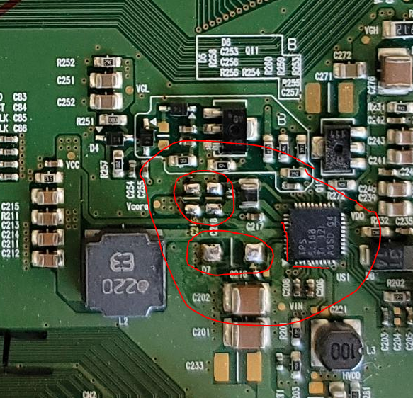

          Re: 47LW5600 Lines
          Something I don't like about your T-con board lack of parts and soldering.

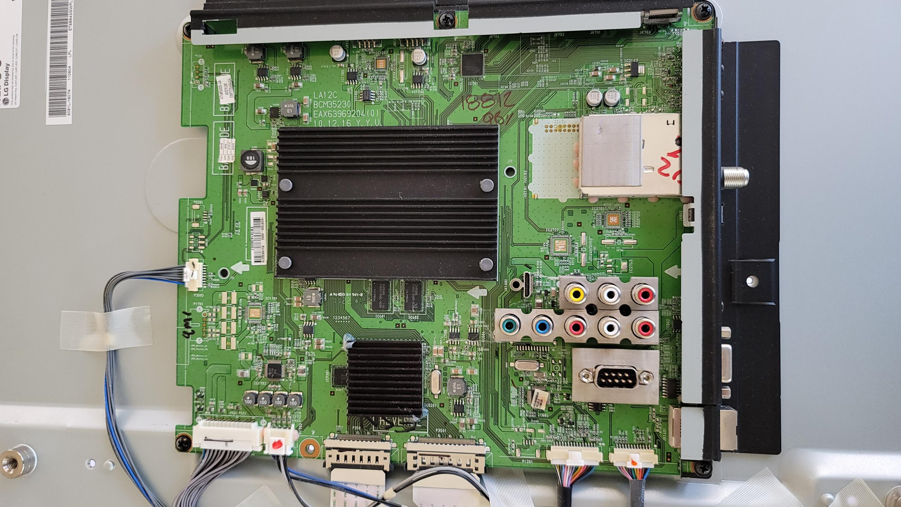

            Re: 47LW5600 Lines
            Main boards are going bad on these

              Re: 47LW5600 Lines
              Yes, on these chassis, the processor suffers from overheating, reballing or replacing the processor helps.

                Re: 47LW5600 Lines
                LE, LV, LW, and LS have BGA failures. Lots of repair services on ebay if you search.
                Symptoms
                -TV responds to power on command, LED lights run at the front bezel, but the screen never lights up or lights up, but with no image;
                -TV starts up and LG splash screen shows up, but freezes there;
                -TV comes up and has image, but the image or audio is garbled;
                -Loss of HDMI ports or loss of audio.
                  Yeah I did remove some caps because I thought it was short. It wasn't short out of curcuit so I put it back in. But I did order a replacement T-Con it was the same no change.
