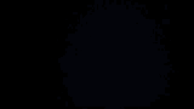

    I found out from the guys that transported the TV to me that the TV shifted in route and it was the screen coming in contact with a toolbox that stopped its slide. This is likely when the panel was damaged.
      Re: Sharp LC-80LE632U 2-5 blink code
      I raised the panel up just enough to see the screen when the backlights come on and verified that the screen is cracked from the bottom left to the top right (see attached GIF). You cannot see the crack with the backlights off.
      Thanks to all for your help/suggestions.
