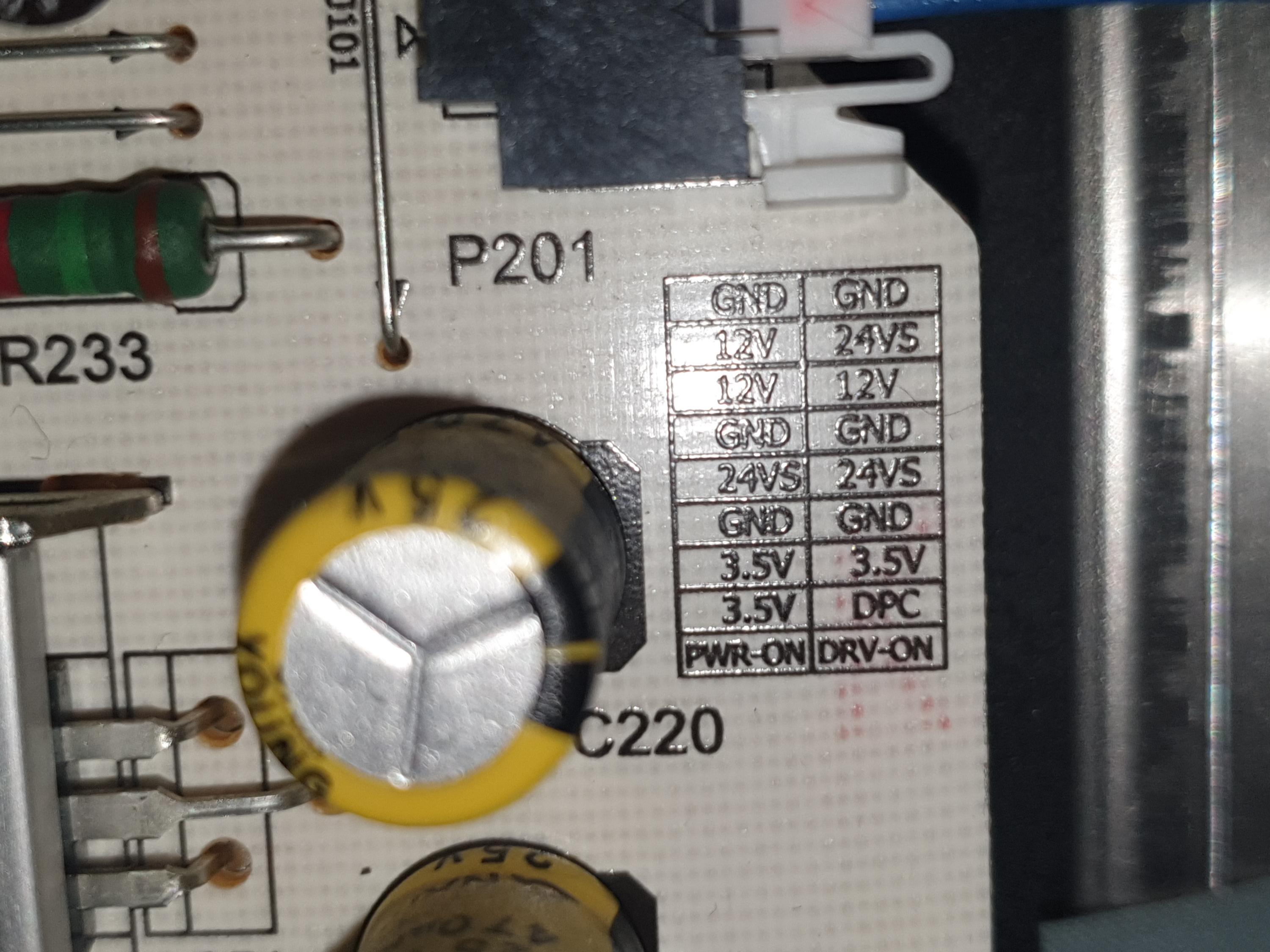

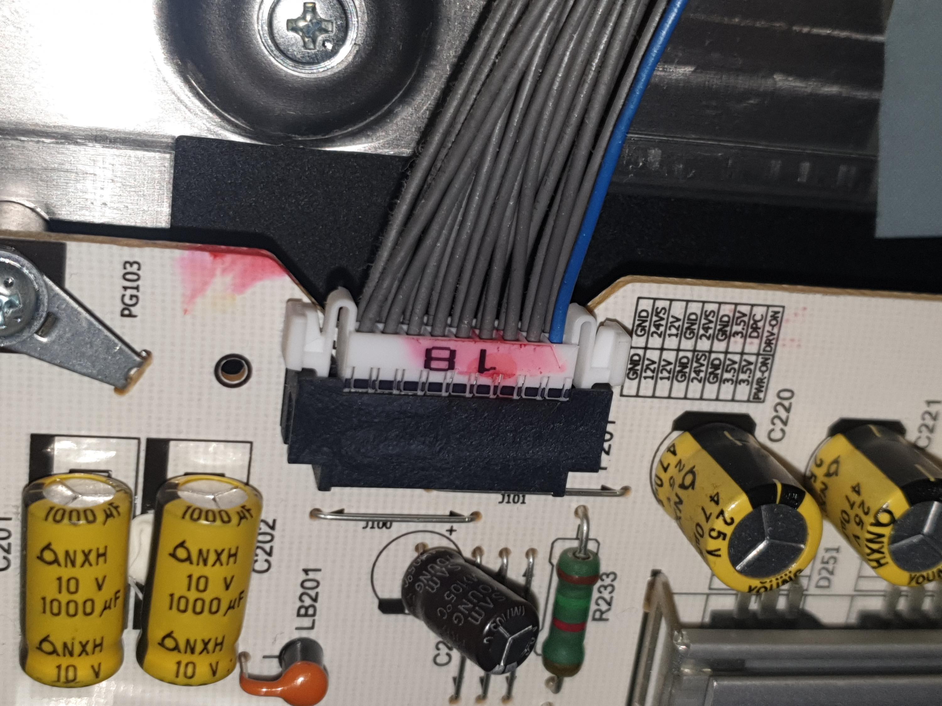

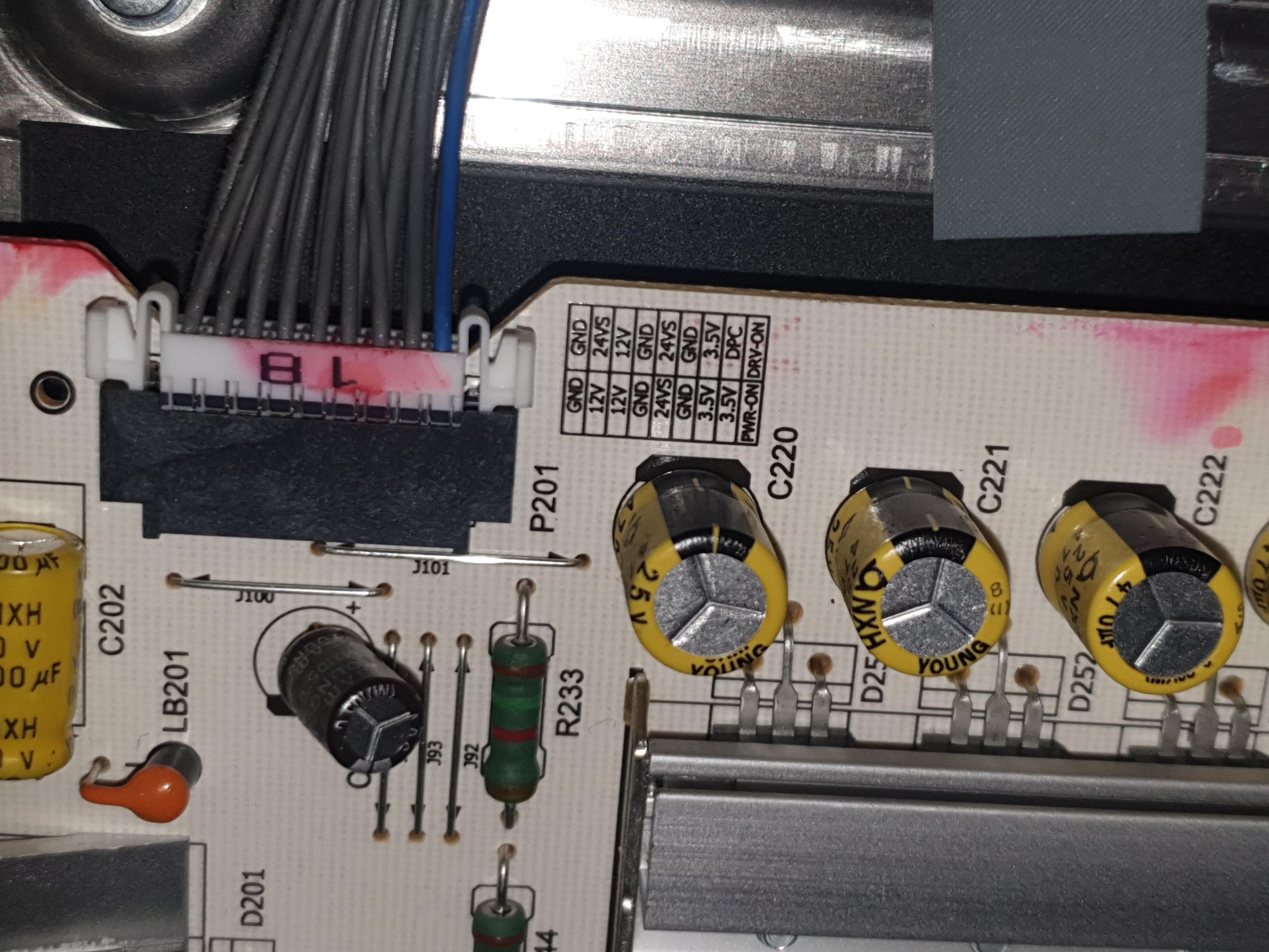

            okay.. show me the print lable pin chart of the socket on the PCB which it goes to MB
              #86
              Re: LG 55EC930v is not turning on, it's dead
              Sorry, don't know what you mean. You mean from T-con socket to the MB?
                #87
                on the power board.. near the socket which go to MB there are printing label named the pins description of the socket... i need to see it so i write to you the test.
                  #88
                  Okay, here are the Pictures.
                  I guess, this is the end of the tv
                    #89
                    the things you may didn't know... the T-CON driver boards receive the VCC 12V via the LVDS... so what you did before disconect LVDS with out feeding T-CON driver boards with 12V make no sense at all.. this why you need to follow the test below.
                    this test very important and you should double check each step like the (japanese workers method shisa kanko) Pointing with finger and calling the pins ) for avoiding mistakes.
                    1- the socket between PCB and MB should be disconnected from the MB side
                    2- the LVDS between MB and T-CON driver boards should be disconnected from the MB side
                    3- locate the Fuse (F1) of the 12V on the T-CON driver boards ( usualy will be close to the LVDS socket in case you didnt see it remove the metal shield of the T-CON driver boards to have access to the fuse of the T-CON VCC on board ( could the label will be (F1). be sure the boards screwed with chassis on case you removed the shield.
                    4- the 24V socket between PCB and T-CON driver boards should in place connected on both side
                    5- on the socket on PCB which goes to MB. idenfied and locate the following pins:
                    A- 3.5V pin any one you have 3 pins
                    B- Pwr-ON pin
                    C- DRV-ON
                    D-12V
                    6- make Jumpers connect all A_B_C together
                    7- connect the pin D-12V to one side of the fuse (F1) you can use clip for example or solder it up to you.. but the connection should solid and stable
                    8- go back and check all points above done in correct way
                    9- plug the TV in wall socket.. and look on the screen..any color it displaying shoot photo and upload over here.

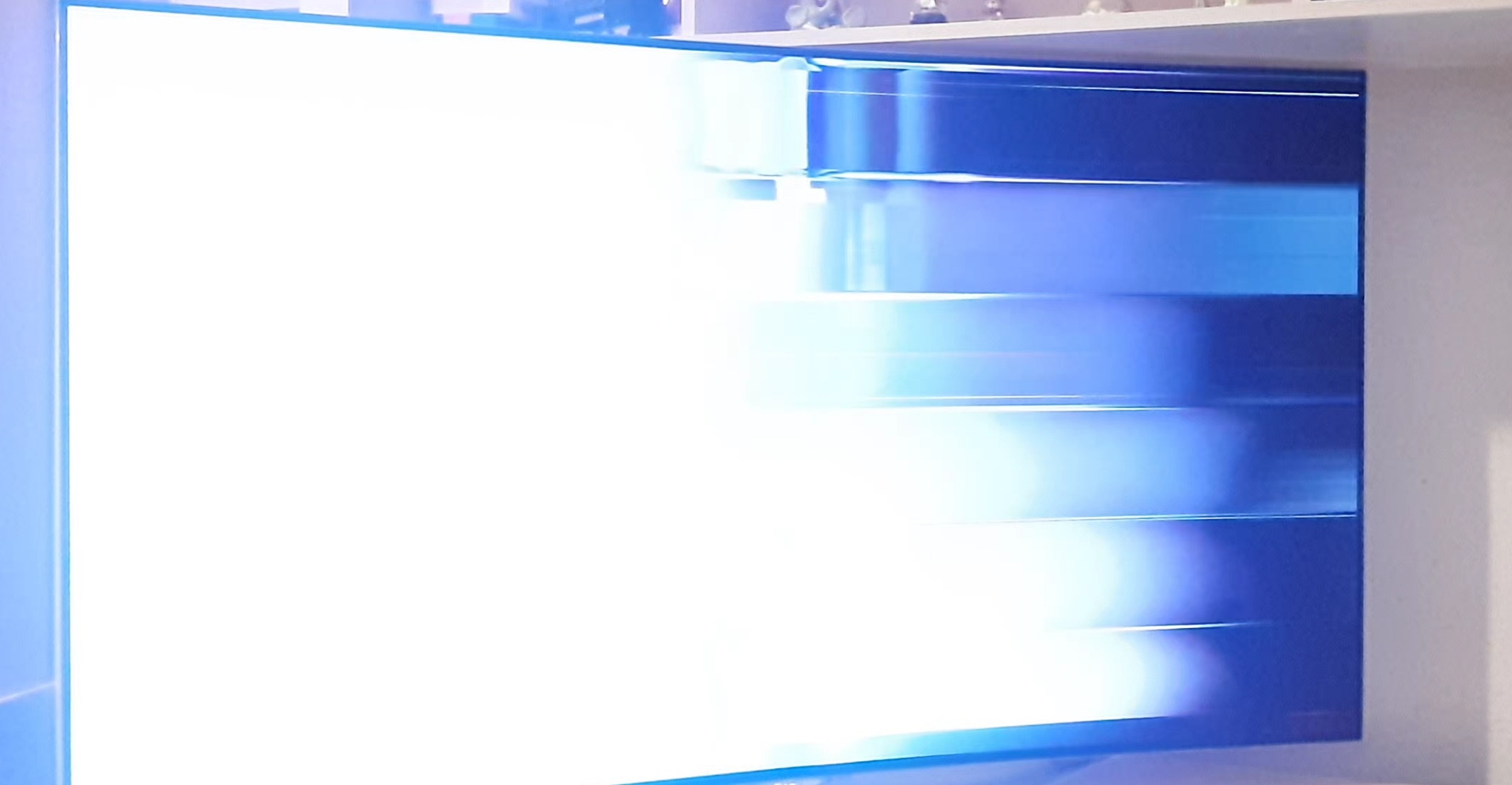

                                  This TV is forever dead... was flickering at test and then screen freezed and i smelled something weird... will upload pictures...

                                    flickering or one color pattern R G B

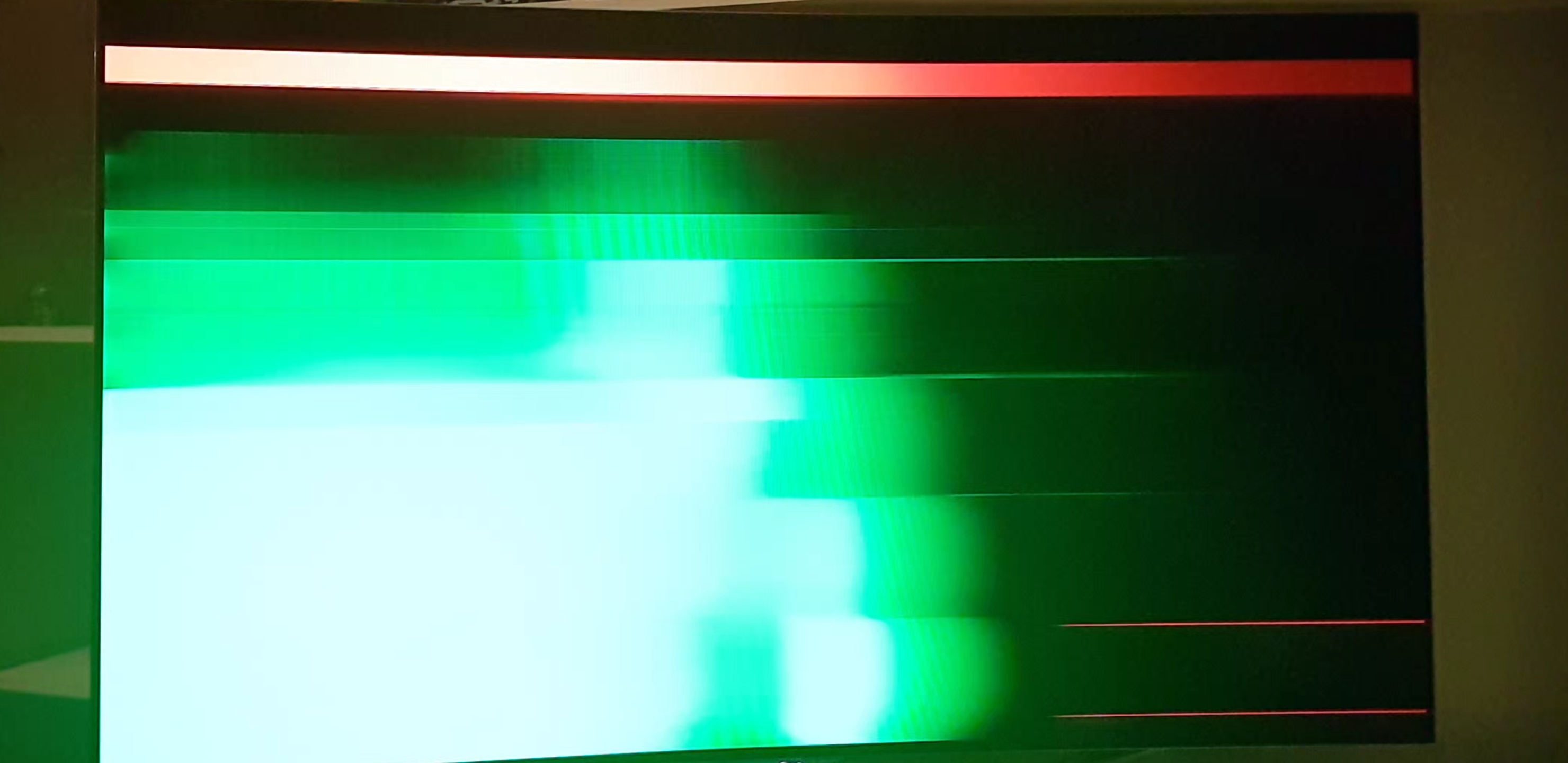

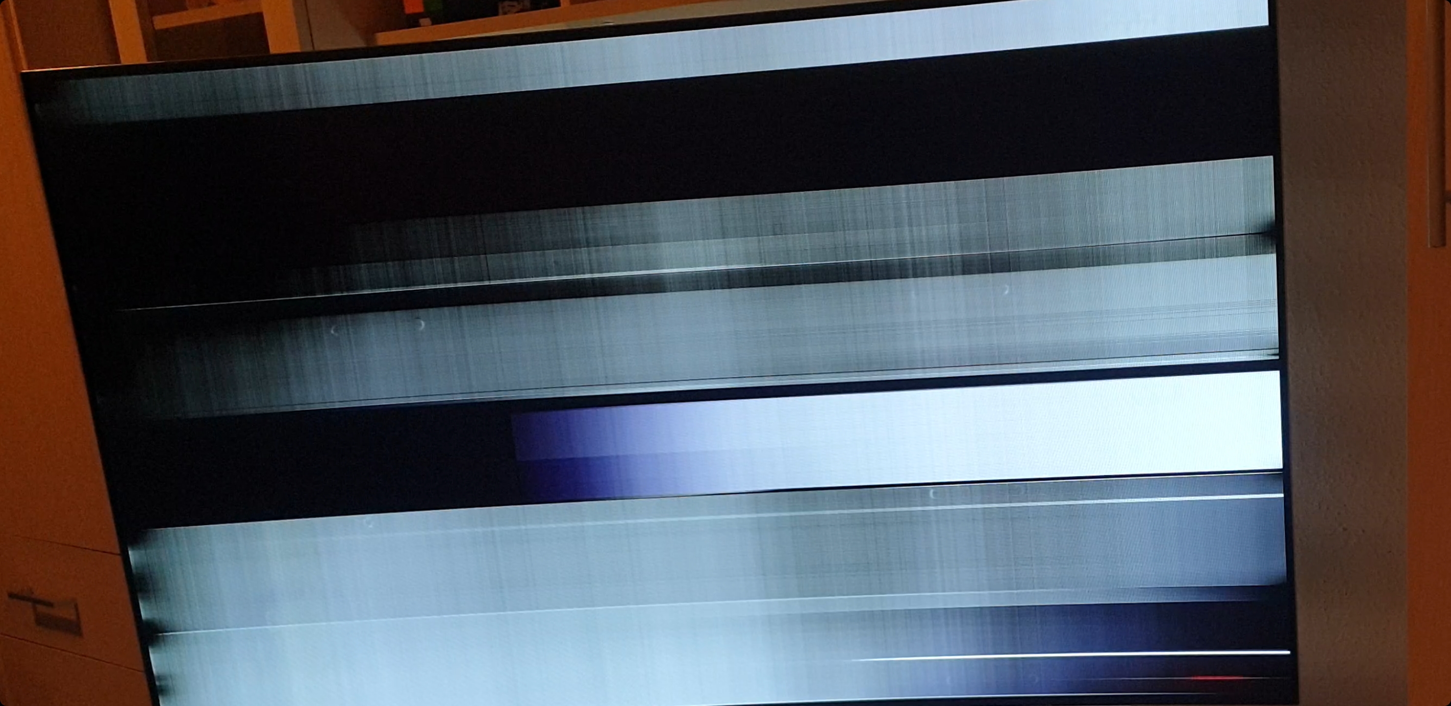

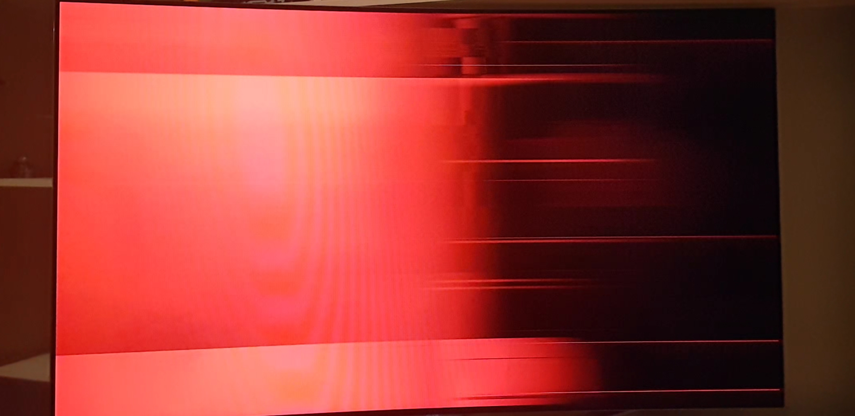

                                      #98
                                      I could see the colors changing but half site had also same problem + flickering orange lines. then it freezed and stayed at one color. then it started a bit smelling
                                      Here Pictures

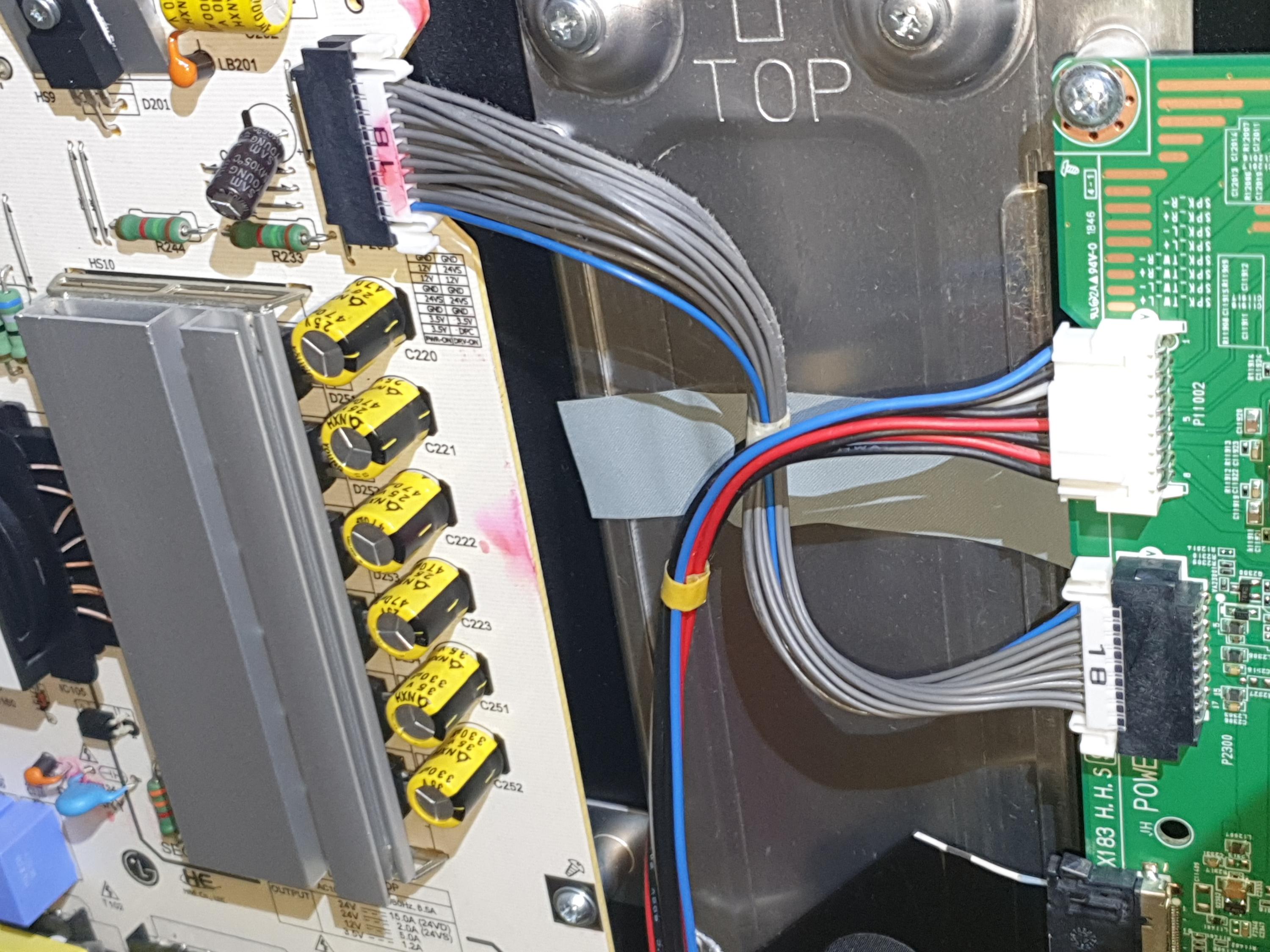

                                        show me the photos and show me your work of cable and t-con too
                                          And the another weird thing is now, TV is now always turning on with normal remote and i see everything flickering. then also the loading image and then everything is away on screen and i see on left side a bit green, also a bit of these green lines i got when LVDS removed.. and also hearing sounds in the corner like buzzing..
                                          unfortunately i didn't shot a image of the cabling..
                                          It's time to give up...
