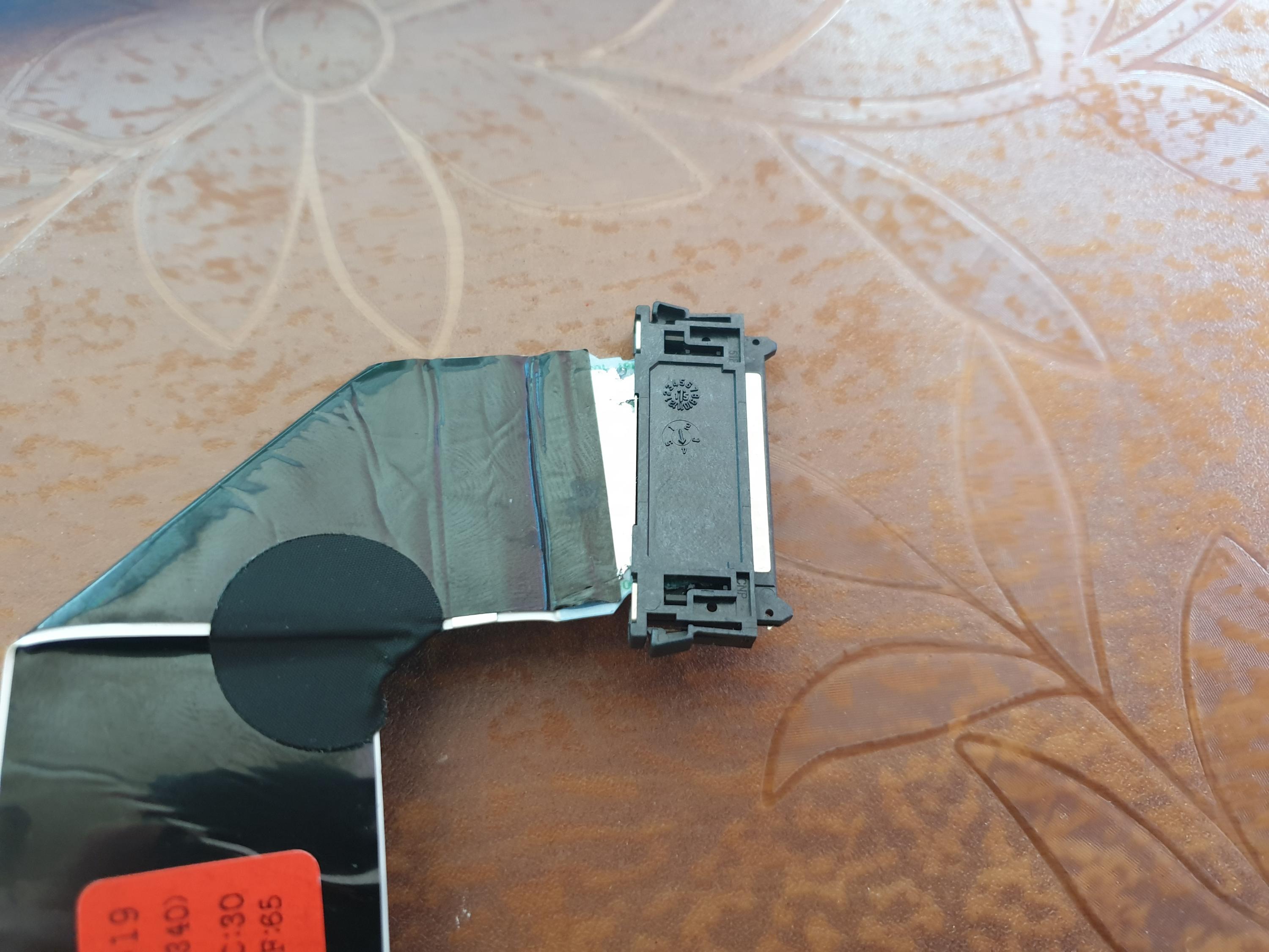

    ... gosh ... what about the original lvds can u show me
      #62
      Re: LG 55EC930v is not turning on, it's dead
      i broke on that original LVDS cable the connector, because of that i bought a another LVDS cable. got only a old picture of it how it looked.
      Will also search a image of the new cable how it looks.
        #63
        This currently the LVDS cable. Picture is of 2021 summer.
        You can see it a bit that it's not flat, it's bended. it was 170° bended in the package.

          #64
          ohh shit crap... it got many folding .. shit seller.
          this original one you can repair it and bring it back to life.. now its late for me... tomorrow we can focus on this cable... don't play with tv any more please... my happiness always if we safe some things from scrap.
          just upload more photo on the original lvds from many direction to understand the damage.

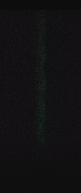

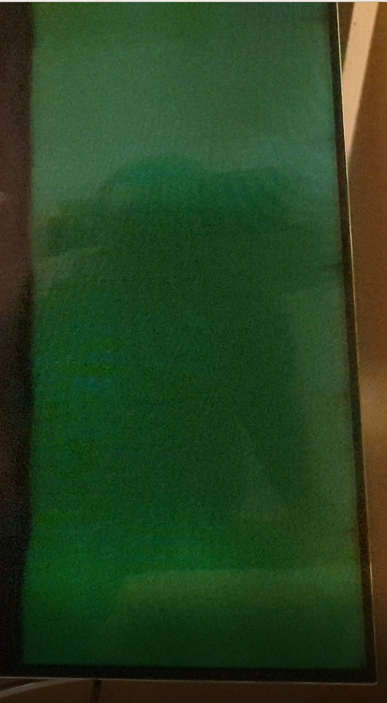

                  let me explain for you how OLED work. and why you got green and what it mean the green line you got moving from top to down
                  1- you installed the replacement t-con result was green screen.. ( t-con defect ot its firmware didn't match )
                  2-you disconnected the 24 line.. you saw green line move from top to down ( this is refresh pixel after you send IN_STOP command... it show green because the fault T-CON was able to turn on green only... in normal cases this line should be white.
                  3- as you are home user.. not workshop. so you don't have discharge.. OLED always need to discharge 90% of any current remain at T-con PCB or Panel module after any repair step to avoid any dummy result caused before the repair.
                  so leave it discharge.. as you faxed before when you left it long time and when you turn it on was working for 3 minutes

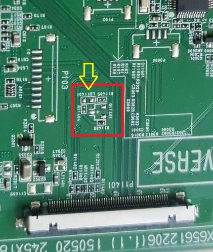

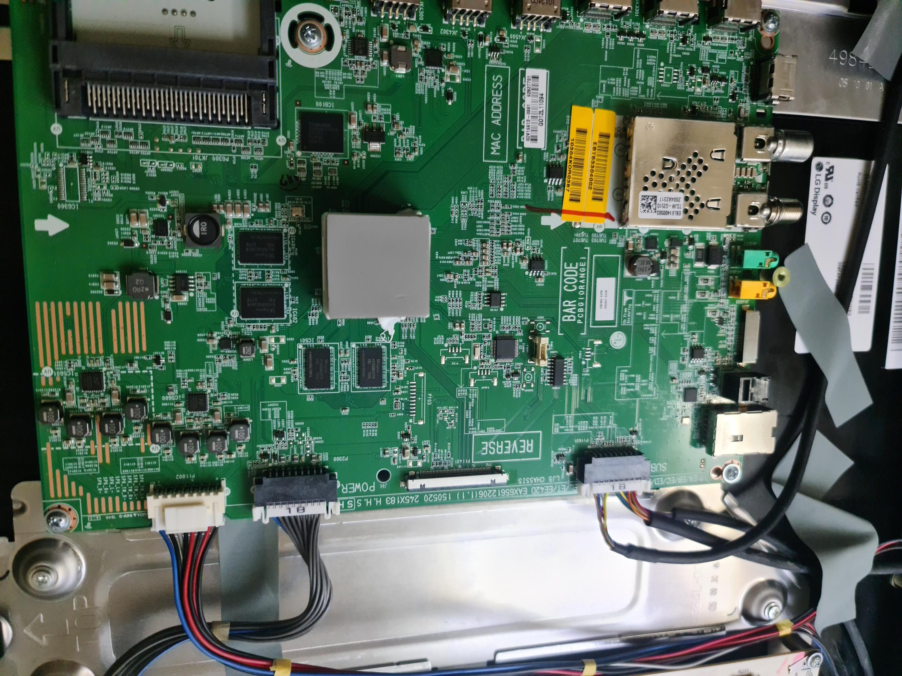

                              take look on the Main boards.. you have on the right side of the LVDS socket small LED with Lable as i remember (LD114) if this Led lit red color mean the main board are fine and sending video signal to the T-CON. tell the result then we go further.

                                  #76
                                  upload focused high resolution photo of yours MB

                                    #77
                                    Yes i'm now out of House but before i leaved i made a image. When i'm home in 1-2 hours, i will test again LVDS and will upload more high res. Images of MB.
                                      #78
                                      I've never seen a Light on it, even when tv Was working.
                                      this is LD indicator !!!
                                        #79
                                        Okay, this is like with the Button that is not on my MB. See only the solder Points. I'm at home in half hour and then will check again correct the cable
                                          #80
                                          are you kidding me ?? then why you post it.. its worthless if i spend time on some things not belong to the matter.
