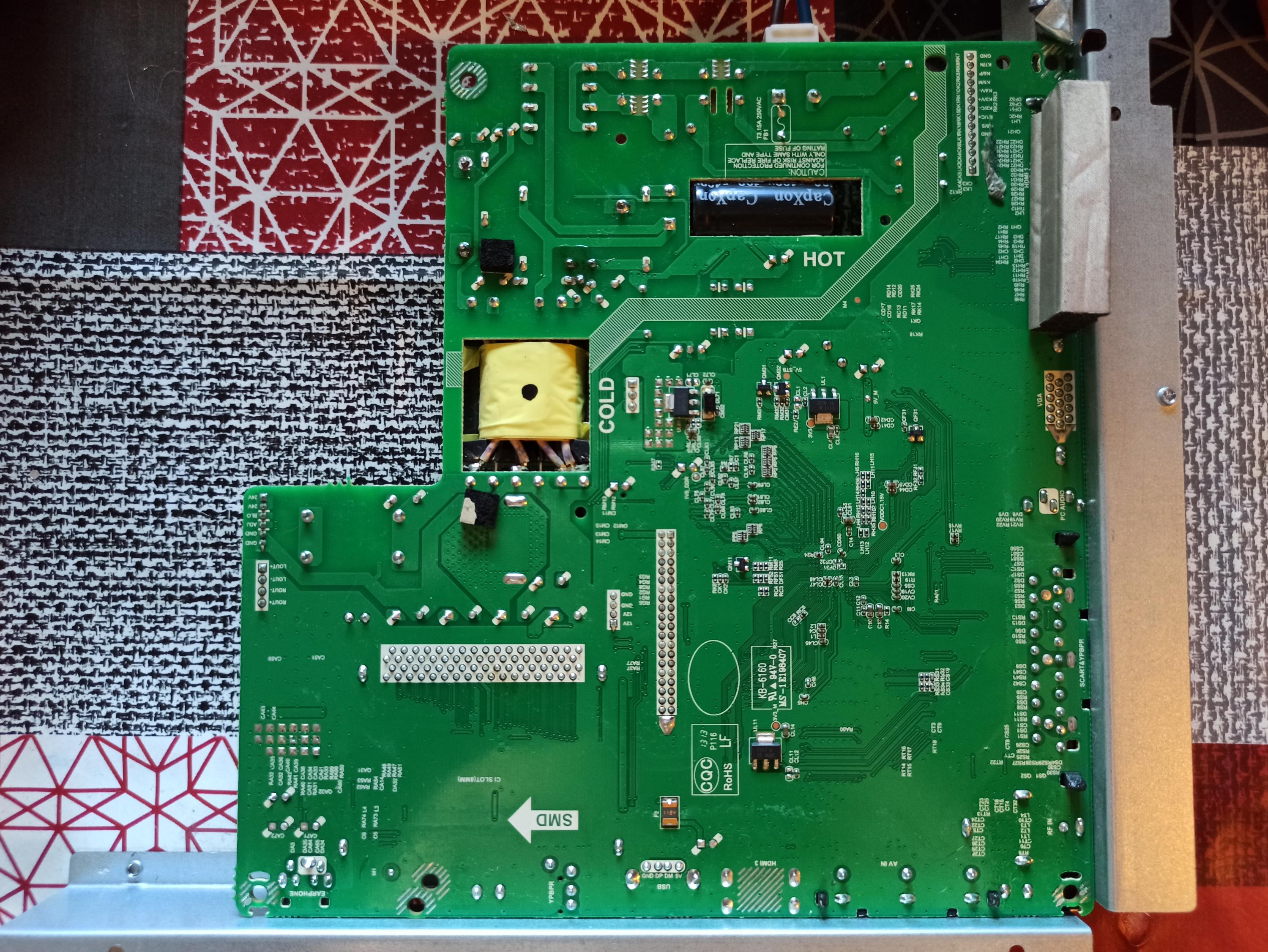

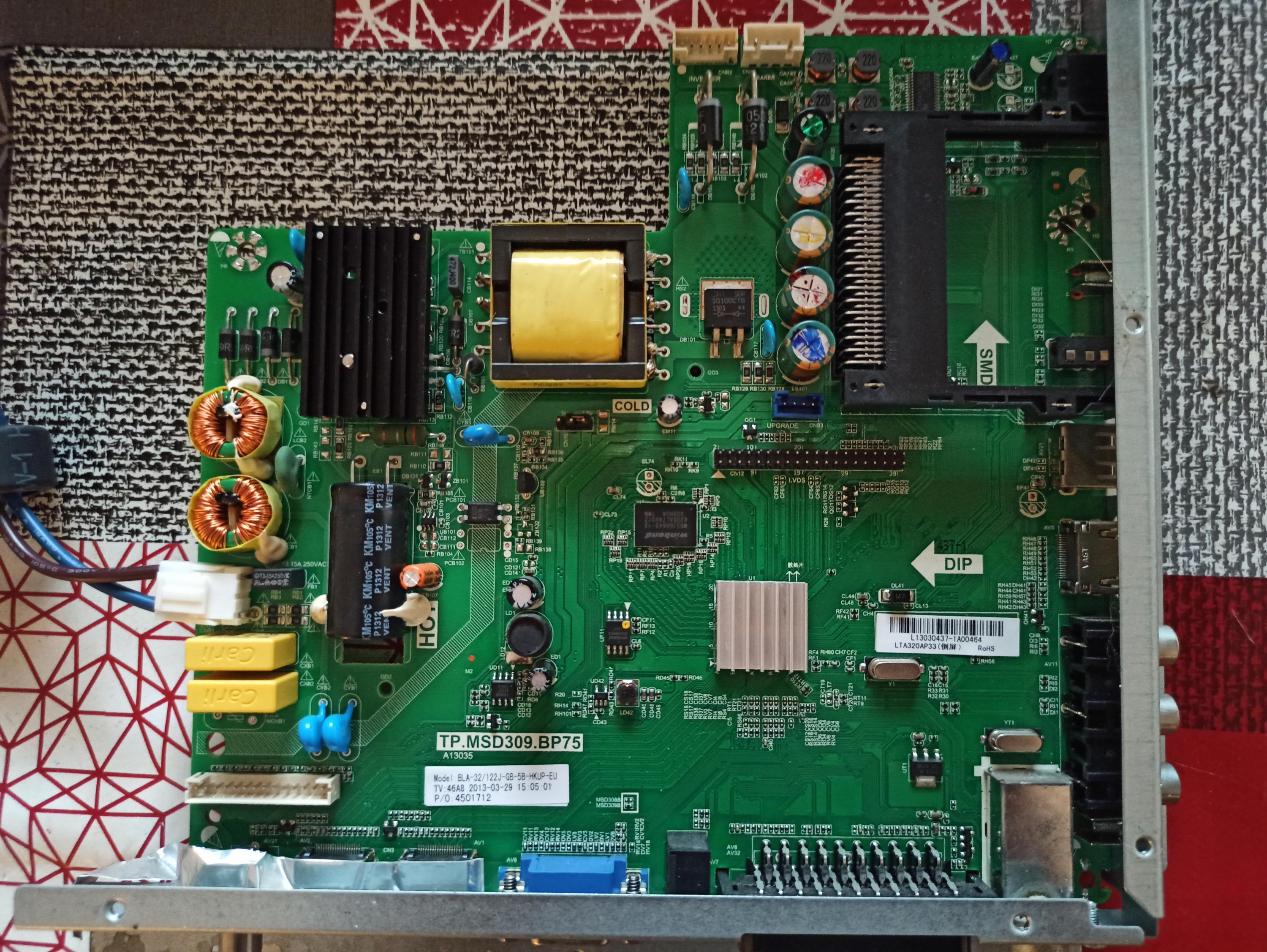

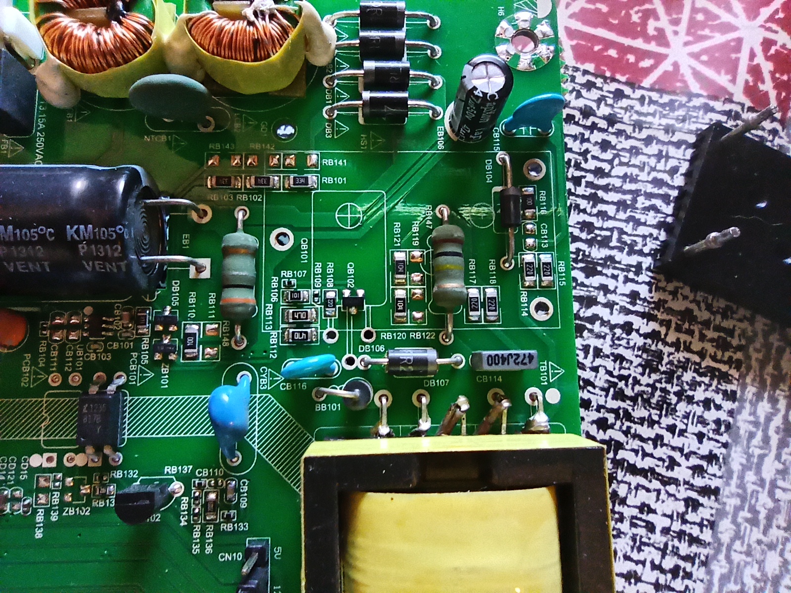

    Hi everyone.
    I have the above mentioned set for repair, and can find any of the power rails.
    Being a beginner, i could use a hand pointing to where i should start looking.
    Searched the web for a schematic, but didnt find one... aparently, there's a bunch of different boards with this number on them.
    Thanks in advance for yout time.
    Only thing i tested was the mosfet under the heatsink with the multimeter for shorts and on/off operation.
    Toni

    What DC voltage do you have when you connect you meter leads to each side of the main capacitor EB1. Be carefull. The voltage can be around 380V dc so do not let the probes slip.
    Have you checked the fuse FB1 alongside the mains in connector?

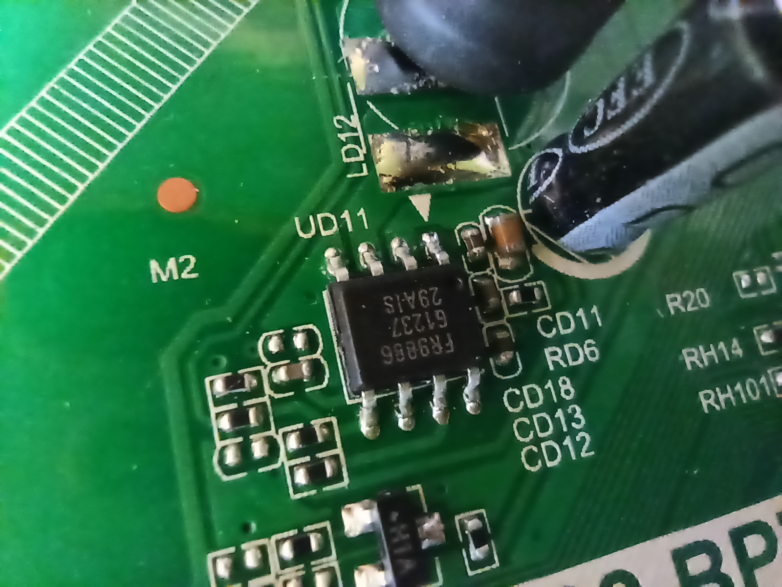

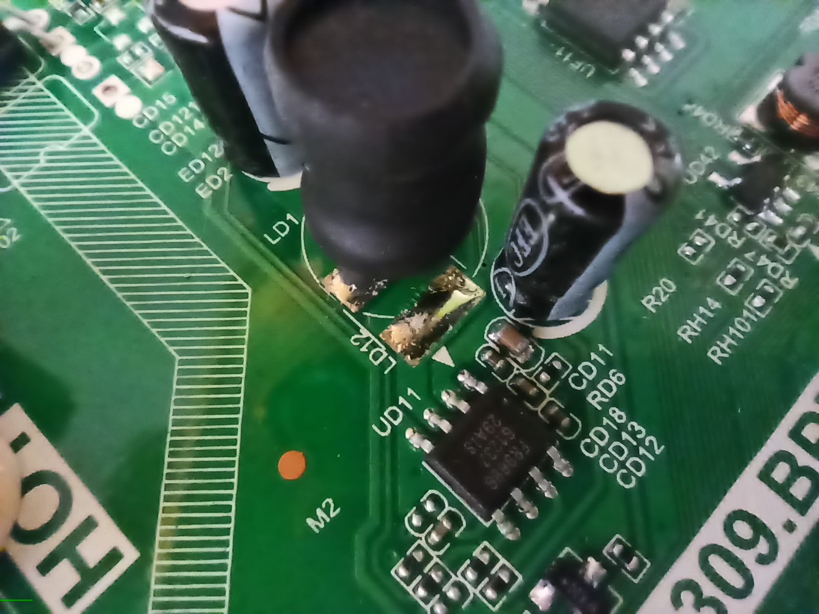

        What dc voltage do you have on UF11 pins1 to 8. Pin 1 is next to the white arrow and the pin numbers increment going anticlockwise around the IC.
        The only information I have found on this board is that the EEPROM UF11 can corrupt.
        • chabregas2k
          • May 2021
          • 24
          • Portugal
          Re: Blaupunkt B32A122T - no power
          1 and 2 vary between 0.2 and 1.2 up and down... 3 to 8 nothing.
          • dick_barton
            • Aug 2015
            • 6643
            • Wales

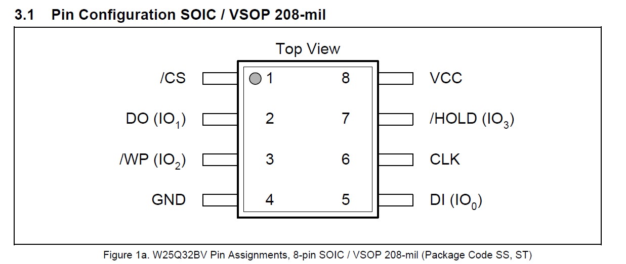

            If UF11 is a W25Q32BV EEPROM then pin 8 is the supply voltage and should be between 2.7V to 3.6V dc
            • chabregas2k
              • May 2021
              • 24
              • Portugal
              If i keep the probe at pin 8... mostly 0, then every 2 seconds or so i get a spike to almost 1v, but instant drop to 0 again.
                If it's not getting the supply voltage then it's not likely to be an EEPROM problem but a supply voltage problem as you initially suggested.

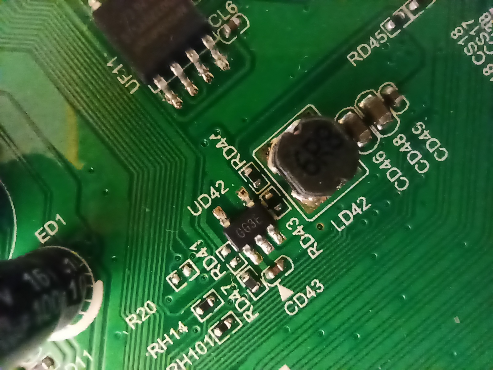

                What is the part number of UD11 & UD42
                Is there a burn mark on the white patch by LD12
                • chabregas2k
                  • May 2021
                  • 24
                  • Portugal
                  UD11 - FR9886
                  UD42 - GG3E
                  cant notice any burn marks
                  Thanks again, barton.

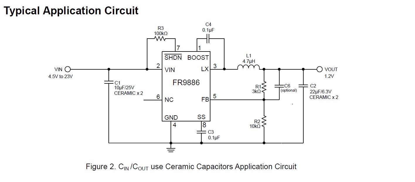

                    What dc voltage do you have on pins 2 and 3 of the FR9886,
                    • chabregas2k
                      • May 2021
                      • 24
                      • Portugal
                      Both oscilating... cant get a fixed reading. input varies between 2 and 5 up and down.. pin 3 i get spikes and 0 like the reading on pin 8 of the flash.

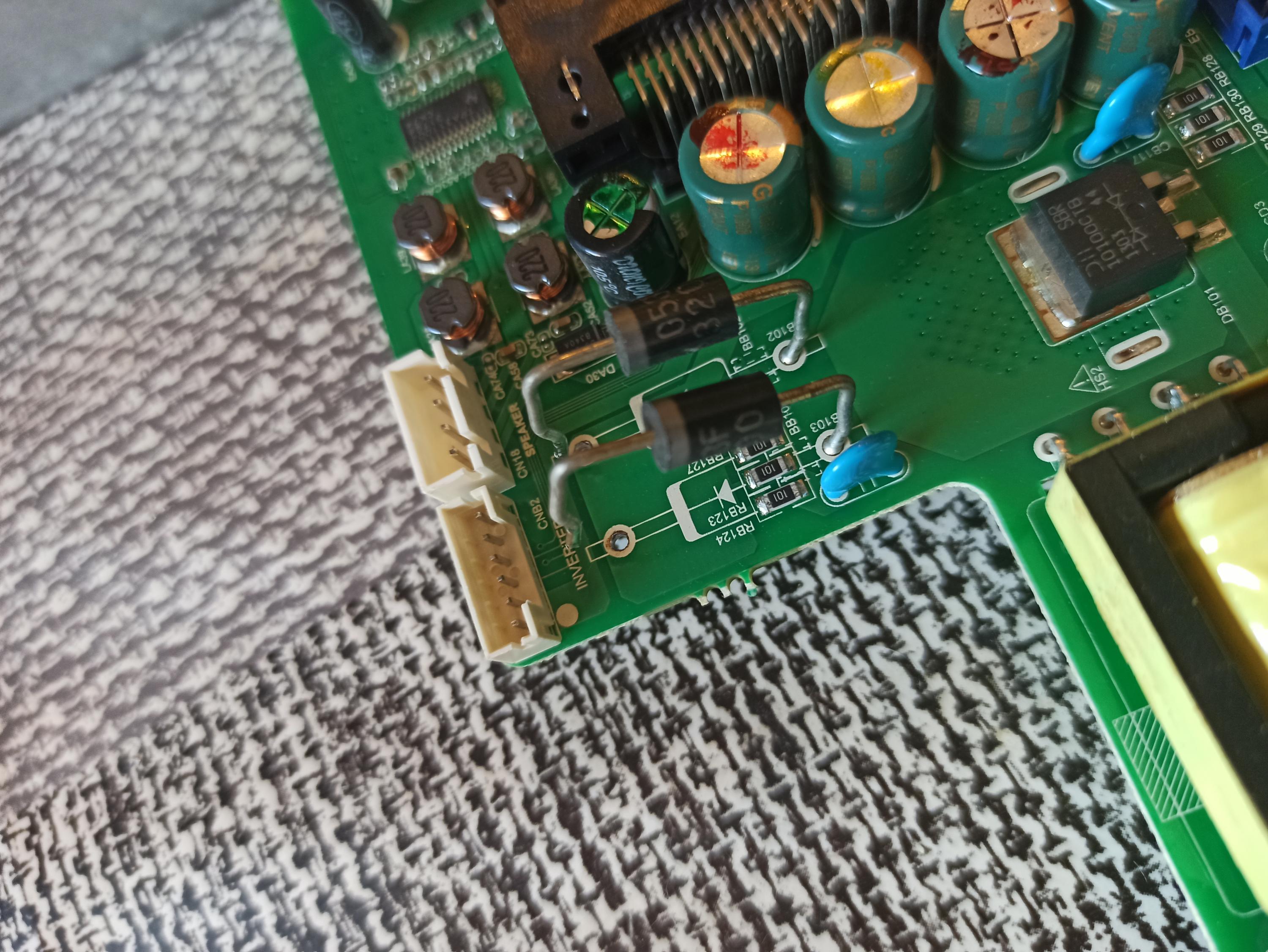

                        With the power to the set switched off can you do a diode test on dual diode D8101
                        Another thread with a similar board gives the voltages as given on the board
                        Are there any voltage points given on your board and if so what are the readings.
                        https://www.badcaps.net/forum/showthread.php?t=42022
                        • chabregas2k
                          • May 2021
                          • 24
                          • Portugal
                          DB101 looks good....

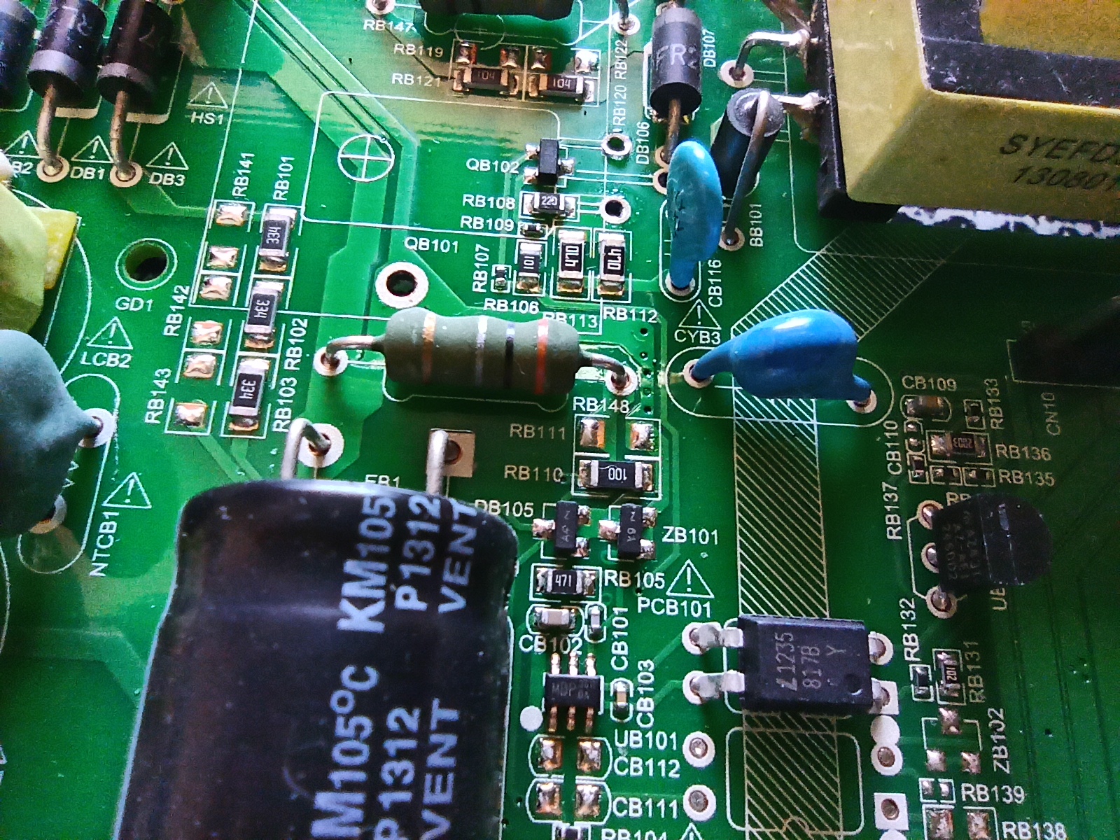

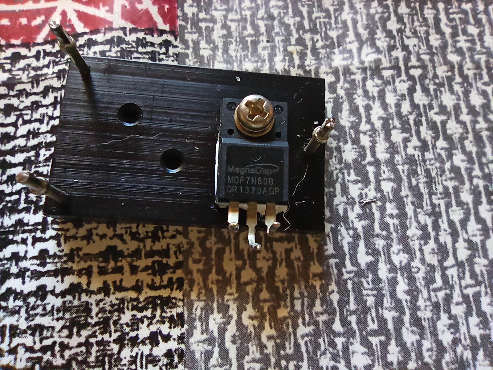

                              What is the resistor value of the one above RB111
                              Can you lift the black heatsink so as to see the components underneath.
                              How did you test the mosfet and what is its part number given on it.
                              • chabregas2k
                                • May 2021
                                • 24
                                • Portugal
                                I tested the mosfet with the multimeter.. the basic open close / charge discharge test.
                                RB148 reads 0.4Ohm
                                Mosfet is MDF7N60B

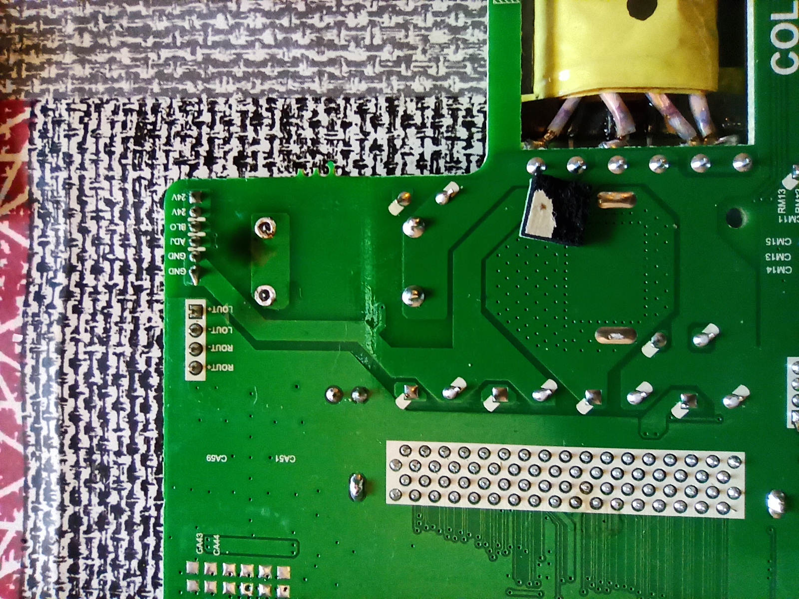

                                When taking the pics for you, i found RB108 to be "funny looking" so i measured it to 8.7kohm (onboard). Should read 22 Ohm am i right??
                                Thanks for all your time once again!
                                • chabregas2k
                                  • May 2021
                                  • 24
                                  • Portugal
                                  The diode on the left, next to the inverter plug, shows continuity both ways, as its twin neighbor reads normal. did i struck oil?
                                  Since theyre working in paralell, for testing purpose, it should work with the shorted on pulled out right? or should i replace before testing?
                                  Last edited by chabregas2k; 06-24-2021, 08:27 AM. Reason: Added back picture and stupid question :)
                                  • dick_barton
                                    • Aug 2015
                                    • 6643
                                    • Wales
                                    If a diode shows continuity both ways (when at least one leg is lifted from the board) then you have struck oil and it is faulty.
                                    • chabregas2k
                                      • May 2021
                                      • 24
                                      • Portugal
                                      Going to put all back together, replace the bugger, and get back to you.
