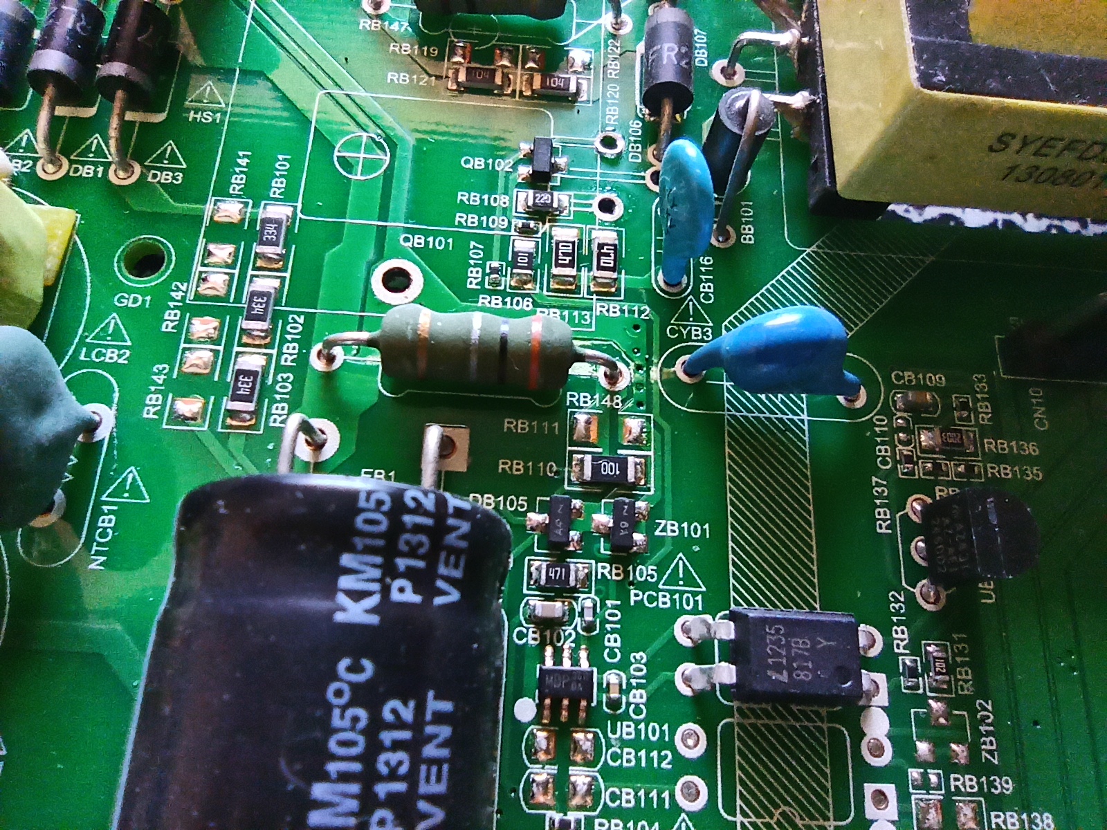

    I tested the mosfet with the multimeter.. the basic open close / charge discharge test.
    RB148 reads 0.4Ohm
    Mosfet is MDF7N60B
    When taking the pics for you, i found RB108 to be "funny looking" so i measured it to 8.7kohm (onboard). Should read 22 Ohm am i right??
    Thanks for all your time once again!
    If RB108 has 223 written on it then it would be 22K ohms. However if it is 222 then it would be 2K2 ohms. Can't quite read what is on the resistor.
    What resistance does RB147 have.

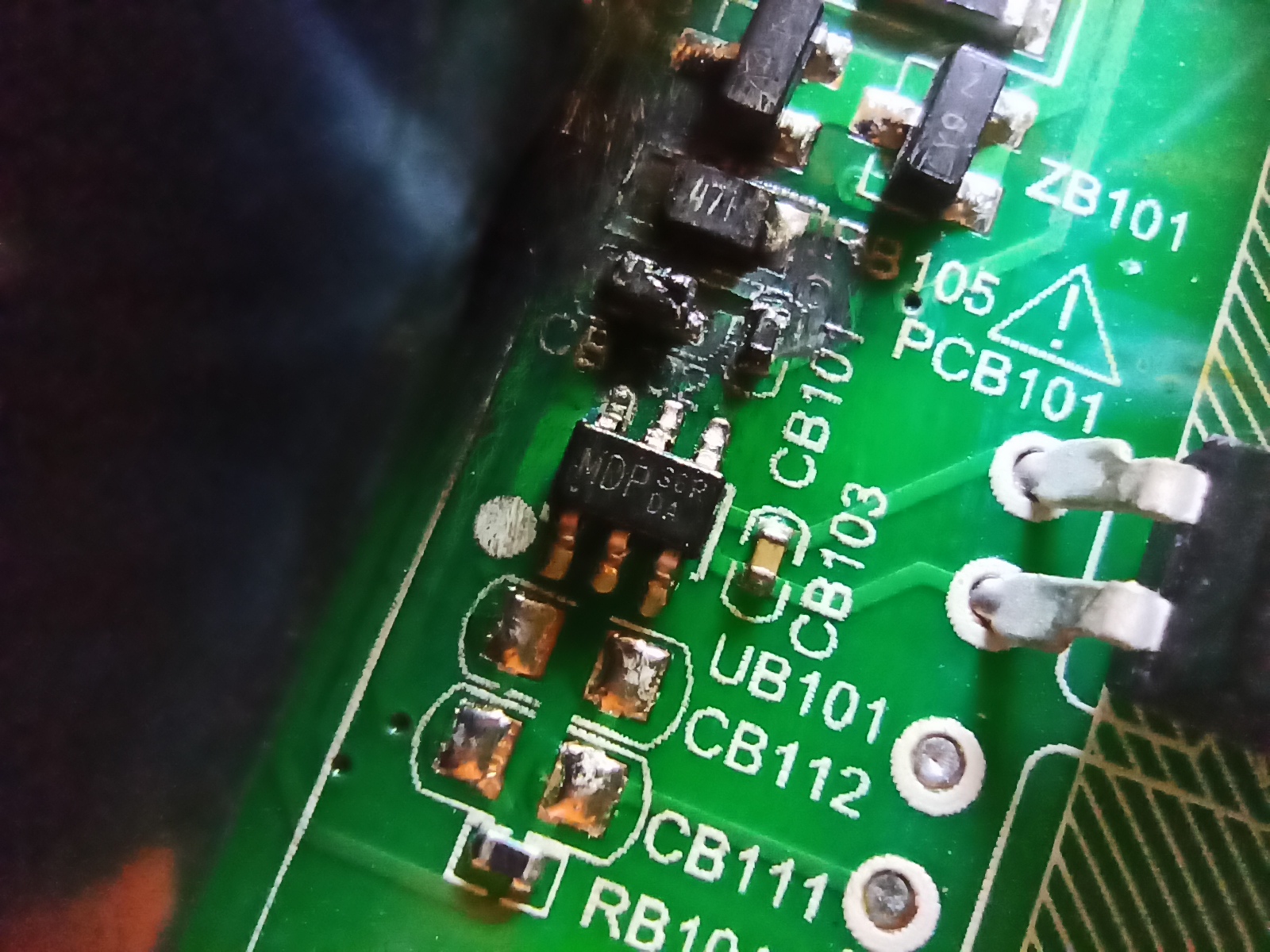

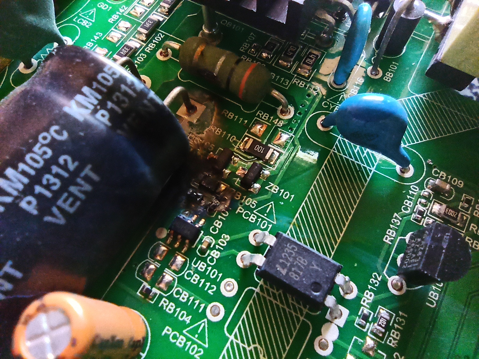

          Heres something new....
          good thing i have a picture of the "before"
          this happened as soon as i flipped the power switch.
            Re: Blaupunkt B32A122T - no power
            CB101 appears to have vapourized. What other component burnt up?
            What is the part number for UB101

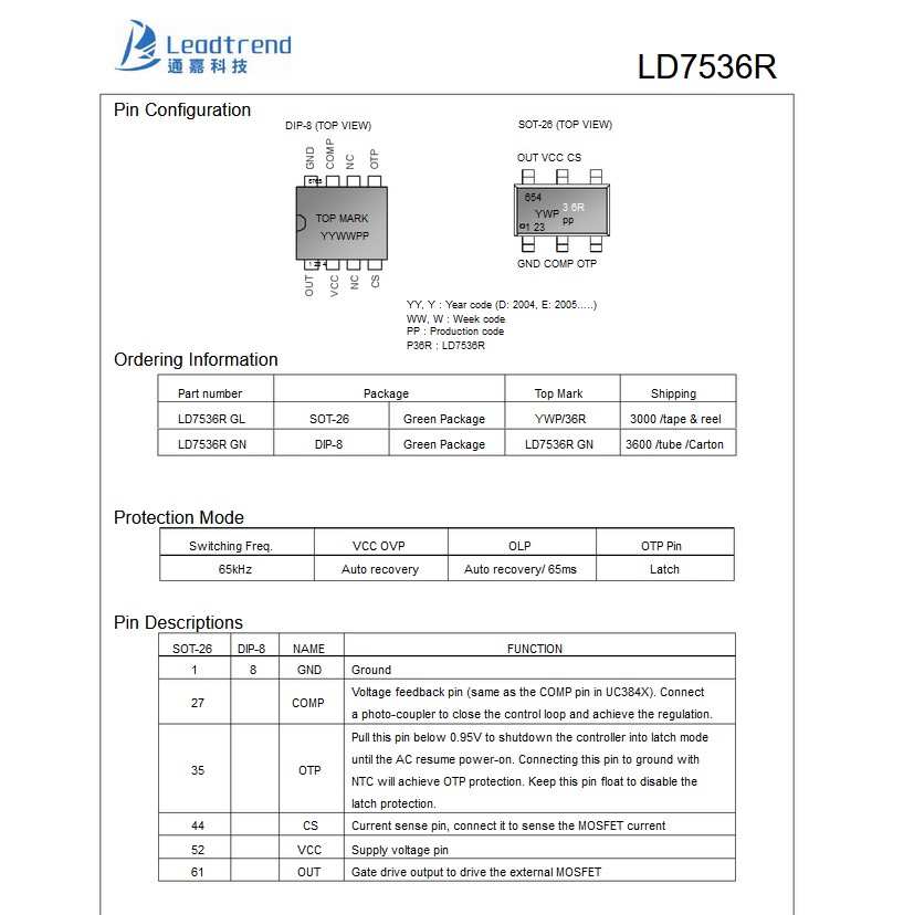

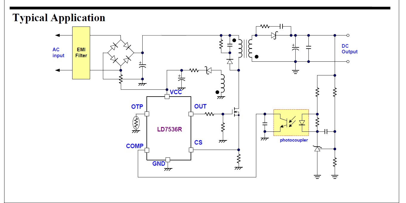

              Mdp 36r da
                The MDP36R looks as though it may be an LD7536RGL which is a PWM controller IC
                I would suspect it has been damaged so I would also check the mosfet to see if it's short circuit.

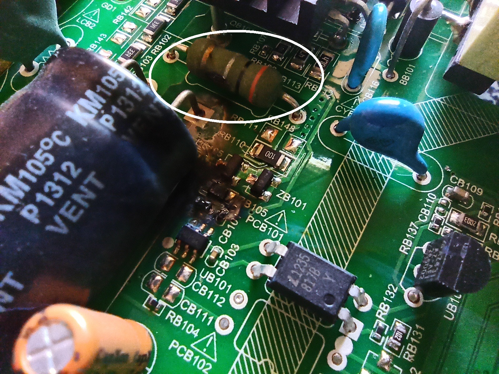

                  I would also check the resistor RB148 circled in white in attached picture as look vaporised in the middle
                    #29

                    Also clean the area up with some alcohol and some cotton buds to remove the carbon debris.
