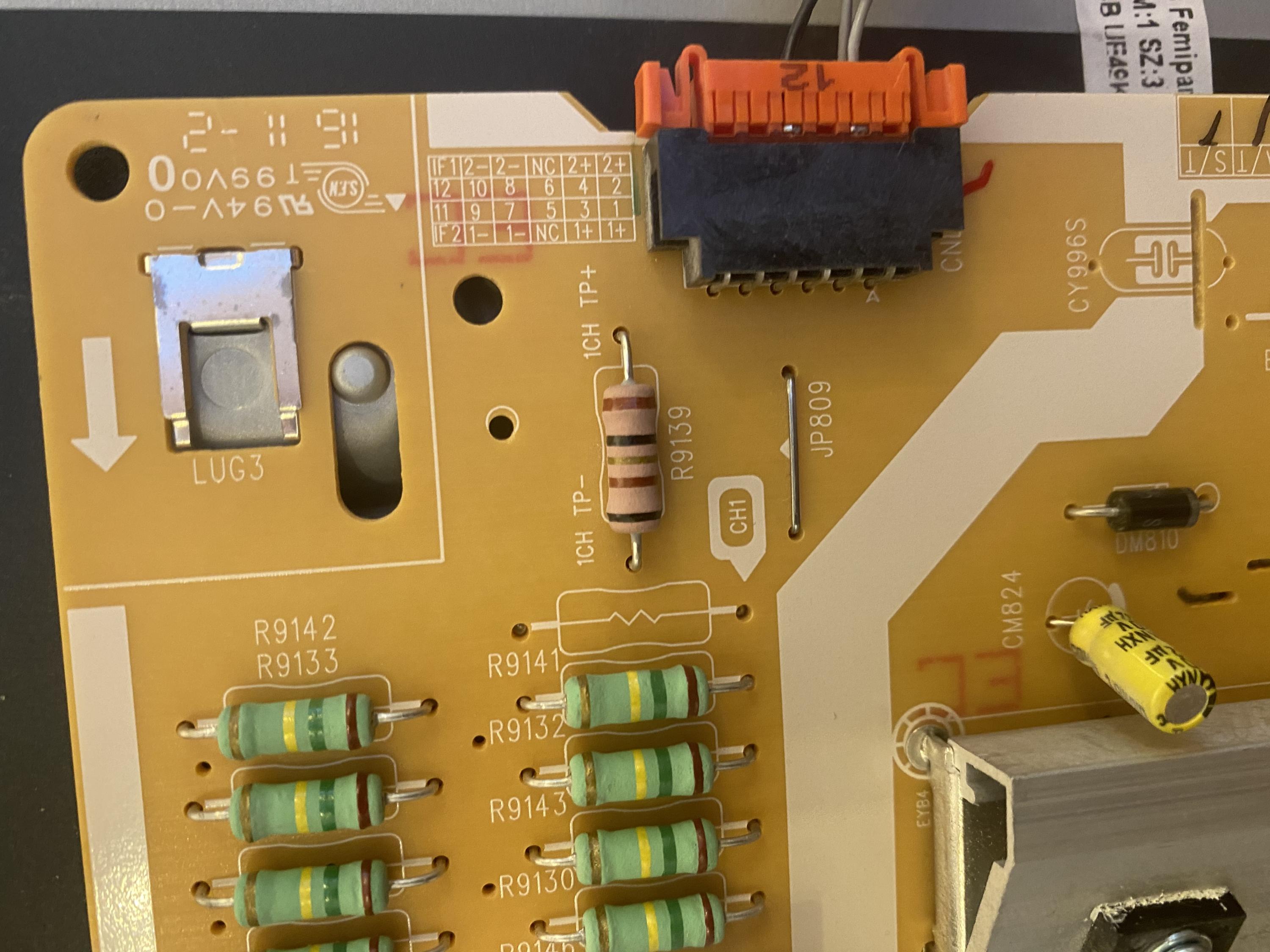

    Hi everyone thanks for accepting me to your forum. I have a problem with the above set, functions perfectly apart from backlights. I've tested them with LED tester and both sets light up ok in fact with the tester connected the TV is perfectly watchable. When connected to the BN44-0876A supply they don't illuminate, I've removed the connection to the main board which I believe should have brought them on as well but nothing. Is it possible for the fault sensing in the power supply to pick something up in the LEDs which the tester isn't showing or is it more likely to be a fault in the PSU?

      Light spread looks ok no dark spots (it's edge lit) I'm showing 72 volts on each array (there's 2). Refering to the picture I'm measuring with LEDs connected:
      Pin 3 1+ 365v
      Pin 7 1- 296v
      Pin 4 2+ 296v
      Pin 8 2- 227v
      All measurements to case.

                Supply voltage to LEDs looks OK.
                There is a mosfet that controls current through LEDs.
                It's drain should be connected to pin 8 of connector.
                Check the voltages on that mosfet pins.
                And obviously inspect PCB for solder joint cracks, check transistors and diodes with multimeter.

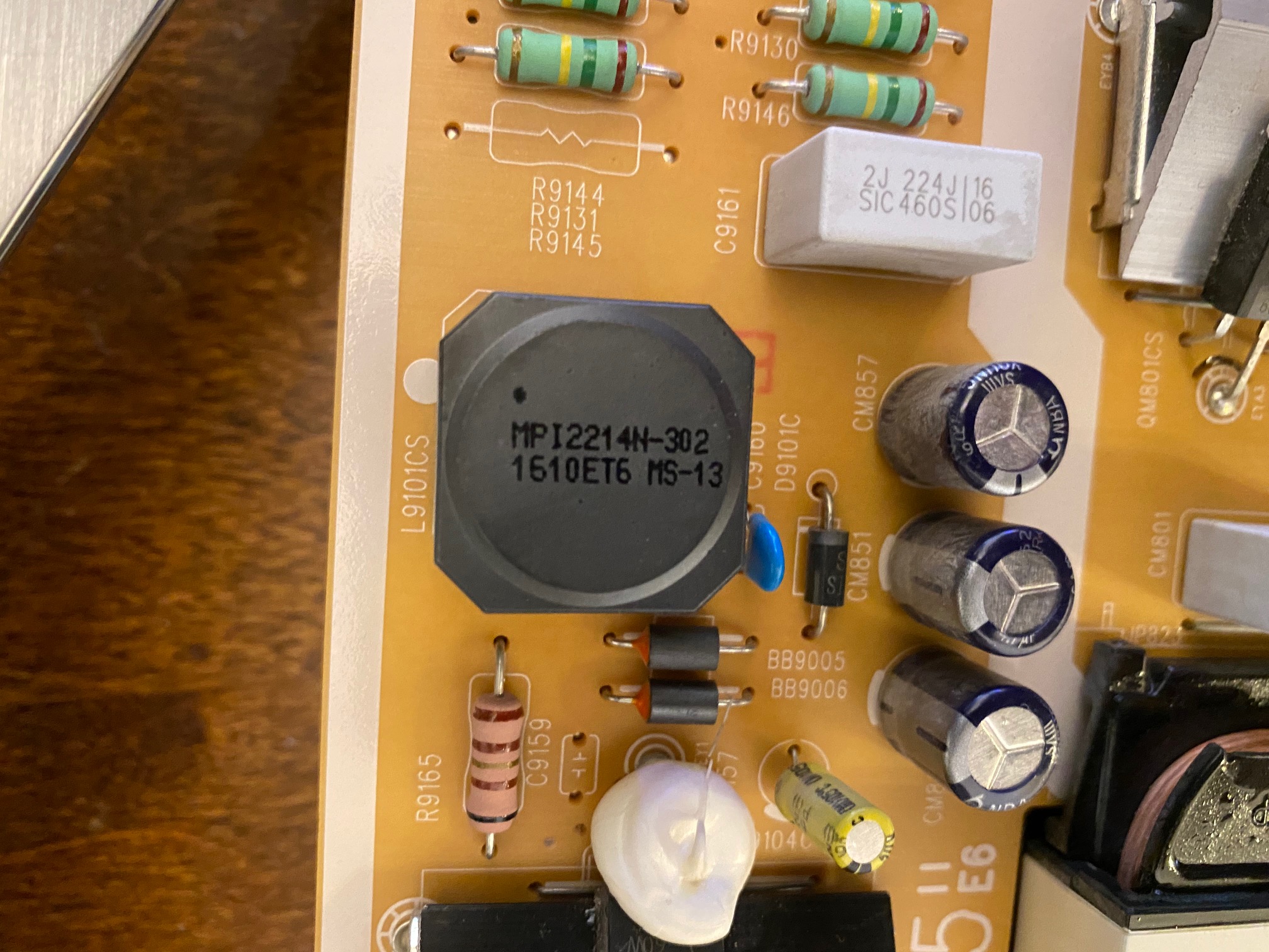

                    All looks ok apart from what looks like a choke/coil inductor which is open circuit L9101CS?
                      Re: Samsung 49KU6400U backlight
                      Run some fresh solder on the inductor pads and test again. L is generally a prefix for an inductor.

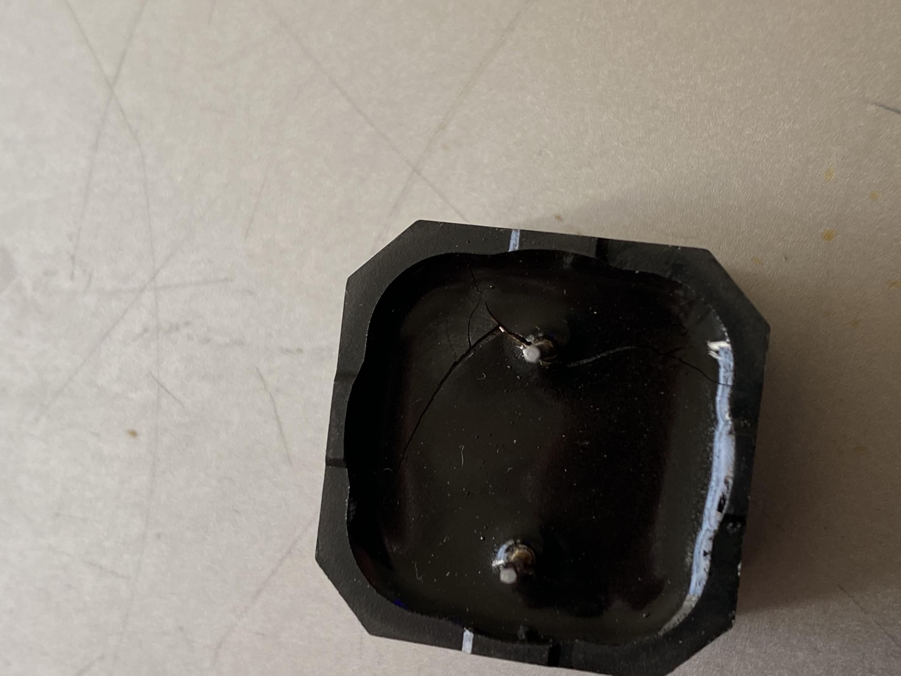

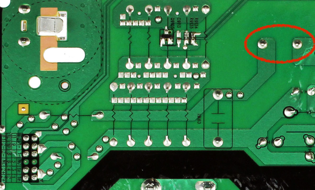

                        Took it out still o/c but big crack in the base looks like we may have the culprit, anyone know of an equivalent because the number doesn't bring up many results
                          I found this part reported bad in other forums, so it seems to be typical failure.
                          And I found datasheet too:
                          http://www.mu-sem.com/bbs/download.p...&wr_id=14&no=0
                          3mH is quite high value for inductor.
                          You can search replacement by inductance and other specs in the datasheet.
                          Or if you have a meter with inductance measurement, you can try some parts from scrap boards like transformers, common mode chokes. And you can connect windings in series to get the right inductance. It doesn't need to be precise, can be 20-30% off, usually slightly more is better.
                          Good luck!
