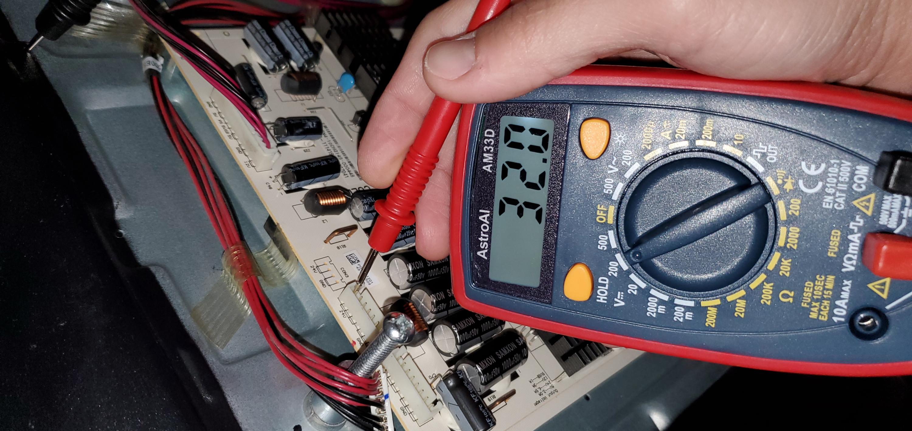

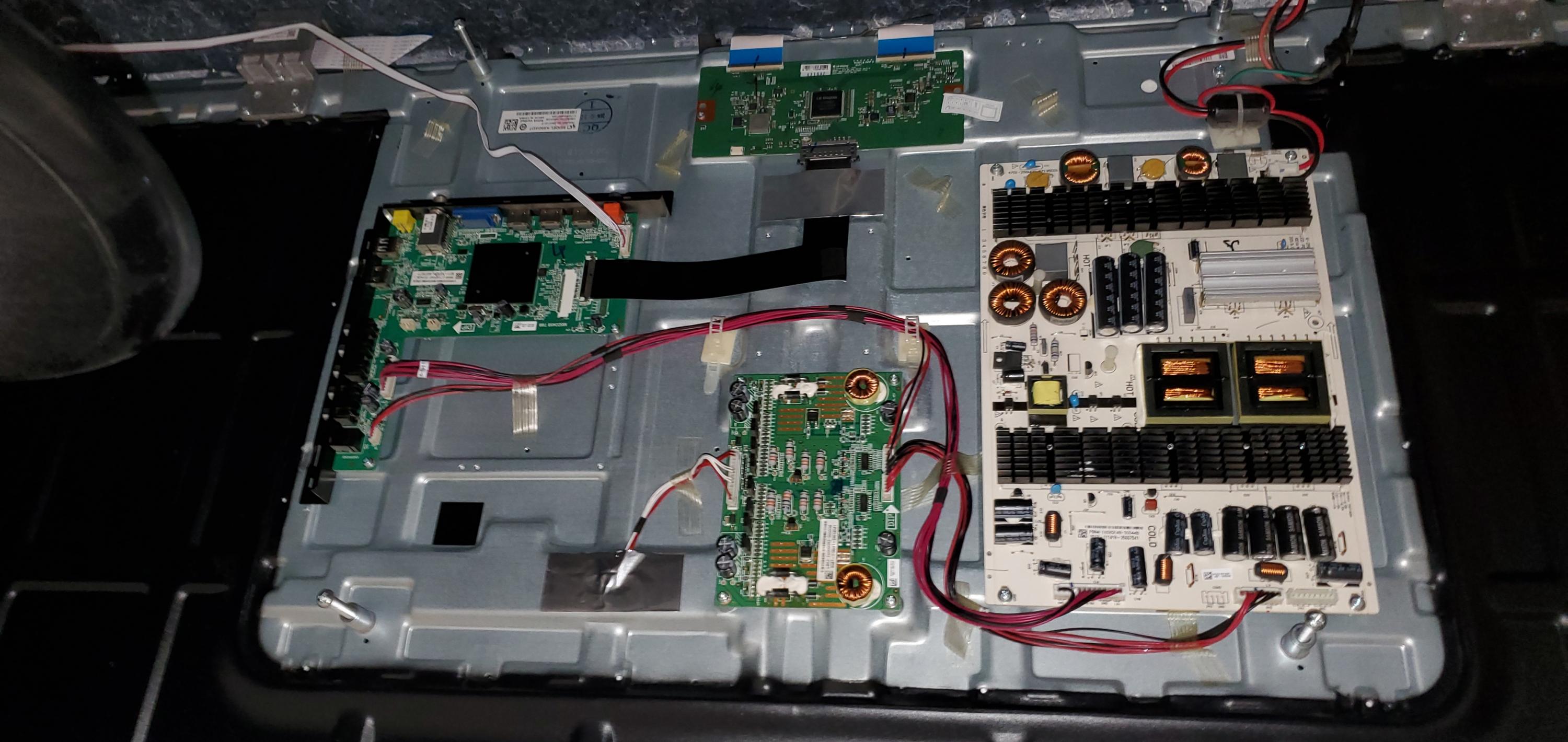

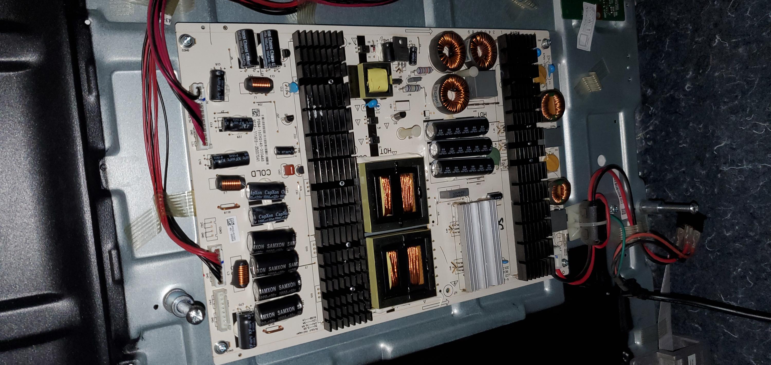

    65" W Box TV half backlight problem
    I have a 65" W Box TV, model 0E-65LED4K that most of the times it is turned on, the right half of the backlights flash on and off in a split second and remain off while the other half lights up and stays on just fine. I thought it would be the LEDs, so I checked all of them and they're all good, no direct problem with any of the LEDs or any of the connections. One thing I noticed was that when I disconnected one of the LED strips from the left side (the working side) the backlights now switched and the half left side flashed and stayed off while the right side lit up and stayed on. I then checked the voltages on the circuit boards. The only thing that stood out was that on the power supply board I was reading 32v on each of four pins that connect to the LED driver that is supposed to be 24v each. I disconnected to check if it was the LED driver board that was drawing that power or if it was the power supply, and it's the power supply. Do you think that this could cause the LED driver board to kill the power on half of the backlights to avoid frying them? What should I do next? I attached a few pictures. Thank you.
