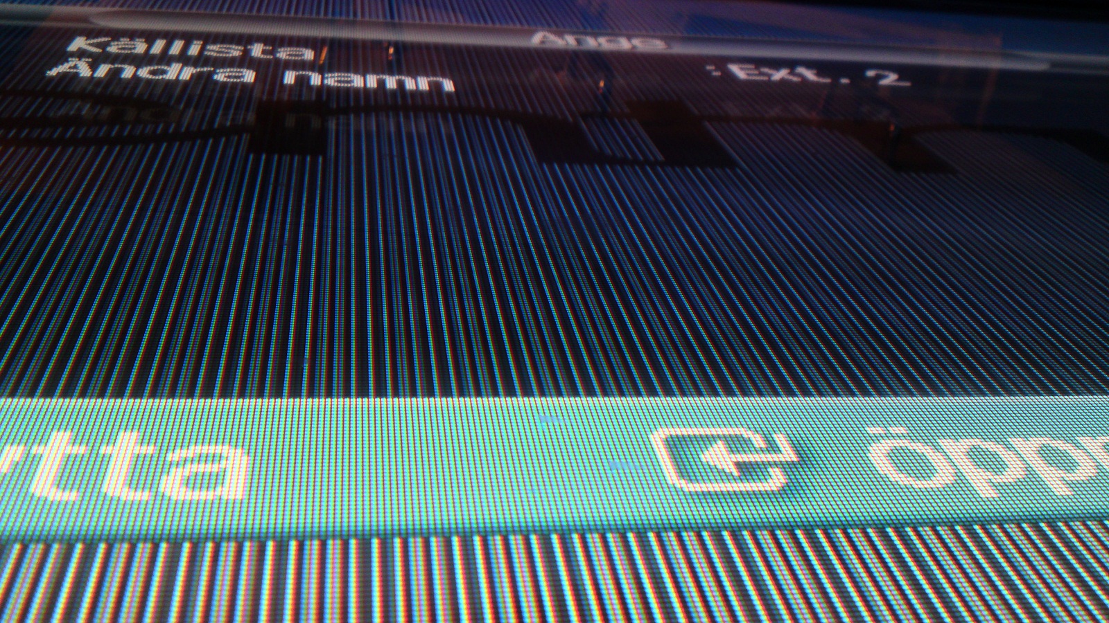

    The entire screen has vertical lines from top of the screen, all the way to the bottom which is not lit (one pixel wide). In each inch of the screen there are 4-5 lines which is off. The pattern repeats itself through the entire screen.
    BUT, the menu and all OSD information is displayed correctly, which means all the final output and multiplexing is working correctly, otherwise also the menu and osd would have these vertical lines. Also, the smps must be ok.
    In other words, all these dark vertical lines is lit ok through the menu/osd.
    Unfortunately, this could indicate a problem with the video scaler or other video processing circuit on the logic board. There are two processors which is named "ASI501" which is a BGA, in other words very hard to replace. The other is a FL12310 which is possible to replace.
    I may start with this and I hope I managed to explain the problem good enough.

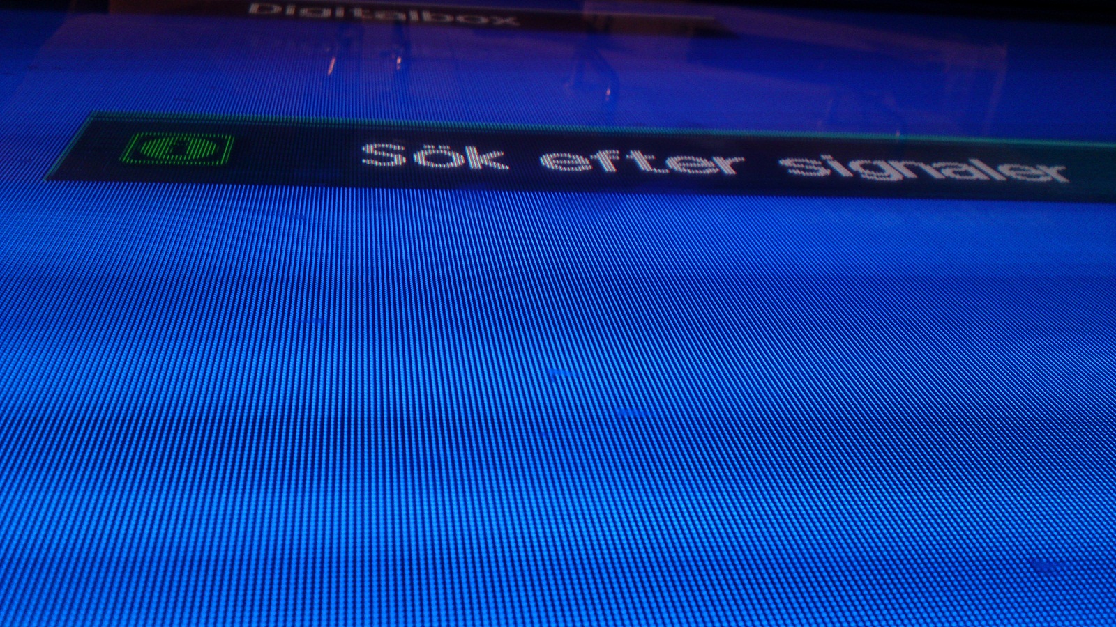

                      Re: Samsung plasma TV PS-42V4S repair
                      I try to include two attachments with photos of the screen. It's possible to see the vertical lines in the picture, while the menu and osd graphics is not having the problem. This must mean that all screen drive electronics is ok.
                      The other picture shows that all lines is ok during "blue screen" when no video source is connected.
                      So, why does the video picture have the vertical lines problem, and the menu graphics does not?
                        You just diagnosed it.
                        Panel itself is fine, and parts of the mainboard functions. But other parts on the same mainboard failed. Replace the mainboard. Not the logic board.
                        Menu/text is fed from different chipset via different source to the main chipset that handles the LVDS output to the logic board is functional but other signal that is feeding to that chipset from analog to digital converter failed. Have you tested with HDMI input?
                        Cheers, Wizard

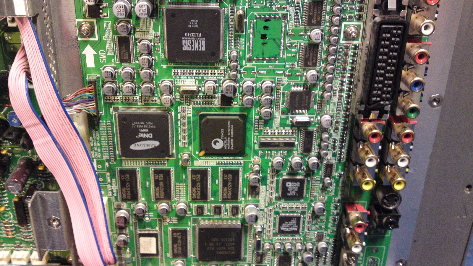

                          Wizard, is this the main board? (check attachment)
                          I actually spoke with a local Samsung repair department, and they told me no parts are available anymore. But, I can buy some of the IC's and change.
                          I'll have a look in our microscope at work to check for soldering problems with big IC's or bus resistors.
                          Maybe you know which IC's handle the video signal and could possibly give such a problem? I didn't check with HDMI, since I've no such source.
                                Hard to say. Best to replace whole mainboard. Try to get one used. Otherwise new LCD TV.
