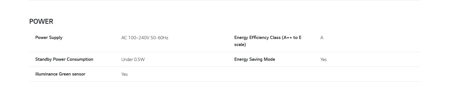

    LG's website standby info for the OLED55B8PLA, 55'' LG OLED TV - B8 attached.
    If it's 24W in standby I would double check the power meter you are using to measure it to ensure it's not a false reading. Nowhere near LG's figure for standby power.

      as mentioned by dick, yours measurements had error. it could be 0.24 LOL
