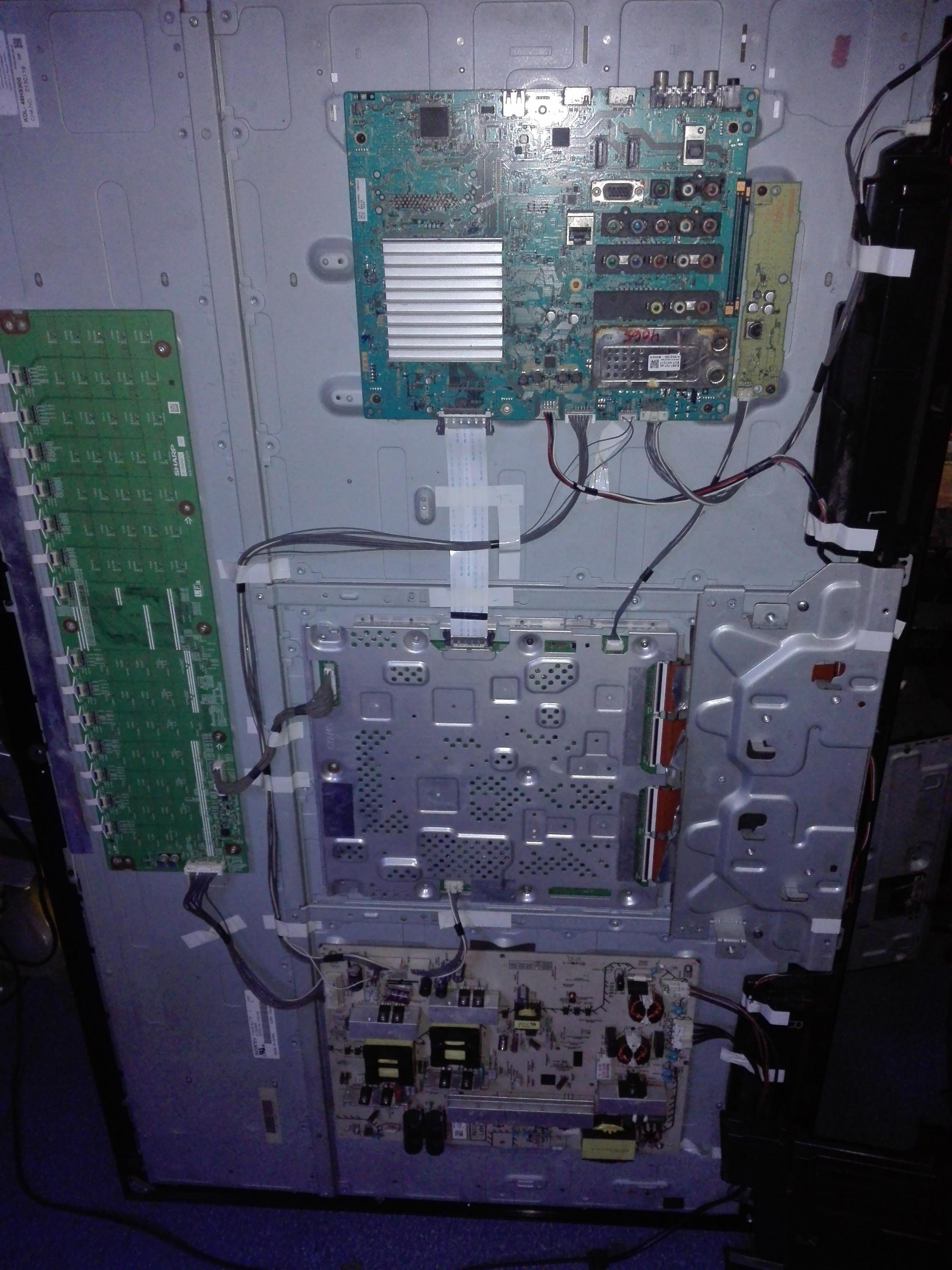

    Sony KDL 46HX900 with sharp led driverwill power on and work for some seconds then shutdown and blink for 6 times. I ckecked the the back light all is working fine. Am asking if there a way one can remove protection on this kind of led driver? I attaced thepicture of tv

    Try to disconnect 4 the panel loop from the t-con board

      Your TV is indicating it has bad backlights and they are likely failing under load. You can try turning down the backlight level and see if they stay on.
        Re: Sony KDL 46HX900
        How did you check each LED backlights strings? There are many LED strings on that panel based on many LED connectors on the driver board.

          I opend the panel to the backlight , and i can see All lighting . But after some few seconds it will shutdown . If i power it again the samething. So that is why i said led.strips are good . Though some may light like this.and still fail

                Replace backlights.
                4 and 6 blinks is backlight error codes
