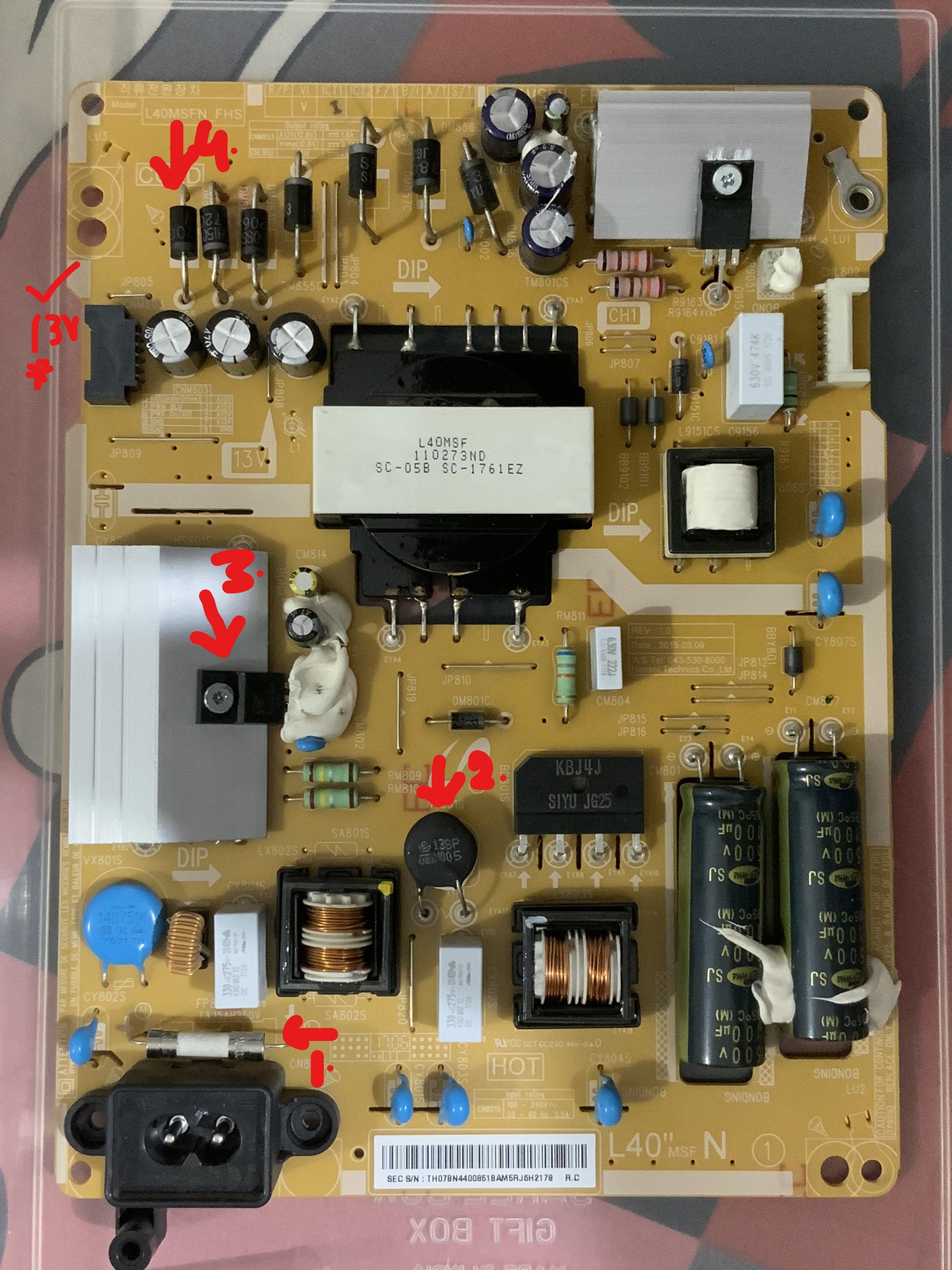

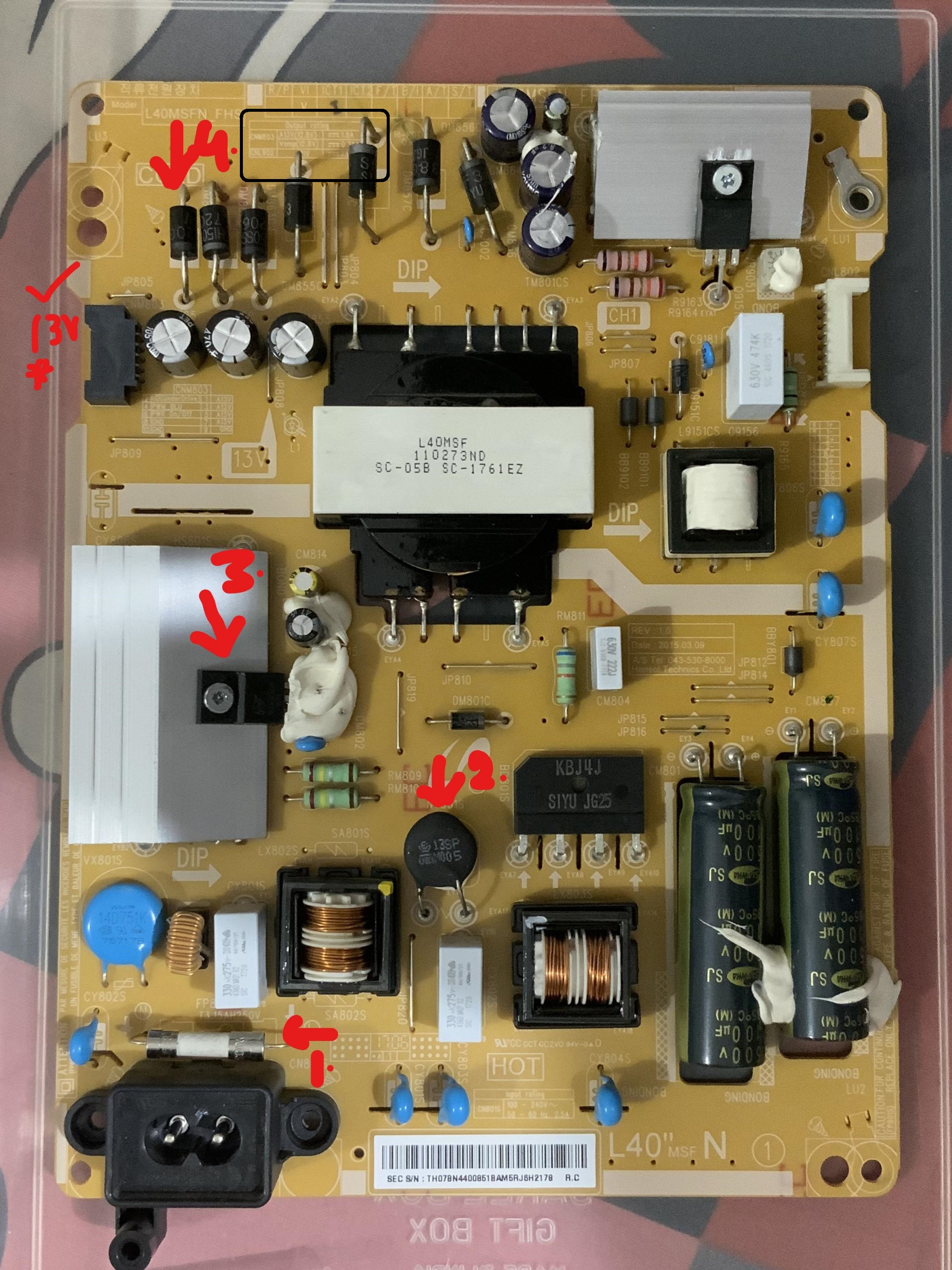

    Diagnostic Steps taken by me :
    I opened the TV after watching several YouTube videos for common faults with LCD/LED Tv's and how to fix them.
    1.I checked voltages in the Hot section till high voltage capacitors and the voltages are between 325 to 345volts DC after bridge rectifier.
    Fuse was okay too.

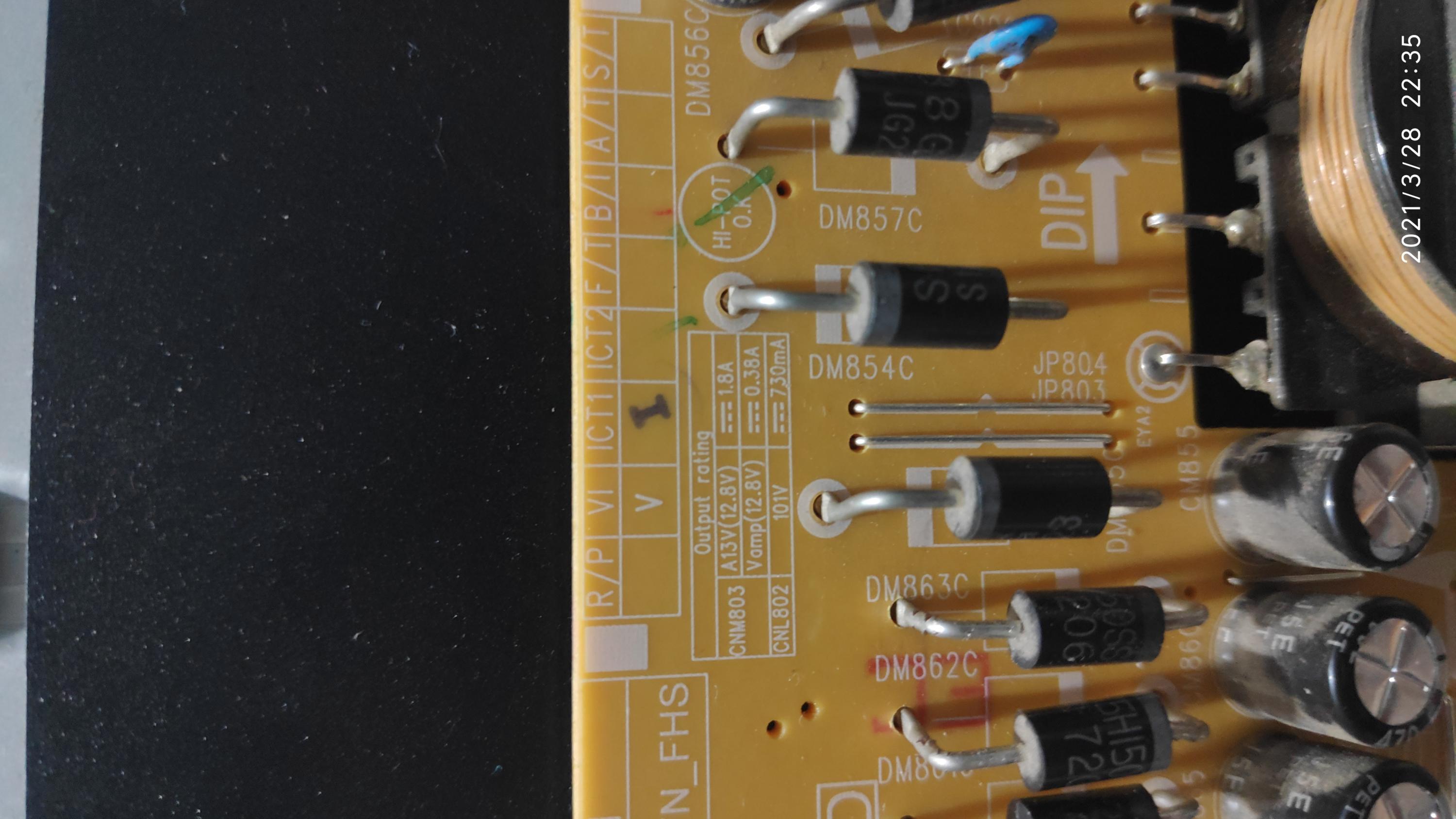

    However the secondary side (Cold side) one schottky Diode was found shorted .( I thought I found the common fault and could fix easily)
    While proceeding with multimeter checks, I might have shorted the board somewhere , then the fuse went out.
    2.I misread the fuse number and replaced with 10 amps normal fuse as opposed to 3.15 amps ceramic one (its not easy to find components in India ,even with full specs) ,next when plugged in AC mains , the thermistor blew up.
    I was scared but not done yet.
    3.I increased my knowledge about the primary circuit and learned function of each and every component .
    Finally I found the MOSFET to be shorted on primary side .
    I searched for proper components in local market as per original component data sheets ,then replaced equivalent values Fuse ,MOSFET & Thermistor on primary side & schottky diode on secondary side.(image 1 -InkedSamsung PSU1 attached)

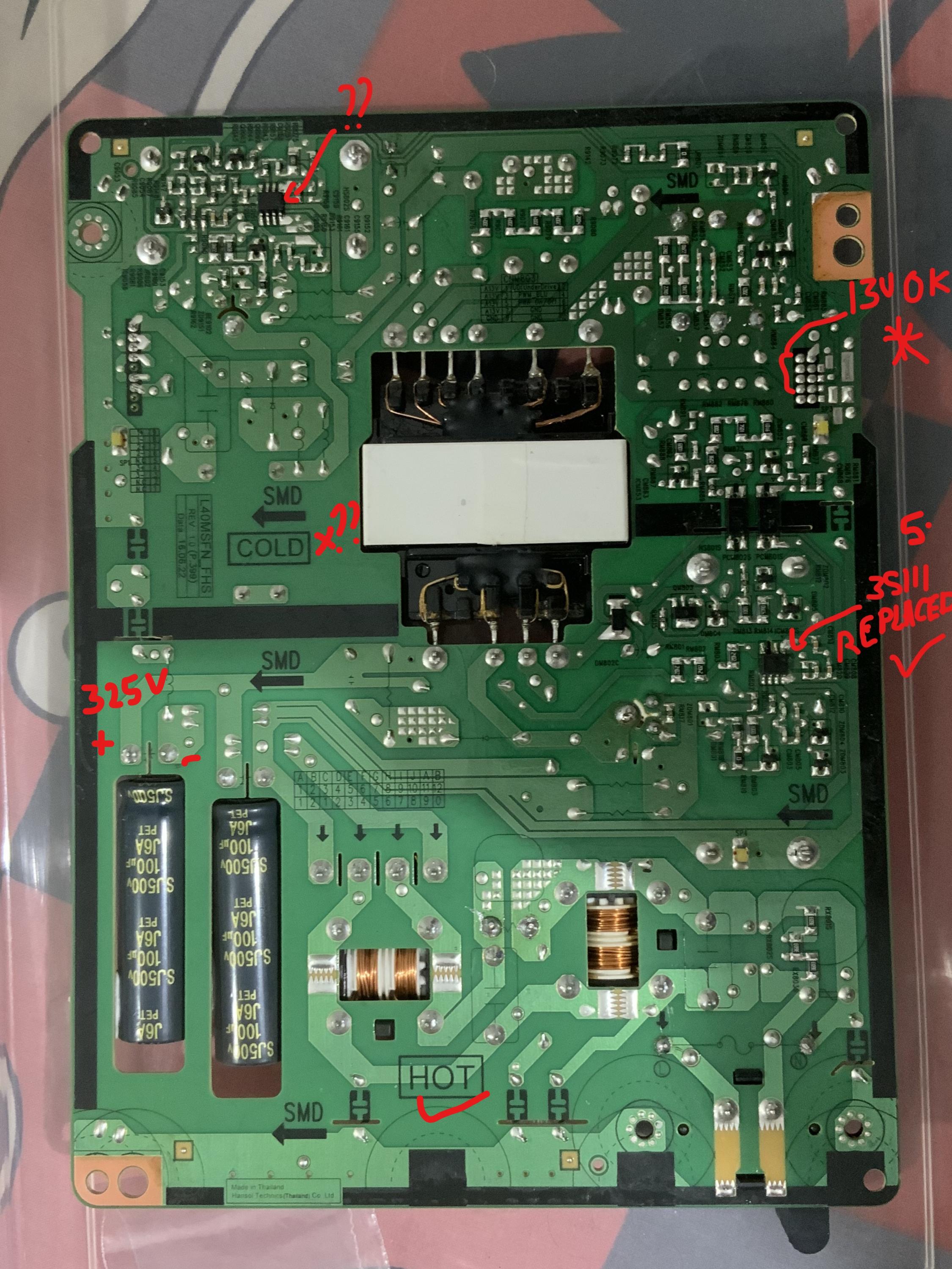

    4.Once Again the voltages were reaching the capacitors but not beyond .
    I suspected the PWN IC to be bad which switches the MOSFET on/off to start the main transformer ,After searching more on internet ,I found a post which explained how to check PWM IC 3S111 and found the PWM IC was the issue and replaced with original(Image 2-InkedSamsung PSU2) and yes I was able to bring the TV back to life .
    Partial problem solved :The Standby came on , sound came on , image came on BUT NO backlight.

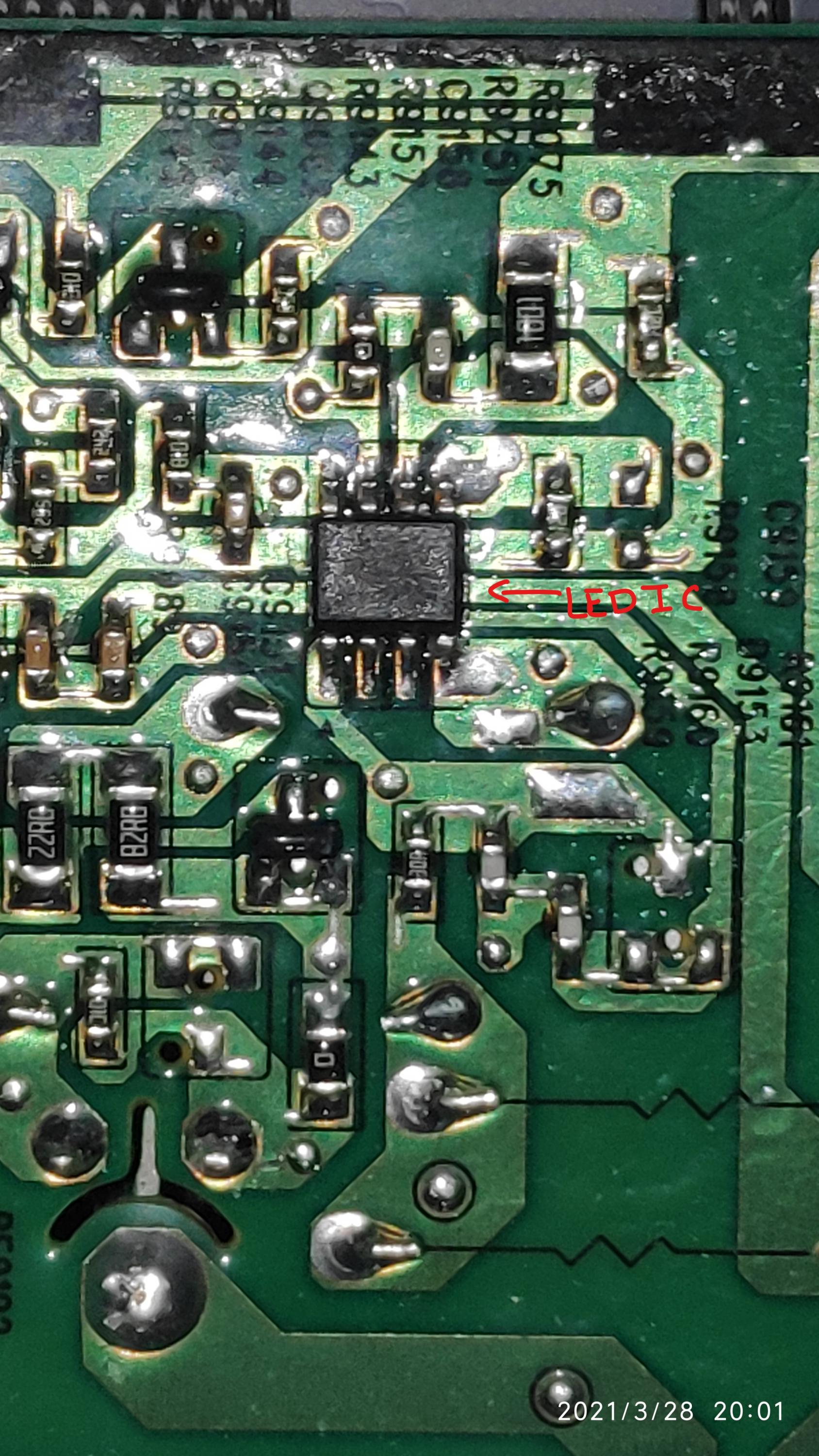

    5.I once again searched internet and then opened by full TV to check the LED strips to my surprise each LED checked individually was lighting up, since i didn't have bench power supply to check full strips .(Dis-Assembling & Assembling TV took 6 pain full hours)
    Plugged again in AC main the TV still runs with image & sound but no backlight.
    Help required :Now I think the LED driver IC maybe at fault but again i have no schematics as there is nothing written on the chip ,no matter what magnification level I use, its blank.(Image 3-InkedSamsung PSU3 attached)
    I have checked the MOSFET for LED circuit ,that is not shorted but When after switching off the TV ,I put Multimeter red probe to "Drain" and "black probe" to "Gate" terminals the LED strips light up for a short time. That proves its working.
    Additionally I have also checked that it's not the main board at fault ,but PSW itself(Check method -Switch on TV with everything plugged in ,then disconnect the main board cable, if led lights up the issue with main board , if not PSU fault ).
    Fault code :Now after switching on tv, Standby LED blinks 3 times,Sound okay ,image okay
    Any help next steps will be highly appreciated.
    Let me know if you need specific voltage checks at connectors , I can capture an send.
    Thank you in advance

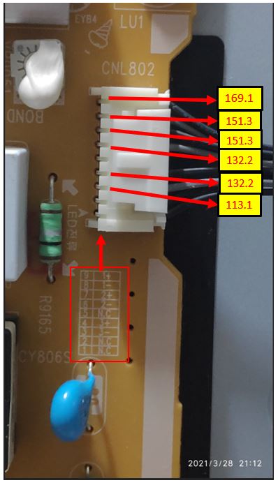

          Re: Samsung 40 inch TV -Uncommon Backlight issue.
          Hi Capleaker & Alfatv;
          Thank you for your quick response .
          The LED connector voltages captured at each pin are attached in the image .
          The TV was switched on with all connectors connected .
          Sorry But How do we check PFC?Is there any circuit /component I need to check .Apologies ,I only has basic knowledge of electronics .

            Backlight is not turning on, as explained in the post earlier and I have just attached all led connector voltages above after tv is switched on.

              If I read post #1 correctly the problem is no backlight.
              If you disconnect the main board and power on the TV do the backlights come on or flash.
              Can you post a photo of what is in the black box, image attached
              You can test the led voltage similar to the Shopjimmy video https://www.youtube.com/watch?v=uIrlbsbiltY

                      Individually checked leds is not the same as when full current of 100's of mA's is flowing through them.
                      Do a check as in the video given.
                      What is written in that box. Photo would be usefull.
                      Another point is that any poor connection in the backlight circuit would also cause the backlights to not come on even though the leds themselves are good.

                        No , they dont flash or come on , thats the issue ,if it either did any of those then it would have been the main board issue. The Samsung technician also said that main board is okay , its the PSU.
                        and yes the that black box does say LED connector voltages to be 101 v. Image attached

                              Thank you for the picture. Post #12 shows a legend indicating that the led voltage should be 101V and you show the voltage to be considerably higher in post #5 which normally indicates you have a led(s) problem or a problem with one of the connections/connector in the led array.

                                Thank you ,okay , I will check the full strip & connector again but Sorry which video link I should refer to ? Also I don't have Led strip checking equipment, What voltage should I be providing to check the strips individually or collectively?
                                This TV has 3 strips of 7 LED's each.

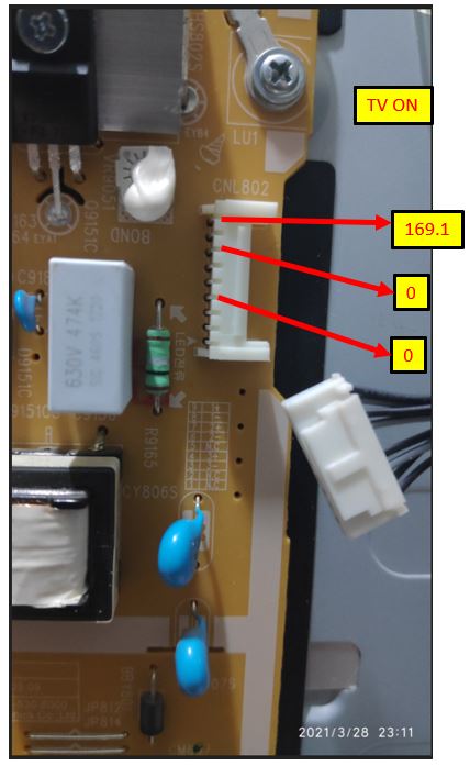

                                      @dick_barton ,Thanks for the video,I did follow this video, but when I disconnected the LED connector ,while TV is turned on and checked the voltage , I get 168.2 to 171v at top pin only and rest all the positive pins as per legend are zero?
                                      As per video for PSU to be okay , it should show the normal voltages at each pin.
                                      Does this mean the PSU is bad somewhere ?
                                      I will check the LED strips again and feedback.
                                        How many leds strips and how many leds on each strip are there in the panel?
                                        Led connector Pins 4 and Pin 6 connected together
                                        Led connector Pins 7 and Pin 8 connected together
                                        Led strip 1 connected between Pin 8 & 9
                                        Led strip 2 connected between Pin 6 & 7
                                        Led strip 3 connected between Pin 3 & 4
                                        Pins 1, 2 & 5 not connected
