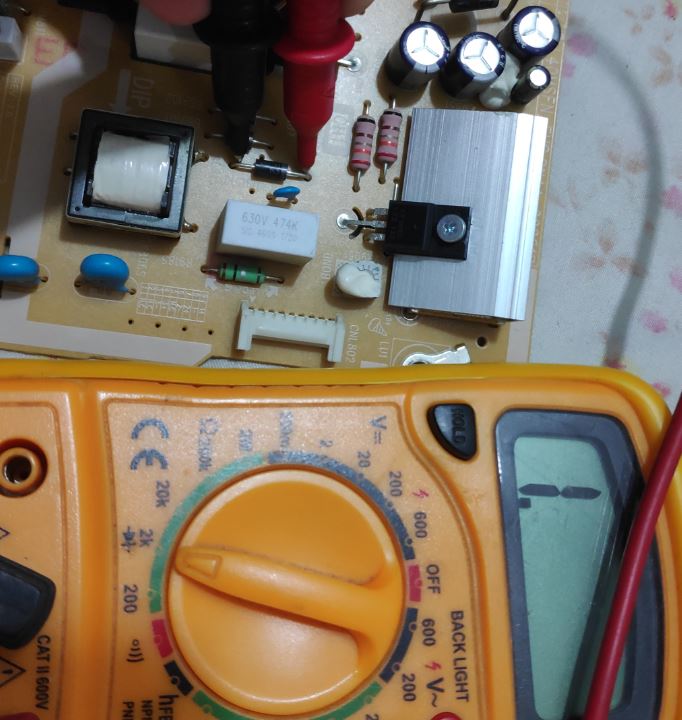

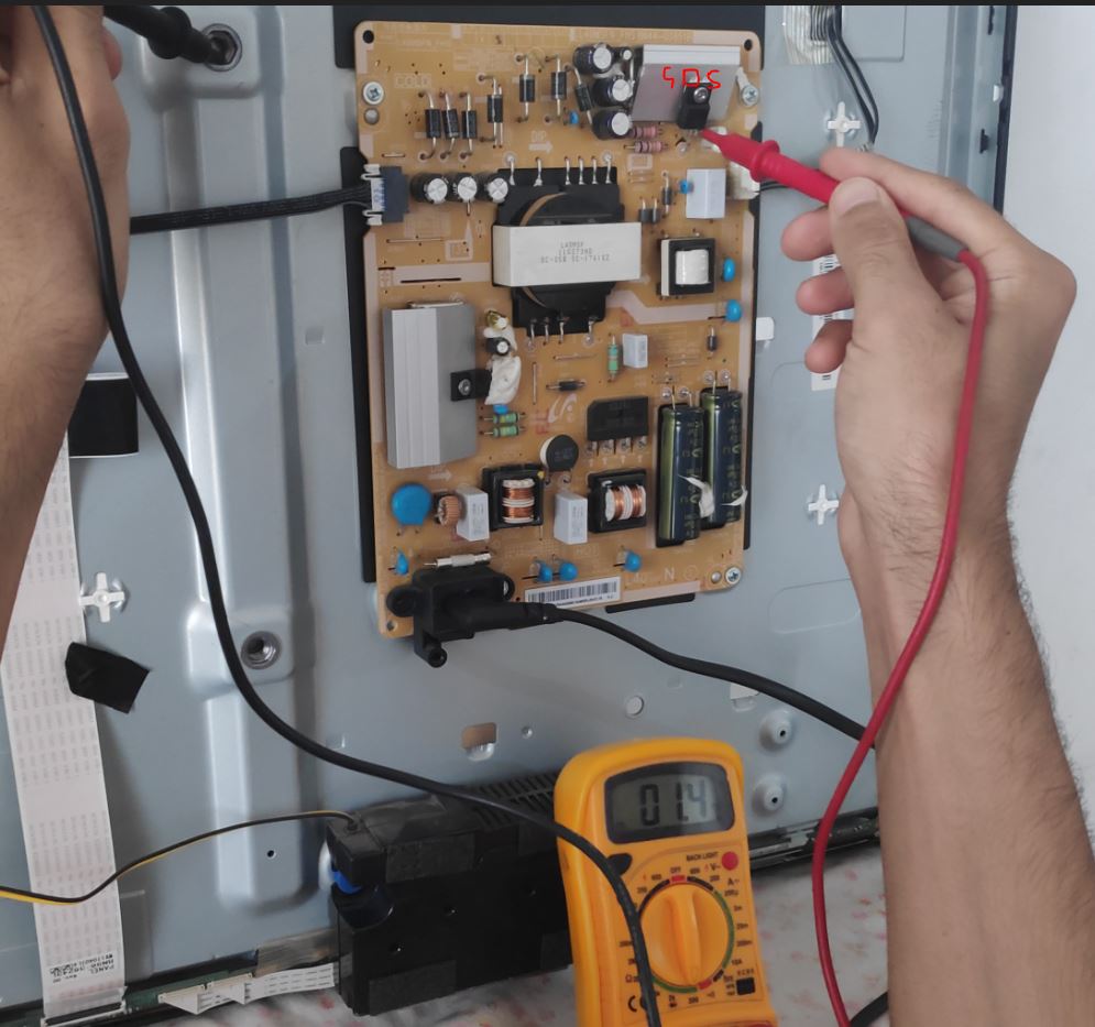

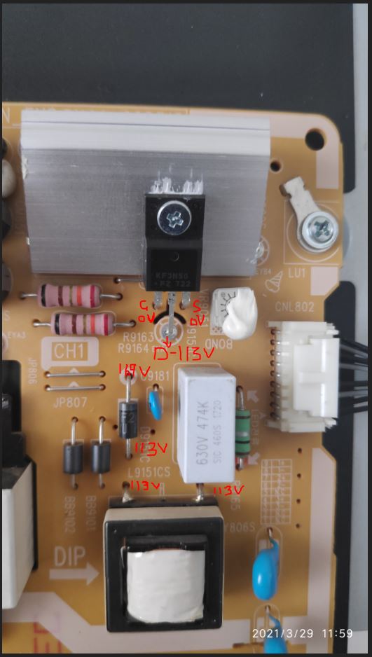

      As per your suggestion ,here are the results,
      1. I checked the Gate,Drain,Source
      TV on Image 1)
      Led driver MOSFET-KF3N50FZ
      Gate -0 volts
      Drain- 113 volts
      Source -0 volts

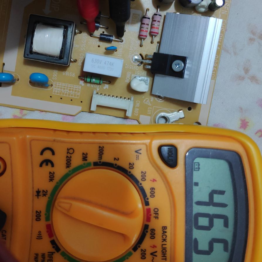

      2.Resistance between source and ground when TV is off.(Image 2)
      Ground TV-Black probe
      Source MOSFET- Red probe
      Multimeter set to 200 ohms- gives 1.5 ohms
      I have checked few voltages around and have shown in image attached .
      The one diode shown is showing weird voltages as shown in image although when checked diode is okay - checked(TV OFF) its give 473 ohms on multimeter and at opposite terminals 1, also continuity checked-no beep.
      Thank you in advance.

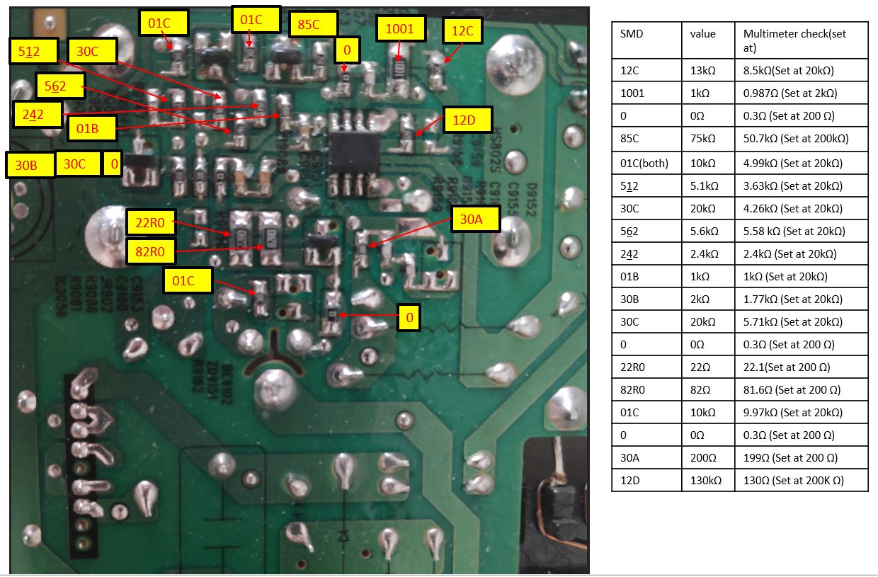

          @dick_barton:
          I checked all of them near LED driver IC & MOSFET.
          Image attached.
          In continuity mode all 0 ohm resisters beep and at 200 ohms they give similar value 0.3ohms
          Thank you .

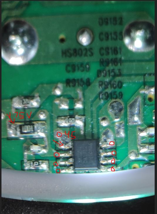

                        I checked the IC , it is only receiving the 1.75 volts from from PWM_BLU(4th pin of CNM803) first resistor before the IC and the first pin of IC is only 0.44 ohms, but all other pins show zero volts .(image attached)
                        Also ,after trying so many angles & lighting, I finally read the IC numbers partially..
                        SM125*
                        DA1712
                        Did some research on internet & found the IC is SM1251
                        I did check you link too ,but then the number I found is different on this chip.

                        I have also checked the diode marked D9151C-It is okay and showing 0.465 ohms one side only .(range should be 0.4 to 0.7 right) -images attached

                          Re: Samsung 40 inch TV -Uncommon Backlight issue.
                          Supply voltage is missing. Either it's not supplied or IC is shorting it.
                          Measure DC resistance between each pin and ground.
                          Can you remove IC and measure voltages at the pins?
                          Or try to find the path of supply voltage and see where it's lost.
