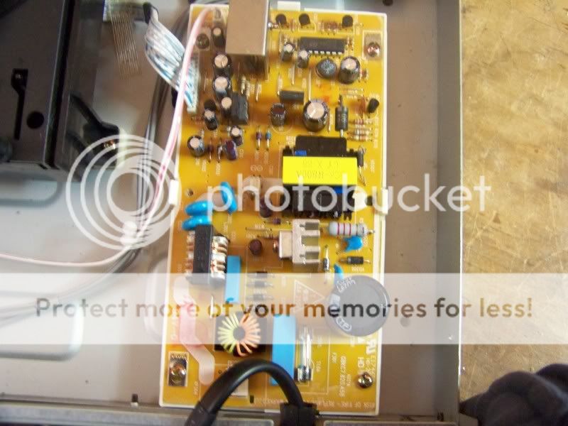

RCA DVD Player won't read discs, power intermittent
  • Solder Boy
    • Nov 2006
    • 178
    RCA DVD Player won't read discs, power intermittent
    Hi there not sure if this is the right spot for this... this is one of the 50 or so I got a week ago. Decided to see if I could fix it..
    It had a service tag on top indicating the that the door wouldn't open properly and the video was broken up on playback. It's a RC5240P. Turned the unit on, the door opened, put a disc in, it said it was reading then it said no disc. Tried to get it out, it wouldn't open, nor would the unit shut off, I had to unplug it to get it out.
    Sooo I took off the lid and undid all the boards except the video processing board. Sure enough I found bad caps in the power supply board, the video-out board, I was going to check the power switch board but haven't yet because I have to desolder the bottom lid to get at the caps.
    Oh ya tried loading a CD, the gears sounded noisy when it was trying to read it.
    Other than the obvious bad caps in this thing.. how easy is it to fix the sprockets and gears in one of these things. Not looking to fix it to sell cuz there would be no way I'd recoup my time and effort.. just something to do on a cold winter day.
    www.bcrelectronics.ca
  • Solder Boy
    • Nov 2006
    • 178
    Re: RCA DVD Player won't read discs, power intermittent
    Update.. ok I replaced all of the bad caps that I found, that seemed to have fixed the on/off problem and the open/close drawer not responding.
    I cleaned the lens gently with rubbing alcohol and let it sit for a few minutes.
    with the lid off this, I noticed the laser was moving up and down by increments trying to read the CD I inserted, still said NO DISC.. unplugged the laser unit from the logic board to see what would happen, nothing did so plugged it back in.. get the same result.. so would the laser assy be shot? I don't think the logic board is bad because the front panel buttons all work.
    www.bcrelectronics.ca
    • Wizard
      • Mar 2008
      • 2296
      Re: RCA DVD Player won't read discs, power intermittent
      Laser do weaken with age and quality of laser declines with price of DVD players. Good ones lasts longer.
      Pull the caps you used in this and junk it.
      Cheers, Wizard
        • 31283
        Re: RCA DVD Player won't read discs, power intermittent
        turn up the gain on the laser a tiny bit - there is a pot on the side of the block.
        if there are 2 pots then the other is for the cd.
        • Solder Boy
          • Nov 2006
          • 178
          Re: RCA DVD Player won't read discs, power intermittent
          Originally posted by stj
          turn up the gain on the laser a tiny bit - there is a pot on the side of the block.
          if there are 2 pots then the other is for the cd.
          I saw the pots you are referring to on the laser assy, there wasn't any real easy way to get at them.
          As far as junking this thing goes, I'm gonna keep the boards since I repaired them.. maybe I'll come across another one with a good laser but shot boards.. ya never know with my business
          www.bcrelectronics.ca
          • triplefour
            Karavision PRO KP-8800 wont read burned DVD.
            by triplefour
            a friend of mine brought me a Karaoke Machine that was somehow damaged in shipping and will no longer read the Burned DVD that was in it when it was shipped. they swear up and down that it used to read that DVD just fine. The drive was making all kinds of horrible noises and wouldn't read any discs when i started working on it. after cleaning the lens and adjusting the spindle it will read regular CDS now but still wont read any burned CDS or DVDS or even regular DVDs. is this the proper place to ask about this?
            cause its a video karaoke machine... not strictly "audio equipment"...
            02-19-2023, 06:29 PM
            MEDION AKOYA S15447 + ext. DVD Player Notebook Specification for Upgrade or Repair
            This specification for the MEDION AKOYA S15447 + ext. DVD Player Notebook can be useful for upgrading or repairing a laptop that is not working. As a community we are working through our specifications to add valuable data like the S15447 + ext. DVD Player boardview and S15447 + ext. DVD Player schematic. Our users have donated over 1 million documents which are being added to the site. This page will be updated soon with additional information. Alternatively you can request additional help from our users directly on the relevant badcaps forum. Please note that we offer no warranties that any...
            09-06-2024, 05:30 PM
          • nervous_capybara
            Repairing the Hitachi DA-6000 CD player
            by nervous_capybara
            Hello everyone !
            I recently conducted maintenance on a Hitachi DA-6000 CD player for my grandparents : it had two distinct issues.
            Feel free to share your experience if you ran into other issues.
            DISCLAIMER : BE VERY CAREFULL WHEN OPERATING ON THIS SYSTEM : THE HIGH VOLTAGE IS VERY CLOSE TO THE VARIOUS TESTING POINTS, PROCEED WITH CAUTION
            CD tray would not come out of the player
            I could hear a motor spinning inside the player but the CD tray would not come out.
            Turned out that the issue was the CD tray belt that aged poorly and began to...
            11-05-2025, 03:11 AM
          • Dannyx
            Hilti PD30 Laser Range meter Error 276
            by Dannyx
            Good day folks.....wow, seems like forever since I posted anything here Still alive and well, thank you I guess you could say I've become more independent and able to work stuff out on my own. This one though goes way over my head and I doubt is fixable, but maybe some bright spark out there has an equally bright idea.
            So: my Hilti PD30 laser meter quit on me just the other day. It was working fine, I set it down for a while and when I tried using it again it gave me an E276 and wouldn't do anything else. I tried taking out the batteries, all that standard stuff but nothing...
            07-30-2023, 05:05 AM
          • dkneyle
            Onkyo DX-V500 Laser Disc Player - weird SMPS fault
            by dkneyle
            This relic from a technology path that came to a dead end (but still has historical interest) was brought in with a dead SMPS, which is based around a MK1210 device. I got it going after a battle. It seems to have a strange design - if it's not getting feedback that the secondary is OK it cause the big FET to go into full conduction and overloads resulting in a blown fuse at best or something worse! I'm using a Dim Bulb Tester (70W/230V) which thankfully has saved the day a number of times whilst repairing.
            Now, it loads a CD OK. The motor voltage output (which is built onto the SMPS...
            02-01-2022, 02:08 AM
