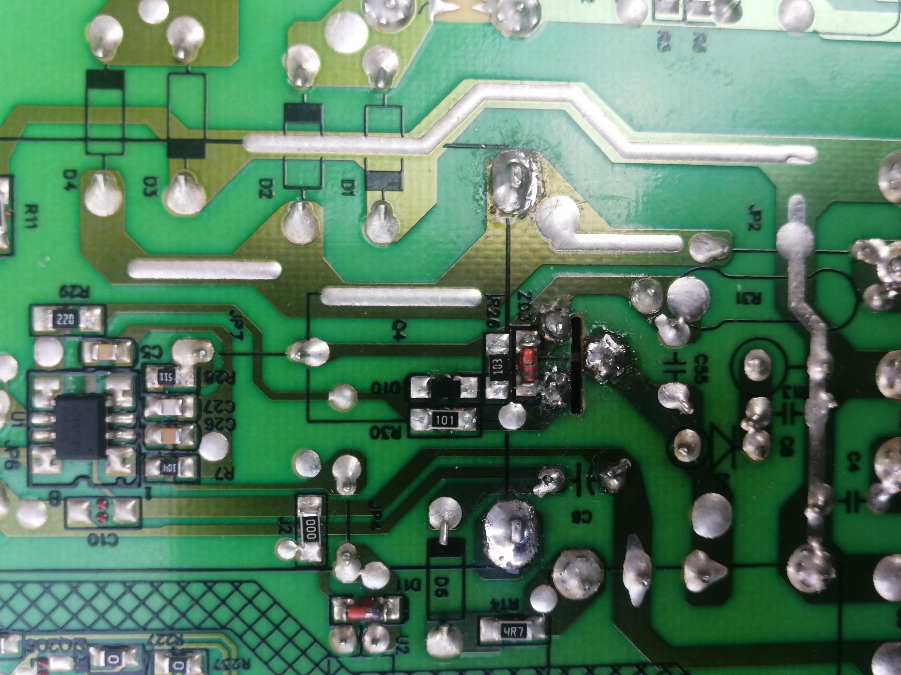

    Looks like you are right about the short circuite
      #42
      Re: TV not powering on - with standby red –led flashing
      Originally posted by dick_barton View Post
      Either the gate/ source of the mosfet is short circuit or more likely the zener diode ZD3.
      You need to lift off ZD3 and make a note of which way around any markers are so it goes back in the exact same position. Then check its resistance when out of circuit.
      Can you post a photo of that area so I can see the components mentioned.
      R30 looks as though its a 100 ohm resistor so I think D10 is probably damaged as well
      I would double check the mosfet as shown in many Youtube videos for example
      https://www.youtube.com/watch?v=gloikp9t2dA
      I have removed it form the board, do I just measure it on the ohm setting of the multimeter?

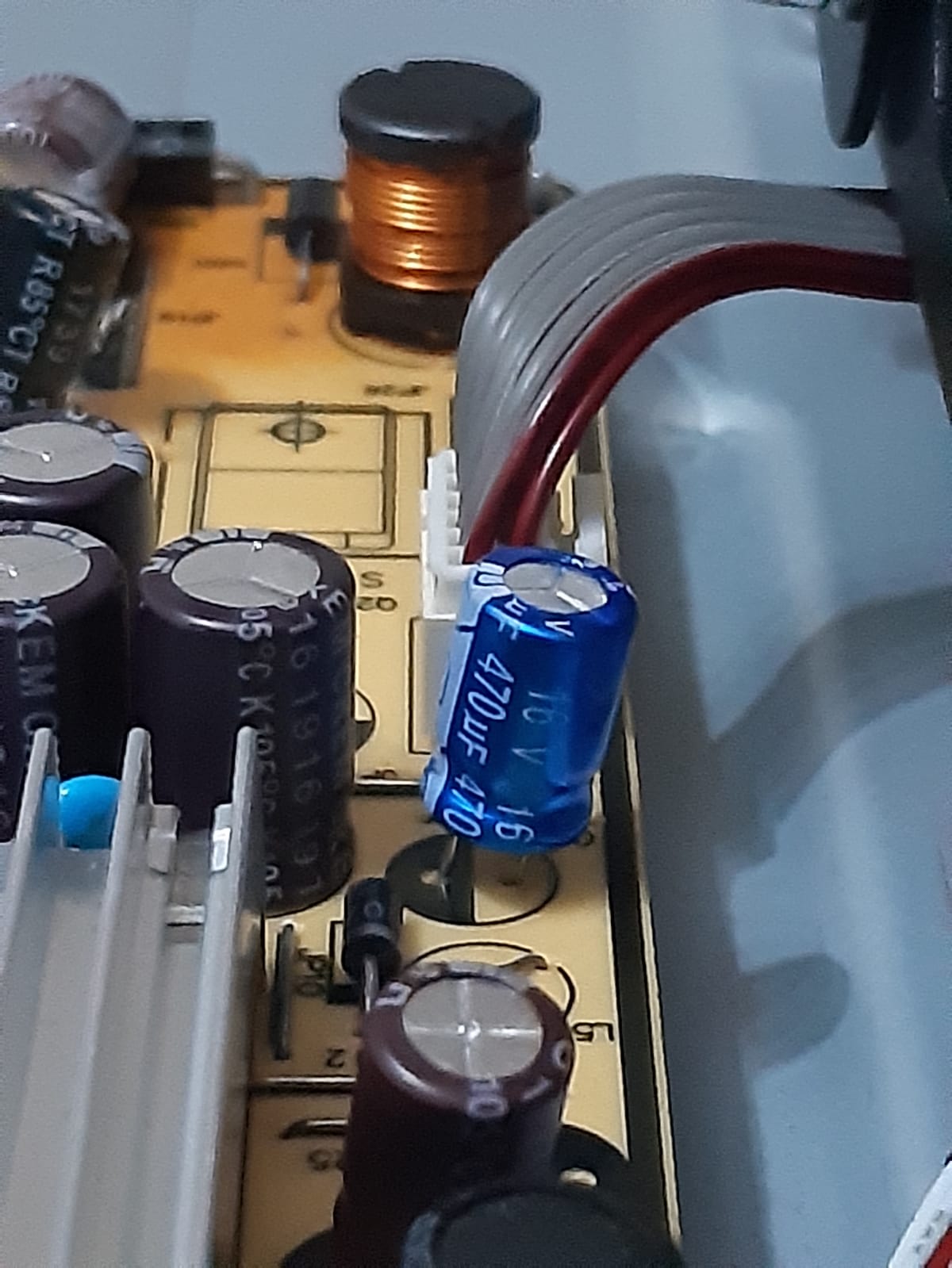

                Are there any components on the opposite side to C45 which may be heating up as you heat up C45. Is C30 in circuit? if so I would check that.
                Did you check the diode D15. Also check all the soder joints. Post a picture of the replacement capacitor. Ensure it's soldered in the correct way around.

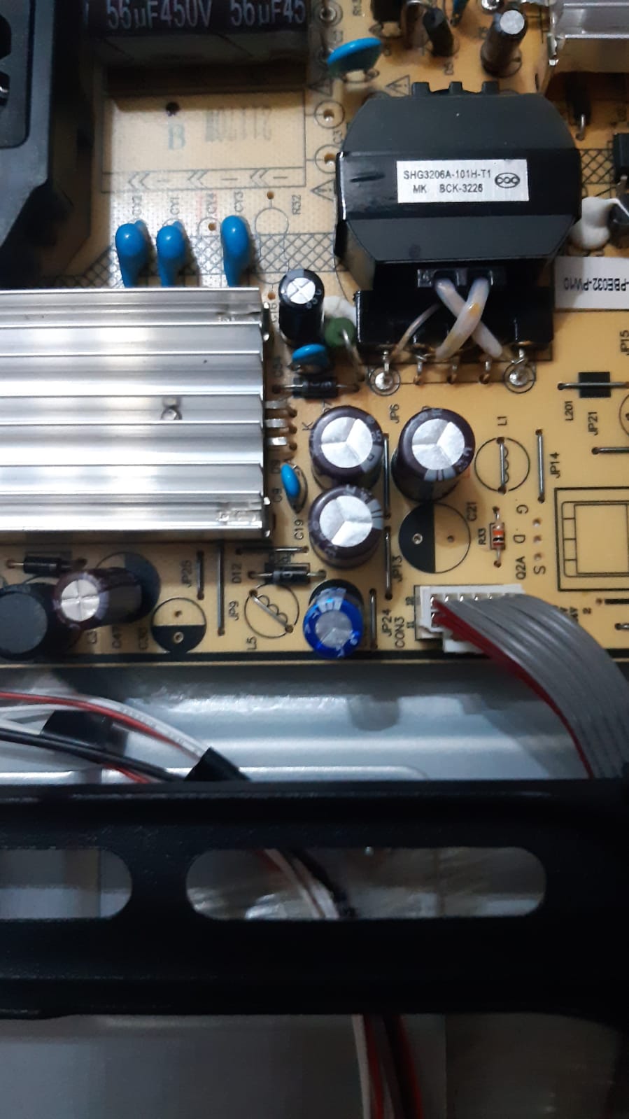

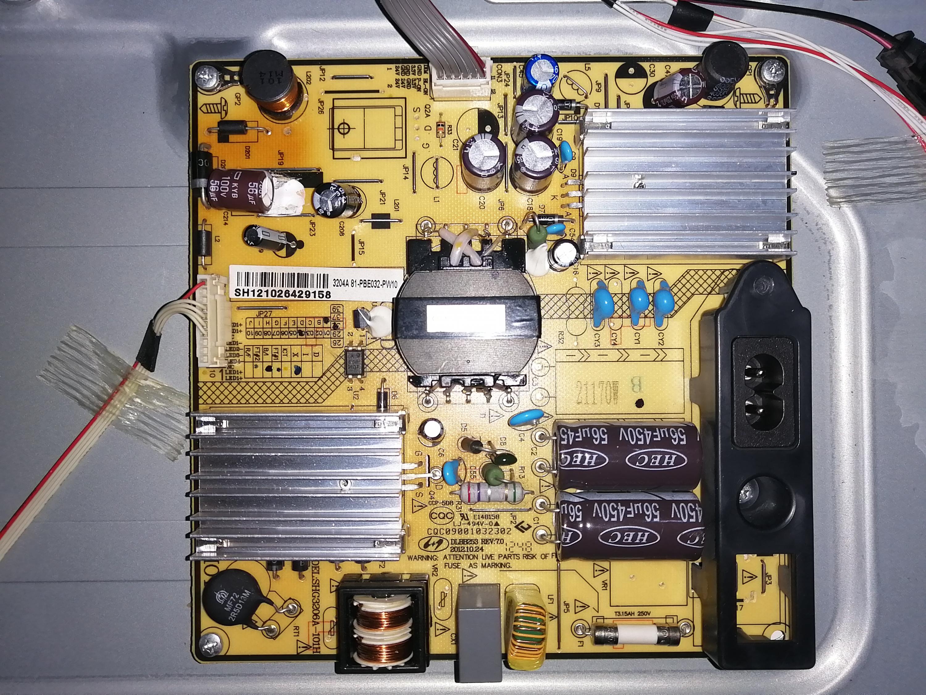

                  I have placed a piece of cardboard in between the caps to prevent the heat-flow to each of the other caps, I test it 3 times every time I heat up C43 the led goes solid. I can see C30 is not in circuit
                  C45 is that blue cap
                  Then on D10 I did measure it and there was a ohm reading cant remember now as the board is mounted again in its place.
                    The view from the top of C45 doesn't give a lot of information. Can you post all that is wriiten on it.
                    Are you saying you're losing the 3.3V supply when the set is in standby ?
                    What voltage do you have on L1 link when in standby?
                      "470uf16v cap" Those specs are not a problem but you may just have a bad cap there.
                        #51
                        C45 blue one, must I replaced it with another one
                          #52
                          No, It should be fine. Checking it was in correctly.
                          I think you are losing the voltage to U4 which is why the 3.3V is dropping. It would be interesting to see what voltage is on D9 cathode and whether it does drop in standby.

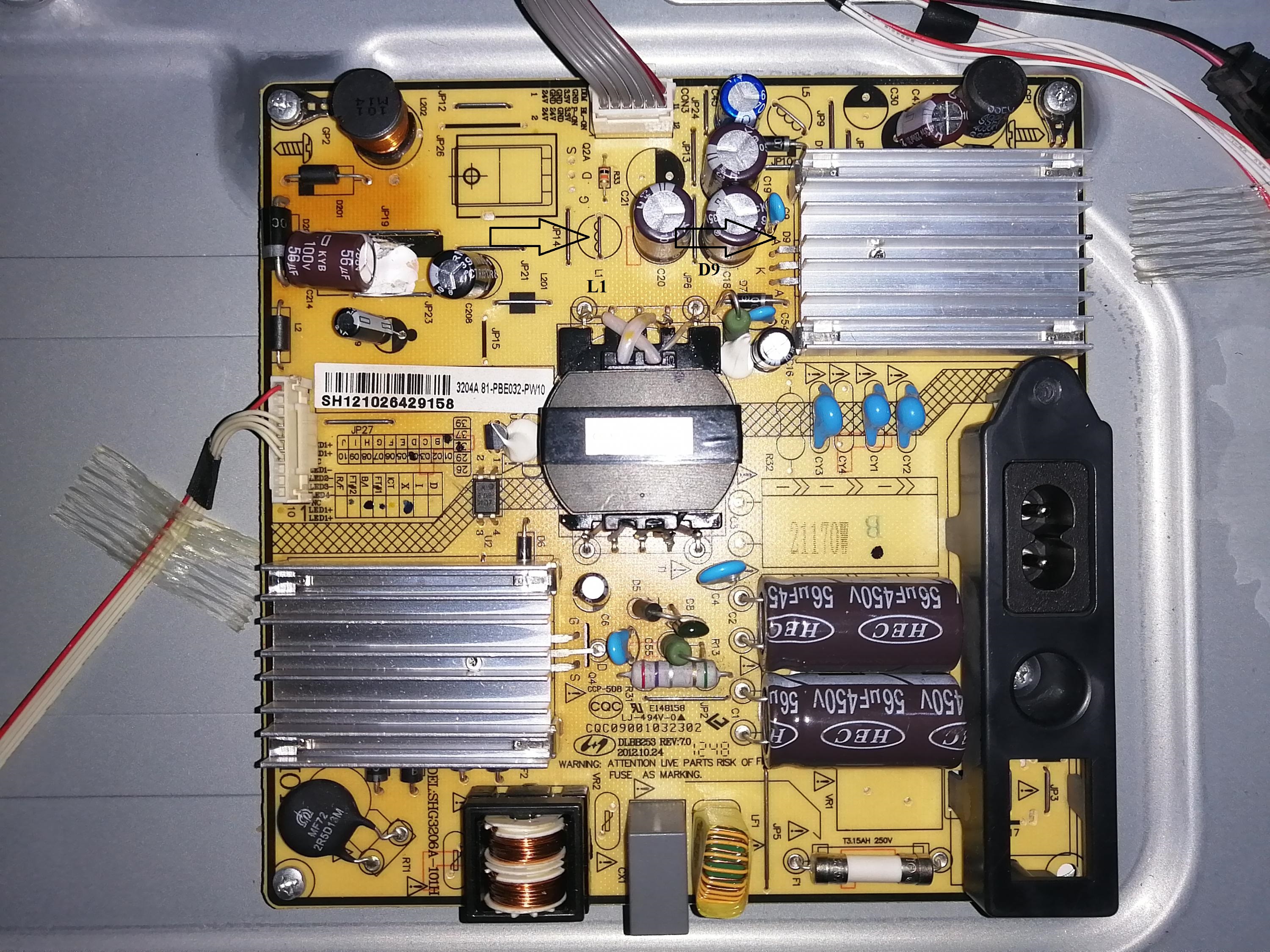

                              #54
                              Here we are as per your photo

                                    #57
                                    What is the answer to the above questions?

                                        #59
                                        On L1 it fluctuates 3.6 - 4.7 with the standby led flashing
                                        When I unplug the CON3 plug for 10 sec plug it back the led stops flashing amd turn solid, then the volt on L1 is about 22v
                                        D9 cathode voltage fluctuates from 21v - 60v that is without any pins jumped

                                          #60
                                          Originally posted by nomoresonys View Post
                                          Make sure C45 is not in backwards.
                                          See post #51 image
