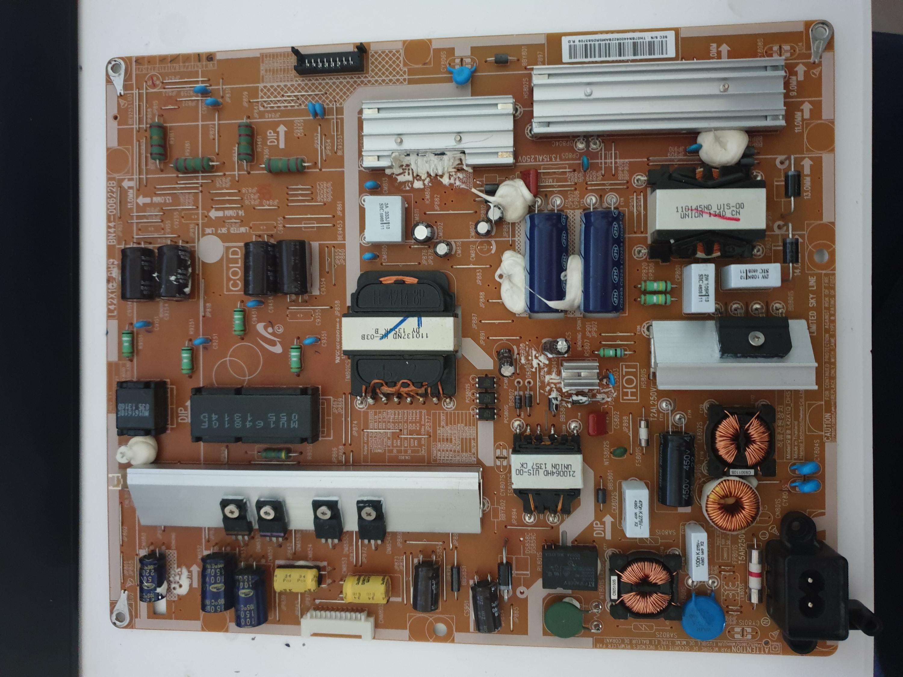

    Hi guys,
    I friend of mine bring to me this TV because it started to reboot continuosly.
    Sometime when the TV is really cold it startup correctly but when we shut it down and try to turn it on again it is stucked in bootloop.
    When the TV fails to start i can hear the sound of a relay triggered in the PSU.
    I tried to do some measurement and voltages are present in the connector to the mainboard but being the power supply intermittent i don't know if i can trust these measurement.
    By the way if i disconnect the PSU from the mainboard the LED backlight stays on, so i think that the problem must be in the PSU.
    Do you have any suggestion where to look at?
    The PSU model number is BN44-00622B.
    Thanks a lot!

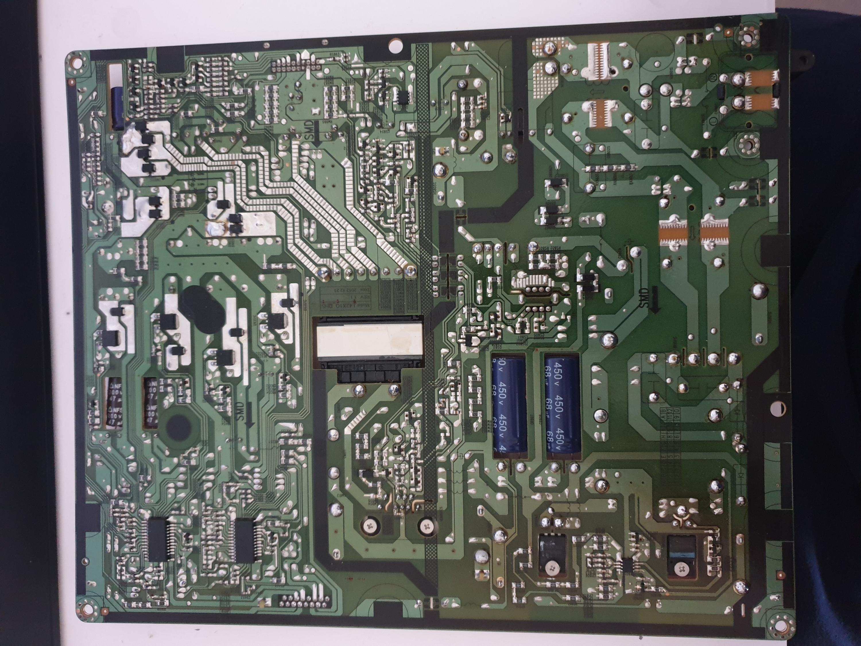

                  Yes i checked the joints and re-do a lot of them to be sure.
                  I made some other measurement and testing and i was wrong, with the mainboard disconnected from the PSU the led lights are blinking because of the relay shutting of the power. When i am lucky and the TV starts correctly it seems that the backlight strips are all good.
                  Here i attached a picture of the front and back of the PSU, i recorded also a video to show the clicking issue:
                  https://youtu.be/-IDE-OUGtZA
                  Please help

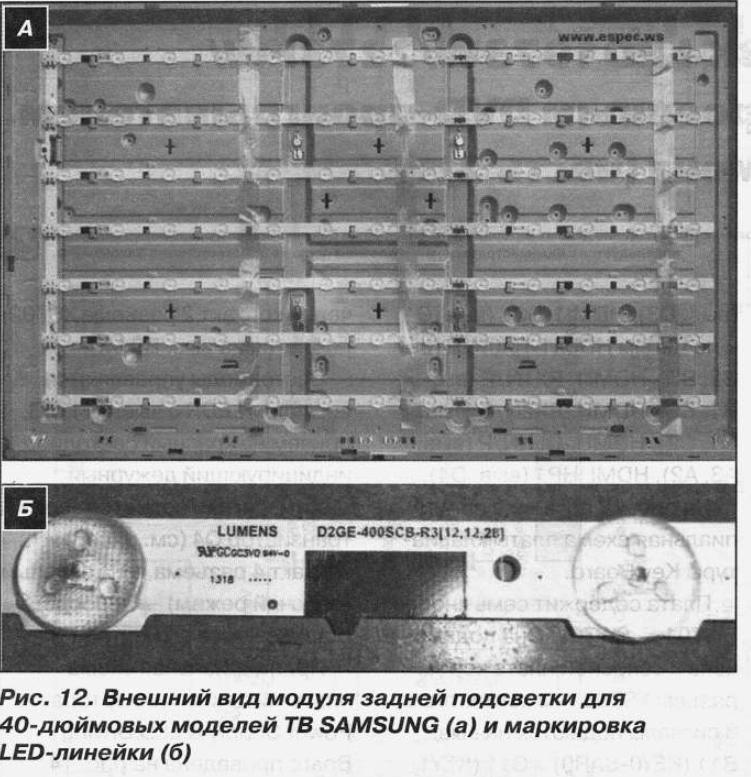

                            Main PSU have to be switched permanently ON also without connected main board, but backlight have to be connected and 100% OK.
                            If you carefully checked LED strips an you are sure that there is no interrupted LED, no shortcuted LED on any strip, please skip next few sentences.
                            There are four separate backligt channels. First channel needs for feeding apr. 45V/270mA, next 3 channels apr. 90V/270mA. Last three channels are two the same LED strips as for first channel, but connected serially. For backlight is used 7 strips in total in this TV.
                            (see picture from magazine mentioned below)
                            Each IC is responsible for two channels. First half of first IC (9101) generate apr. 45V, next half apr.90V, second IC (9102) 90V per each channel. Each IC has output over voltage and overcurrent protection for LED strips feeding. In case of error LED strip is generated from appropriate IC error signal, which switch off main PSU. TV is switching off, after a few second switching on ad again...

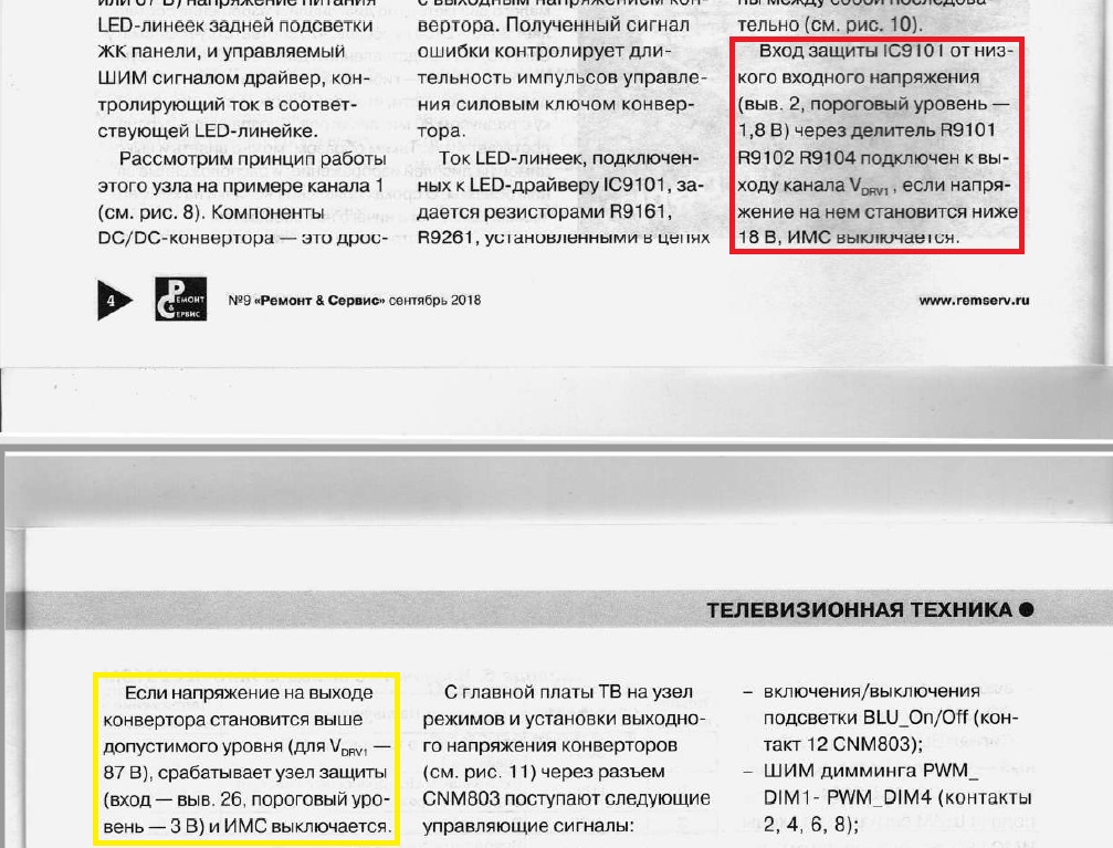

                                  I am not sure, because:
                                  Please see attached picture (a few pages from magazine).
                                  In red marked square is described under voltage protection Vdrv1. If is less than 18V The protection is activated, IC is switched off.
                                  In yellow marked square is described over voltage protection for LED strip no. 1. If is there more than 87V The protection is activated, IC is switched off.
                                  I think that google translator is not easy way in this case. I have found only pdf "bitmap" scan of the magazine. No OCR scan.
                                  What happends with output voltage for LED strip if is the strip disconnected/broken-interrupted ?
                                  Did you measured voltage at pins 25 IC DC-DC converters?

                                      Re: Samsung UE40F6400AY relay sound and reboots continuosly
                                      - A5V signal drops when the relay turn on and off.
                                      A5V is not a signal, it is the standby voltage and if it drops that is your problem, Relay_On should be near 0 volts when the power supply is ON
                                      The mosfet (QS861) is likely ok or the relay would not turn on at all or would be on all the time.
                                      • Luis8
                                        • Oct 2020
                                        • 17
                                        • World
                                        I am sorry i wasn't precise, i meant A5V voltage
                                        I made other measurements today and i have stable voltage across DS858C and CS851 but i have 0 volts across CS854.
                                        The only accused can be QS851, it doesn't have drain and source short-circuited and i am not sure on how to effectively test it with the multimeter but i think it is the culprit. Do you agree with me?
                                        It never happened anymore that the PSU was able to start correctly but can a mosfet be affected by thermal malfunction? If so it is the first time that this happen to me.
                                        Thank you very much for your help and patience
