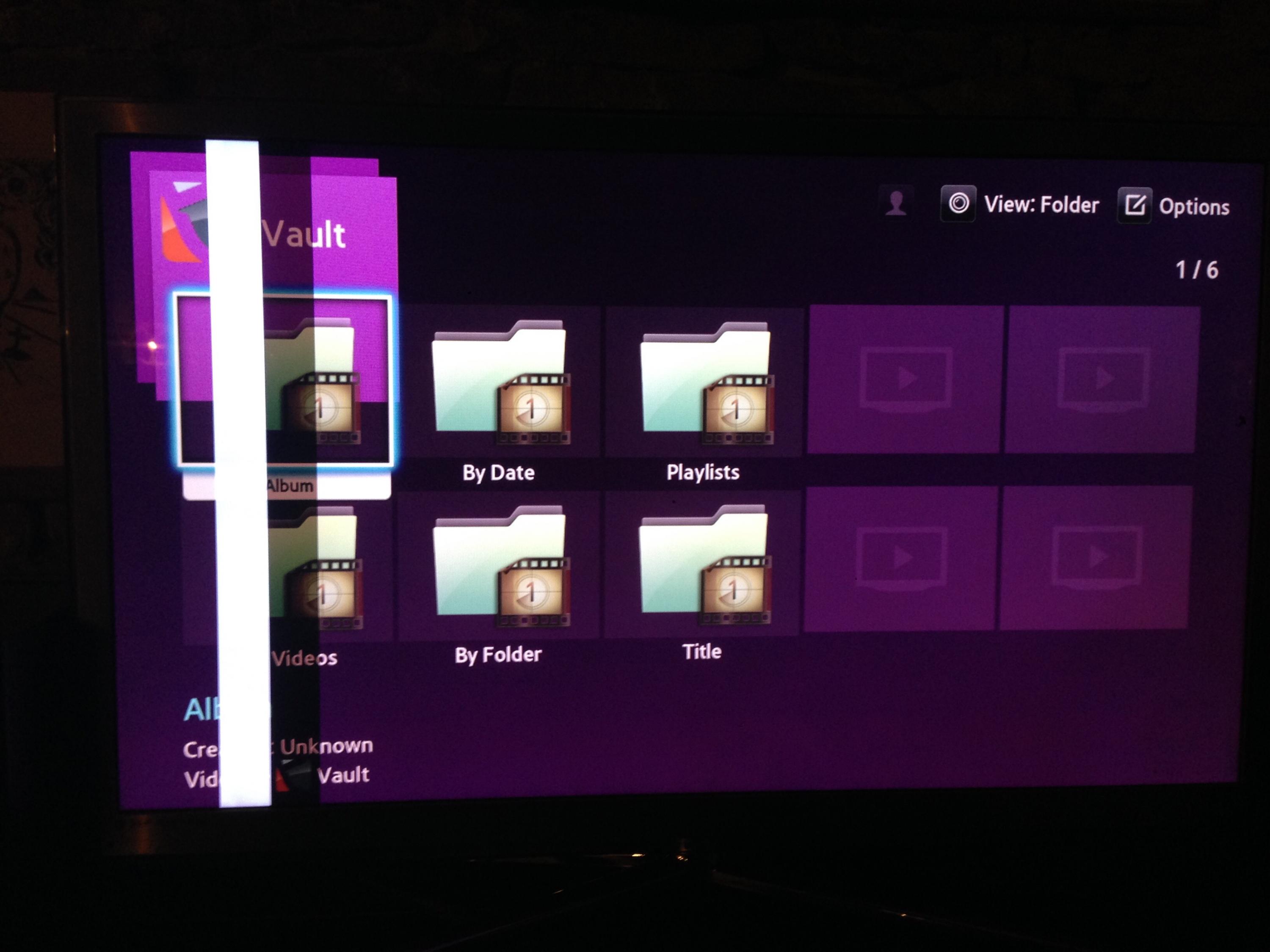

    Hi there,
    Our sterling UE46C8000 has recently come out of storage and has started intermittently exhibiting two vertical bands - one light, one dark - side-by-side to the left of the screen.
    Sources are through a receiver so only using one input on the TV. Changing inputs makes no difference.
    Often they will disappear on a scene change watching live material but with recorded material they'll stay until the input source is changed, or switched to menu/guide. Appears to be more prevalent with recorded material.
    No vertical bands on the self test.
    I can't find anything similar anywhere so if anyone's seen anything like this before I'd be very grateful to hear about it.

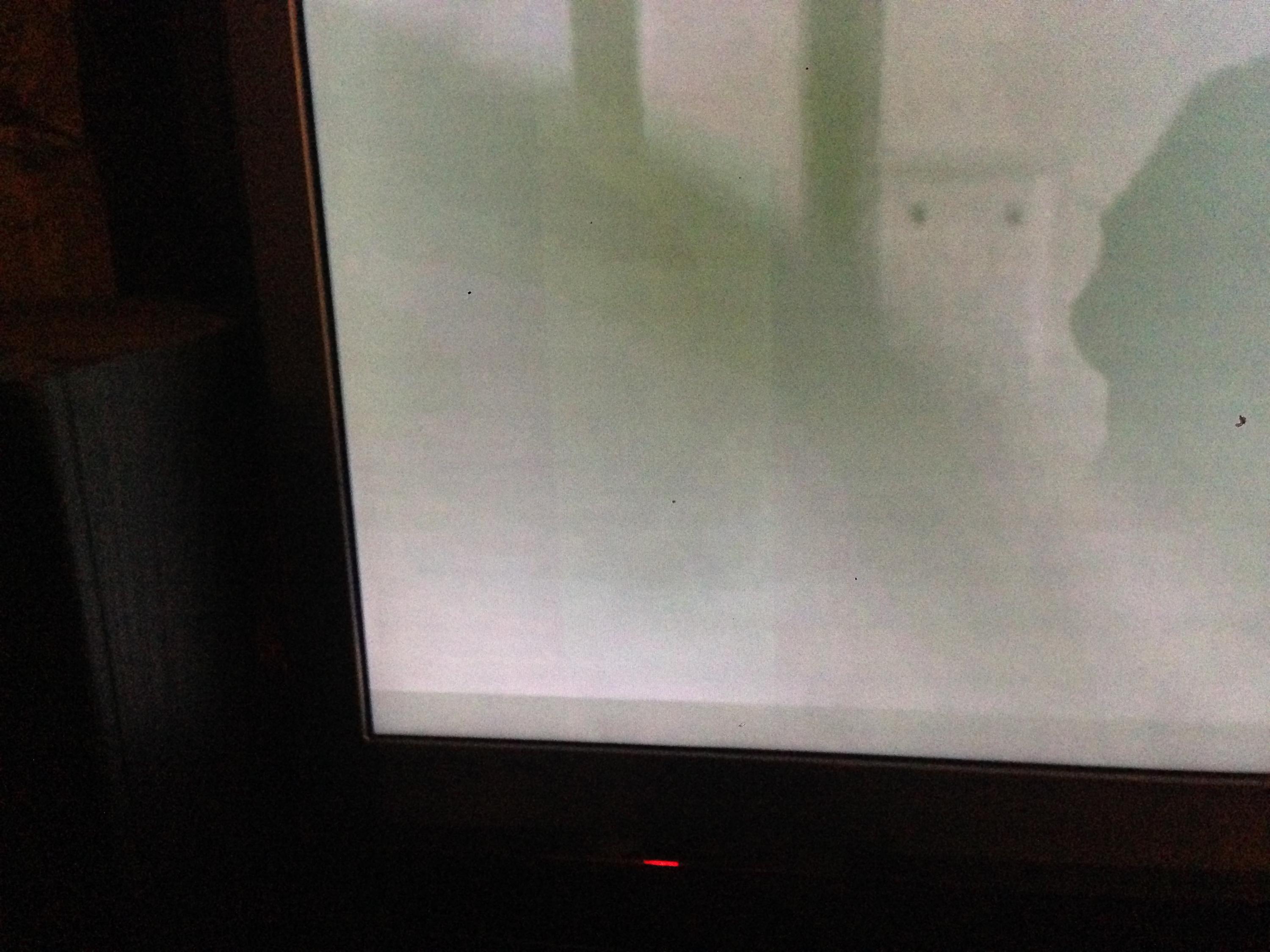

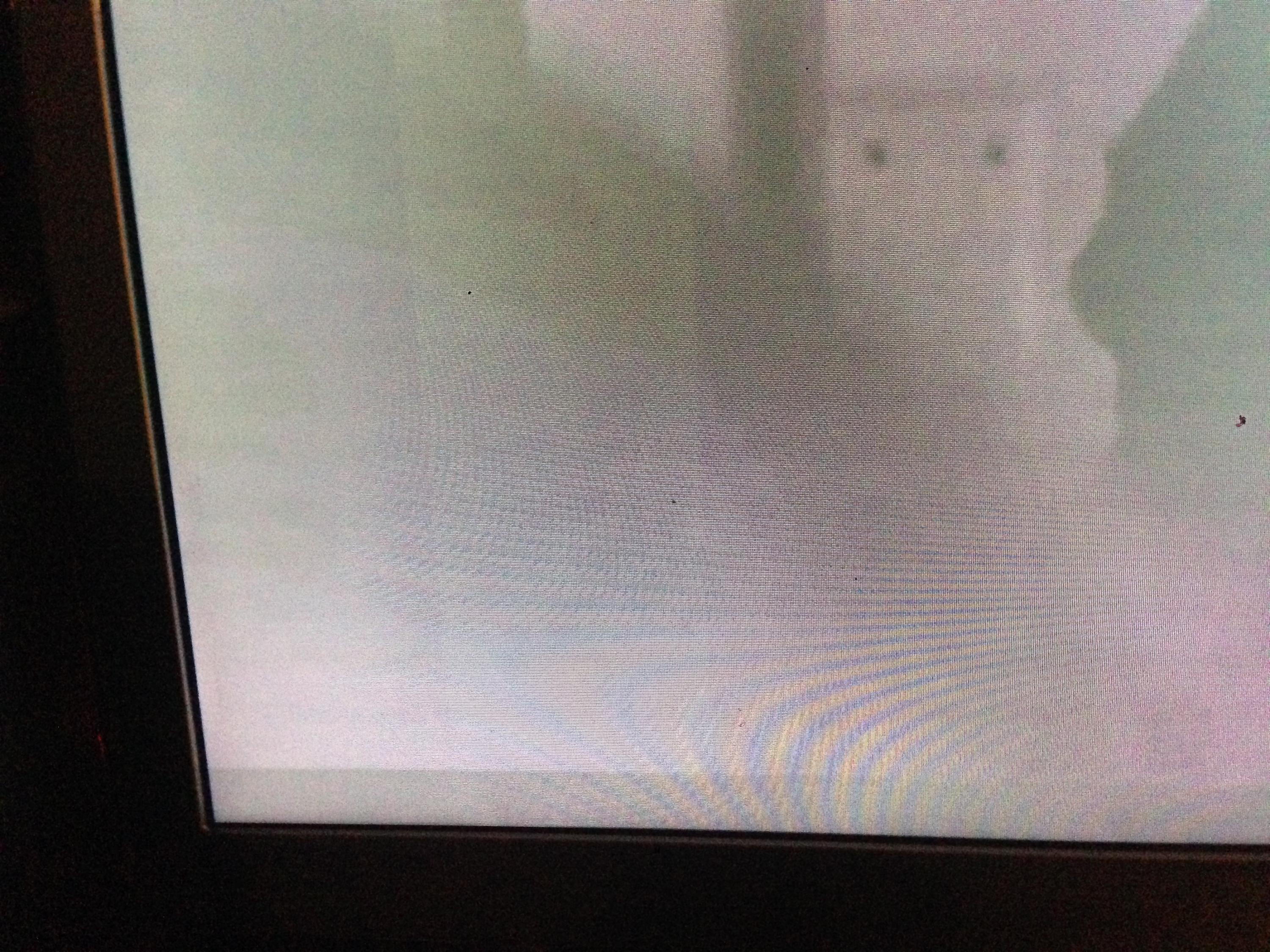

                    Re: Samsung UE46C800 Intermittent Vertical Bands
                    Originally posted by Diah
                    can you show me please
                    Hard to photograph but here you go.
                    Interstingly just watched a dvd at 1080/24p without a single incidence in over 90 minutes....

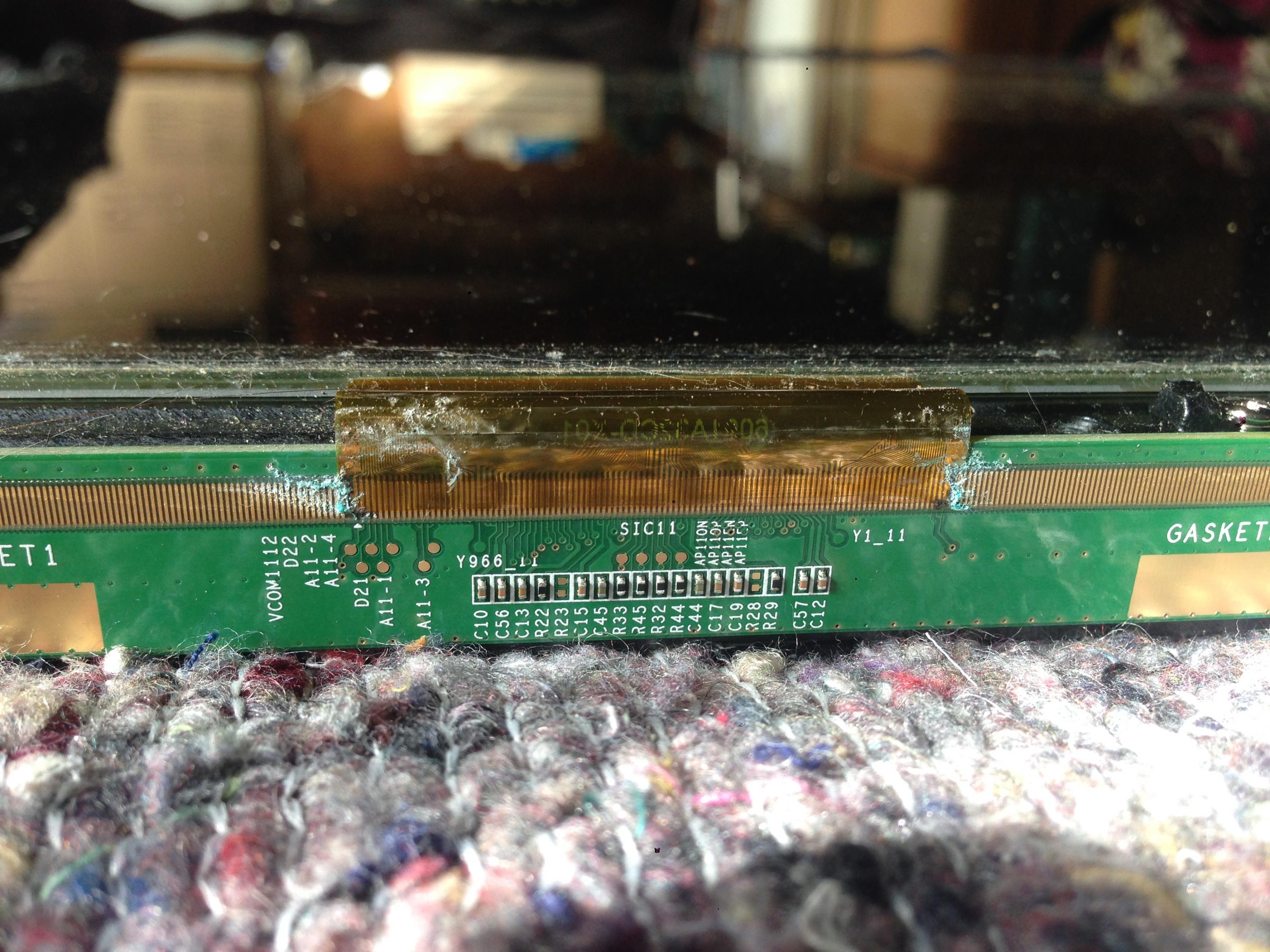

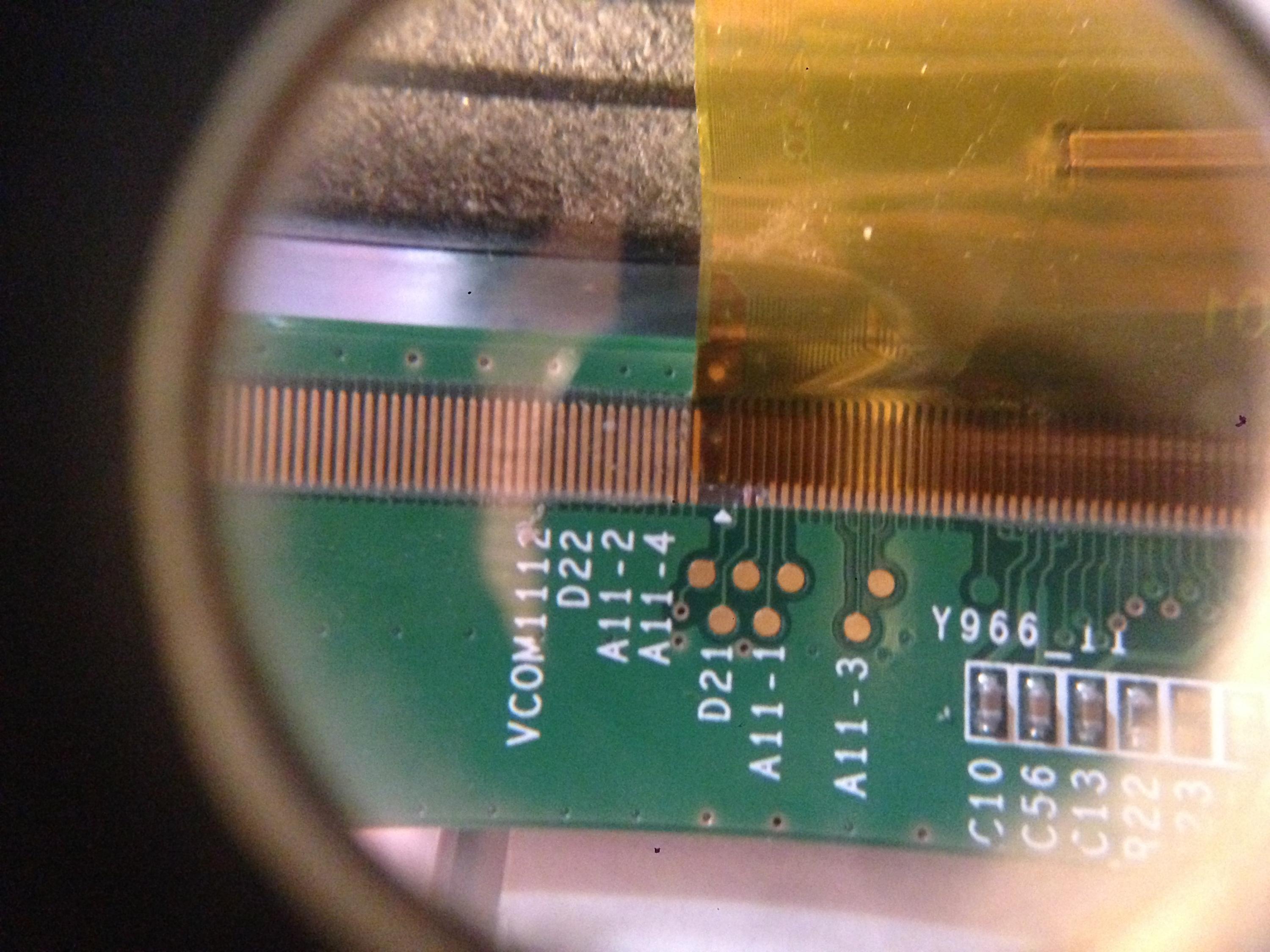

                                Originally posted by Davi.p
                                locate the COF in corrispondence of the fault, then inspect the board attached to it.
                                You were right on the money - small amount of oxidation on the board which cleaned off with iso - vertical bands appear to have gone although I'm now left with a single-pixel vertical red line.
                                Appear to have a burnt out track feeding the ribbon at D22 so scratching my head for a way to jumper that as there's nothing on the ribbon side to solder to.
                                As an aside do you know of any resource to find TVs with common panels? New price for mine is around 1200€ which is insane so was thinking of trying to locate a second hand one and would be easier if I could widen the net....
                                Panel is an LTF460HQ03 or Samsung P/No BN07-00874A

                                  Buying a replacement screen in tv field is out of discussion, you can gently cut out partially the flat along the contacts to separate those two with traces corroded, bent it and solder a single filament each one with bare tin, it's non so difficult, it worths a try. For your info the corrosion is built by the screen washing with detergant..
                                    good that you still have trace of the line at the boards area so its easy to fix if you have calm hand with good light source and standing magnifier.
                                    i face such 2 time before and i did fix it
                                    take very thin copper wire( take it out one line from any wire) put solder on yours IRON at the top and move the cable over the solder so it will cover with solder.
                                    solder it at the start line on the boards ( before the ribbon cable) and let it go straight over the line you want to repair. with plaster type make it fixed on the line..
                                    now the most important take any small straight screw driver ( such for mobile ) and heat the end of it, with calm hand placed it on the cable and push down smoothly it will mild down ribbon and stick on the line.
