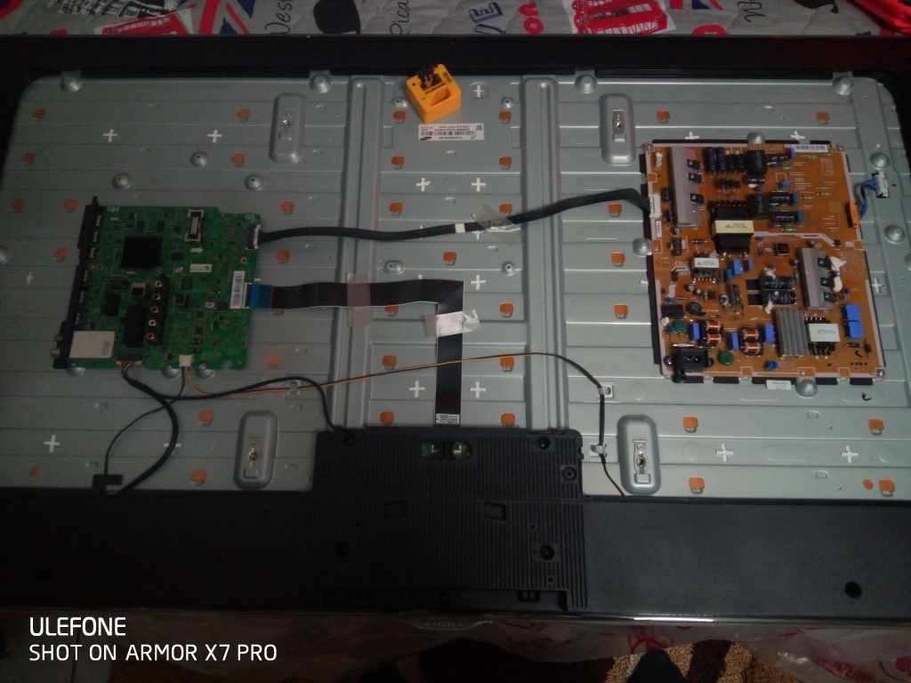

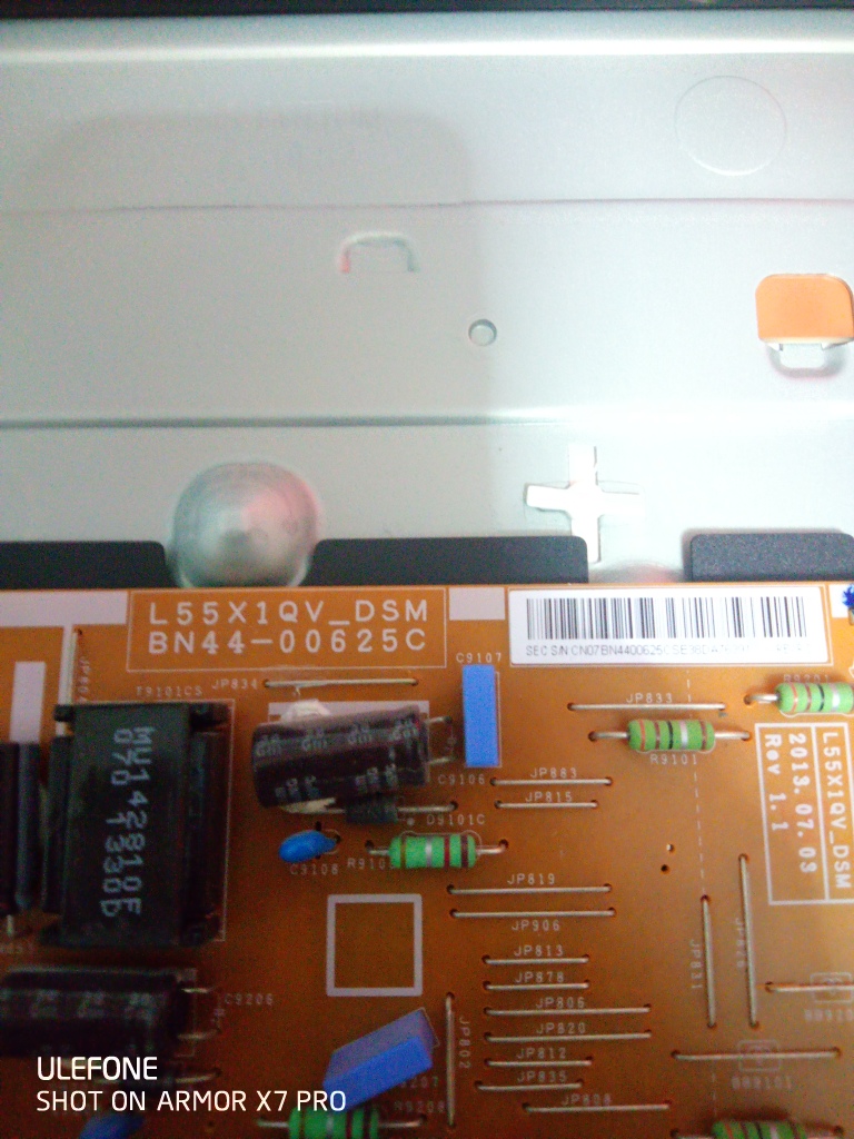

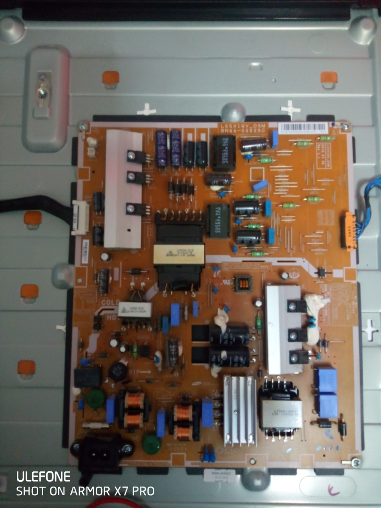

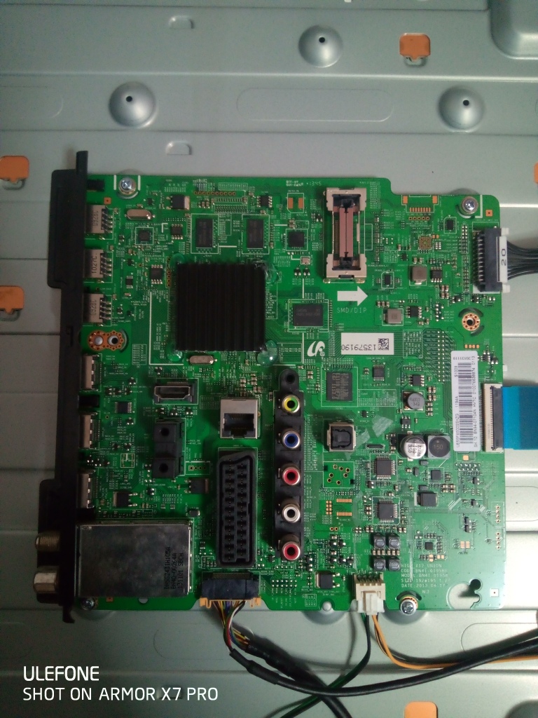

    Hello i have tv SAMSUNG UE55F6500SS
    The roblem is that when i start it all led start flashing like strobe and never stop. I hear the sound regular from the speakers.
    I bought new led stripe but the problem is still the same
    When i disconnect motherboard from power supply all the led light up without problem.

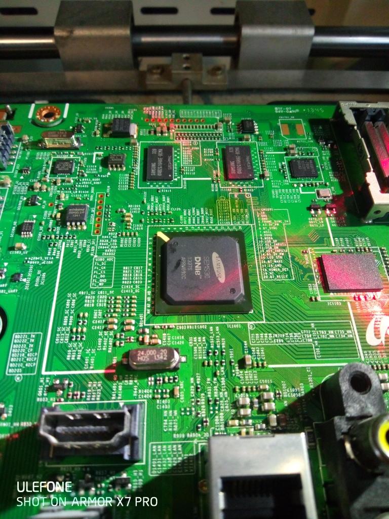

    I tried also to rework bga chip SAMSUNG SEMS30 but nothing.

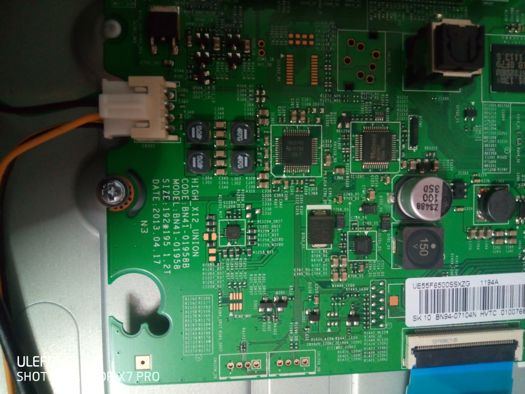

    my motherboard is
    BN94-07104N
    HIGH_X12_UNION
    CODE: BN41-01958B
    MODEL: BN41-01958
    SIZE: 192 * 195 1.2T
    DATE: 2013.04.17
    N3
    i also upload images from tv boards
    Please if someone haw any suggestion how to fix it are welcome.
