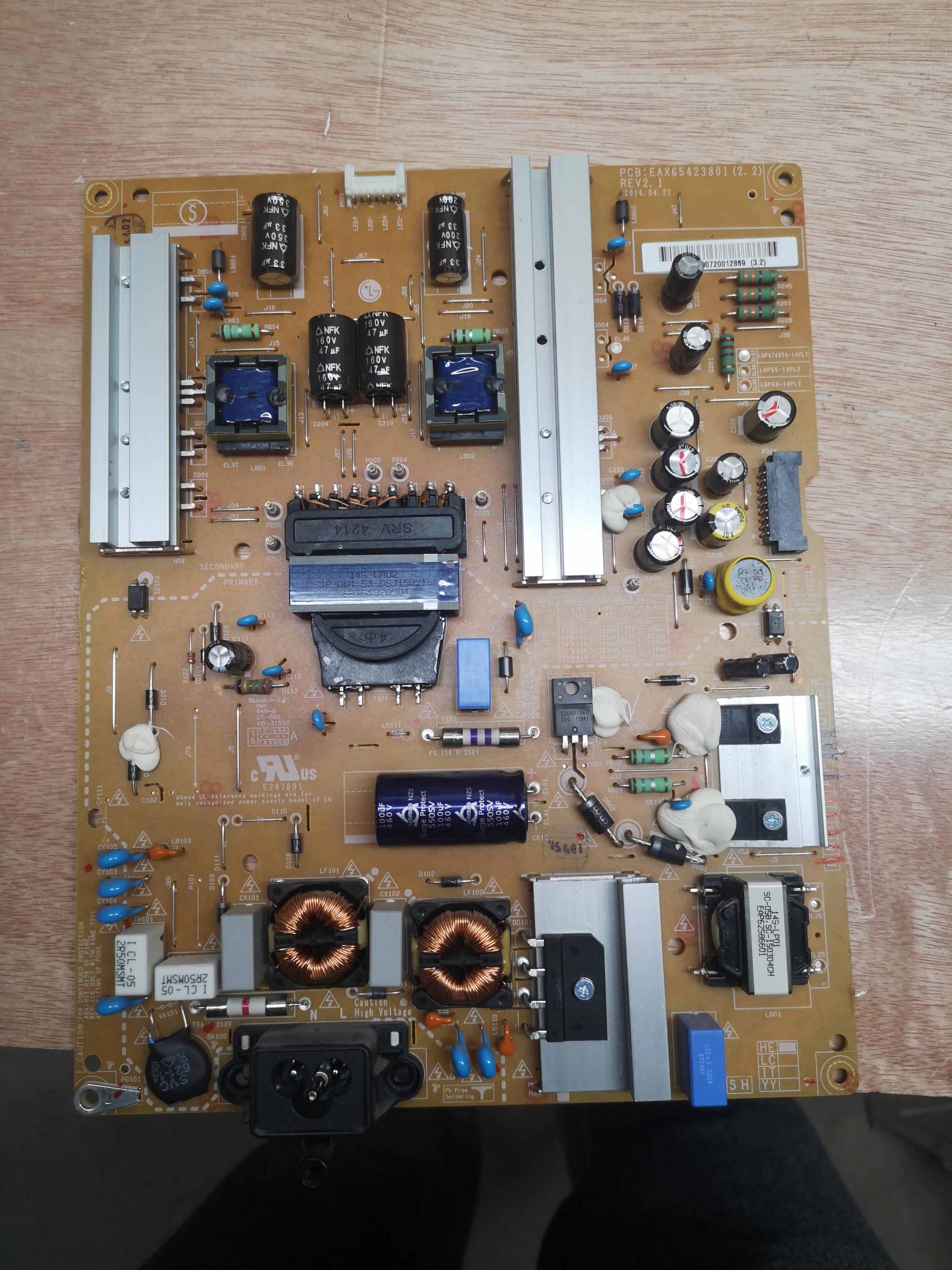

    LG 50LF5800-UA Backlights flicker on and off
    So i ran tests on the power supply and all of the voltages going to the main board are fine. I tested all of the capacitors on the psu with an esr reader and they all pass. All diodes pass also. But when a reading is done on the 4 pin white led connector on the top of the board, the voltages will flicker to 5Vdc for a fraction of a second and go out again. For that fraction, the LED backlights light up. Anyone have any clues to this situation?

      Re: LG 50LF5800-UA Backlights flicker on and off
      If your leds flicker then you must have a high voltage at the connector in order to light them up. The voltage may sharply spike at switch on and then drop quite rapidly.
      Recheck the voltages at each pin to chassis at switch on and repeat for all four pins.
      Quite can't see what is given on the circuit board but it looks like one set of leds run at 113V and the second set at 170V

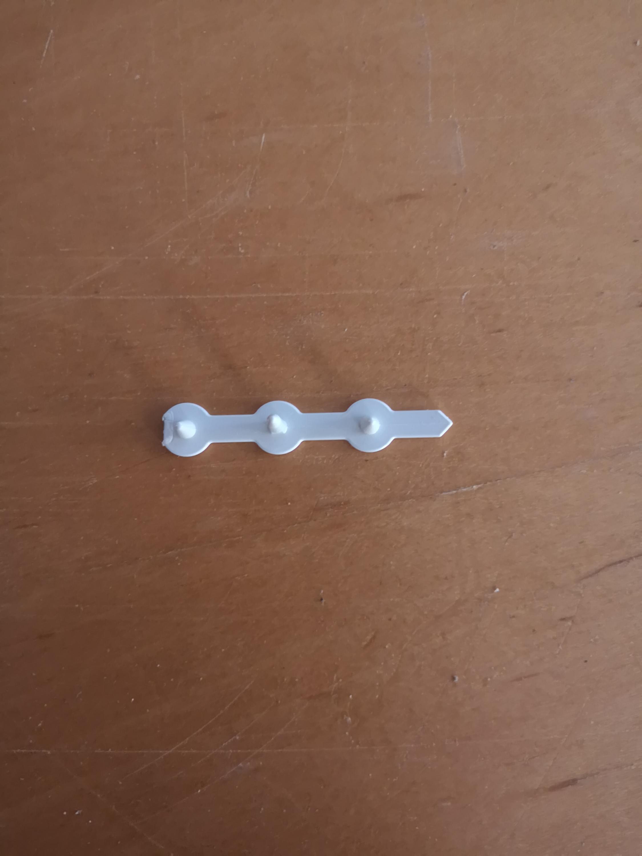

                      Ok so these LEDs worked fine but i ended up breaking about half of the clips off that keeps the white panel from touching the leds. Anyone know what these are called so i can order new ones? I can see the round shape of the led covers on the screen when watching tv.

                        You mean the plastic standoffs?

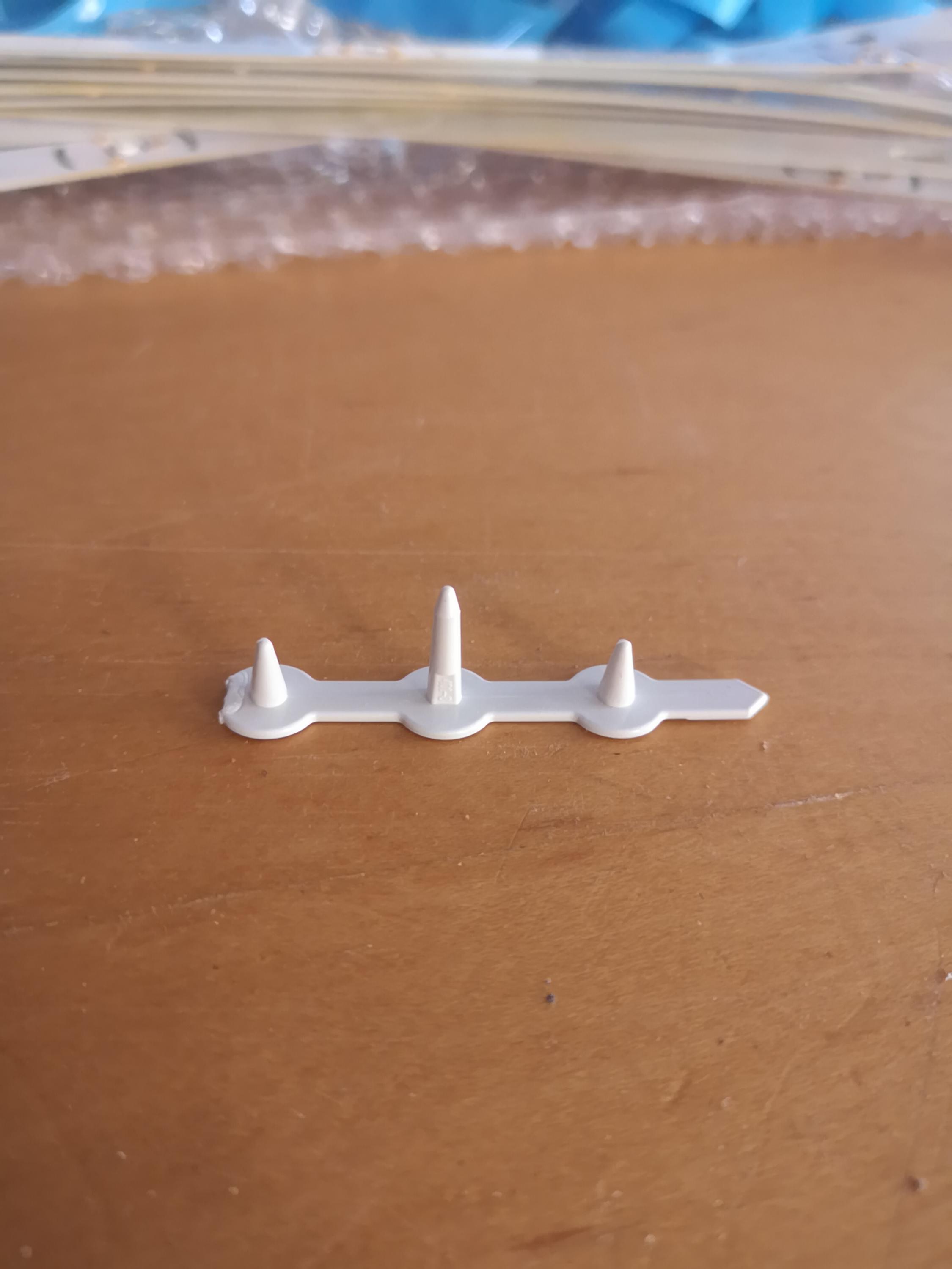

                          Whatever is in the picture there. They're called standoffs are they? Go to 7:40 in this video: https://www.youtube.com/watch?v=s4wNc3hF4JI
                            I remove mine from the back of the panel. Push down on skinny part of tab and slide back.
                              Ya well it's too late for that. Half of them are broke now. Looking for a place to purchase them
                                    Could you have glued the broken standoff's. Superglue or something similar.
                                      I could try that with hot glue or something
                                        So anyway i put all the broken standoffs back on with glue but can still see two leds shining through the screen when it's on. It's like they are brighter then the rest or something. They are especially visible when there is a lot of white on the screen in those areas. I cant figure it out. I got them from aliexpress. Maybe they're faulty. Is it possible to put the light filters back in upside down?
