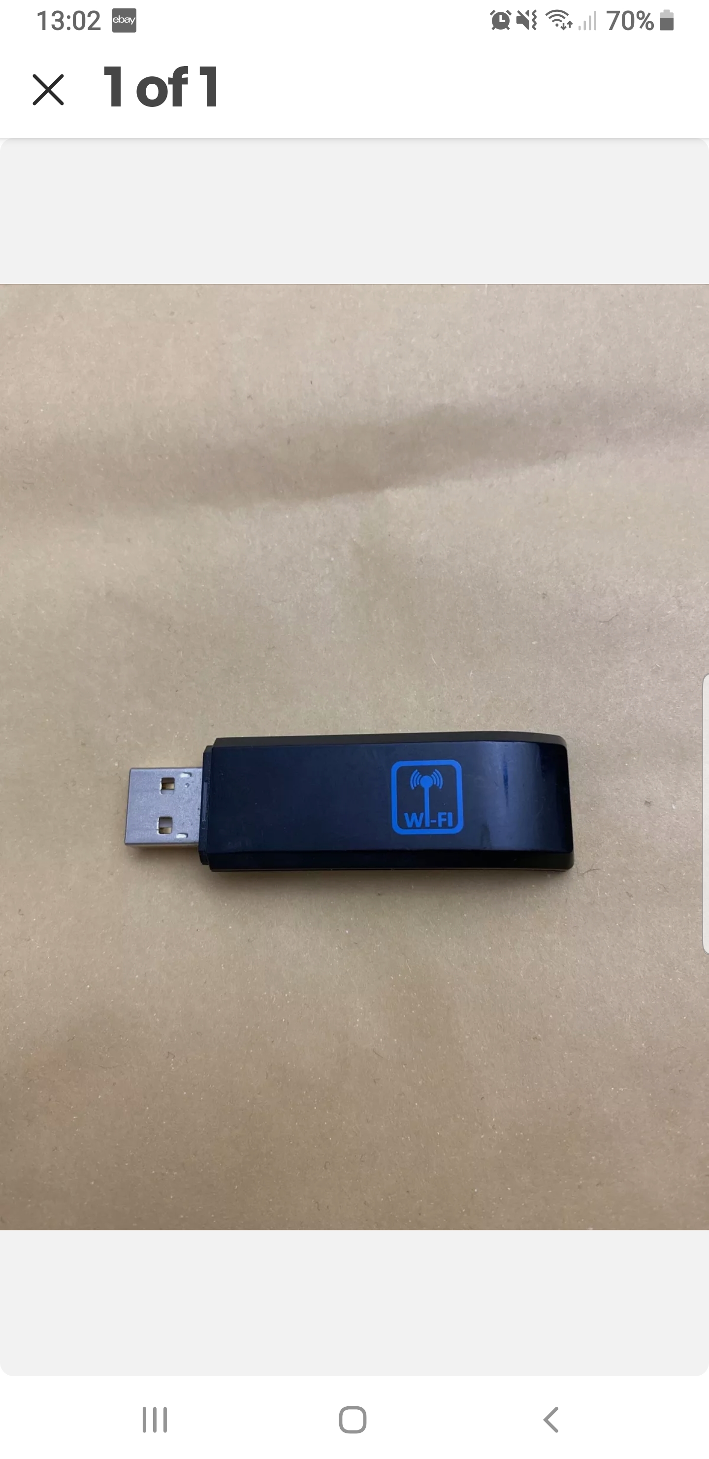

    Hi guys
    Just recently repaired the backlights on this set but then noticed that this vestel set does not have built in wifi but requires a dongle
    Vezzy 200 usb dongle is the required dongle which I cannot find
    So my question is does anyone know a compatible version that will also work on this vestel set
  • cheeky2
    • Dec 2012
    • 337
    • uk
    Re: Hitachi 42hxt12u wifi
    Vezzy 200 dongle is the only one that will work directly with these models. There are chinese units that derive the power from a usb port and are then connected up to the lan port on the TV. The configuration for the unit has to be done with a pc or laptop and cannot be done solely by the TV.
    I personally haven't tried them as they require some setup with a reasonable tech savvy customer and they are few and far between!
    Customers just want plug and play without too much configuation.
