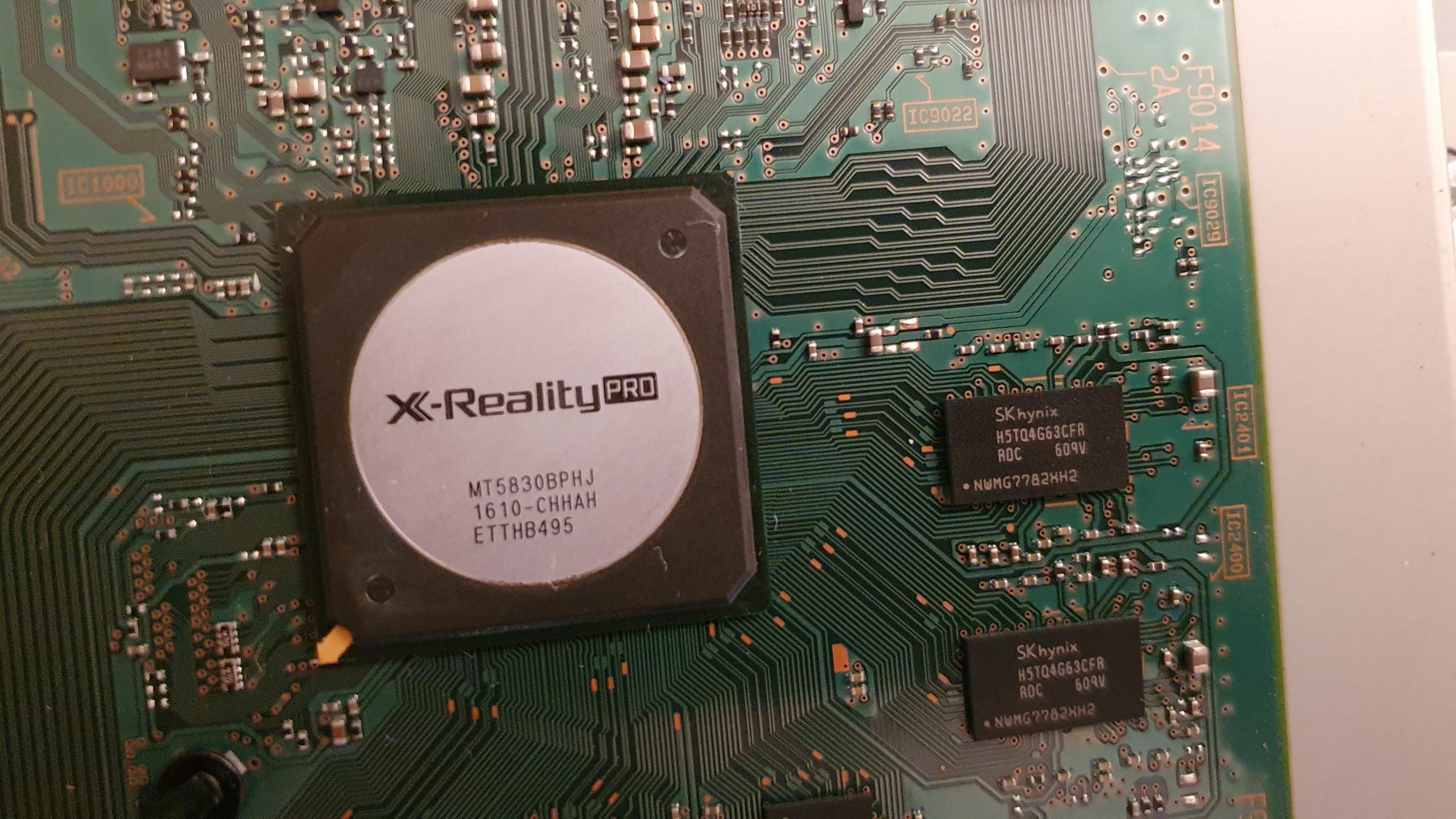

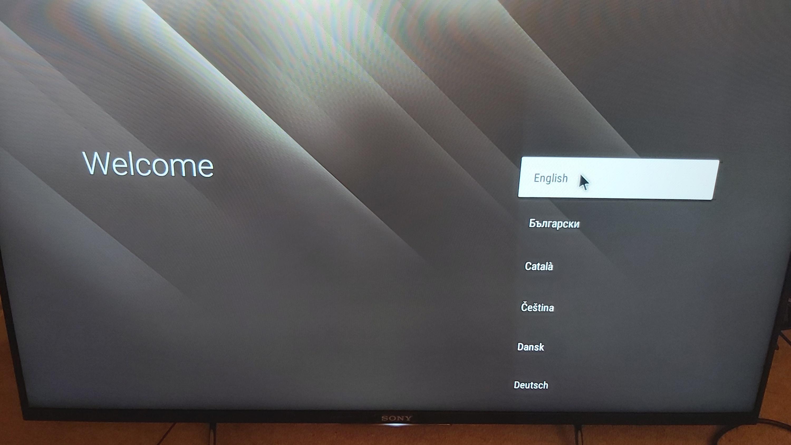

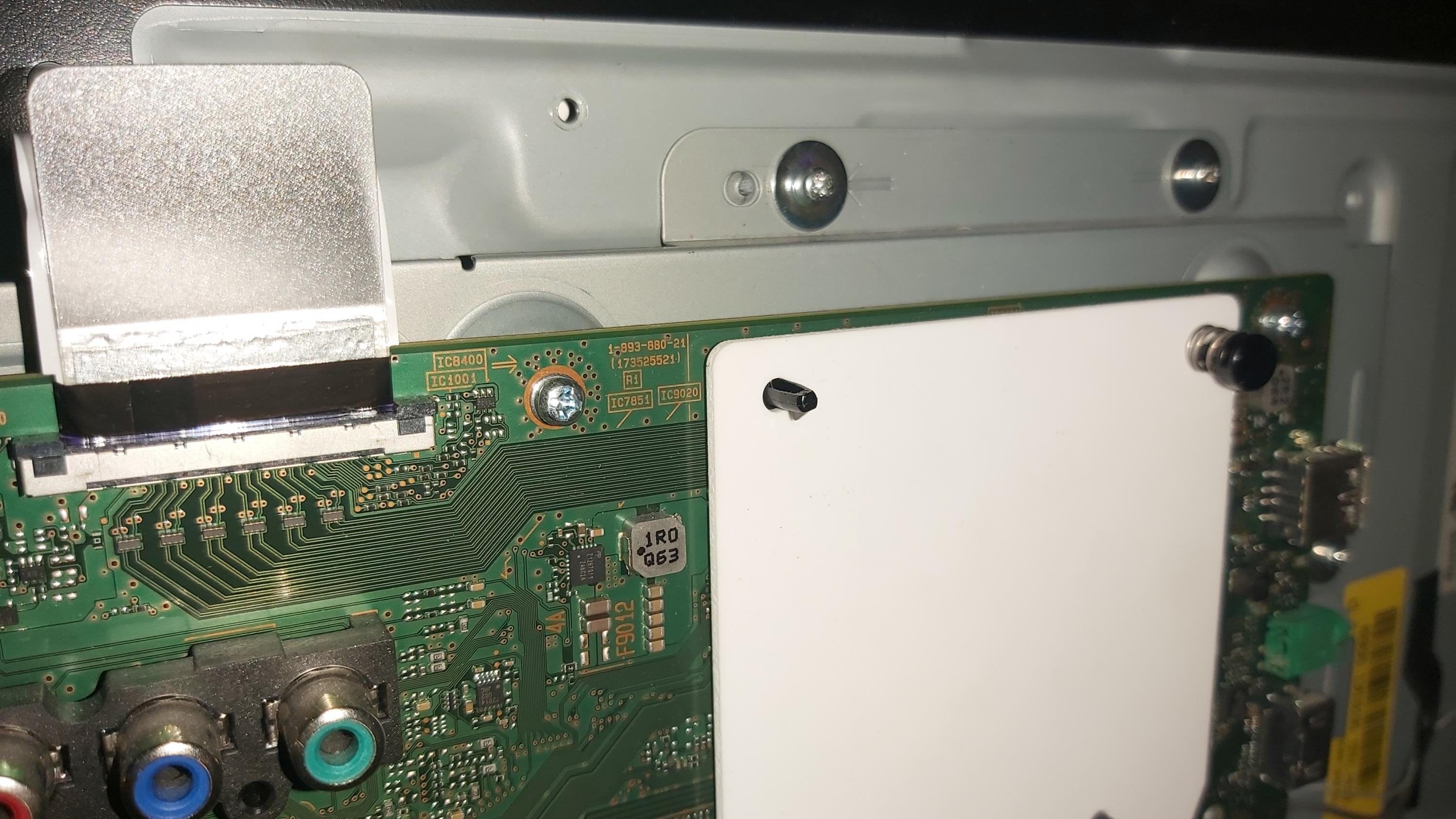

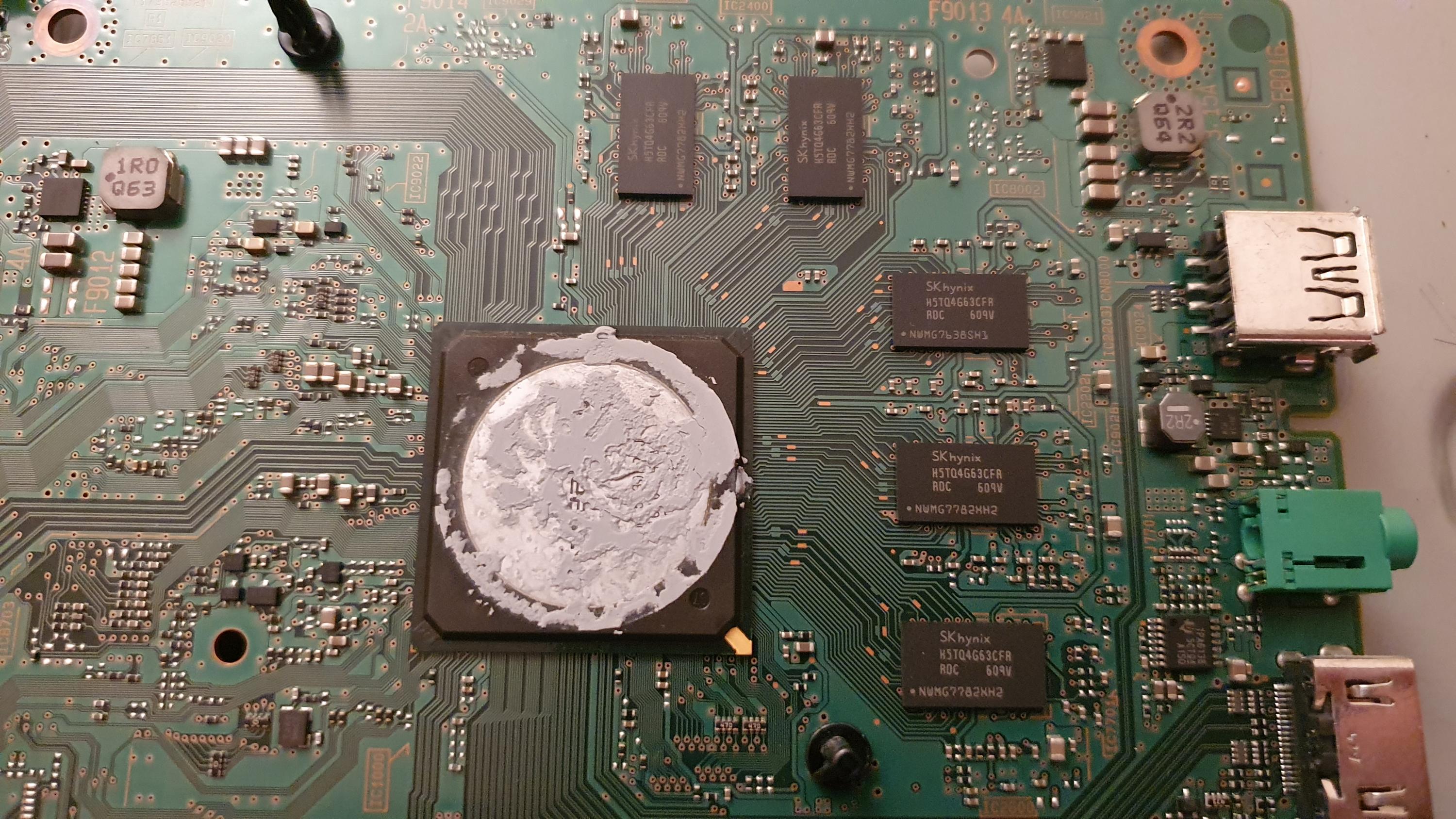

SONY KDL 43w805c does not accept commands
  • Diah
    replied
    Re: SONY KDL 43w805c does not accept commands
    which heat equipment do you have ? show me to let the work being perfect this area i mean
    Leave a comment:
  • Dobsuk
    replied
    Re: SONY KDL 43w805c does not accept commands
    Originally posted by Diah
    ok then heat this chip with hot air gun specially the middle to left side facing the plug which goes to side panel
    when you heat it try dont move the boards ...leave it cool then put it back
    For how long i need to heat it?
    Leave a comment:
  • Dobsuk
    replied
    Re: SONY KDL 43w805c does not accept commands
    I did in #27
    Leave a comment:
  • Diah
    replied
    Re: SONY KDL 43w805c does not accept commands
    ok then heat this chip with hot air gun specially the middle to left side facing the plug which goes to side panel
    when you heat it try dont move the boards ...leave it cool then put it back
    Last edited by Diah; 01-15-2021, 02:40 PM.
    Leave a comment:
  • Dobsuk
    replied
    Re: SONY KDL 43w805c does not accept commands
    Originally posted by Diah
    one things more before we go for heating... your photo https://www.badcaps.net/forum/attach...5&d=1610728654
    the side panel and led indicator IR receiver socket... are they connected with ribbon flat cable to the middle of the mainboards?? if yes... did you inspect under loop the end silver pins of the cable if any short or broken ???? yours issue very strange
    No, they are not with ribbon cables:
Name:	20210115_203512.jpg
Views:	1
Size:	501.8 KB
ID:	2059793
    Leave a comment:
  • Dobsuk
    replied
    Re: SONY KDL 43w805c does not accept commands
    Originally posted by Diah
    take out the heat sink... it need heating to repair the BGA ... by removing the heat sink we can tell from which side (PIN ) on ship are responsible
    This is it:
Name:	20210115_202656.jpg
Views:	1
Size:	776.7 KB
ID:	2059790Click image for larger version
Name:	20210115_203009.jpg
Views:	1
Size:	638.3 KB
ID:	2059791
    Leave a comment:
  • Diah
    replied
    Re: SONY KDL 43w805c does not accept commands
    one things more before we go for heating... your photo https://www.badcaps.net/forum/attach...5&d=1610728654
    the side panel and led indicator IR receiver socket... are they connected with ribbon flat cable to the middle of the mainboards?? if yes... did you inspect under loop the end silver pins of the cable if any short or broken ???? yours issue very strange
    Leave a comment:
  • Diah
    replied
    Re: SONY KDL 43w805c does not accept commands
    take out the heat sink... it need heating to repair the BGA ... by removing the heat sink we can tell from which side (PIN ) on ship are responsible
    Leave a comment:
  • Dobsuk
    replied
    Re: SONY KDL 43w805c does not accept commands
    Originally posted by Diah
    by the way... when it start at select language did you hear the music ? if yes you increase the volume or decrease from side panel... is there response and did you have notification bar ?
    Yeah, i can hear the music and the volume responds but cannot see notification bar every time. But he volume is working - i can turn it up or down even i can or not see the notification volume bar.
    Leave a comment:
  • Diah
    replied
    Re: SONY KDL 43w805c does not accept commands
    by the way... when it start at select language did you hear the music ? if yes you increase the volume or decrease from side panel... is there response and did you have notification bar ?
    Leave a comment:
  • Diah
    replied
    Re: SONY KDL 43w805c does not accept commands
    Originally posted by Dobsuk
    Yeah, i found the same but it looks it does not work. And can see the comments under the post, seems nobody has success with that rollback
    I tried and using your advice, Diah
    It looks i need to looking to buy Main board
    no need to buy new mainboards...
    take out the heat sink of the CPU and show what we have under it
    Leave a comment:
  • Dobsuk
    replied
    Re: SONY KDL 43w805c does not accept commands
    Yeah, i found the same but it looks it does not work. And can see the comments under the post, seems nobody has success with that rollback
    I tried and using your advice, Diah
    inset it in USB Port Ver 2. and do the procedure as you doing hard reset. you need to release the power & Volume - only when you see the usb led indicator start blinking
    It looks i need to looking to buy Main board
    Leave a comment:
  • Dobsuk
    replied
    Re: SONY KDL 43w805c does not accept commands
    Originally posted by Diah
    just to be sure you did hard reset correct..
    1-while the set on plug it out from wall socket
    2- plug out any cable / antena etc from the set ( keep it solo )
    3- press on the tv side panel volume - & power and keep press then plug it in wall ac again.. the front LED will change to green... after it change to green release the keys you pressed before.
    4- leave the set it will reset and it will show you first install but it will reset again and reboot..--- this mean after the set rebooted 2 time and the first install remain on screen the set finished reset.
    you must use air mouse. because its plug & play with android
    Yeah, mate! I did that few times. I can see the green led light and you can see that my TV is coming in the first Welcome screen after hard reset.
    Leave a comment:
  • Diah
    replied
    Re: SONY KDL 43w805c does not accept commands
    Originally posted by Dobsuk
    Thank you! I am going to try some of them now....
    there is procedure of rollback 2015 set firmware listed at Sony UK ,,you can download the pkg.
    Leave a comment:
  • Dobsuk
    replied
    Re: SONY KDL 43w805c does not accept commands
    Originally posted by Diah
    there are 2 kind of regions android 5 for Sony 2015 as yours w805c so i listed for you very early version for eua ...
    and this eua sony_tvupdate_2015_2637_eua_auth.zip
    Thank you! I am going to try some of them now....
    Leave a comment:
  • Diah
    replied
    Re: SONY KDL 43w805c does not accept commands
    just to be sure you did hard reset correct..
    1-while the set on plug it out from wall socket
    2- plug out any cable / antena etc from the set ( keep it solo )
    3- press on the tv side panel volume - & power and keep press then plug it in wall ac again.. the front LED will change to green... after it change to green release the keys you pressed before.
    4- leave the set it will reset and it will show you first install but it will reset again and reboot..--- this mean after the set rebooted 2 time and the first install remain on screen the set finished reset.
    you must use air mouse. because its plug & play with android
    Last edited by Diah; 01-15-2021, 11:42 AM.
    Leave a comment:
  • Dobsuk
    replied
    Re: SONY KDL 43w805c does not accept commands
    Originally posted by Diah
    did you use air mouse??
    Errm, no mate. I did not get you that you are talking about air mouse. Sorry. I do not have air mouse.
    Leave a comment:
  • Diah
    replied
    Re: SONY KDL 43w805c does not accept commands
    Originally posted by Dobsuk
    YEah it is working but for few seconds only... then it is freezing for few secs and so on.
    did you use air mouse??
    Originally posted by Dobsuk
    Found some procedure for downgrade on Internet but cannot find older firmware for my TV.
    Thank you, Diah!
    there are 2 kind of regions android 5 for Sony 2015 as yours w805c so i listed for you very early version for eua ...
    and this eua sony_tvupdate_2015_2637_eua_auth.zip
    Last edited by Diah; 01-15-2021, 11:30 AM.
    Leave a comment:
  • Dobsuk
    replied
    Re: SONY KDL 43w805c does not accept commands
    Originally posted by Diah
    f you did hard reset as press power and Volume - then plug set in AC and it show for you erase on screen .. then Air mouse will work.
    YEah it is working but for few seconds only... then it is freezing for few secs and so on.
Name:	20210115_162910.jpg
Views:	1
Size:	276.9 KB
ID:	2059781
    put the last update firmware on USB stick not larger than 4GB formatted FAT 32... inset it in USB Port Ver 2. and do the procedure as you doing hard reset. you need to release the power & Volume - only when you see the usb led indicator start blinking. do it many time until you succeed.
    Did that about 10 times but nothing - it is just looping in the boot logo and turn off again and on and off ..... May be it is not possible to reflash it with the same firmware version. Found some procedure for downgrade on Internet but cannot find older firmware for my TV.
    if this not help need to open the cover and show me the main boards to see which version its.
Name:	20201231_144004.jpg
Views:	1
Size:	406.7 KB
ID:	2059782Click image for larger version
Name:	20210114_122435.jpg
Views:	1
Size:	505.1 KB
ID:	2059783
    Thank you, Diah!
    Last edited by Dobsuk; 01-15-2021, 10:42 AM.
    Leave a comment:
  • Diah
    replied
    Re: SONY KDL 43w805c does not accept commands
    Originally posted by Dobsuk
    Yeah, but the point is it stuck on the welcome screen. So, i cannot use any APK to control it via the network until the tv is not connected to the network. And my problem is not that this volume graphic is missing... The problem is that it does not accept command neither from the remote control nor from the side control panel.
    Just tried with the mouse now and nothing - i can see the mouse coursor and move it for 2-3 sec and then it is freezing for few sec and so on.... Is there how to reflash the TV with USB stick even it is with the latest firmware already?
    f you did hard reset as press power and Volume - then plug set in AC and it show for you erase on screen .. then Air mouse will work.
    put the last update firmware on USB stick not larger than 4GB formatted FAT 32... inset it in USB Port Ver 2. and do the procedure as you doing hard reset. you need to release the power & Volume - only when you see the usb led indicator start blinking. do it many time until you succeed. if this not help need to open the cover and show me the main boards to see which version its.
    Last edited by Diah; 01-15-2021, 09:44 AM.
    Leave a comment:
  • crackedprint
    Sony HCD-HX80R Amplifier Volume Control Problem
    by crackedprint
    I have a strange fault on a Sony amplifier. The volume control varies the display from MIN, then 1 up to 30 and then MAX as expected. At MIN there is no sound. However, at 1 it is quite loud and increasing above 1 does not change the sound level.
    I have tried a Cold Reset as per the service manual.
    I have looked at the I2C clock and data to volume control chip IC501 (BD3499FV). Data is only sent to IC501 when the volume is set to MIN or 1. At any other setting no data is sent to IC501.
    I have looked all the way through the service manual and tried many online...
    01-21-2025, 12:18 PM
  • karthur
    Vizio D65x-G4 Volume changes on its own
    by karthur
    On this Vizio D65x, the volume will change on its own. I don't mean like during commercials where the volume will increase. I mean its like the (+) volume button on the remote is pressed and the actual volume dialog is displayed on the screen going up. It will do this, then the volume may start going down. It might go all the way to "0"or it might stop at a different number, then start going back up. The whole time its doing this, the volume dialog is shown on the screen.
    It wont do it until it has been "ON" for 20 or 30 minutes, so it does seem to be heat related....
    06-05-2025, 08:13 AM
  • Carlos#2003%
    by Carlos#2003%
    02-15-2024, 07:52 PM
  • Ruptor
    Sony MHC 6600 volume clicking
    by Ruptor
    Has anybody had the problem of the digital clicking from the volume control coming through the speakers. I guess the mute should activate as everything seems to have a mute from the analogue switch LC7822 to prevent output of stuff on the speakers but the mute circuits are really complex. The pcb is very badly manufactured as if it is over etched and not cleaned properly before being screen printed because I have fixed one fault but a wide track lifted off real easy with very little heat requiring extra repair. I dread touching the board so would like to go straight to the problem if someone has...
    05-21-2023, 05:32 AM
  • jason123
    Sony STR-DN1030 Distorted audio when Volume adjusted
    by jason123
    New to Audio equipment. Received this 7.2 Surround Sound system - had a blown channel and fixed that (0.22 ohm resistor, 2 transistors, and 1 100 ohm replaced)
    All channels now work. However, when I raise the volume with knob or remote, it doesn't work smoothly - you can heard distortion, and some speakers don't seem to work at max or somewhere in between..
    First thought was the actual audio switch - but then Remote volume control shouldn't have this problem, but it does.
    Second thought was the ribbon cable from front display to control board (V-Flex,...
    06-05-2022, 12:54 PM
