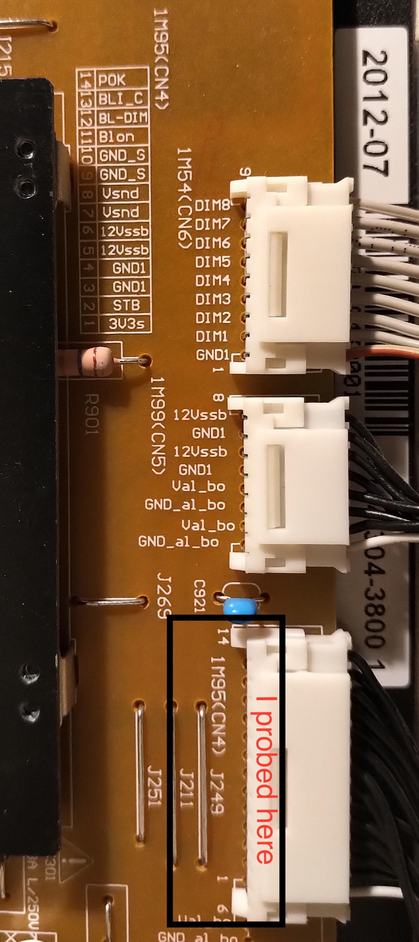

    Probing signals on 1M95 (CN4), I see
    Code:
    1M95 voltages (reference to P3, GND1) with mains applied:
    1: 3.3
    2: 3.07
    3: GND/Ref
    4: 0
    5: 0.09
    6: 0.09
    7: 0.09
    8: 0.09
    9: 0
    10: 0
    11: 0
    12: 0
    13: 0.48
    14: 0.26

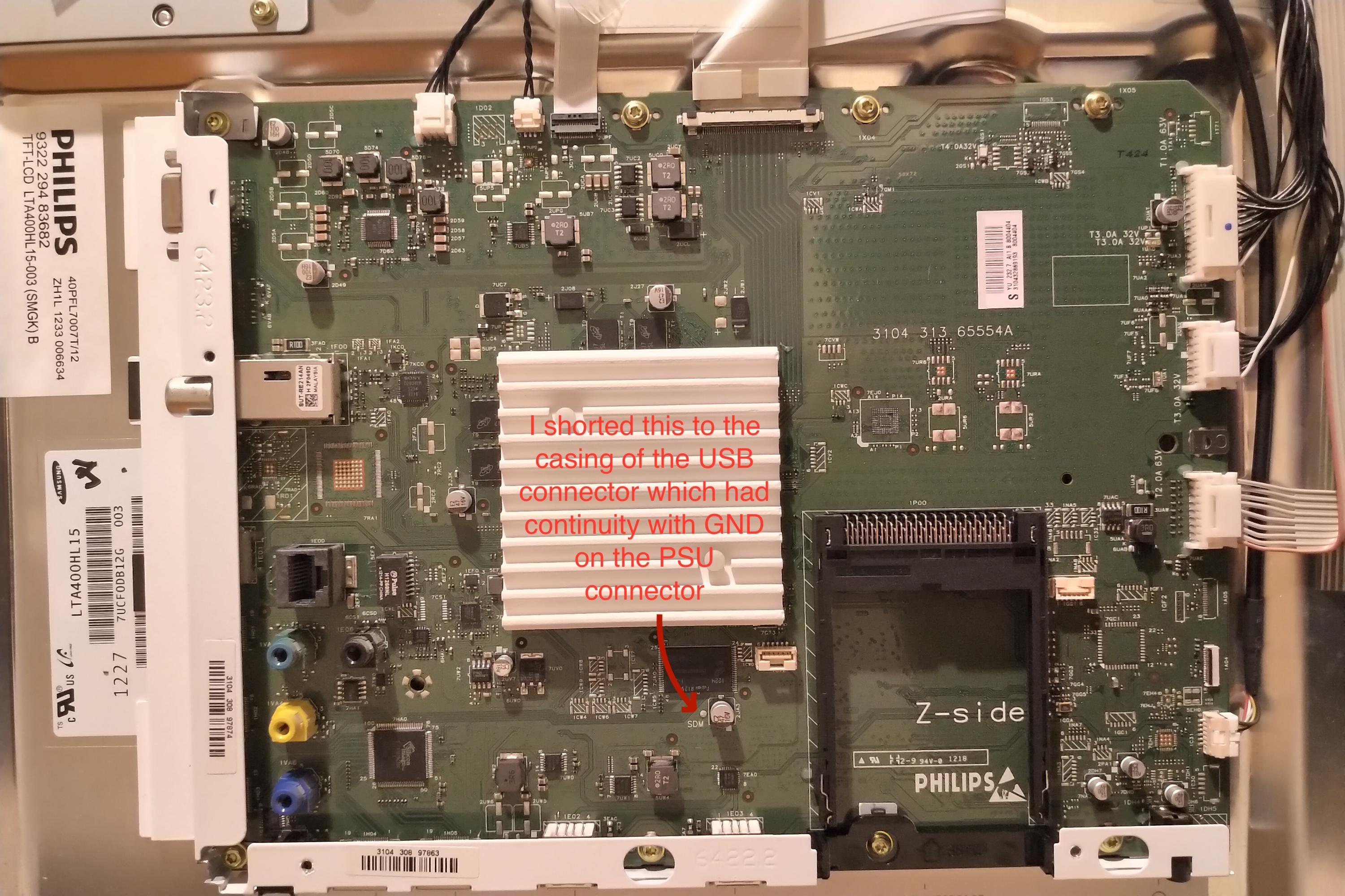

    I wanted to get into one of the diagnostic modes, so I tried shorting the SDM solder blob on the main board to GND, but that makes no apparent difference. I also tried having them shorted while plugging the TV in (well, turning on at the wall). Also no dice. Not sure I have understood how to use this jumper right though. I waited for 2 minutes after doing this to be sure there were no blinks.
    After reading on this forum that these Fusion chips sometimes need re-balling, I also tried just… pressing... the heatsink down and plugging the TV in. Also no joy.

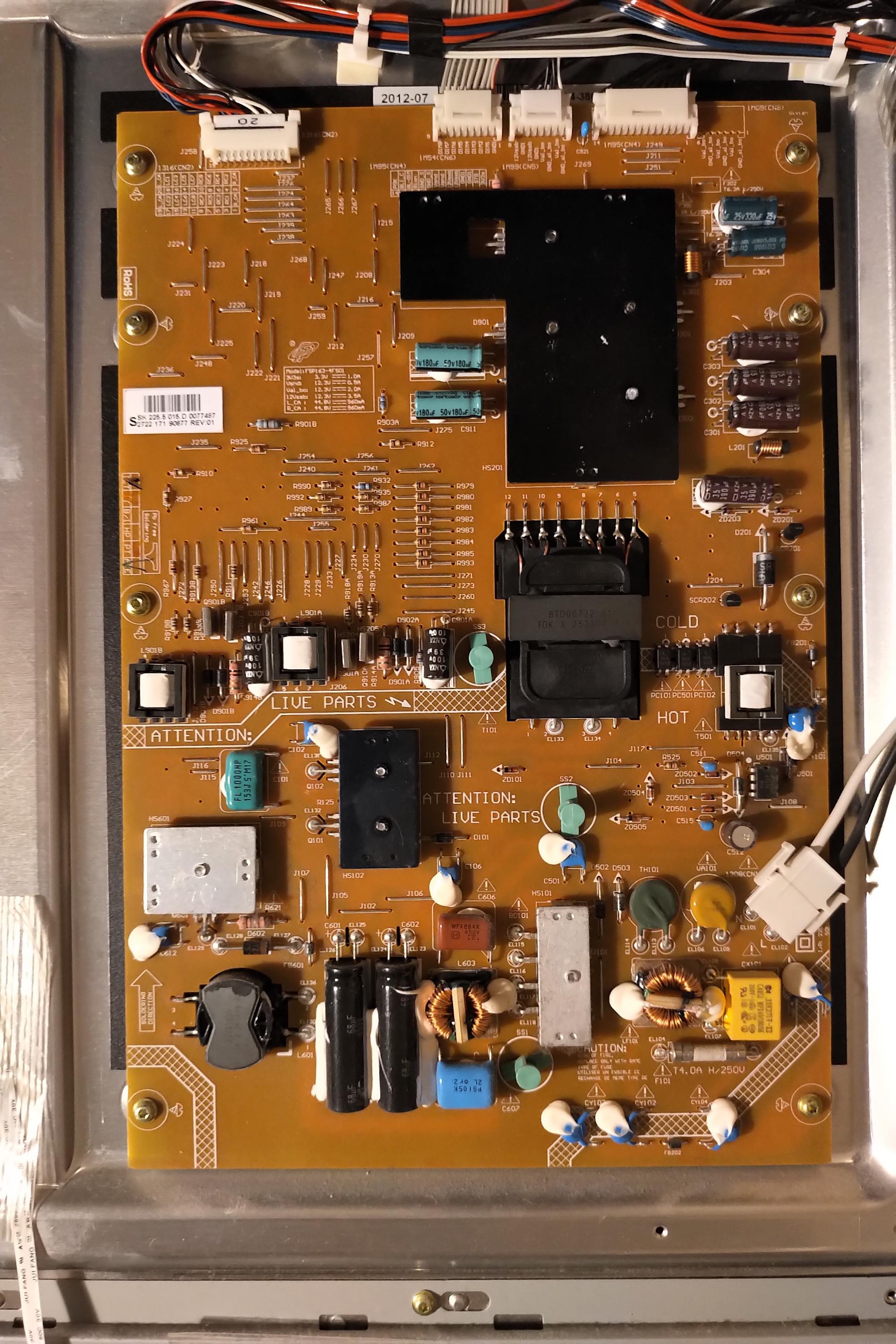

    Re: Philips 40PFL7007T/12 debug and repair. Fusion chip or PSU?
    could you show complete photo of the PSU and one close one on the CN4 printing label to know the name of the pins you listed above... or writing them here ..????

      Thanks for the quick answer, sorry about the missing info.
      PSU:

      (I took the chance to annotate what I did exactly when I said I'd shorted SDM to GND in case I messed that up)
      Detail for the pin allocation of the connector:

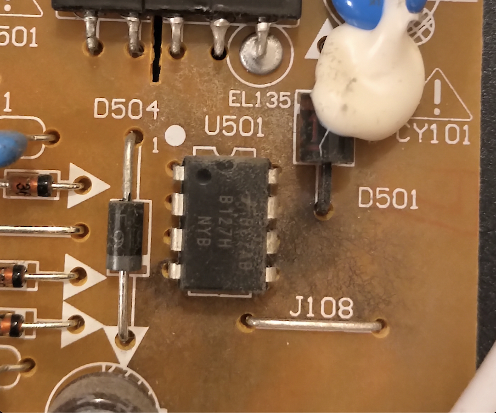

              U501 is the SMPS power supply for the 3.3Vstandby power supply.
              Okay, so I guess it doesn't make sense for that to be the issue as we definitely seem to have 3.3V standby coming up right away.
              Is the level of blackening around it normal? Struck me as a bit odd, but this is the first TV I've had open...

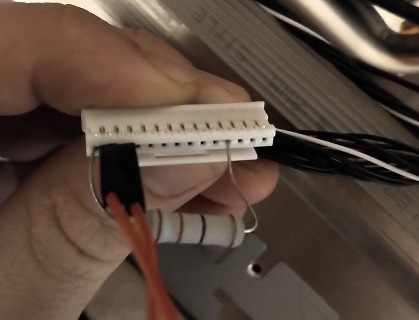

                  Here's what I did
                  * remove all power
                  * disconnect main board from PSU (3 connectors, 1M54, 1M99, 1M95)
                  * Jumper P2 to P3 (GND) (jumper into female socket on disconnected end of connector)
                  * Test for continuity between P11 BLon and GND. --> no beep, ~90k when measured but looks dynamic (drifts down to 90K), so assuming this counts as no connection...
                  --> install jumper of 220R (all I have to hand, from a Kenwood Mixer repair kit!) from P11 to P1.
                  * Confirm jumper with multimeter, 0.2k
                  * Connect mains and power-on TV. No sign of backlight - either flicker or stable. I turned off the lights in the room to be sure I wasn't missing a flicker. If there is one, it's faster than I can see.
                  --> Measure voltage at P11, BLon: 3.2V (I think this confirms jumper OK)
                  --> Measure voltage at P5 (12VSSB) - 12.42V (think this confirms STB pulled down okay)
                  My jumper setup is attached.
                  Does this shed any light (sorry, couldn't resist) on the situation?
                  It looks like 1M54 (which I have disconnected) carries a series of "DIM" signals from the ssb to the PSU. Any chance I need to mess with BL-DIM too? I assume that's a secondary thing?

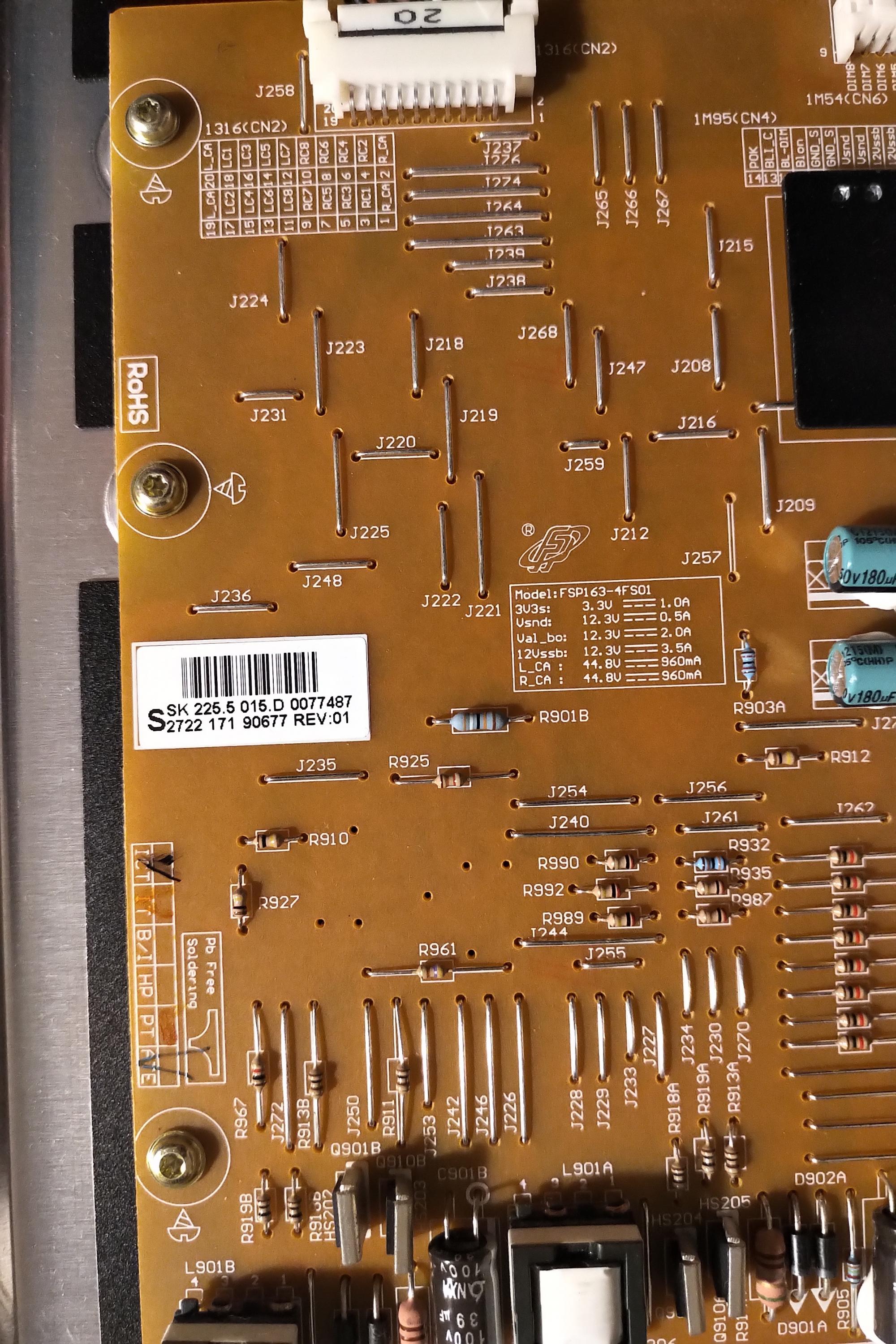

                    you have edge BL. right? can you focus photo on the BL socket label ?
                    also you have label on PSU addressed the voltage of BL socket same way to the one goes to MB
                    • mailforwho
                      • Dec 2020
                      • 13

                      • mailforwho
                        • Dec 2020
                        • 13

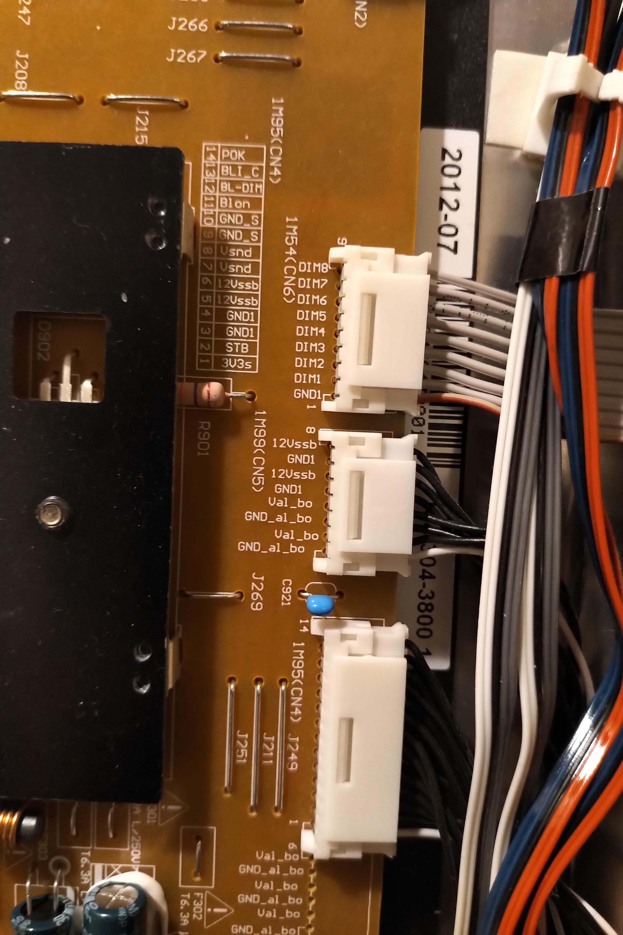

                        Sorry, I don't understand all the questions... Is this about the nature of the panel? I honestly don't know. I'm pretty sure it's an LED backlight. I made sure to lift up the panel enough to see the front too - I think I'd see light leaking through the LCD even with the panel off?
                        Yea, attached...
                        Again I'm afraid I'm not sure what the question is... I was taking measurements from the PSU side of the connector, and when I added the jumper to ground STB, I got the 12V supply in the right place, so I think I've got the connectors/pins the right way around. Is that what you meant?

                                  Originally posted by mailforwho
                                  Thanks for your help - what makes you suspect the backlight? As far as I can tell the BL is only turned on once the main MCU boots, not the standby MCU, but I don't see any sign the standby MCU is finishing boot because it should ground STB once it does to bring up everything else? Are there failures of the backlight that can take out the board in general?
                                  Is taking out the panel/diffuser just so I can see the BL state?
                                  Jonny
                                  in normal cases if we feed the BL ON with 3.3V as you tested before it will turn on with out main boards. the age of the TV. and from the LED BL socket you showed here.. its hard to make test from out side.. beside yours panel 40 its easy to take it apart.. after you remove it and other sheets you will have access to BL. i dont know what kind or type or how they are connected neither you... so left only to access to them. if any user over here had access on this model BL will be nice to tell here.. to me i didn't for this model .. but i faced many other Philips sets failed edge LED and they were newer than yours model.
                                  • mailforwho
                                    • Dec 2020
                                    • 13
                                    Looks like there's some info here:
                                    https://masterelectronicsrepair.blog...0pfl7007t.html
                                    I think this is the most helpful bit
                                    Main features of the PHILIPS 40PFL7007T device:
                                    Installed matrix (LED panel) LTA400HL15 code 003.
                                    To power the backlight LEDs, a converter is used, combined with a power supply unit, controlled by a PWM controller 0Z9909TN x 2, LM358G.
                                    https://www.panelook.com/LTA400HL15_...iew_16750.html is the panel.
                                    I'll have a look tomorrow and decide whether I'm going to brave the next steps!
                                      "12: BL-DIM: 0" you need 1K resistor between BL-DIM and STBY 3.3V since the BL-DIM does not have pull-up resistor.
                                      • Diah
                                        • Feb 2013
                                        • 6363

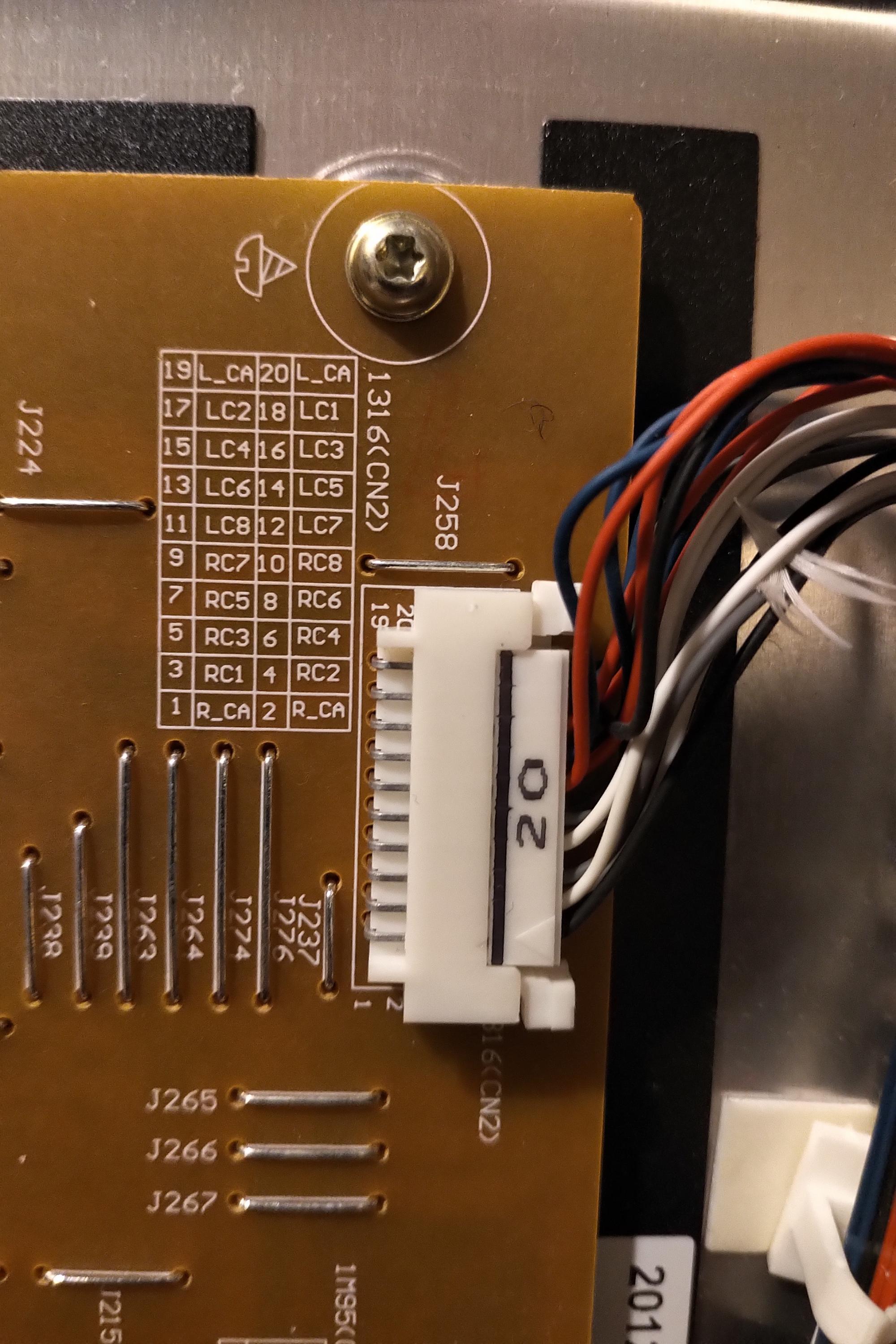

                                        you can also test. put back all sockets in place. read VDC on LED socket (CN2) pins L_CA & R_CA references to TV chassis.. power on and notice if there any activity on both pins.
