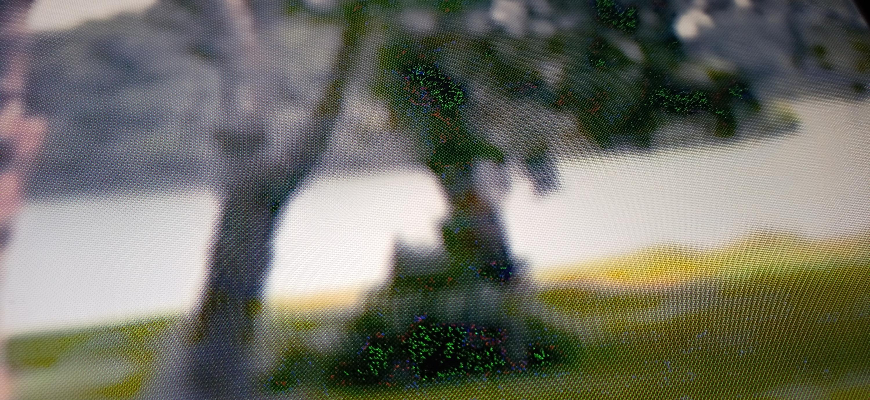

    Tv works normal except for the green snow in the picture. Not everywhere at once maybe following darker shades or similar.

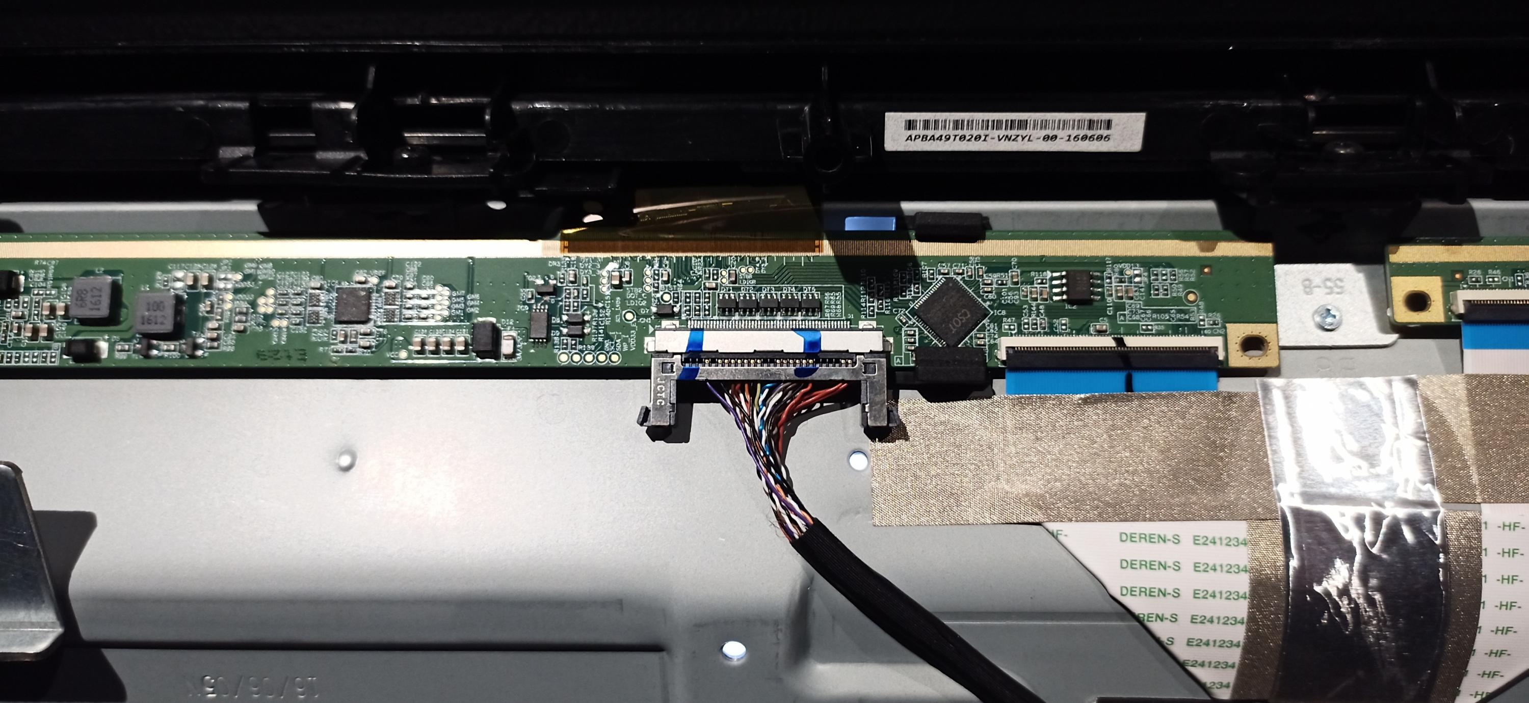

    Tcon is integrated in the panel boards but I did measure gamma 1-14 and they're ok. Also 1.3v and 3.3v present there. VREF is 16.3v.
    Main board processor is NOT a bga so it's not that but It may be failing internally.
    Thoughts on whether I should go with a replacement board or further investigate the tcon ?

    play around with the LVDS cable... sometimes that style develops a dodgy connection. Looks like Tcon to me otherwise...

      Don't see anything wrong with the cable definitely pulling and replugging doesn't make a difference.

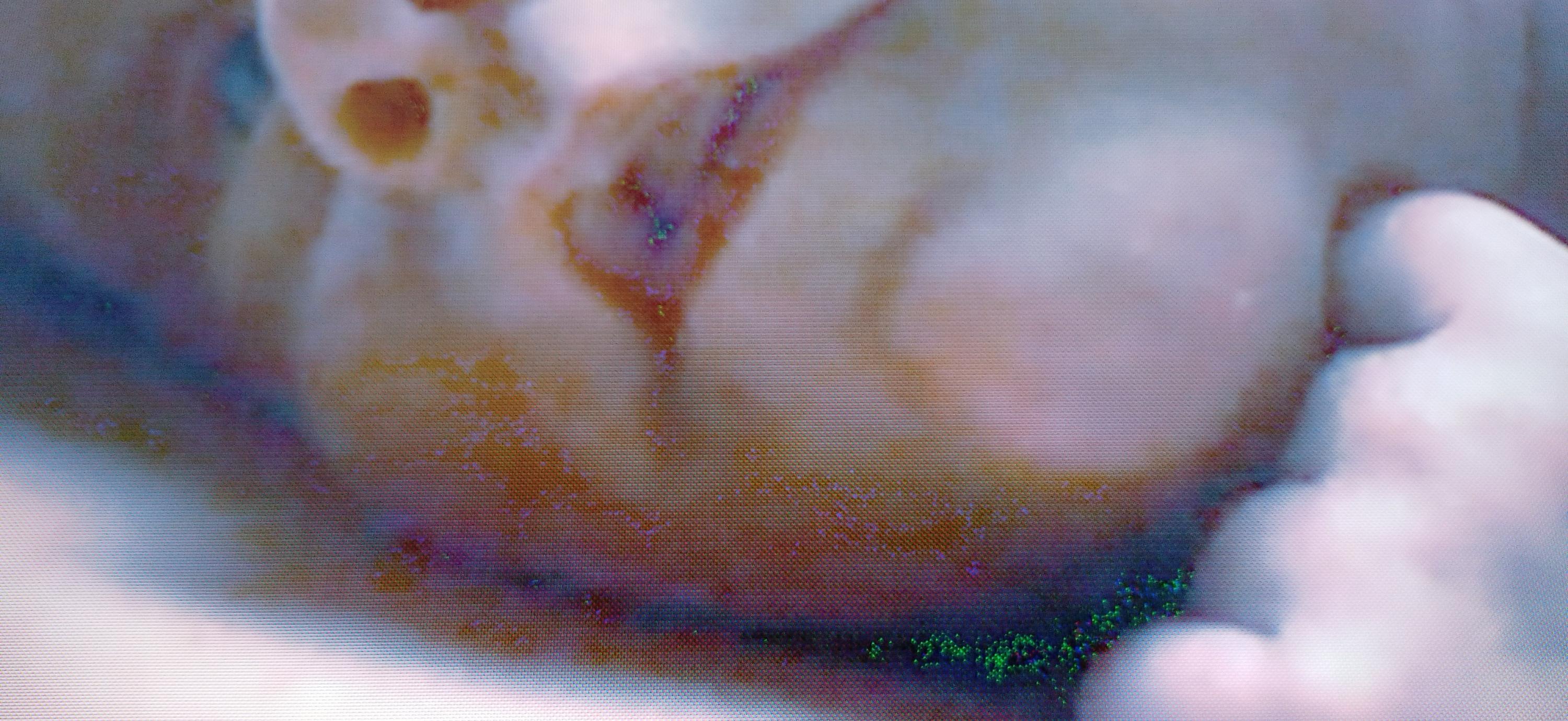

      I should have said the artifacts are not seen at startup they appear within a couple of minutes of turning on so related to something heating up. I put a heatsink on the main processor didn't help.

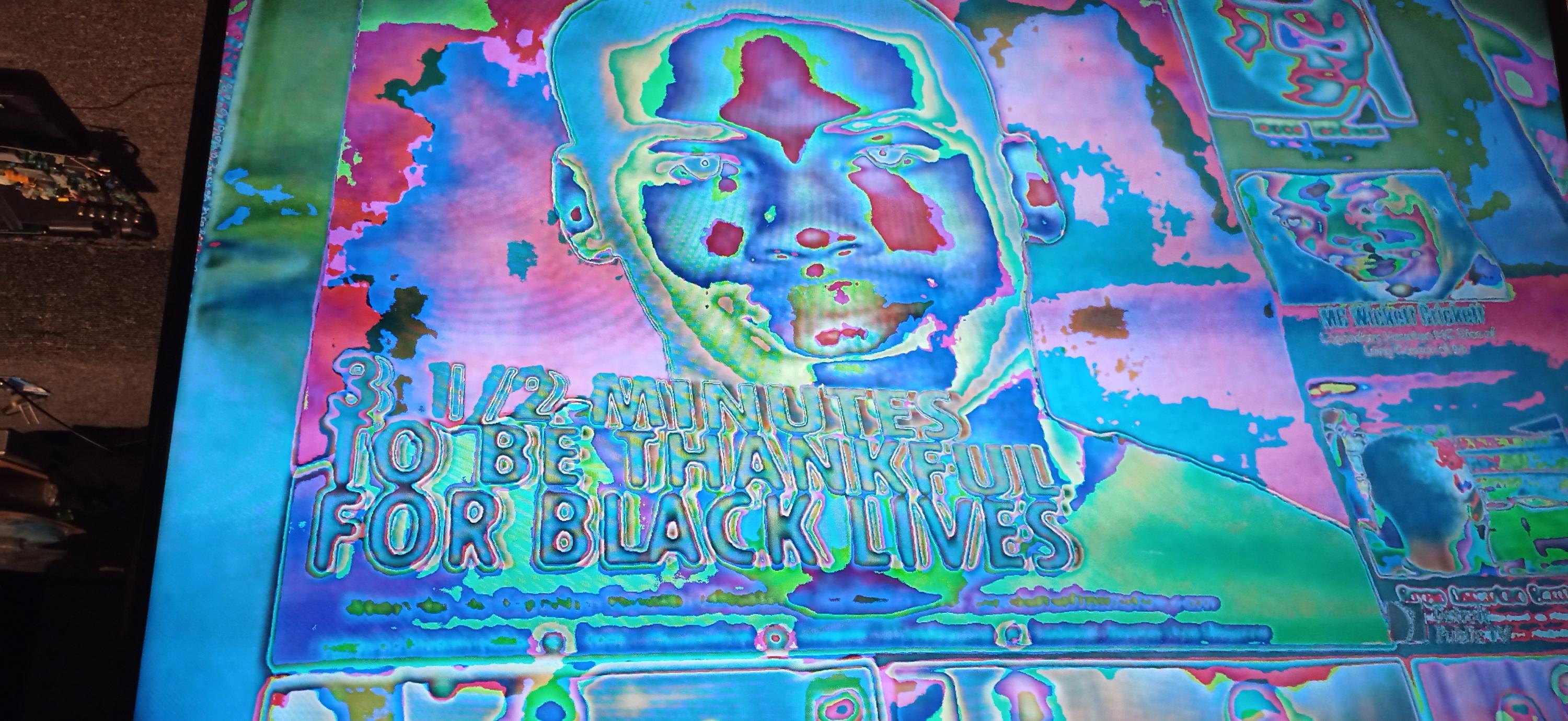

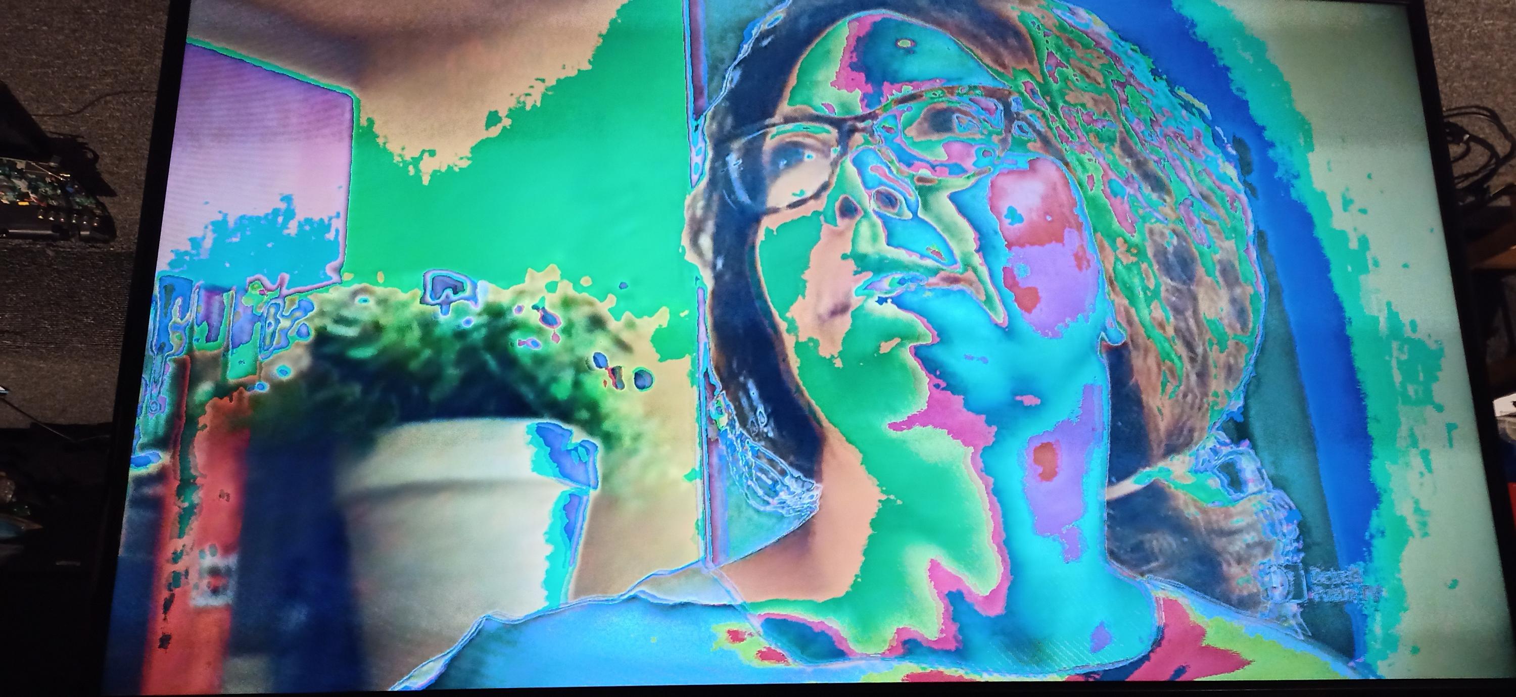

          To try and eliminate the main board as the problem I Frankensteined in an RCA main board.
          Looks great if you're on LSD.
          I went into the service menu and can make changes to the panel type but of course there's no going back should I make the wrong choice...
          Have a few more candidates before I quit this approach.

                • mmartell
                  • Oct 2013
                  • 3189
                  Re: Toshiba 55L310u Noise/Snow in Picture
                  Replacement main board produces the exact same issue. Problem must be on the tcon.

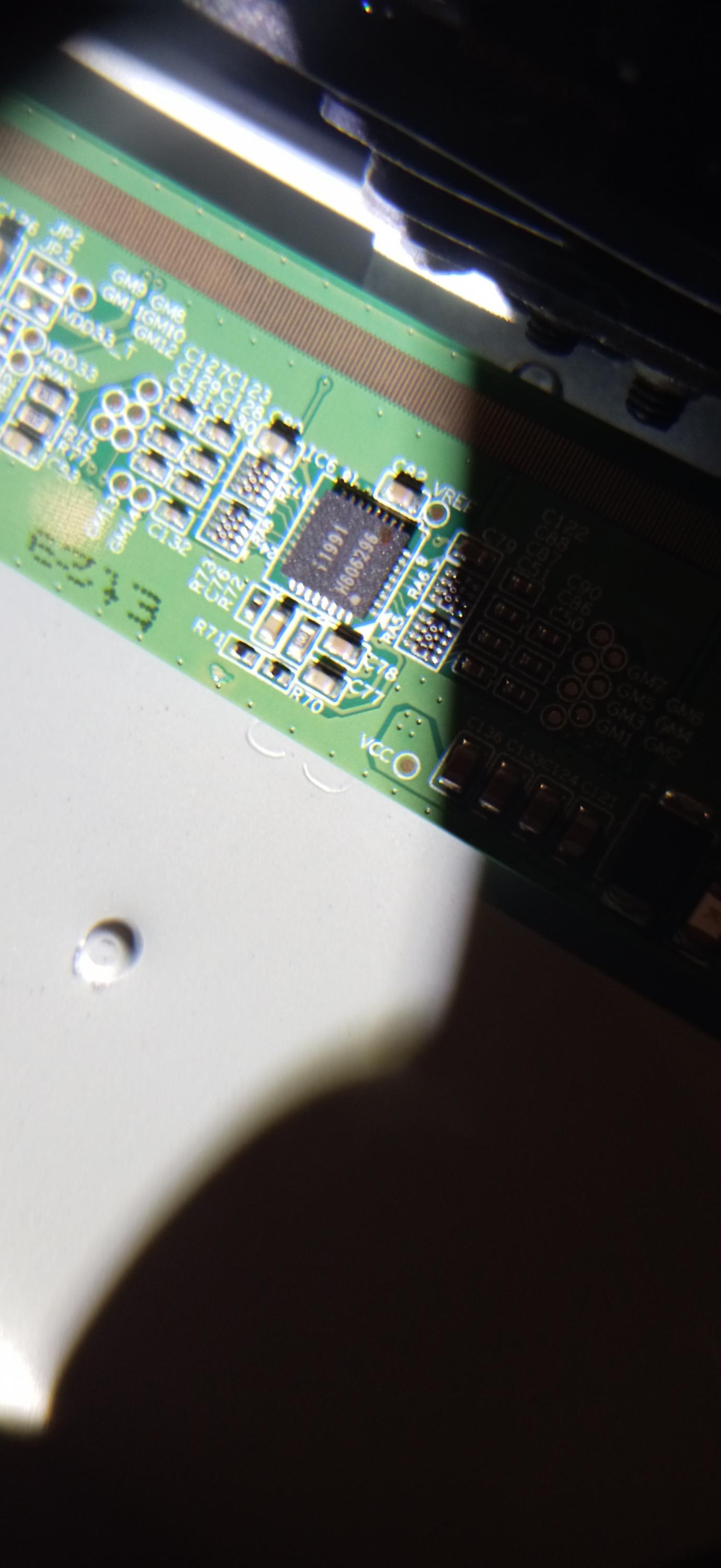

                        Don't know how I missed this but this ic probably the gamma ic labelled i1991 is sensitive to temperature swings. Heating it causes the pic to bloom almost white and cooling it with a shot of upside down canned air snaps the pic back to beautiful with zero artifacts. It didn't feel hot to the touch though which I find odd.
                        I removed it and put it back and the pic looks great but the ic is roasting hot now, can't keep a finger on it.
                        Anyone know anything about this ic or know of an alternative ? It's a QFN32 package.
                        • mmartell
                          • Oct 2013
                          • 3189

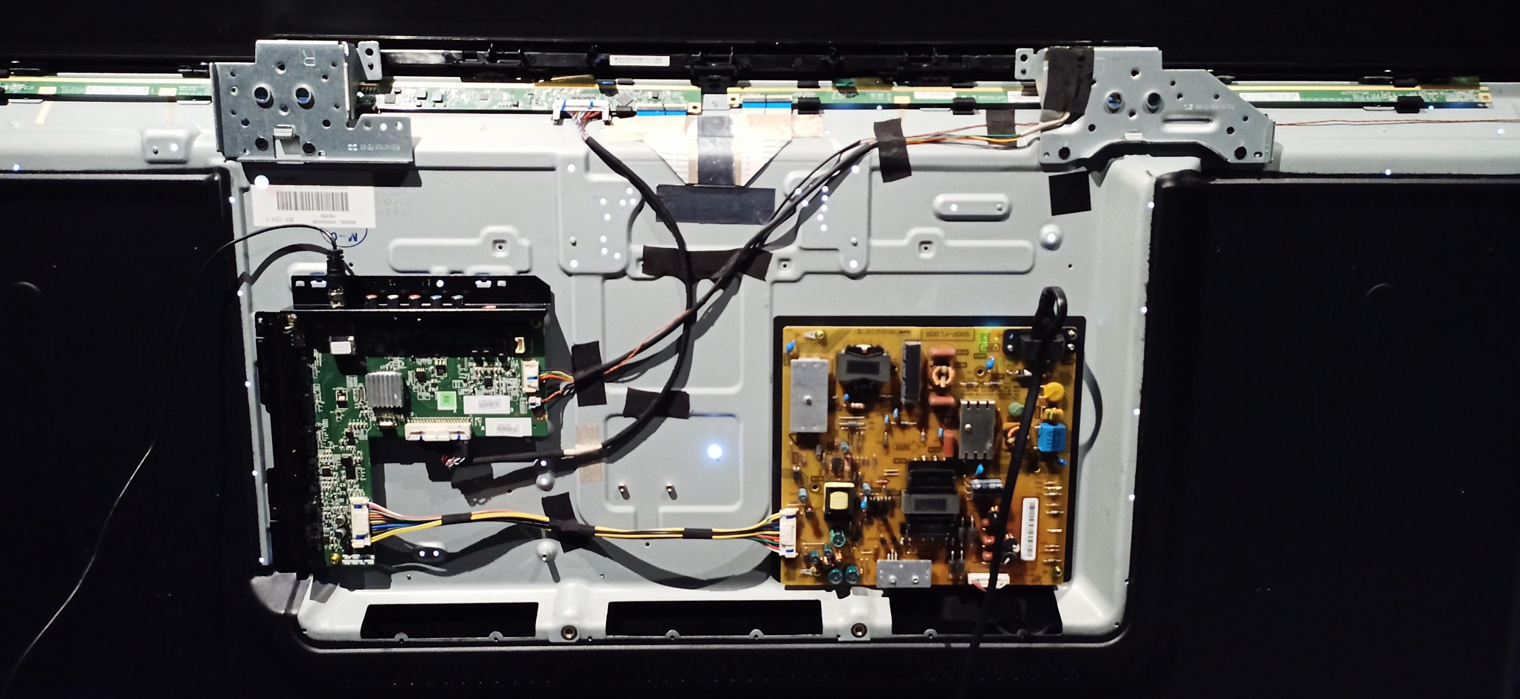

                          And here's a pic of it...
                          • mmartell
                            • Oct 2013
                            • 3189
                            I put one of those thick heat transfer pads you find under YSUS boards on this ic and it's running HOT, the rubber is almost too hot to touch!
                            It's running though without artifacts but I'm afraid to leave it unattended in case it catches fire lol. Maybe these chips run very hot under normal operation ?
                            Edit: NOT normal. I was starting to see a darkish spot at the bottom of the lcd panel where the gamma ic is. Definitely running too hot!
                            If anyone has one of these I would like to purchase it instead of waiting for shipping from China as Aliexpress is the only place I can find it.

                                • mmartell
                                  • Oct 2013
                                  • 3189
                                  This has been resolved by changing out the IC in question.
                                  Big shout out to jjanssen7 for tossing one in the mail to me from a scrap set he had on hand.
                                  Thanks for everyone's input.
