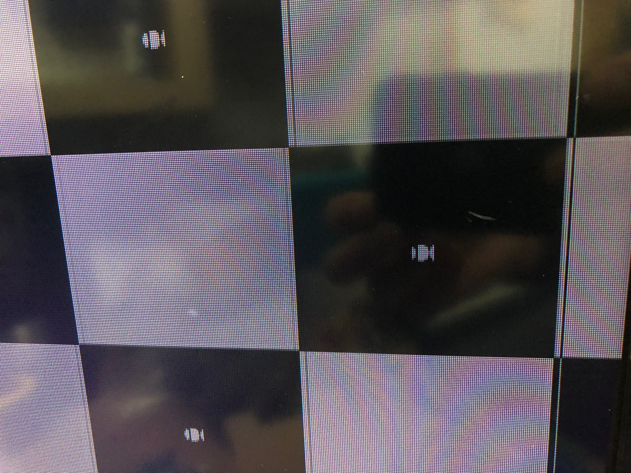

                To give a status update, decided to clean the board with Alcohol once again, but a bit more aggressively and used shop air to dry off. It now turns on normally now on the the next issue, image quality. As you can see in the picture, columns of pixels seem to be offset, according to the previous posts once again point to the main board, any magical fix? or way of knowing it really is the main board and not the T-Con? it is looking like a good blast of heat with the heat gun to possibly reflow something as a last desperate measure as Diah mentioned before I part out the rest, in case someone is interested in parts.

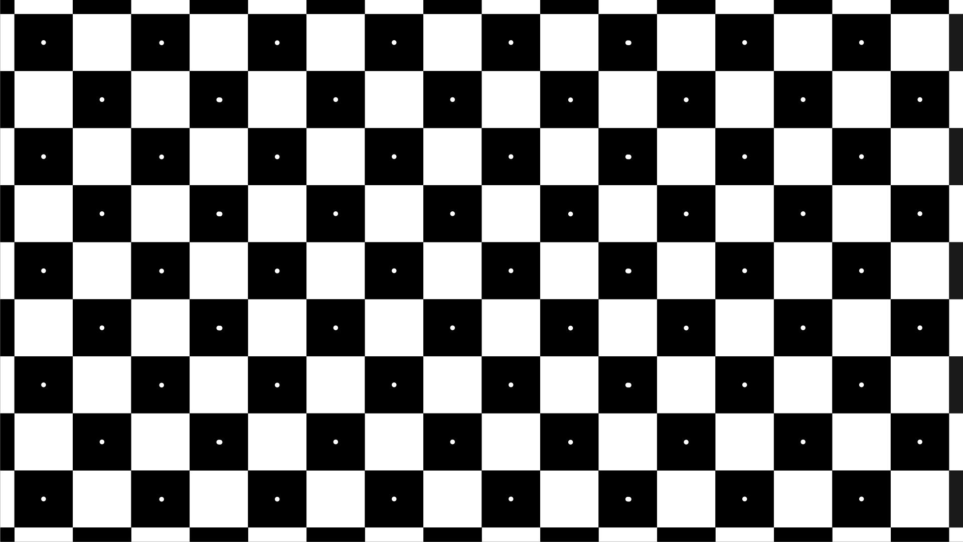

                  put this HD test picture on USB and play it on the tv... show the result

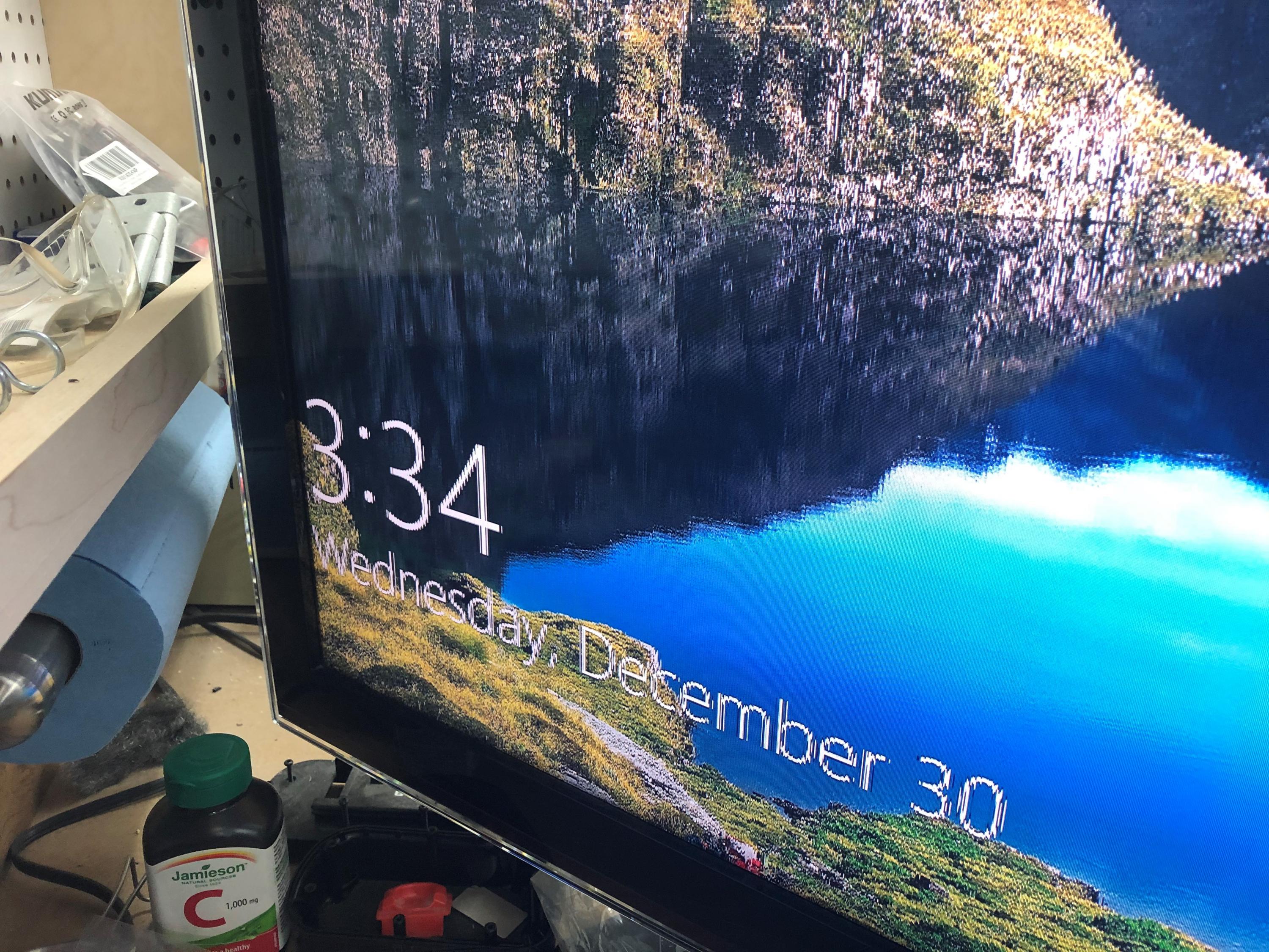

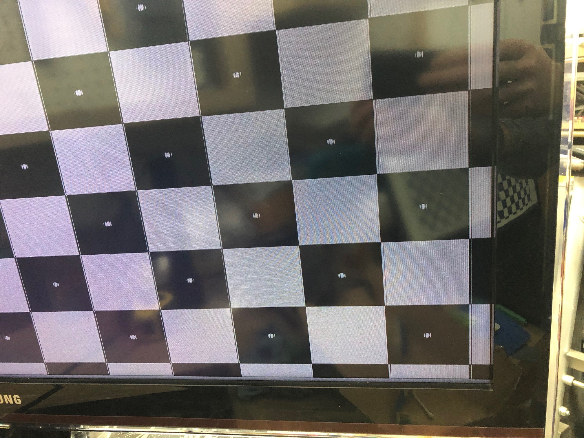

                    #29
                    Re: Samsung LN40D630/BN96-19438A main board noise
                    See attached pictures, I was not able to take a picture of the complete screendue to the position on my workbench, however i confirm it is the same across the screen.
                    this was put up via my laptop and HDMI Cable if it makes a difference
                    I also have to say thank-you for taking the time to help with this.

                      #30
                      its white offset.... BGA on main board.. go more aggressively with BGA ICs
