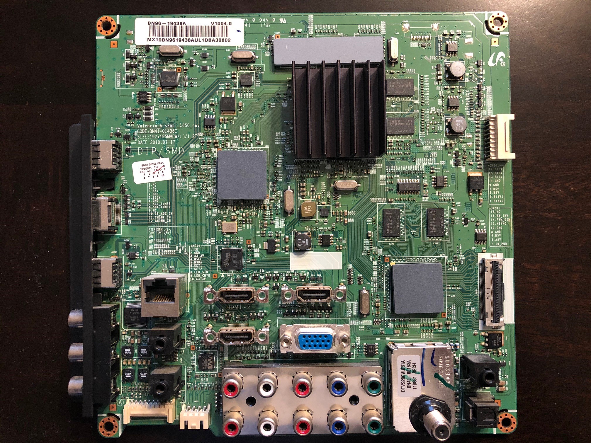

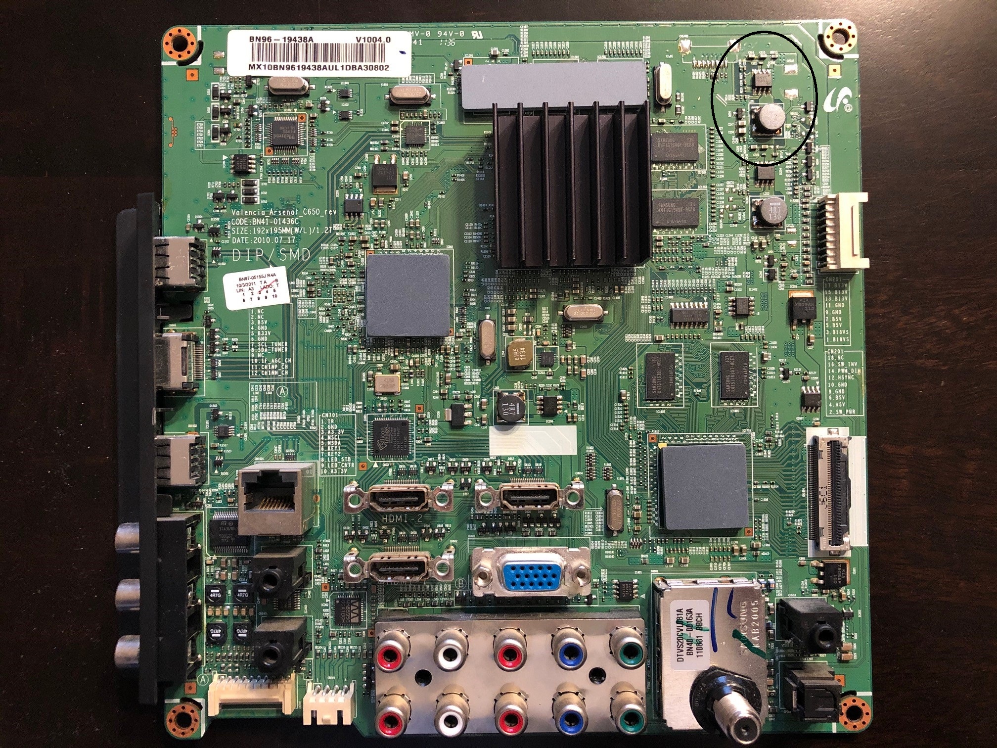

        SPI Flash IC are with 8 Pins IC which it responsible of starting firmware and back light too... i cant tell from yours photo where it is.. the label print on it should include No 25
        BTW did you disconnected the socket between main boards and power boards then turn it on.. to see if the back light will come on and stay stable on.
        • Plane Nuts
          • May 2019
          • 52
          Re: Samsung LN40D630/BN96-19438A main board noise

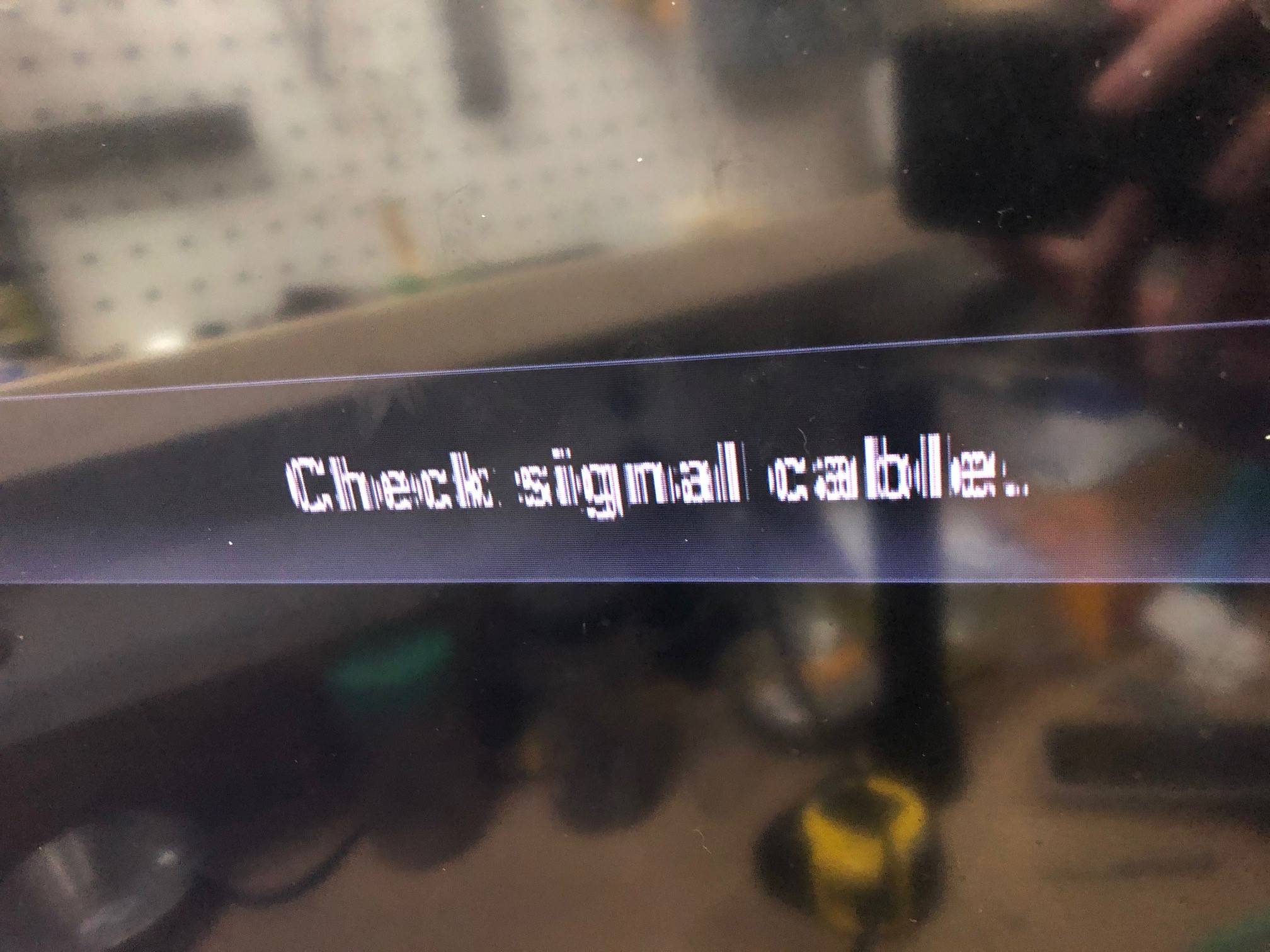

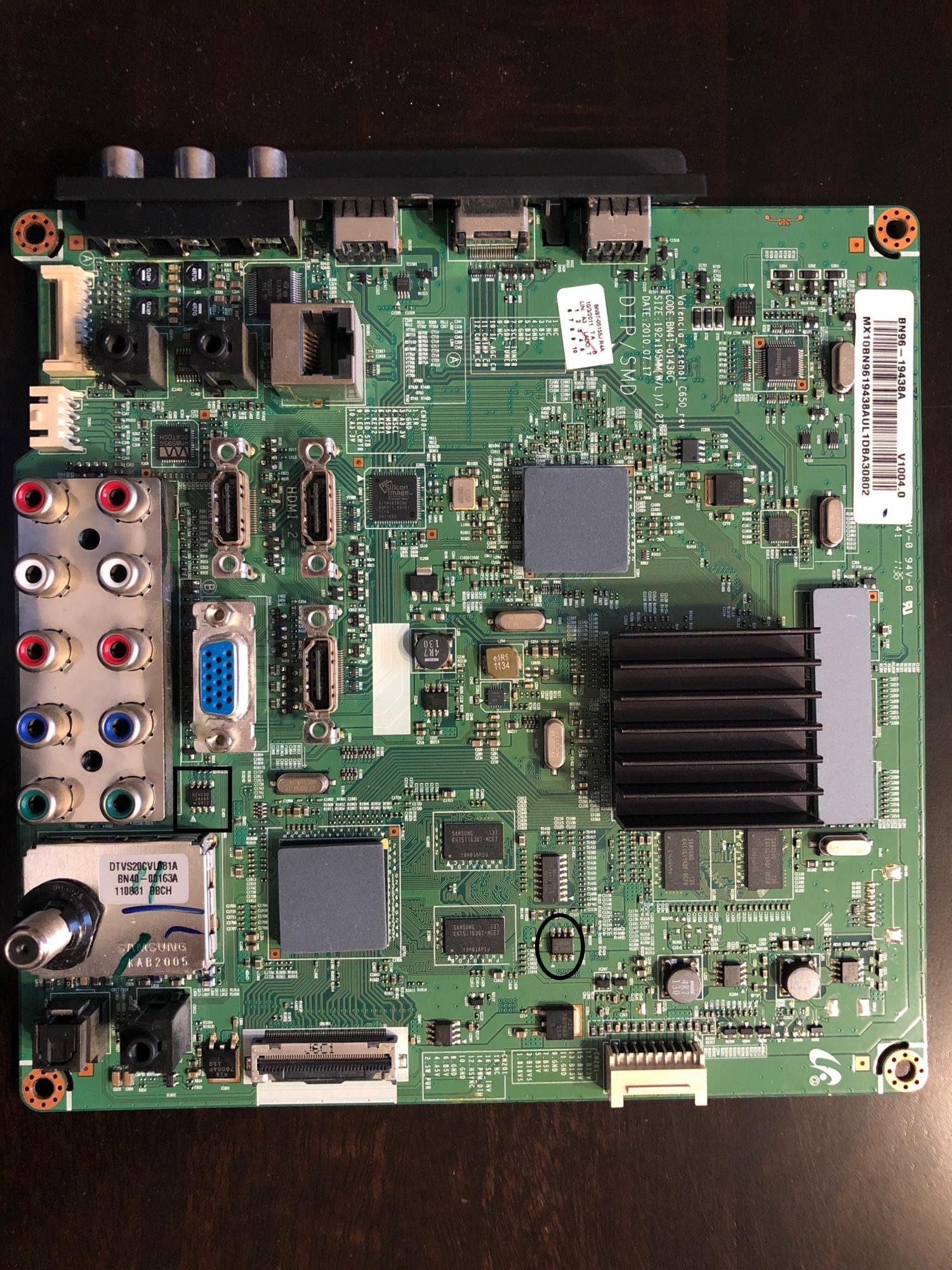

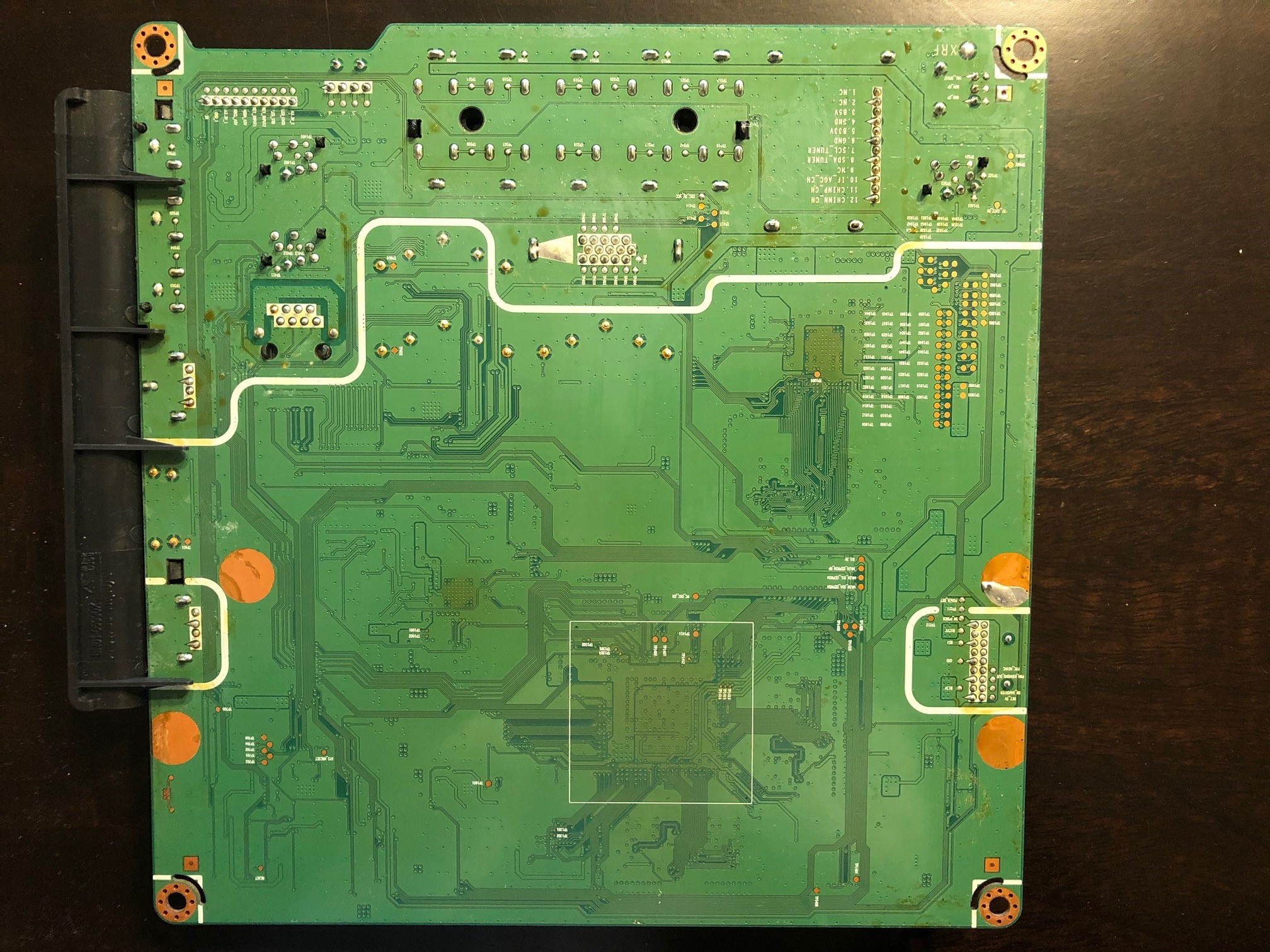

          See attached picture, Square is S24CSO and circle is 4256BRP, and yes if I unplug the Main board the back light will run, no problem, also as a test, Main Board was put in the freezer for an hour or two, and when I tried it after that, I got 5 blinking lights and nothing after that for about 5 minutes when at that point the noise started back (time for the board to go back to a decent temperature?)will have to track down a can of freeze spray, however being in a lockdown only essential services are open...

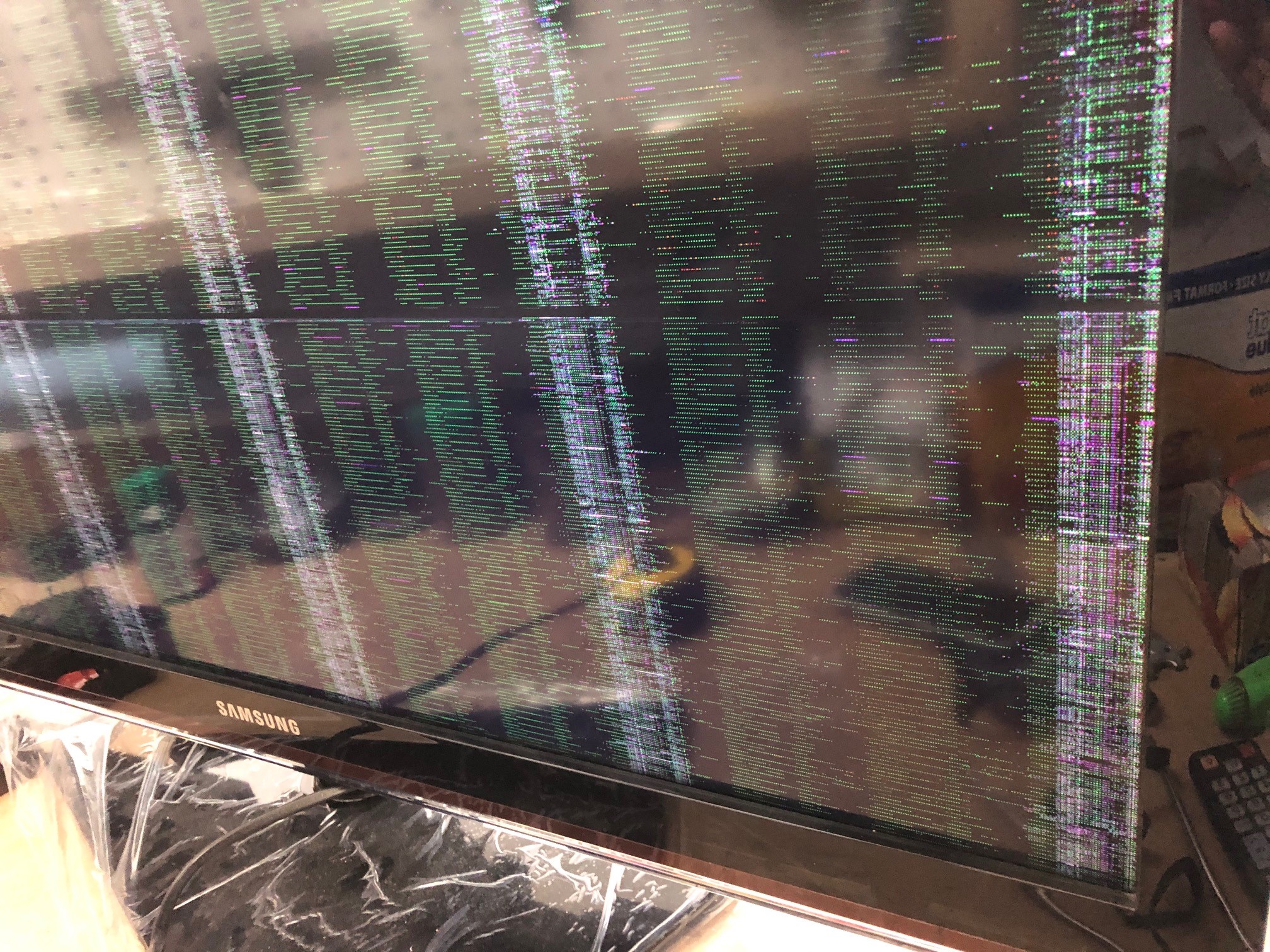

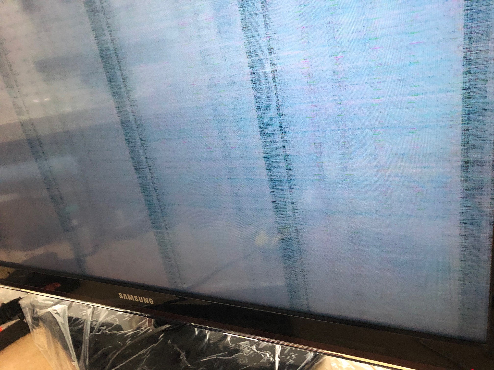

          to add on to this, If I let it cycle enough times (gets up to a certain temperature?) the TV will finally turn on but with an issue with the image, see attached picture.
          • Diah
            • Feb 2013
            • 6435
            ST 4256BRP the one i am talking on. if the freeze did delay as you wrote then try the heat with hair dryer

              Diah, you were too quick to answer, see previous post I edit in a few more details.

                same to my thought... freeze delay it.. then heat bring it faster...
                i dont think the issue at main boards.. try to heat the cold area cabs on power boards..

                        What do you mean with the feeding line? and what do you think about the image issue that I attached in a previous post? being slightly off?

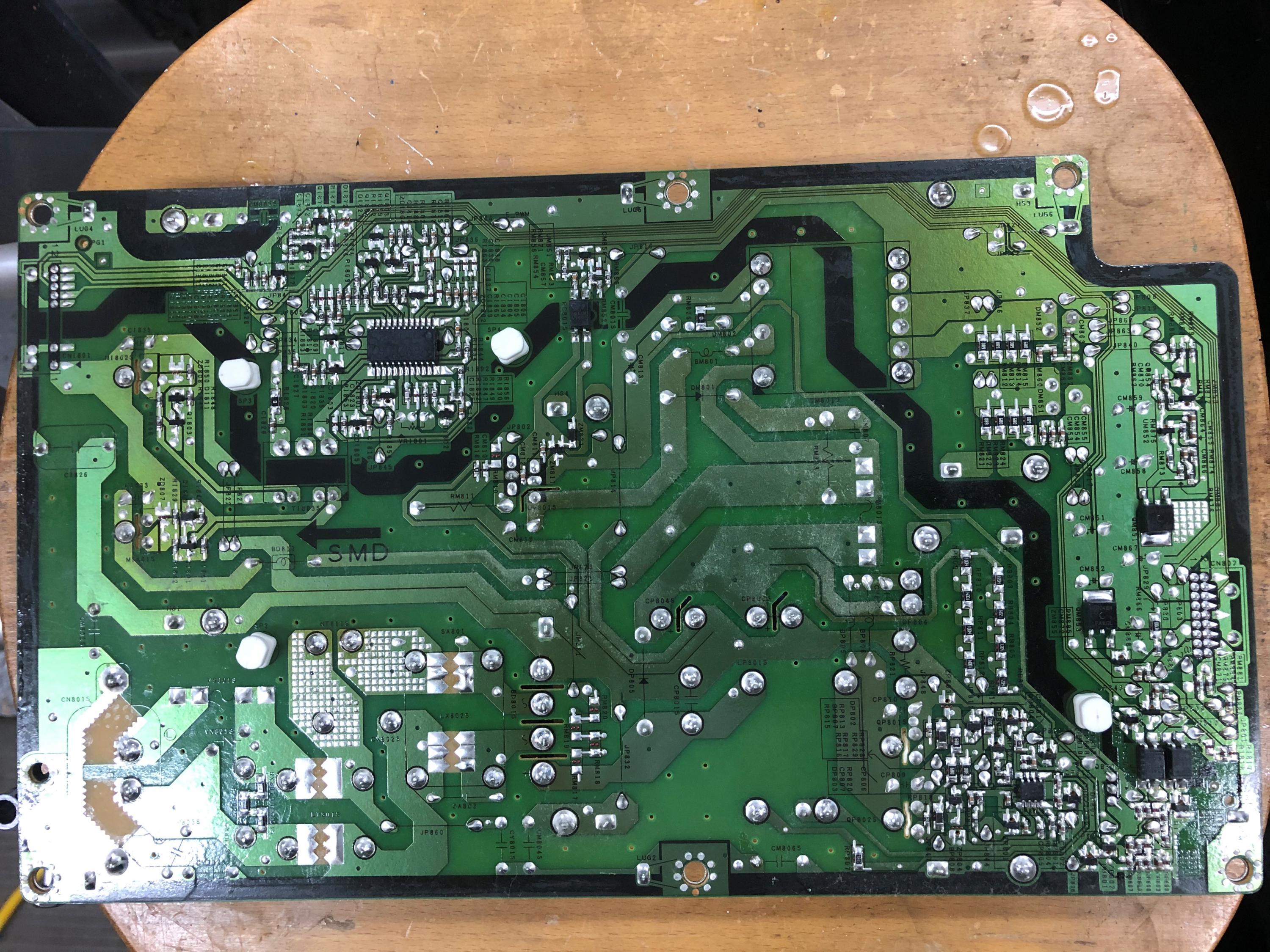

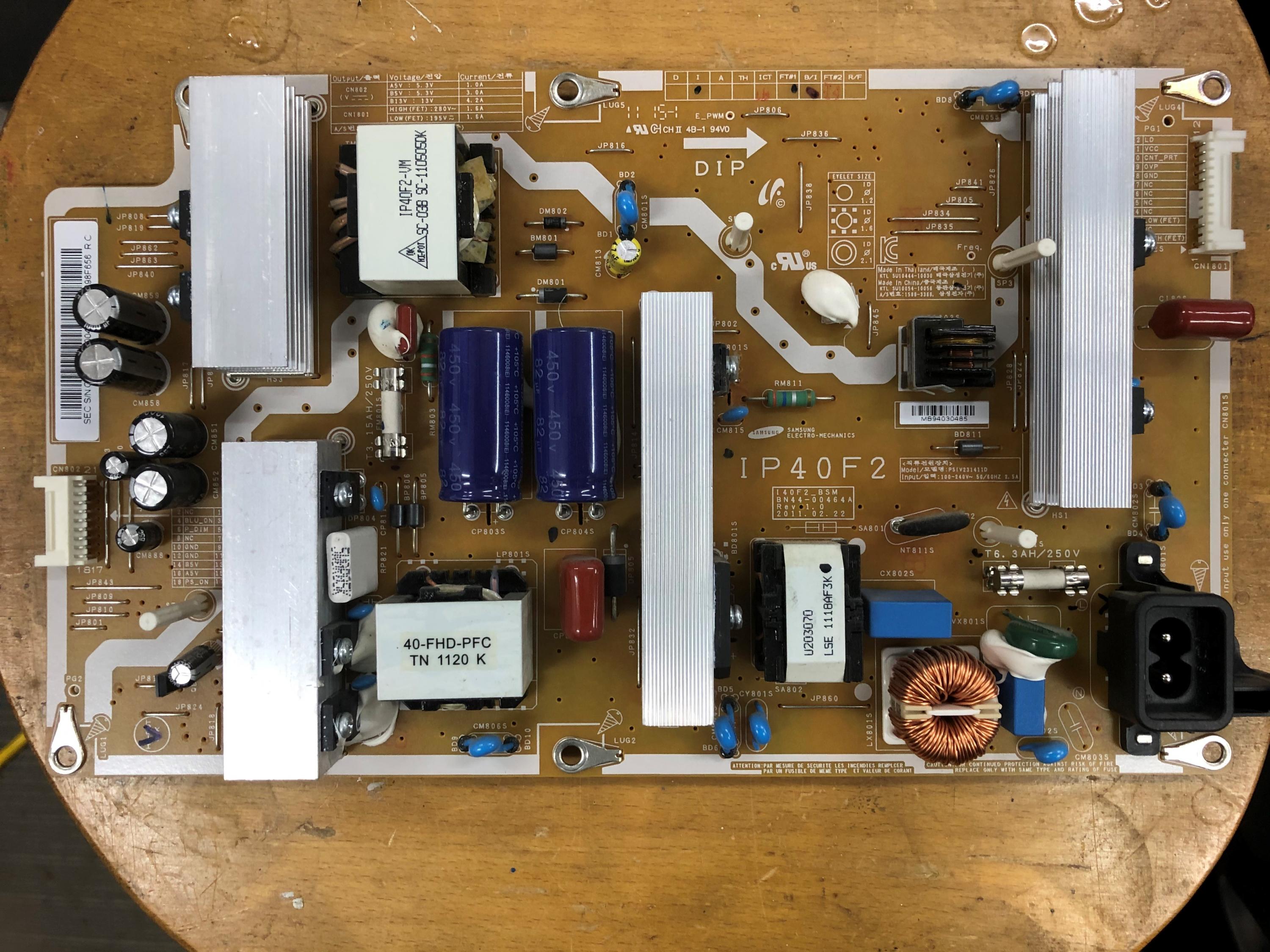

                          upload clear focused photo of yours power boards to remark my point on it..
                          the picture you got on screen was much clear than the first one you posted.. bad cabs can be issue too and because of the bad cabs can cause the glitch at the SPI we talked before by trying to turn on.. so the correct way of trouble shooting this issue are to start from power boards
                          • Plane Nuts
                            • May 2019
                            • 52
                            I have attached pictures of the Power Supply, I have also tried heating up the Main board with a heat gun and it will start working almost right away. I will try to narrow it down to a single component, I also noticed there is a mofset on the main board that has something, you can see just below and to the left of the circle identifying the SPI flash IC I have attached a close up.
                              I would try heating the main board section by section to help locate the sensitive section.

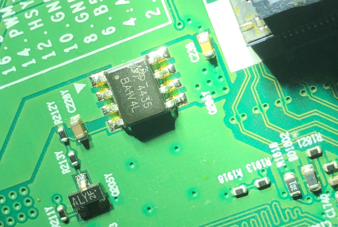

                                SPI Flash IC operated at 3.3V and less. power boards supply 5V. so you have on main boards DC to DC converter circuit to feed the SPI with this low voltage.
                                so start to check VCC on SPI Flash if its changed when you start the set from cold state.
                                • Plane Nuts
                                  • May 2019
                                  • 52

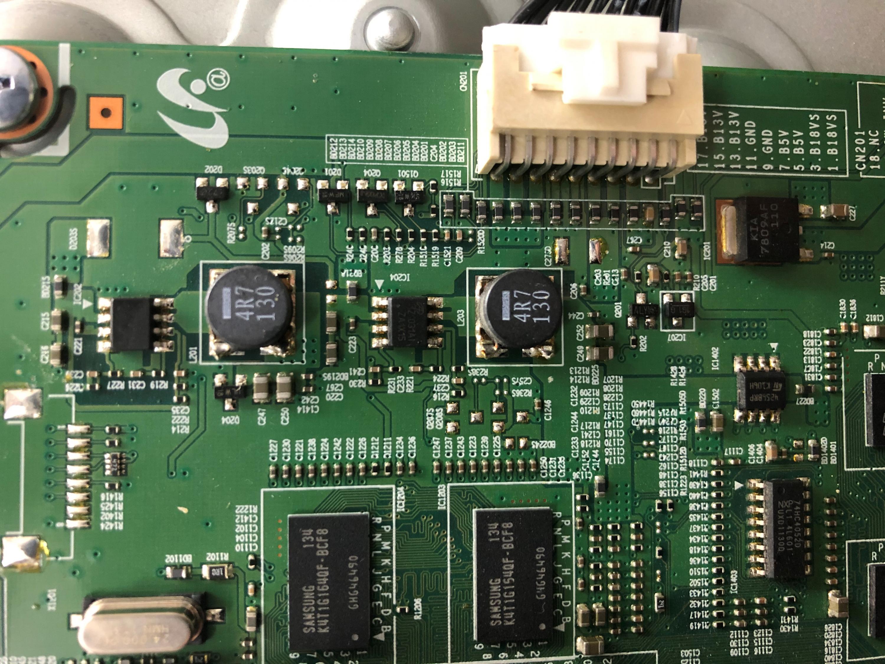

                                  No change on VCC on SPI Flash it is at 3.3. I have been able to narrow down the issue to what is circled in the attached picture and a closeup of that area. I also noticed that Lx on IC204 is at 1.7V however this does not change weather the TV works or not. at the upper one IC 202 I get 3.3V, FB 0.8, comp 0.9, and EN 2.6.

                                    are IC204 & IC202 same NO ? if yes can you write the No over here
                                    • Diah
                                      • Feb 2013
                                      • 6435
                                      at other hand... you need to do test when the tv at cold sate by reduce load on the main boards then plug it on... start with panel disconnecting one ribbon at once.. maybe the panel pull over currents... this happened but hope its not your case
                                      • Plane Nuts
                                        • May 2019
                                        • 52
                                        IC204 and IC202 are both the same Z1031AI, I also noticed that putting my probe on the COMP pin gives varying results (from .8 to 1.7) and the screen will act up with interference lines and stay until it resets itself, possibly normal? due to what I can induce into it. and Although IC 204 seems to have odd value, it is not in the area Is affected by applying heat this area is between IC 202 and IC204
