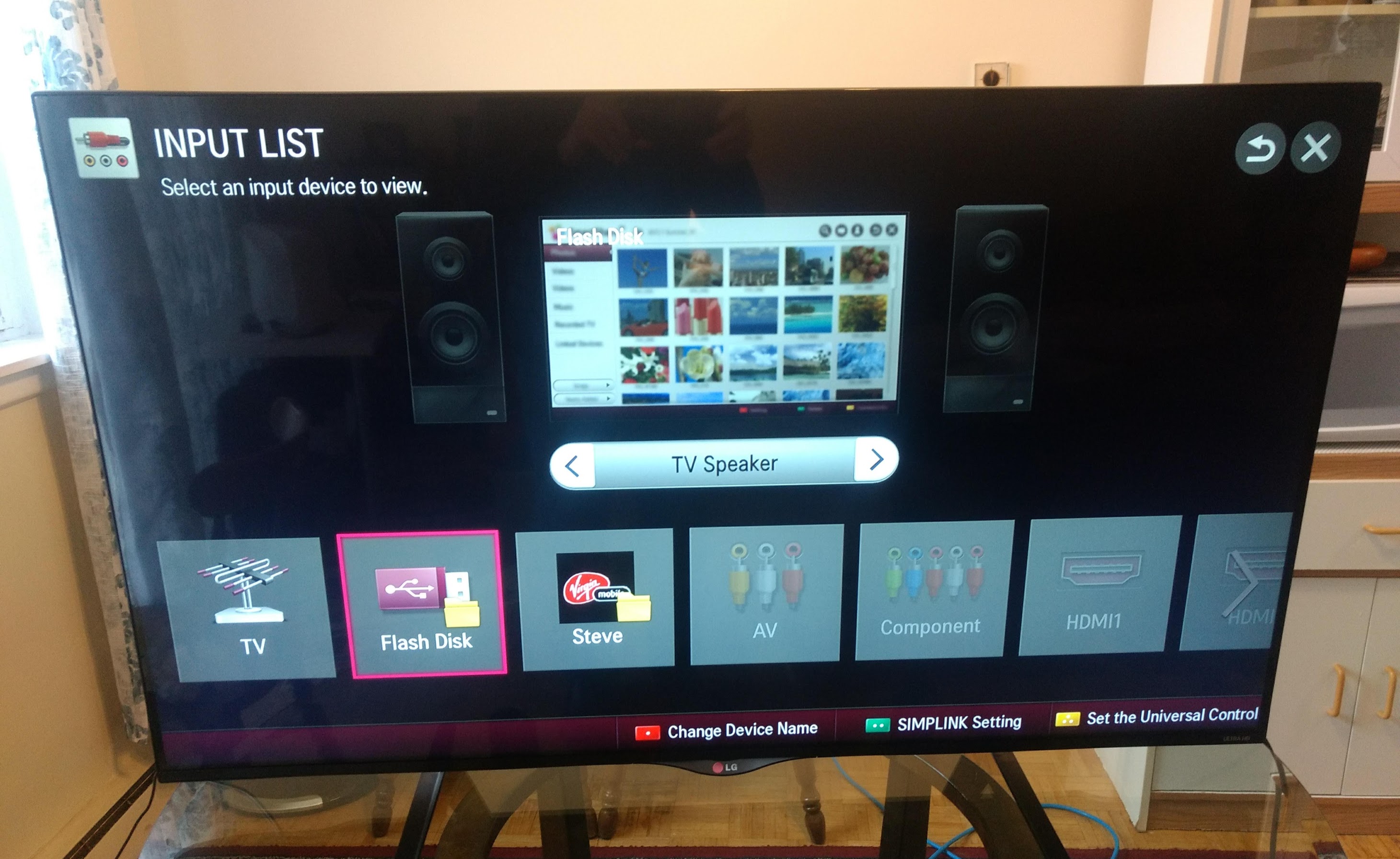

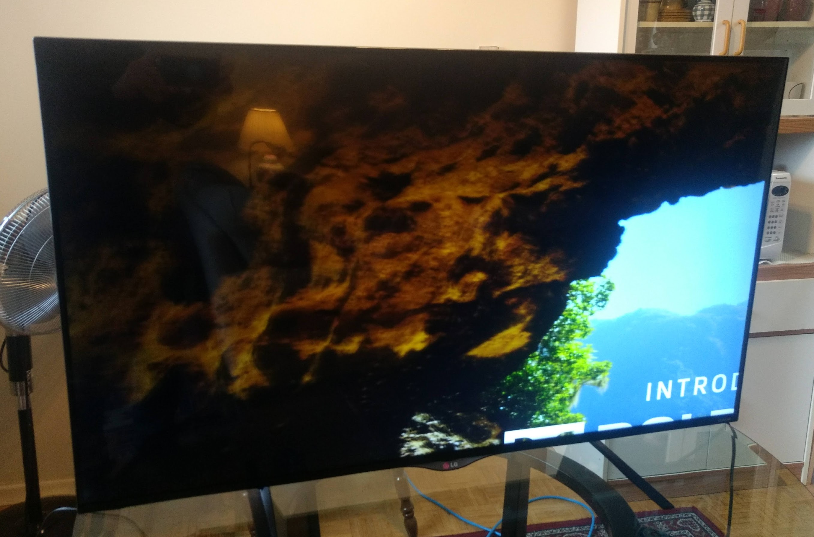

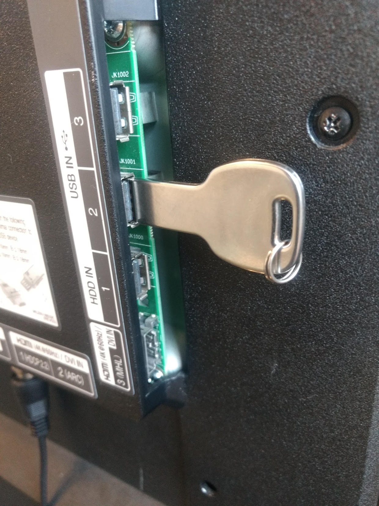

    Hello everyone. Got used LG UHD TV model number 49UB8200-UH. Everything work, but only one fourth (upper left corner) of any 4K/UHD video from USB flash, PC HDMI or streamed from Netflix 4K is shown on the screen. The screen is UHD (3840x2160). Tried all the different settings of the TV, nothing is solving the problem. Any thoughts of what could be the problem would be appreciated.

    could you show us the issue with photos on any source you use for signal???

      Thanks for responding, the third photo shows only one fourth of the original 4K video which is on the USB flash drive (the sound is playing)

              you have wrong picture setting ( overscan need to turn off ) or (Format make it fit always to 16:9)
              also play video HD not 4K and then pause the video and access the player setting change the things i wrote before.
              edit... also maybe the ex owner was played XXXL movies LOL and had zoom in... so need to zoom out again... if you couldn't find how make reset to the tv

                Thanks Diah. I already tried all the above, nothing worked.

                  then its normal as your set didn't support 4K video via USB.
                  read yours TV specification / CONNECTIVITY
