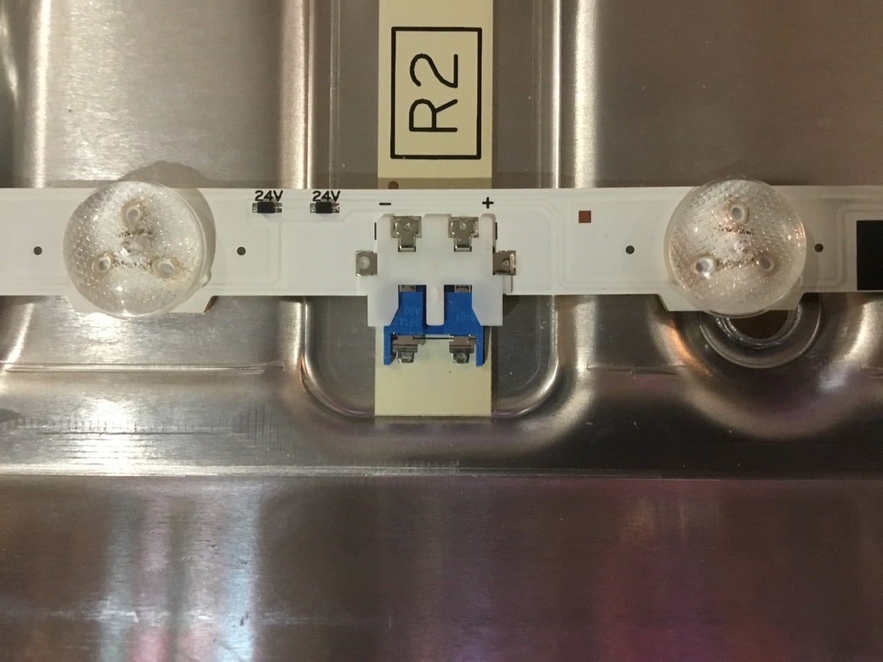

How do I get this apart, I don't want to break it.

Needle nose pliers and press down on the two tabs together by the blue end. Slide out while pressing down. Corrected.

The silver part or white?

press down on the 2 silver tabs with needle nose pliers by the blue plastic piece.

Thanks that got it.
