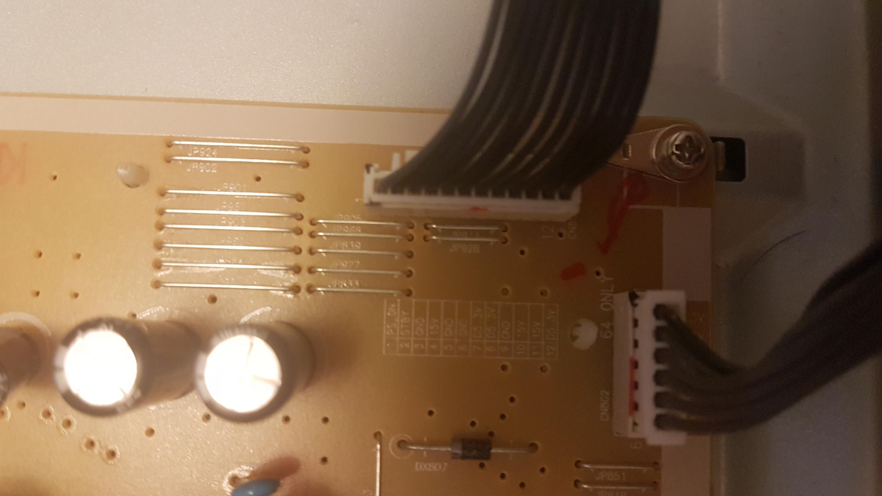

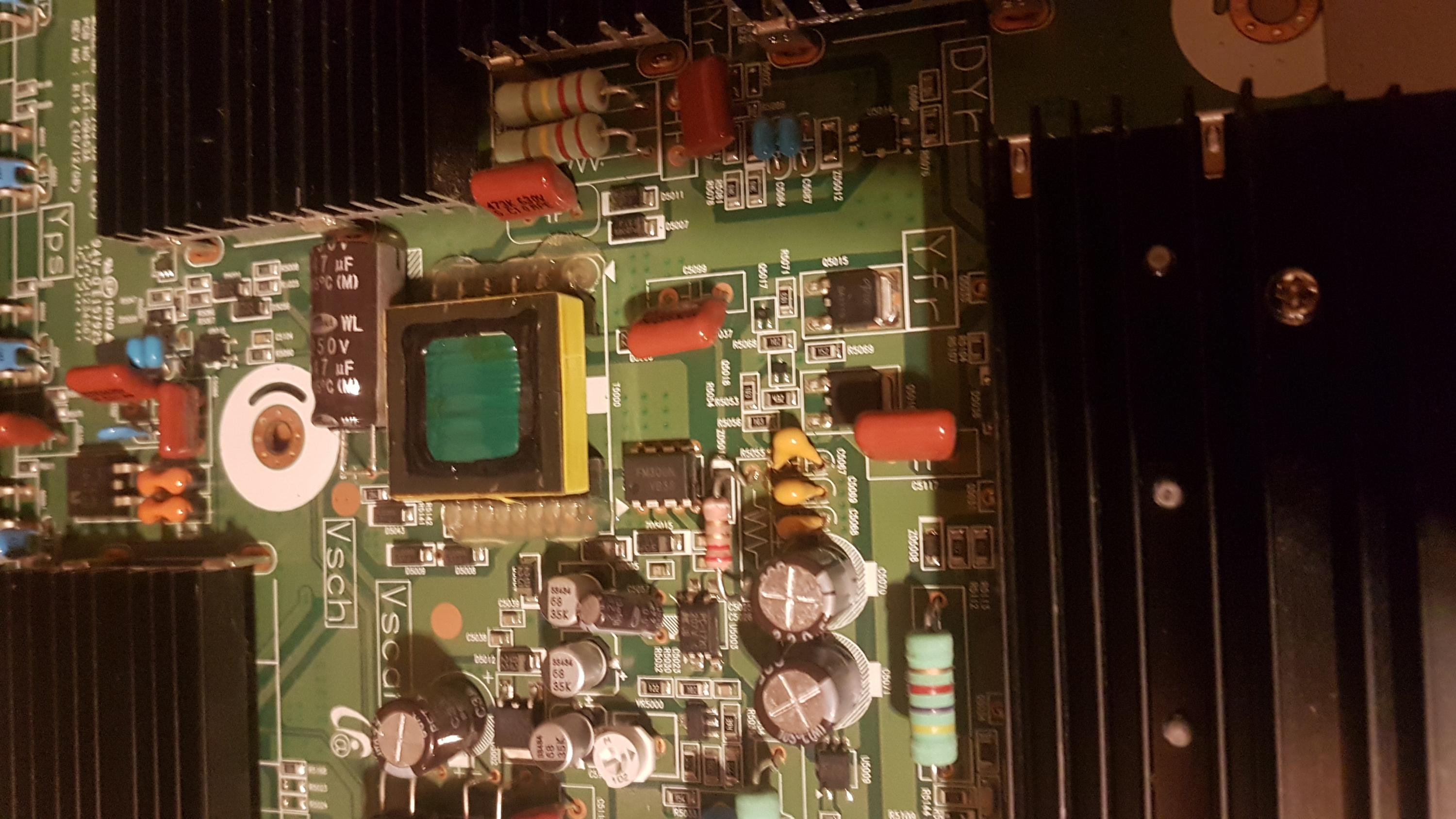

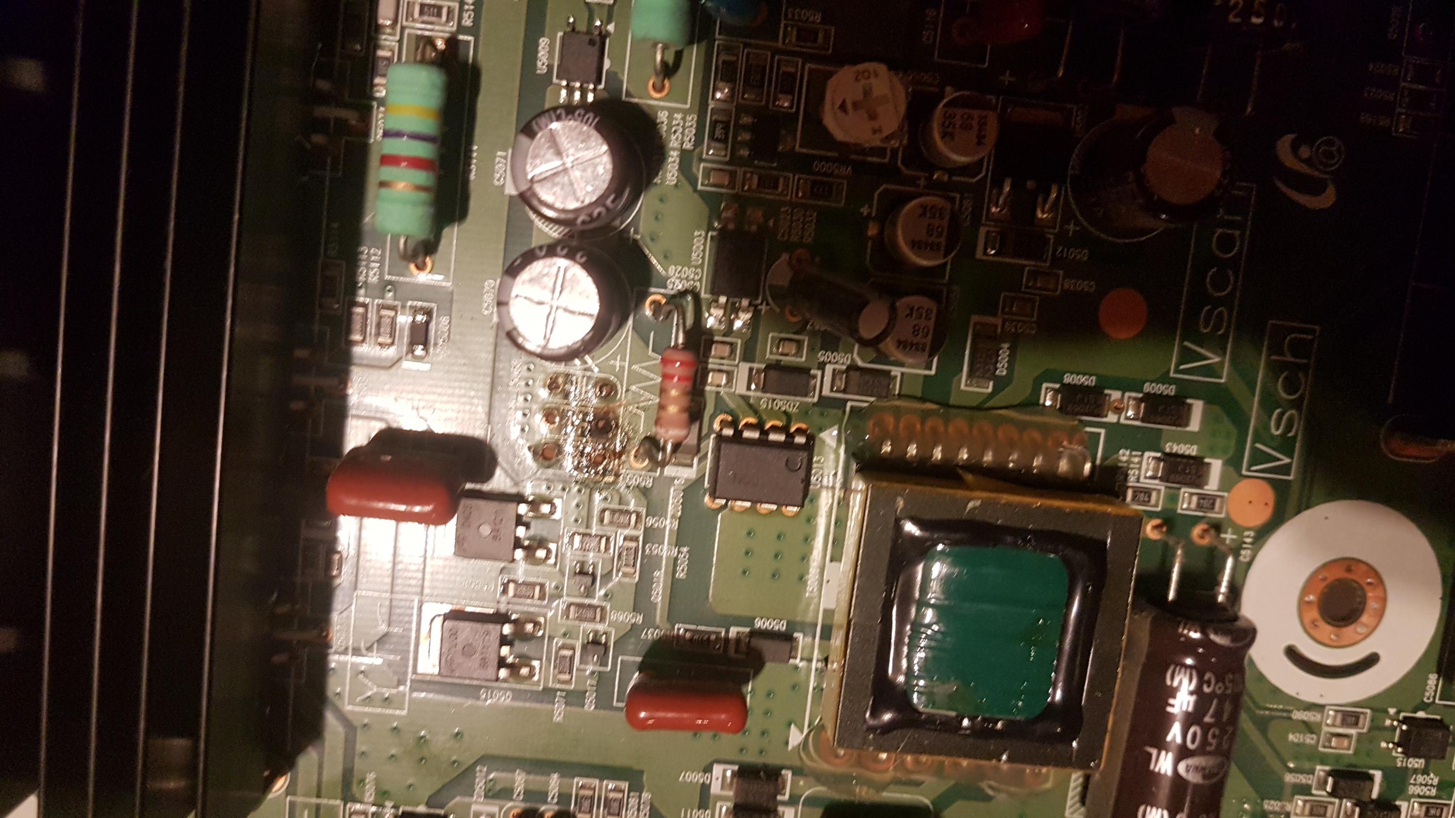

    Each capacitor has one leg soldered on the top of the board as well as all on the bottom.
    • dick_barton
      • Aug 2015
      • 6643
      • Wales
      Re: pn64e550d1fxzc power issue

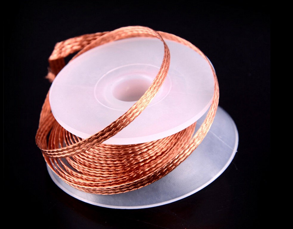

      Flood the pad with fresh solder and use desolder braid to remove the fresh solder. Fresh solder tends to be easier to remove.

        got it changed still wont power on does the top need to be soldered to as i only soldered the bottom thanks
        • pansatdishman
          • Jun 2013
          • 110

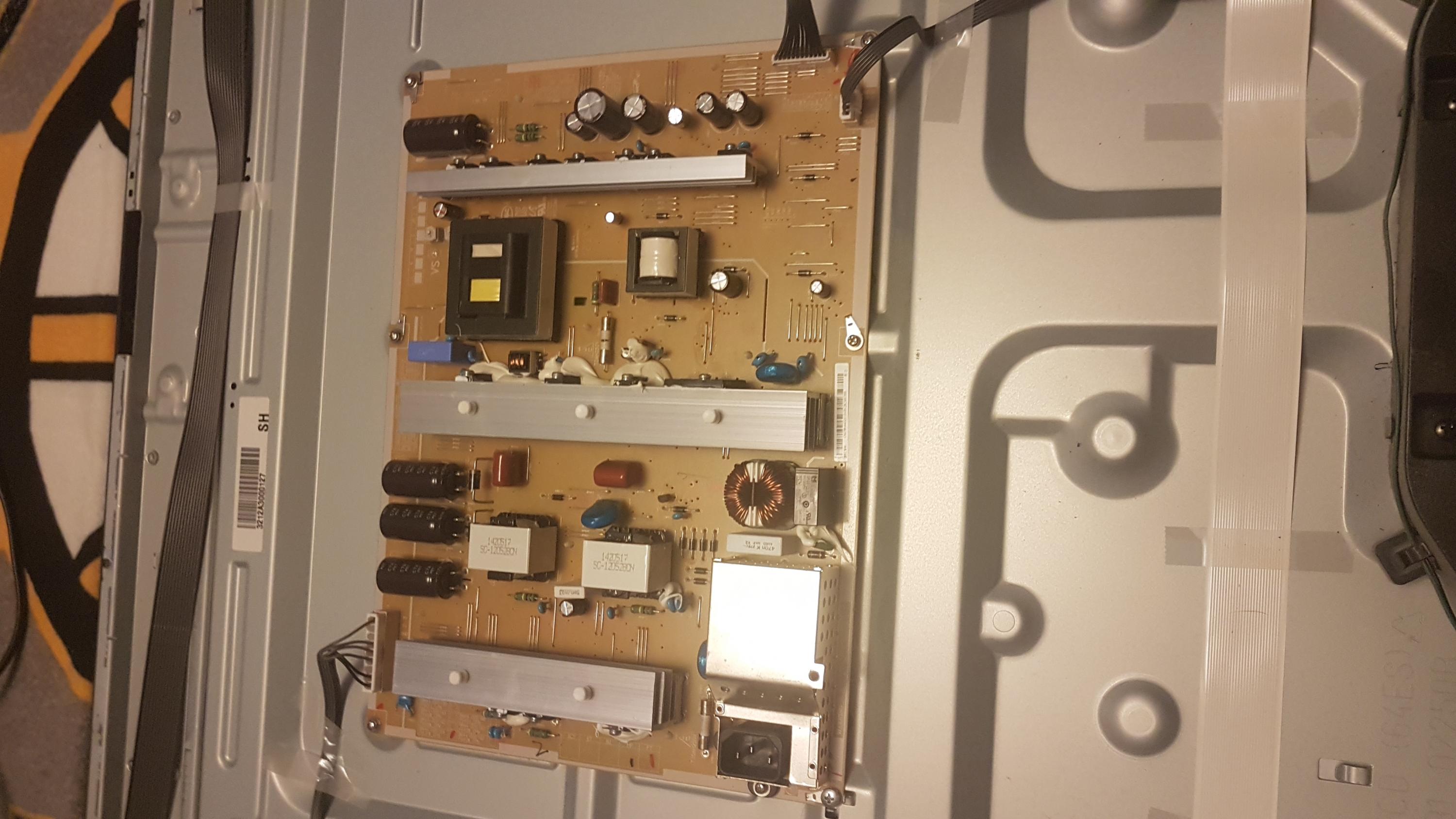

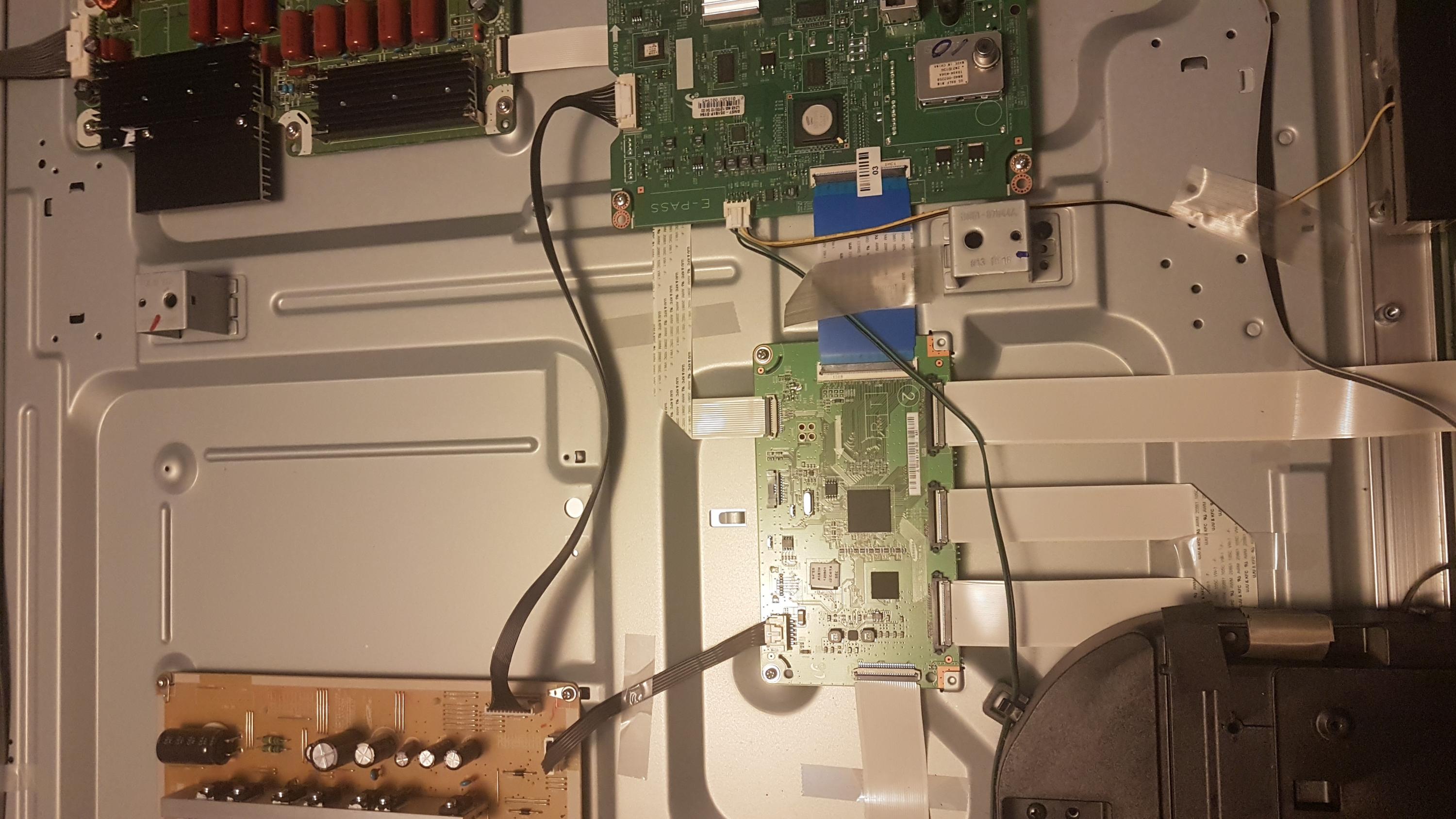

          tv use to work then would tutn off and wouldnt power back on for a while . i took apart and touched up solder joints then no power at all. then changed those caps on the y sustain and tried last night no standby i checked fuses on power supply and there good
          • pansatdishman
            • Jun 2013
            • 110
            i just put solder on the top side of the caps as well and touched up the solder joints on the power supply powered on after a few times of hitting the button then died and wint do anything green light was blinking on control board and everything stopped when it went out

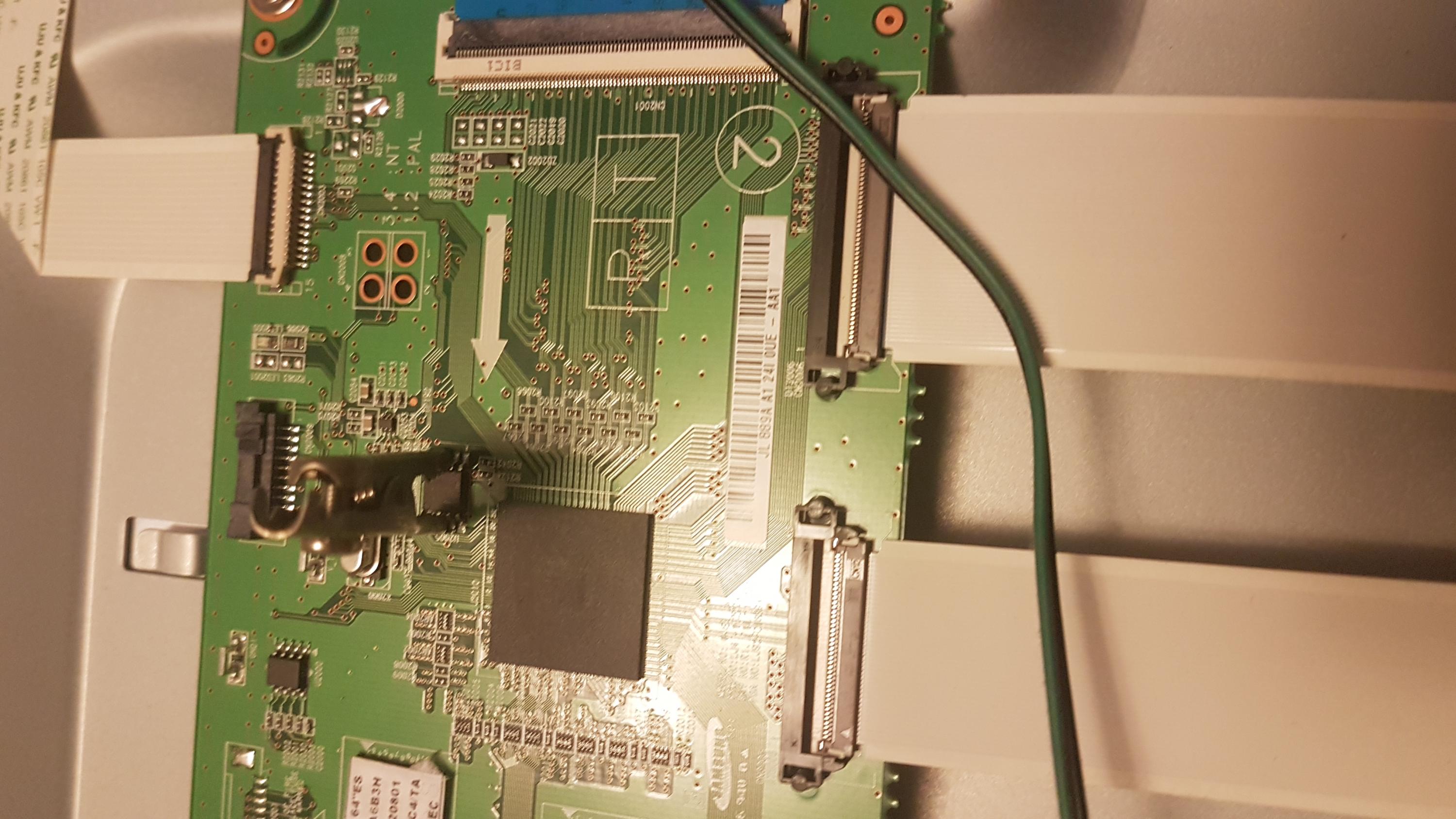

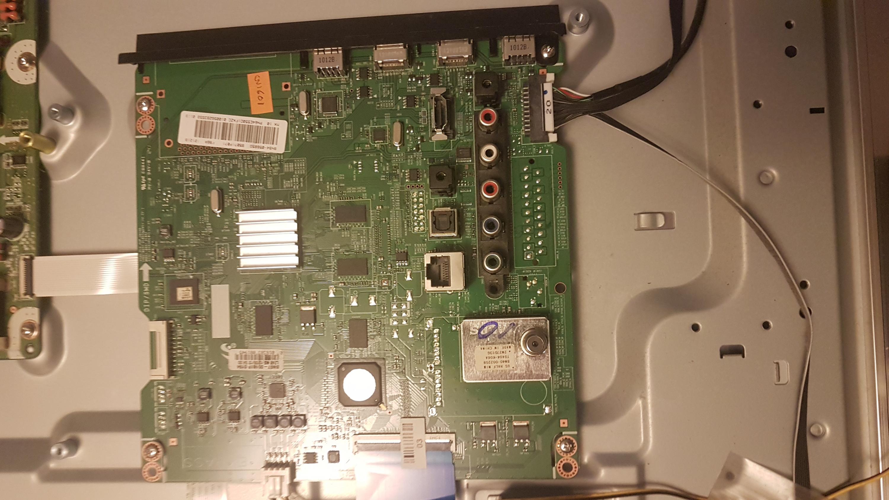

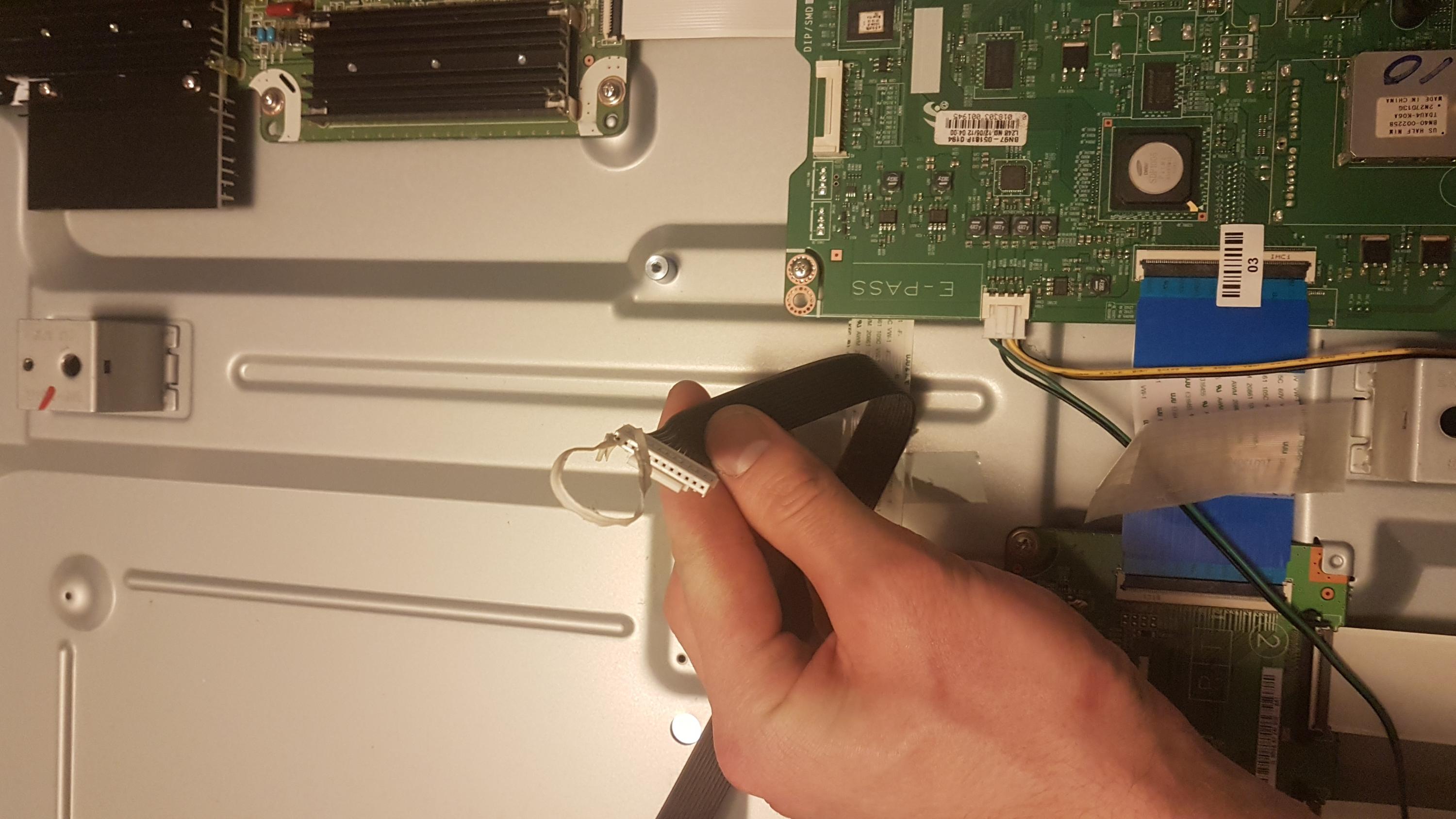

                  On that model, you disconnect the cable from the power supply and put a wire in the ps on and the other end to the ground. Then on the mainboard, put a wire in holes 3 and 4. Then plug in the tv.

                      The instructions given by tvjimmy are shown in the attached pdf in post #2

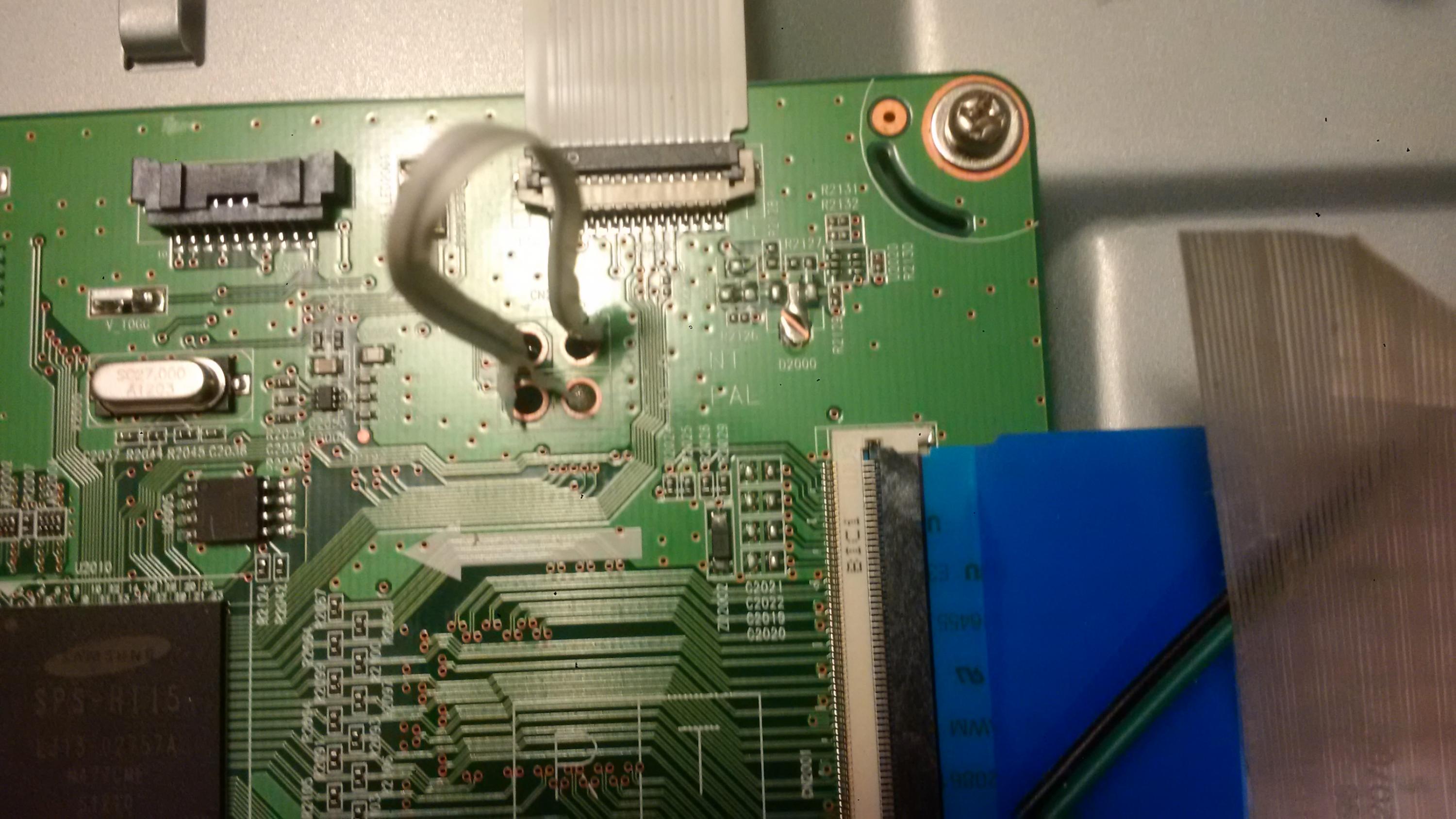

                        okay i have the mainboard to ps supply mainboard connector unplugged and connected to pins 1 and 3 tried plugging tv in and nothing happened. i have to short 3 and 4 on the mainboard? where is 3 and 4 or i add another wire to the same connector on 3 and 4 thanks
                        • pansatdishman
                          • Jun 2013
                          • 110
                          #32
                          tried this and still cant get test patterns. do i have the clip in the right spot on the logic board as mines a bit different then the pic in the pdf thanks

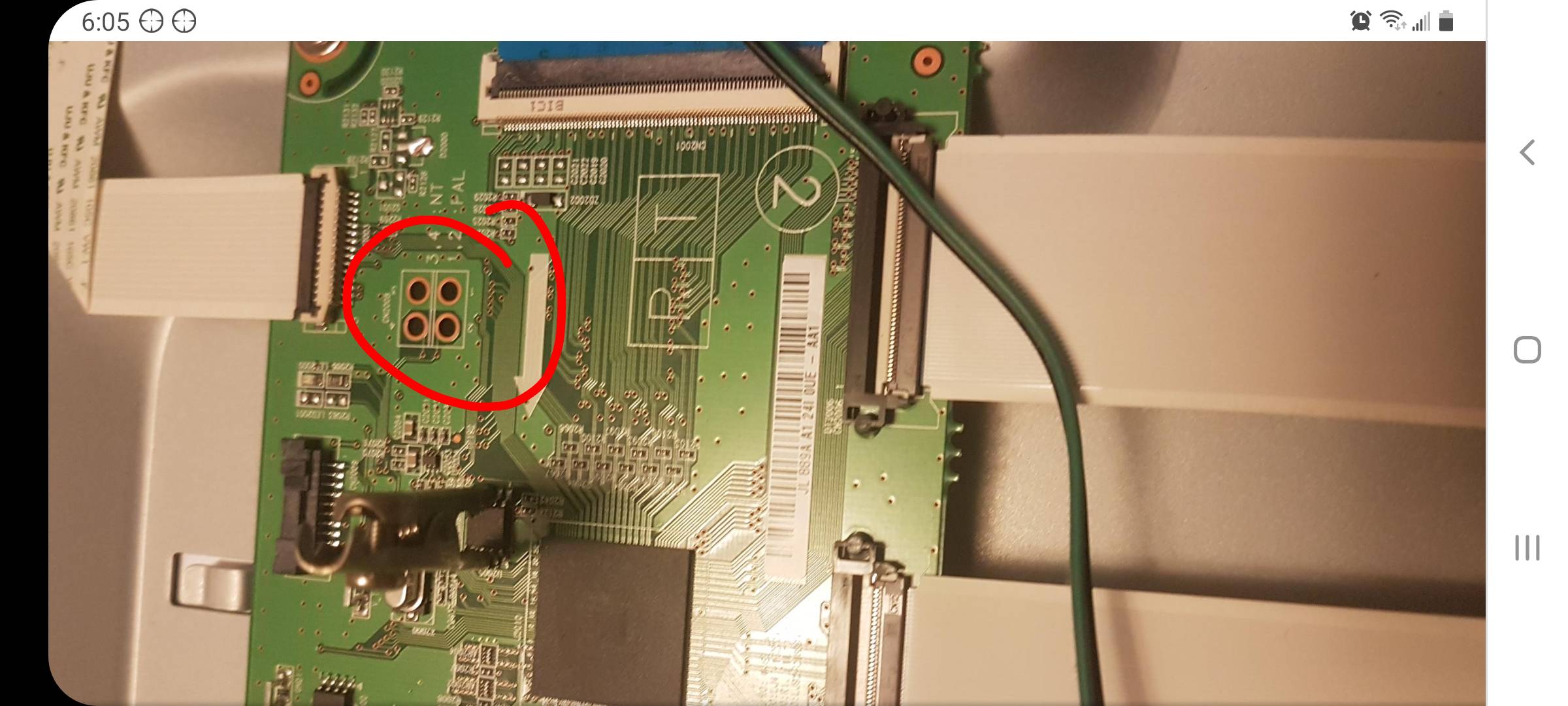

                            #33
                            These are the holes. I hope you didnt do any damage to that chip.
                            The top 2 holes should be #3&4.

                              thanks tried it and still nothing. so that means i have a power supply issue? thanks doesnt try to power on no noise or anything

                                That's how I had it.

                                  #36
                                  The number of the holes is:
                                  3 4
                                  1 2
                                  Put the jumper in the two top holes.

                                    #37
                                    Thanks I used a bread tie for holes 3 and 4 and plugged the tv in and it still doesn't turn on. Power supply issues? Thanks
