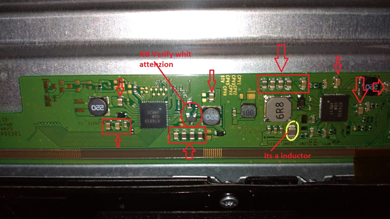

Toshiba 49U5863DB Vestel 17MB130S, blank screen, no image, sound ok.
    Re: Toshiba 49U5863DB Vestel 17MB130S, blank screen, no image, sound ok.
    OK, now I see how the two legs of that device is connected, at first look at your earlier picture it looks like it has one end connected to ground plane, but now I see how legs are connected, it is an Inductor.
    Do you get any DCV reading at all on that inductor?
      Hi.
      if I can, I would advise you to raise all the smd as indicated in the photos, obviously paying close attention.
      carefully check, raised at least on one side, the indicated capacitors, in particular the indicated transiator, it is certainly short-circuited.
      in case it was the transistor I will give you the solution in private messages.
      finally the 10mf 50v capacity is the right one
