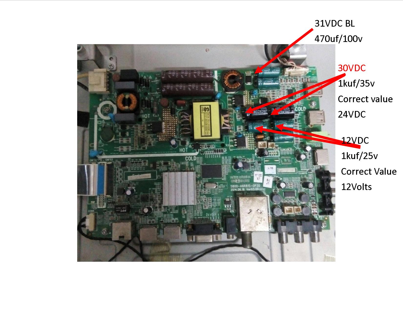

    Hi guys... need a little help here.. costumer brought me this Skyworth 40E360 LCD TV.. symptoms.. no backlight no response to RC and manual switch , the moment it is connected to the wall outlet the indicator lights green.
    what i've done.
    check the voltage in the secondary..shown in the attached picture.
    i manage to locate defective capacitor 1000uf/35v.. meter shows the cap value is way below measuring only with 50uf and esr of 150 ohms.. i replaced that but with no avail..
    check the backlight led system with backlight tester.. all led lit
    checked all the components, mosfet diode resistors inductors, photo isolator..
    in the primary and secondary circuit with no avail..
    do i need to reflash the eeprom. problem is i dont know where the heck it is..
    can someone guide me.. im lost

    Re: Skyworth 40E360 indicator always green
    the indicator light doesn't turn to red which is normal for this kind of tv when you first connect it to the main line. no remote control response no backlight no manual switch response. what i've got is just a steady green light whenever i connect it to the main. . no schematics is available..
    secondary voltage measurements..
    BL 31VDC
    1000uf/35v cap pin voltage measurement is 30VDC - incorrect value normal is 24VDC
    1000uf/25v cap pin voltage measurement is 12VDC - normal value
    check the diode and all component connected to the 1000uf/35v cap all parts is normal.
    already replaced the PWM ic TEA 1733 and the opto isolator PC817 with no avail.
    any help is much appreciated. thanks in advance..

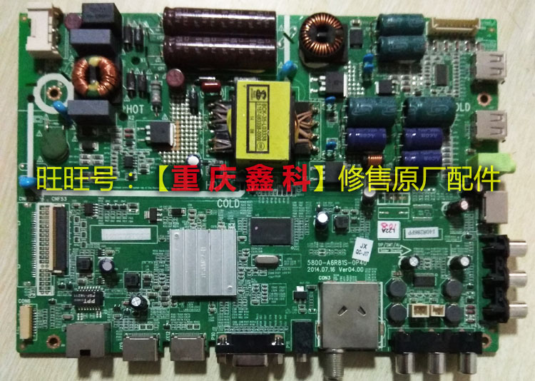

                                      • Duranitron
                                        • Jul 2014
                                        • 544
                                        • Philippines
                                        I think one of the problems is there's a few different mainboards for this tv model, what are all the numbers on the two thin white stickers on the mainboard?
                                        thanks for the reply nomoresonys
                                        SKYWORTH 40E360 mainboard # 5800-A6R81S-0P30 VER 03.00
                                        that sop8 ic near the lcd strip connector is me9435A mosfet i really can't find the spi eeprom
                                        ive got a clear picture of the mobo got on the net
