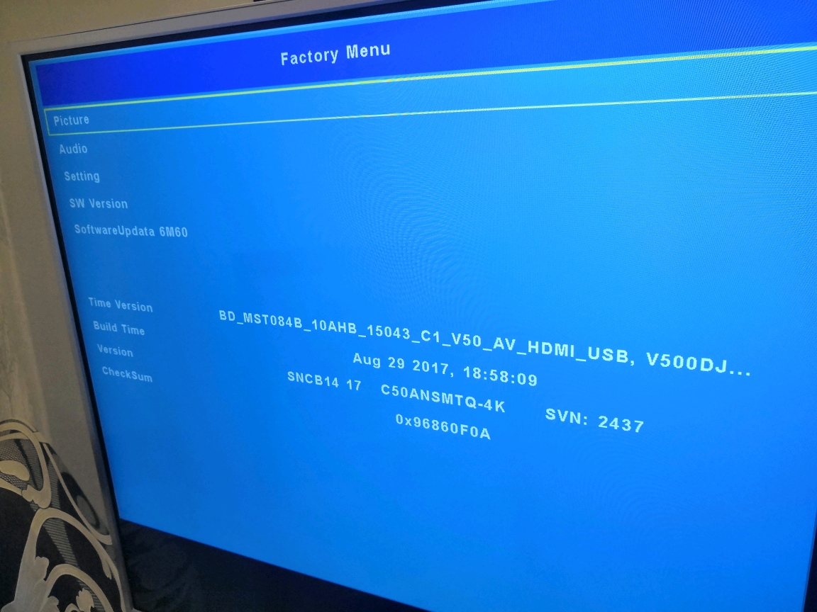

    Re: Cello P50ANSMT-4K won't boot to Android but ok on HDMI
    That only seems to turn on the set, if I press source 2580 I get a factory menu? see pics.
    I've tried the factory reset in this menu

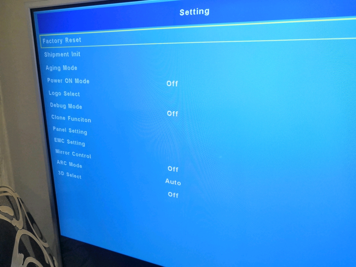

      try first shipment Init.. if no change then Factory reset
      • Neilgw
        • Oct 2020
        • 13
        Tried that and no change, just puts the screen black after a few seconds

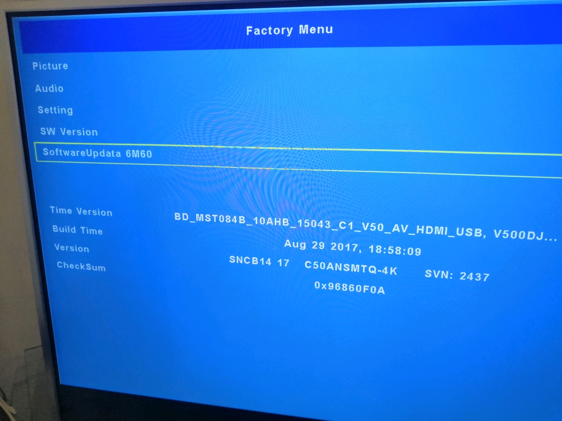

          okay, after the screen goes black and then on exit the service menu by unplug it from wall socket... then plug again... did the first installation showing to you?
          how about if you click on swupgrade what it show to you

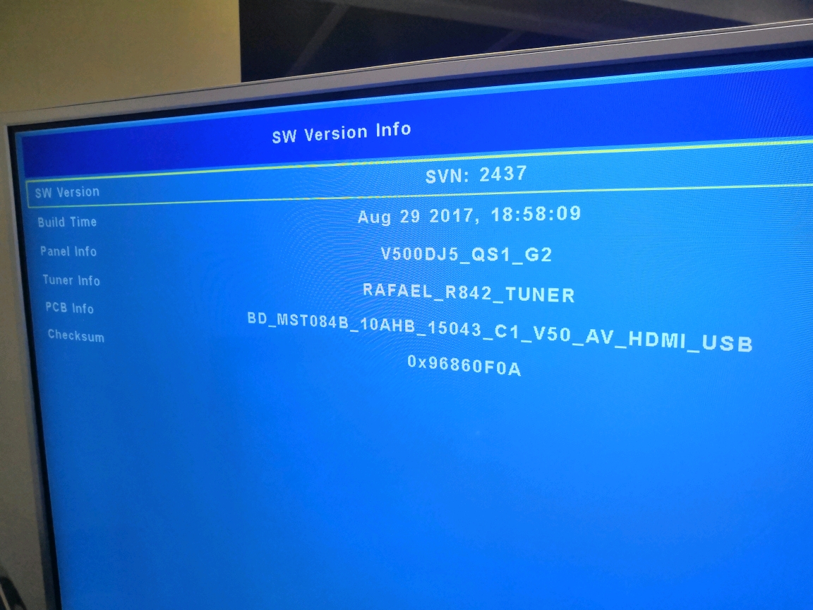

            when plugged back in get please wait in screen then black, no sw upgrade option in the factory menu the option SoftwareUpdata 6m60 does nothing sw version just give the info in the image.
              you may have HW issue or BGA at the main IC as it control all input sources include Tuner.
              or could be too the tuner defect.. so or so need really deep inspection. but starting from BGA issue will be essential for the rest work. but blaupunkt famouse with rubbish firmware.. reset solve many problem.. not yours lol ... sorry i am out of any further idea.
