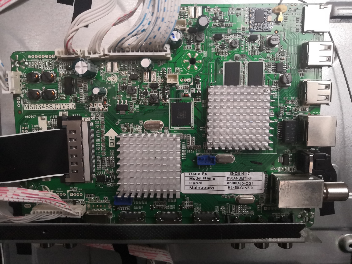

    Hi, this is my first post and just hoping someone can point me in the right direction.
    I've got a Cello P50ANSMT-4k, mainboard model MSD3458.c1v5.0, the set switches on fine and get please wait on the screen then just a black screen but the menu's still work and can still use HDMI with a fire stick etc.
    Cello sent me an update but I'm unable to get it to take it from numerous usb sticks and in all sockets, tried to do it from the menu and by pressing vol up on start up. I've also been into the engineer menu and done a reset but no luck.
    Has anyone any ideas? it seems to be just the Android os that is corrupt?
    Any help would be appreciated.
    Neil

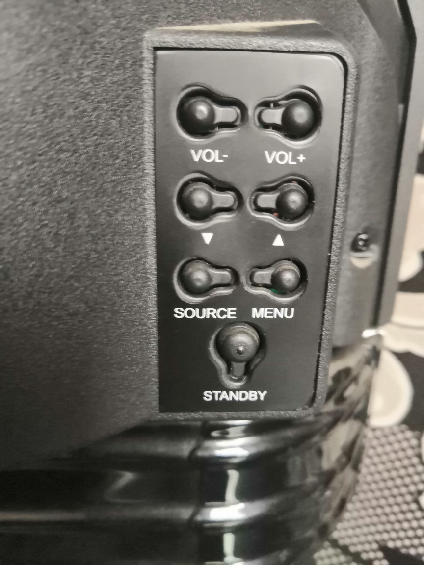

            could you upload photo over here to yours side control panel..?
            did you have front LED indicator on the tv.?

                    Ive tried 4 usb drives fat32 show hidden files and file extensions no other files on the drives and tried all usb ports. the file they sent me is mstarupgrade.bin
                    pics attached of button panel and mainboard

                          edit ; on the MB you have near the NAND socket with 2 pins ist written UPGRADE ?

                              Diah, yes 2pin header upgrade.
                              steiewonder, Ive tried 2 x 8gb usb drives 1x 16gb drive 1x 32gb tried from sdcard also tried from bootup and from the menu but no joy but all cards work with music or photos etc.

                                please read the voltage on the 2 pins while the set on.. black probe to tv chassis.. also when you plug it out from wall socket read the pins with Ohm between each other and between each and chassis

                                    Tried rename to upgrade.bin no change, voltage on pins left pin 5.23v right pin ground with tv powered on
                                    ohms is reading 151.9 pin to pin and left pin to chassis right pin is ground

                                      let try to inter the service menu. try to press on the side panel the standby 5 second long..
