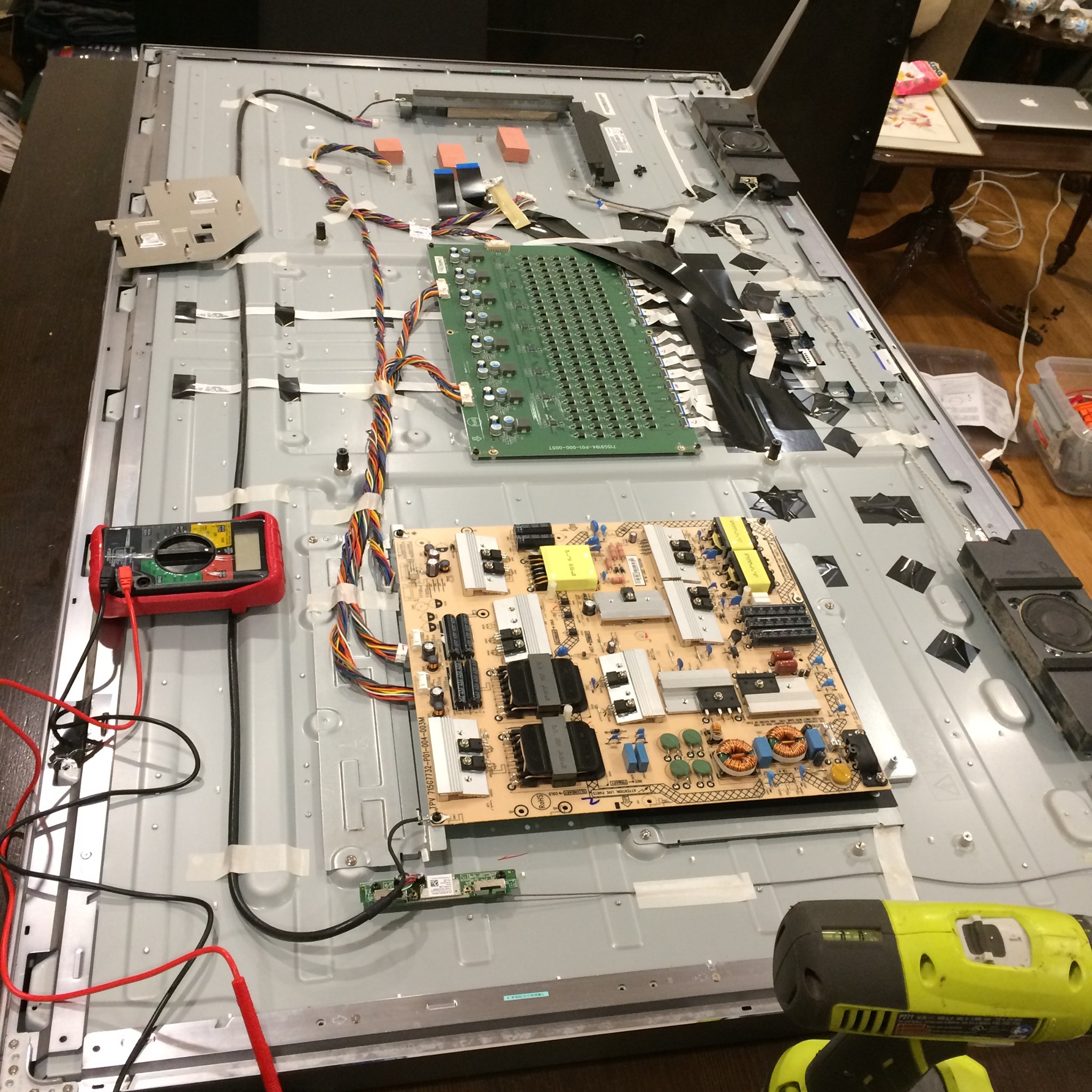

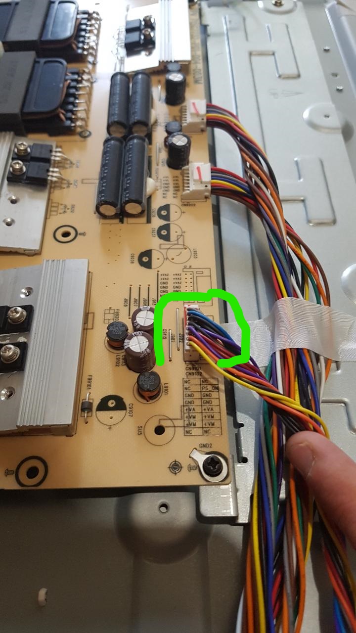

    Guys I have a 65" with no power/no standby light - nothing. Im in the midst of testing the boards right now to see which is faulty and looking for the STBY/SB/STNDBY (not sure) on the power board i don't see it anywhere like i expected. I would like to check the standby voltage could someone take a look at these pics and tell me what you think?
    ALSO, how do i get the black plastic heat shield thing off of the main board - it has push in tabs but it won't come off?
    The green circled connector in the photo is the one that runs back to the main board.

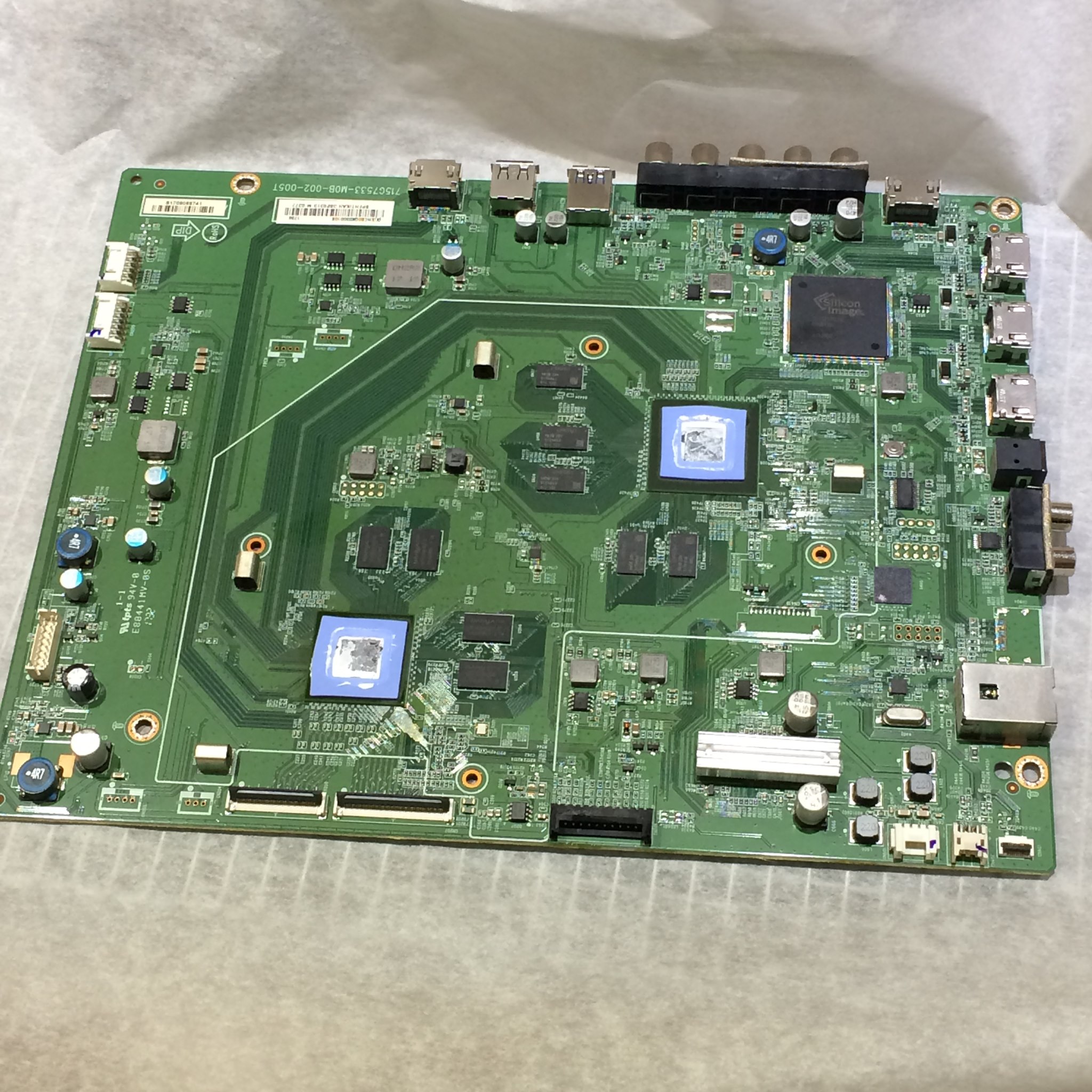

    Nvm got the heat sink off, the backside of the main board is a little sticky?? is that normal it feels like flux maybe covers alot of the back of the board. no burns tho.... Also my model and part number for the board 756TXHCB0QK0300 Vizio Main Board, 715G7533-M01-002-005T, (X)XHCB0QK030010X, P65-E1
    but i found 715G7533-M01-000-005T will this work?? maybe a different revision?

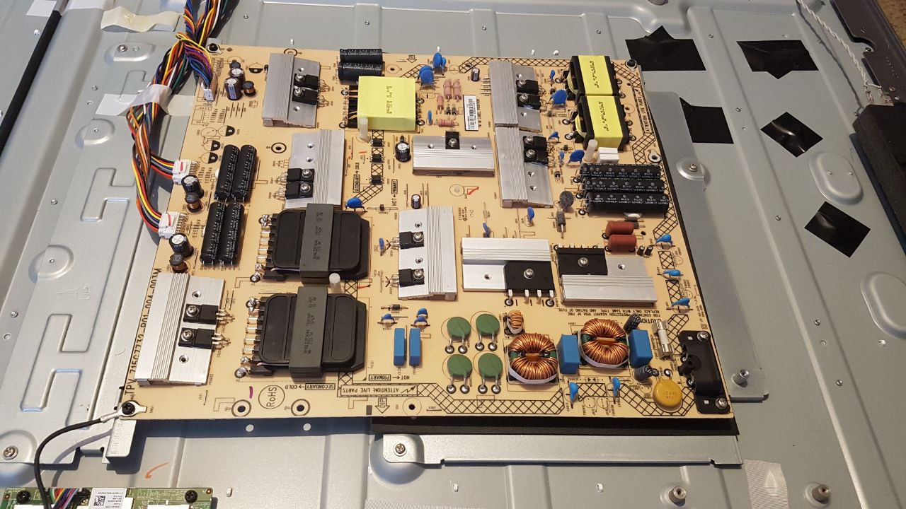

      +VM on CN9102 should be the standby voltage but possibly +VA as well so measure both with ground on the chassis. Would expect 19V on a Vizio. When the tv is turned on, PS_ON should go high (>2.5V).
      Vizio M and P series have BGA issues with the main board. If you have standby voltage, try heating up the main board with a blow dryer before plugging it in and see if it turns on.

            Well you were correct the +VM & +VA all read 18.95 volts with the TV plugged in and all the ribbon cables and connectors connected & PS_ON = 4.95 Volts
            I threw the board in the oven i'll let you know if i get a picture

              I baked the board for about 8 mins at 380 and the TV works now... as others have reported. Can I install fans to keep things cooler and expect the board to last or can someone do a BGA board repair? I cant even find the exact board only different revisions within the P65-E1 model.
              Update: Lasted maybe 10 mins while i was doing firmware the TV began to die displaying lines and blooming .... can i repair this board?

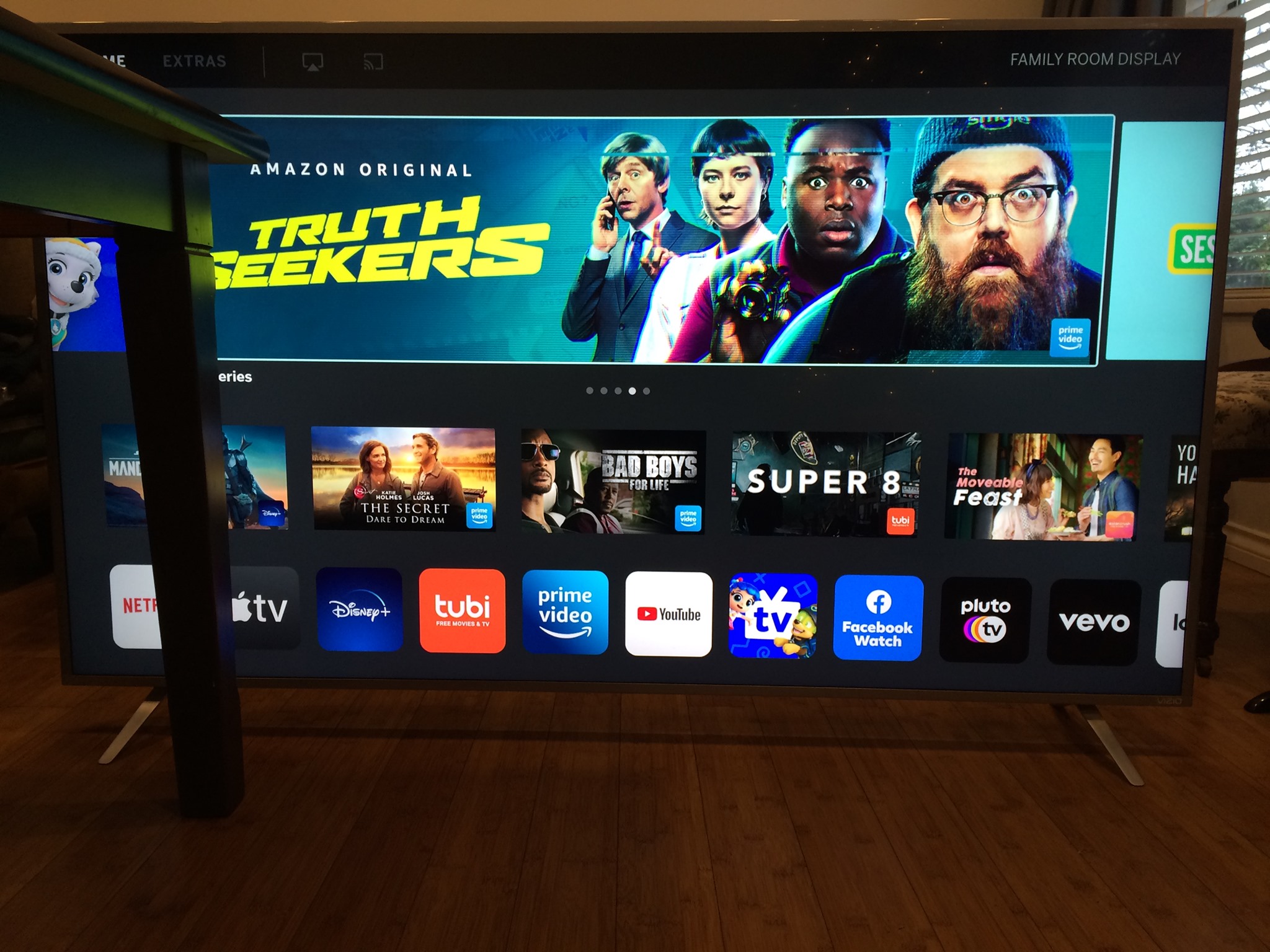

                      I was in disbelief, and I tried it, and it worked! Thanks for posting this. Attached are my in-progress and after shots. I was sure that this wouldn't work, but it did. Total cost $5.00, for the thermal paste.
                      The 6 power pins were 16v, btw. I wasn't sure if it was correct since I couldn't find a free service manual, but they were exactly 16v and didn't fluctuate at all. I didn't get any value of the ps_on pin, but I had to disconnect the switch to the back of the tv, so maybe that's why.

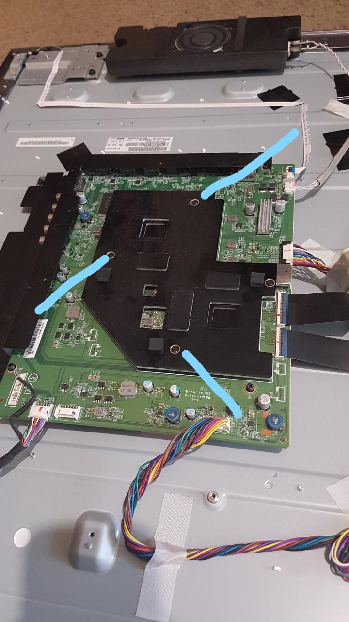

                          Just wondering as I have a P65-C1 same issue. When I tested my standby voltage it was over 40. Then of course when I took the power board off got a nice shock. With that said my main board was replaced under warranty 2018 and tv is dead again so safe to say main board again?
                          How do I go about baking the board (do I need the black shield off) and where does the paste go or is it needed?
