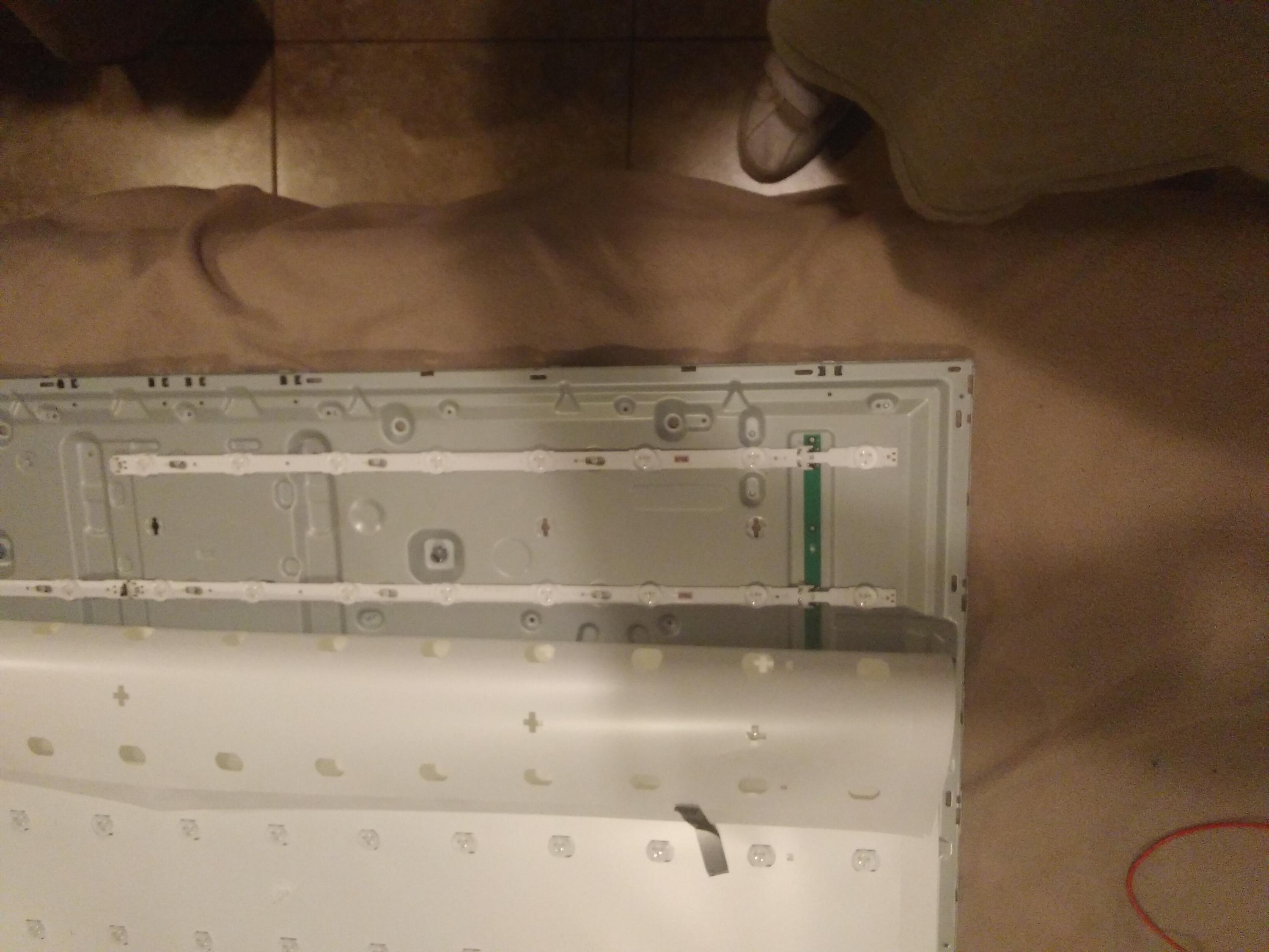

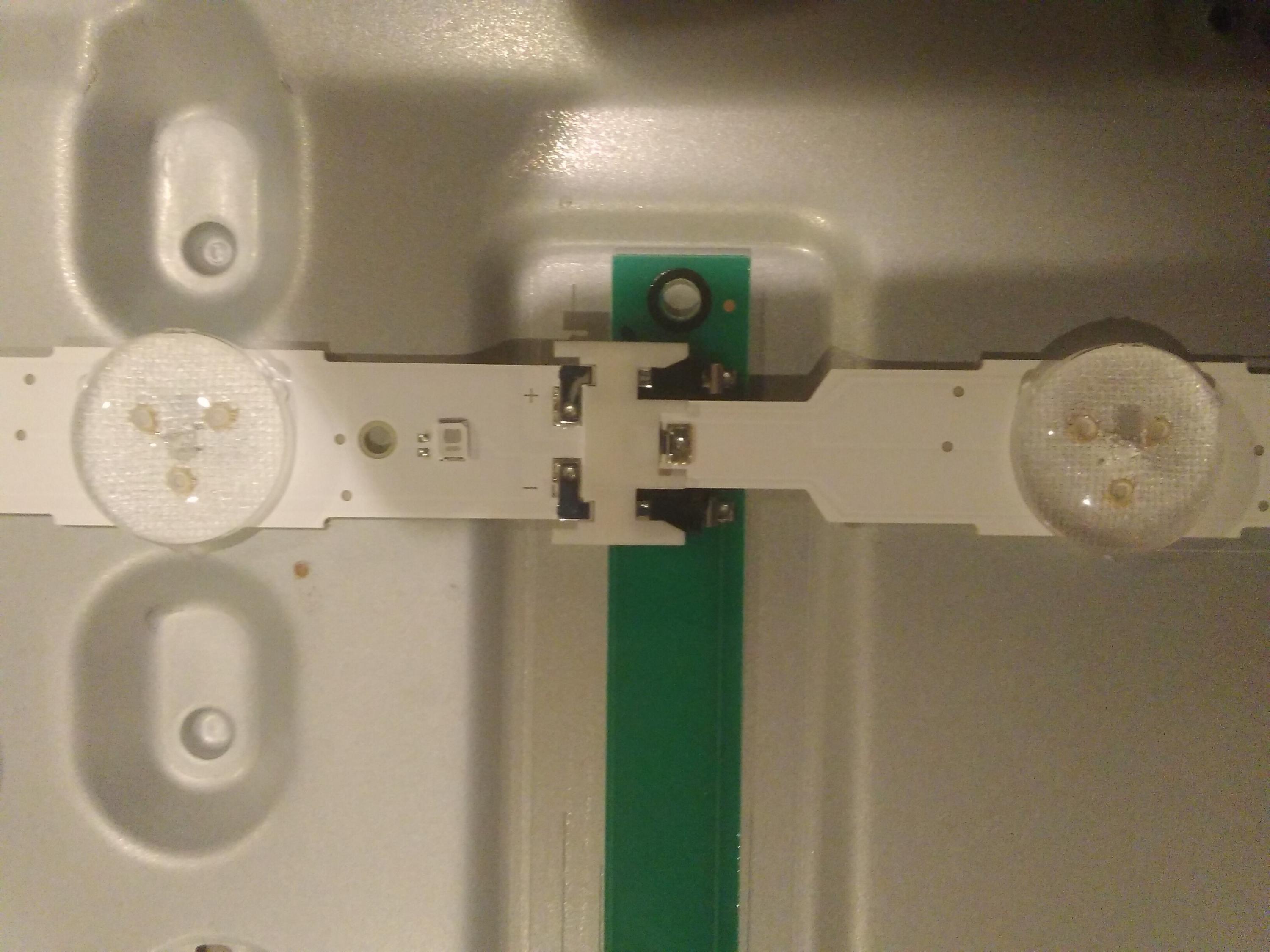

    UN55KU6300FXZA LED strip removal
    Hello Everybody, I cant get this LED strip to release from the distribution board so I can replace a burnt out LED... I dont want to break it, I tried squeezing the white plastic and that didn't work and I tried pushing the black part down and that didn't work maybe somebody knows the secret trick, maybe i'm just not holding my mouth right or something

    Re: UN55KU6300FXZA LED strip removal
    i never take the strips of Direct LED out unless i replace all strips ... for LED replace i leave the strip in place and do replacement work
    for edge LED i took the strips out and remove at once all LEDs then soldering new LEDs
      Take a pair of needle nose pliers and press down on the two tabs sticking out of the black plastic on the right at the same time. Slide strip out to the left.
