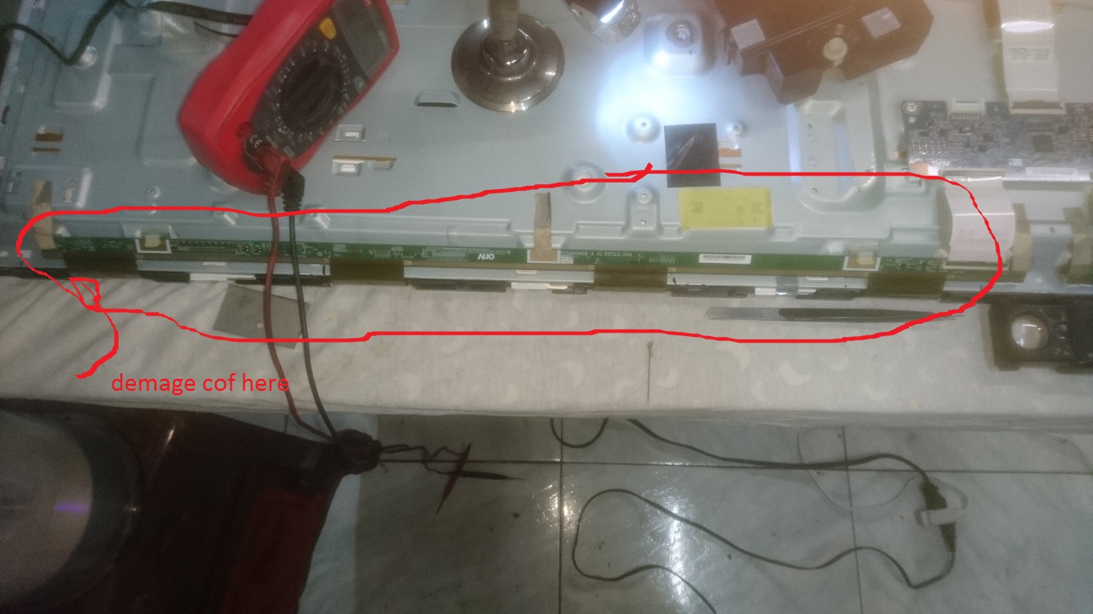

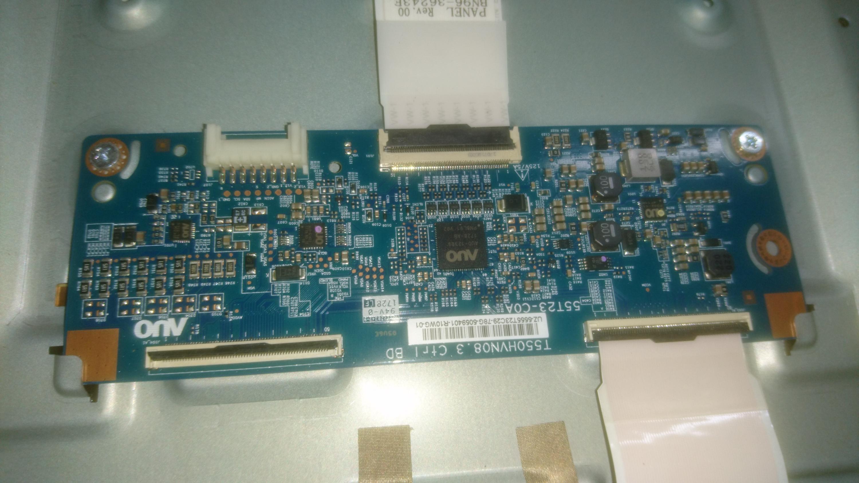

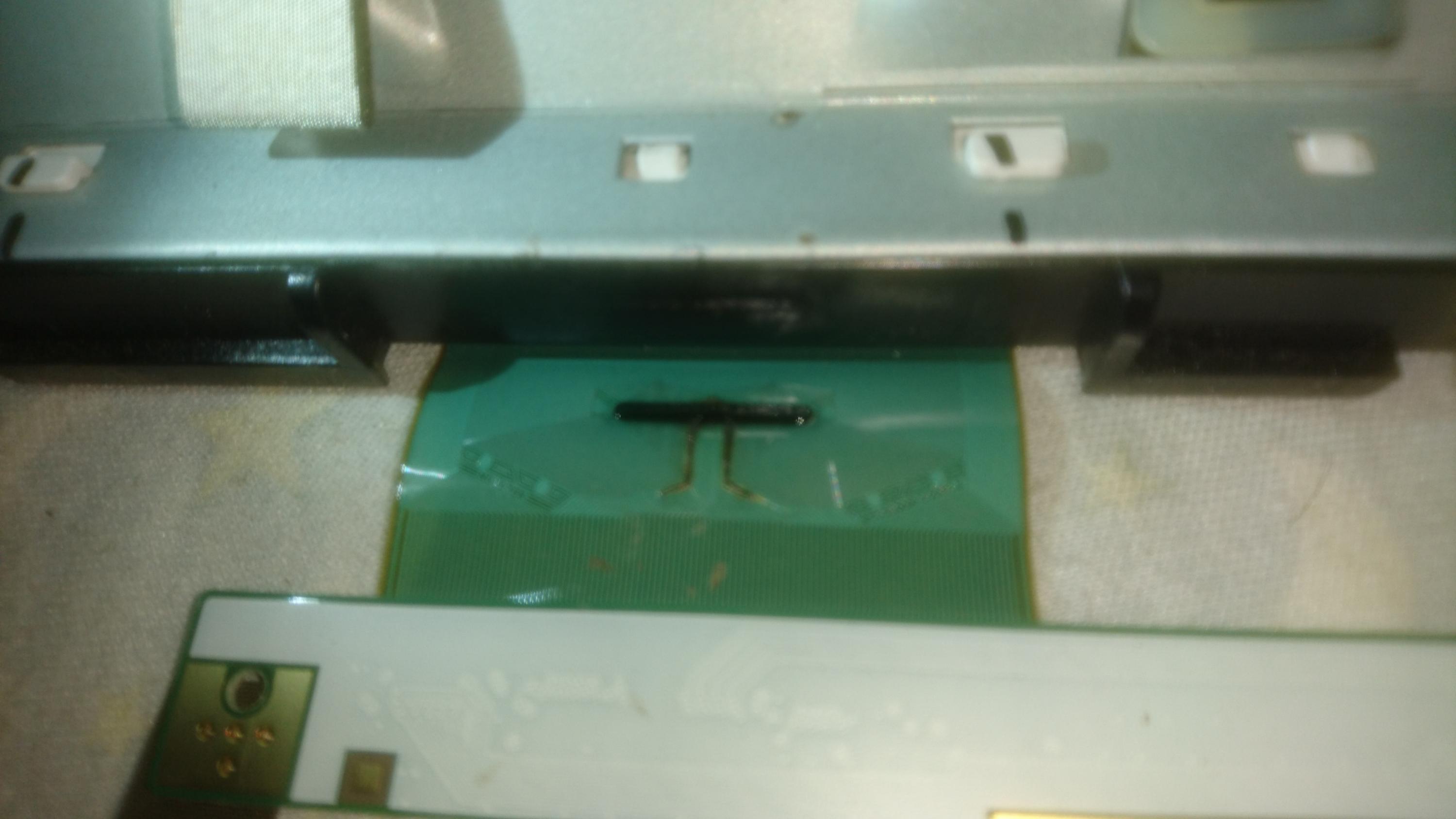

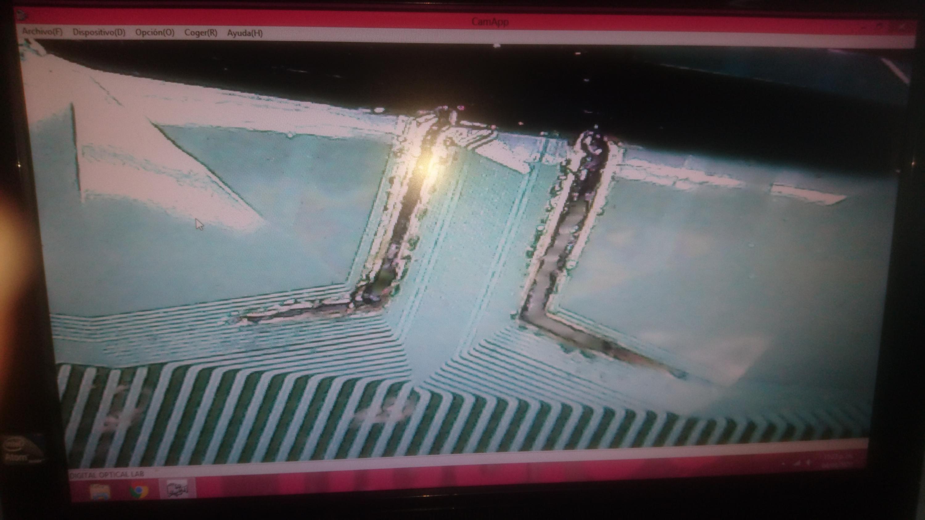

    hello friends i have a smart tv Samsung un55j5300Ak problem is when I turn on I see the smart tv logo then start to get white screen, I put cable tv I hear sound, tv goes white screen, I dissembly and I saw cof damage nt65800h there's anyway to bypass cof , I don't understand where I have to cut to isolate that part and have good video on both sides. I need cof data sheet anyone... left side I remove ribbon I have good video on the righ side, problem is the left side cof is burn.

    in the first picture that you posted, where is that located, the bottom of the panel or side? iF it is the bottom of the panel, then there is no way to save / by-pass this. IF it is on the side of the panel, then all the tabs along that side can be removed.

      here is another picture where is located, thank you

        also what do you mean on the side of the panel, then all the tabs along that side can be removed. in the picture i have the cof in the corner on the left panel can i do that remove all tabs, thats not the same as having remove white ribbon and only half of the screen woul have good video.
          Re: samsung
          Nothing to save at this point with taht bunt out COF.
