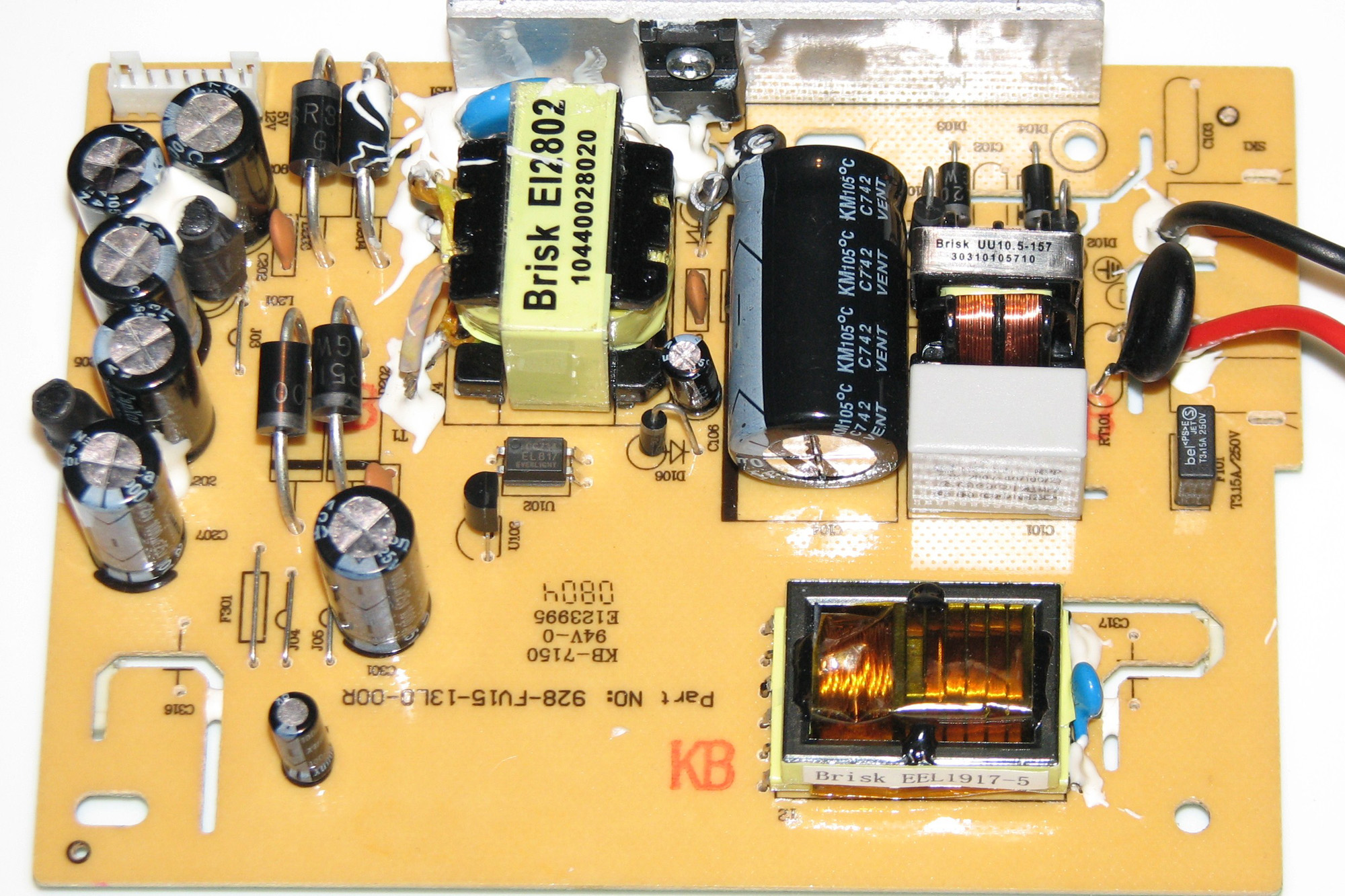

    I have a Coby 15" flat panel TV that appears to have a bad inverter. When I turn the TV on, the power light goes green and stays green, but the backlight (2 bulbs) only comes on at powerup for a few seconds and then goes blank.
    I confirmed the TV is working OK, I have sound and with a flashlight behind the screen ( BOE HT150X02 disassembled) , I can see the picture. The setup and mode features all work OK.
    I have confirmed the inverter has 5V and 12VDC. I connected each bulb individually and switched connections on the inverter and powered up. Both bulbs went blank after a few seconds on powerup.
    So based on this and the great informaiton on the threads I have spent a lot of time reading before my post, I think the inverter is the issue. I do not have any bulging caps or burn spots. I have checked all diodes for shorts - none and I have soldered all diodes and transformer leads on the board.
    Thanks in advance for the help

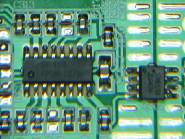

                Thanks for the feedback. IC part number is STM6920A. I was able to find a datasheet . I checked for shorts on G D S and found none. It still could be bad.
                Would you recommend replacing it anyway and if so any recommendations on where I can purchase one?

                  Thanks, I have added a close up picture of the ICs on bottom of the board. The 16 pin IC is BIT3713.
                  Any ideas to troubleshoot are greatly appreciated.

                    BIT3713 is now known as a BIT3193. I'll have to see if I can find an application note on it. We're going to have to see if we can figure out WHY it is shutting down. This could take a while. Suddenly the demands on my time are increasing. And I really need a higher resolution picture of the entire board. The resolution of the latest picture is excellent - better than I need, actually, but I must be able to trace the circuits from both CCFL connectors back to the control IC (BIT3713 AKA BIT3193).
                    PlainBill

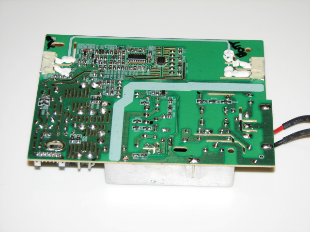

                        Re: Coby Flat Panel TV Bad Inverter
                        Bobdee - thanks for the help and information
                        PlainBill - thanks for comments. Per your request, I have added a bottom view of the inverter, please let me know if this is not good enough quality for your needs.
                        As I noted in my original post, the caps look OK, no bulges. But if you think I need to eliminate variables and should replace them, I can. The list is as follows:
                        6 - Capxon KF 1000 uf 25V
                        1 - Capxon RK 100 uf 16V
                        1 - Capxon KM 10 uf 50V
                        Any help to xref these to readily available quality caps would be appreciated.
                        Do I need to worry about replacing any of the pf caps?

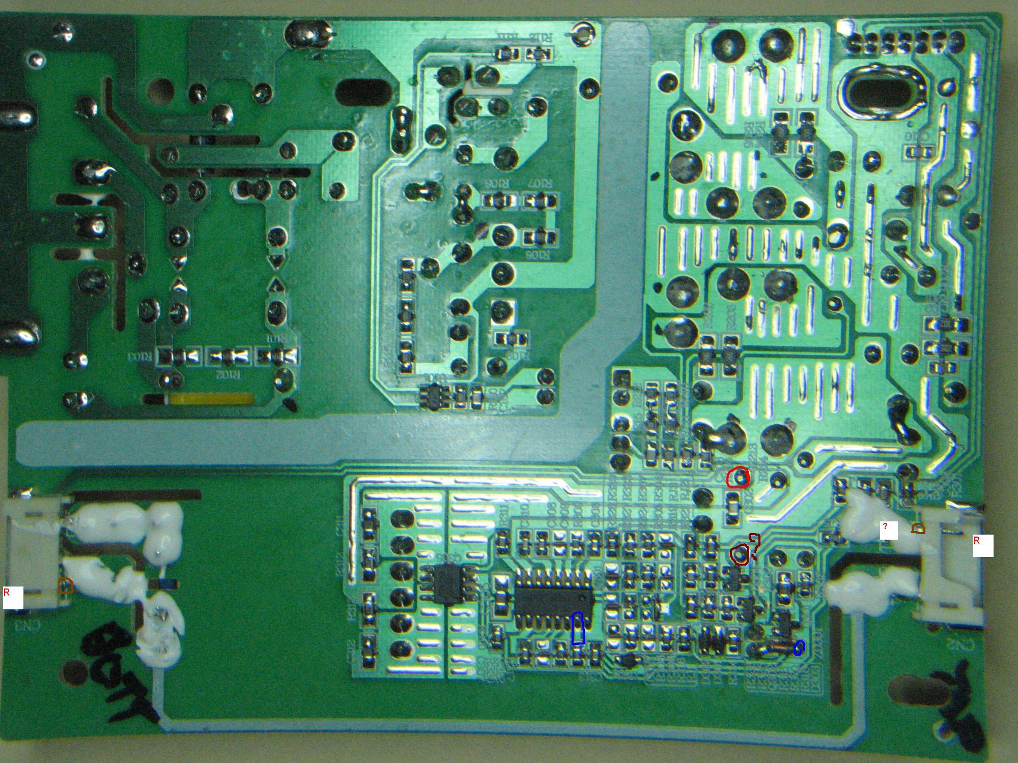

                            I've marked up the picture you attached. The two points I've marked 'R' in red are the return lines from each CCFL. I've also circled the pin on the connector in brown. The one on the left should go to the solder pad circled in bright red. I think a jumper conducts the signal to the point circled in dark red. Please confirm that. I'm not sure where the signal from the pin on the right comes out from under the goop.
                            Pin 15 (outlined in blue) on the controller is the current sense pin. I THINK it goes over to the diode (also circled in blue). Please confirm that.
                            A very brief summary of the operation of the controller: When it is commanded ON it drives the transformer and CCFLs at full power. After a few seconds it begins monitoring the voltage on pin 15. If it is below 1.3 volts it turns off the CCFLs. Check the voltage on pin 15 when the backlights turn on; also check the voltage at each return line (brown circles).
                            PlaBill

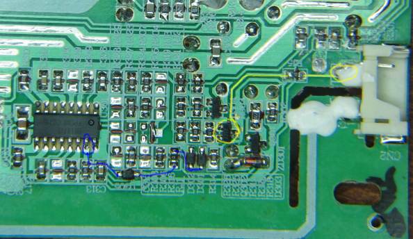

                              PlainBill, here is my feedback for you.
                              Answer - Yes that is correct
                              Answer – I removed the goop and traced it in yellow, see attached photo
                              Answer – pin 15 goes to a different diode than you indicated, I traced it in blue, see photo
                              Answer – pin 15 voltage was 0.03v when I turned the TV on and went to 0.04v when the backlights turned on for a couple seconds and then went blank. The return line voltage put the meter in to over voltage when the backlights came on and then dropped to nothing when the backlight turned off a couple seconds later.
                              I do not know what this all means, but if you do, I really would appreciate the help. Thanks

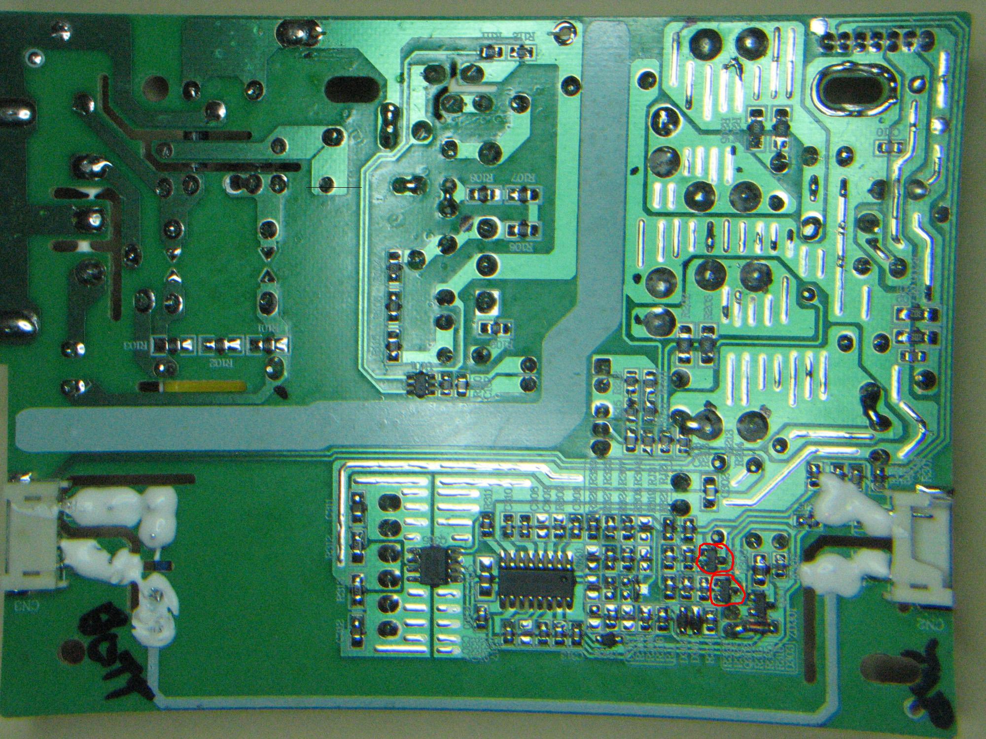

                                BINGO!!! We have a winner!!! You may have to carefully trace the circuit to identify the defective component. I'll try to identify a schematic that illustrates what is happening, but here's a text description.
                                The inverter puts out 700 - 1000 VAC to drive the CCFLs. Rather than ground the return line from the CCFL, it goes to a dual diode. When the output voltage is negative, the diode shunts it to ground. When it is positive, the diode conducts and charges a small capacitor through a resistor network. Pin 15 of the inverter controller monitors the voltage on that capacitor. If the voltage is greater than 1.3 volts it 'knows' the CCFLS are both operating properly. If it is less than 1.3, it turns off the inverter. The fact that the voltage at pin 15 was so low while the voltage at the return line was so high indicates an open component.
                                I've identified the two dual diodes by circling them in red. I suspect you will find one side of one of the diodes shorted. Try to trace the circuit back to pin 15 of the inverter controller.
                                PlainBill
