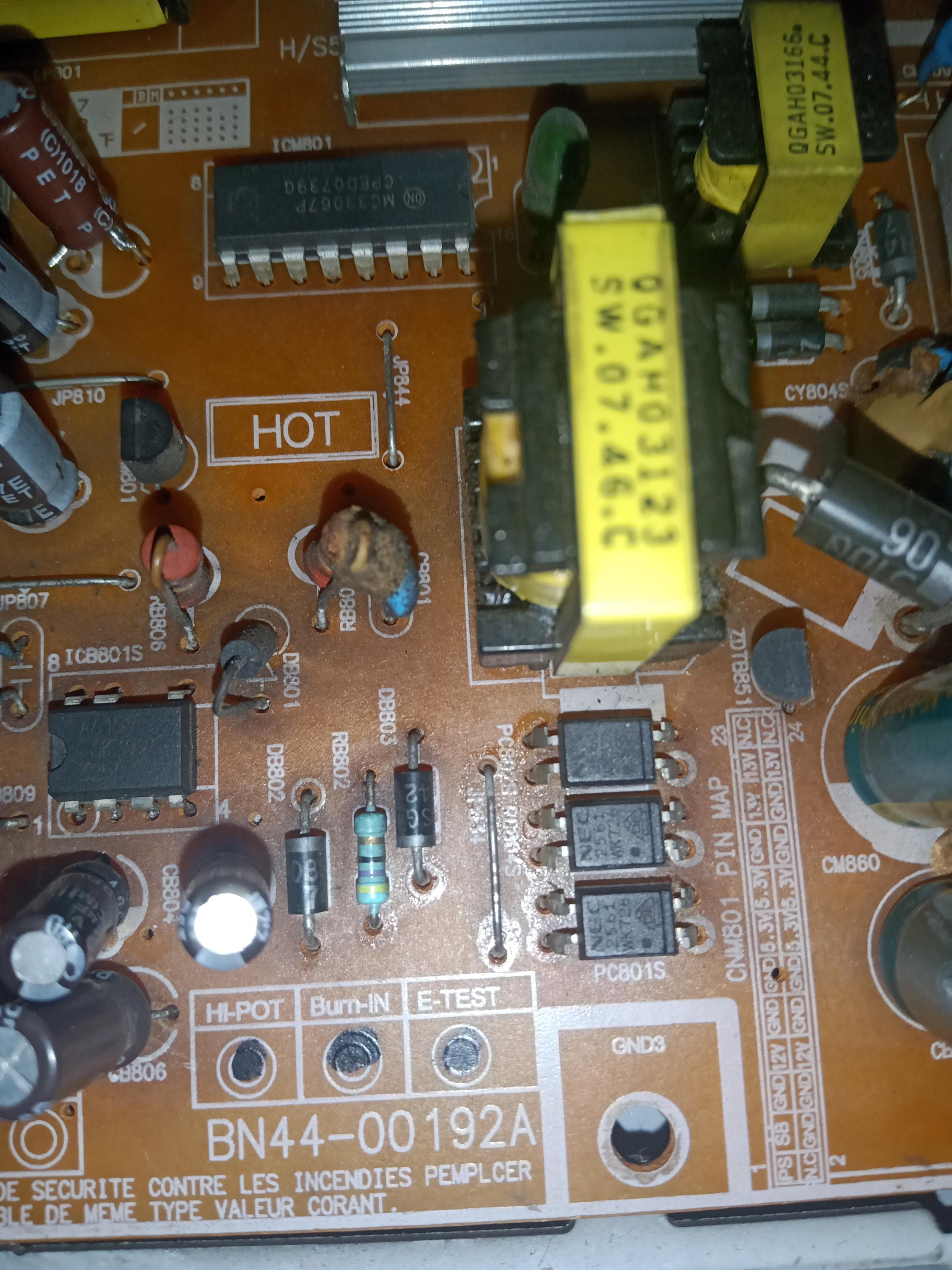

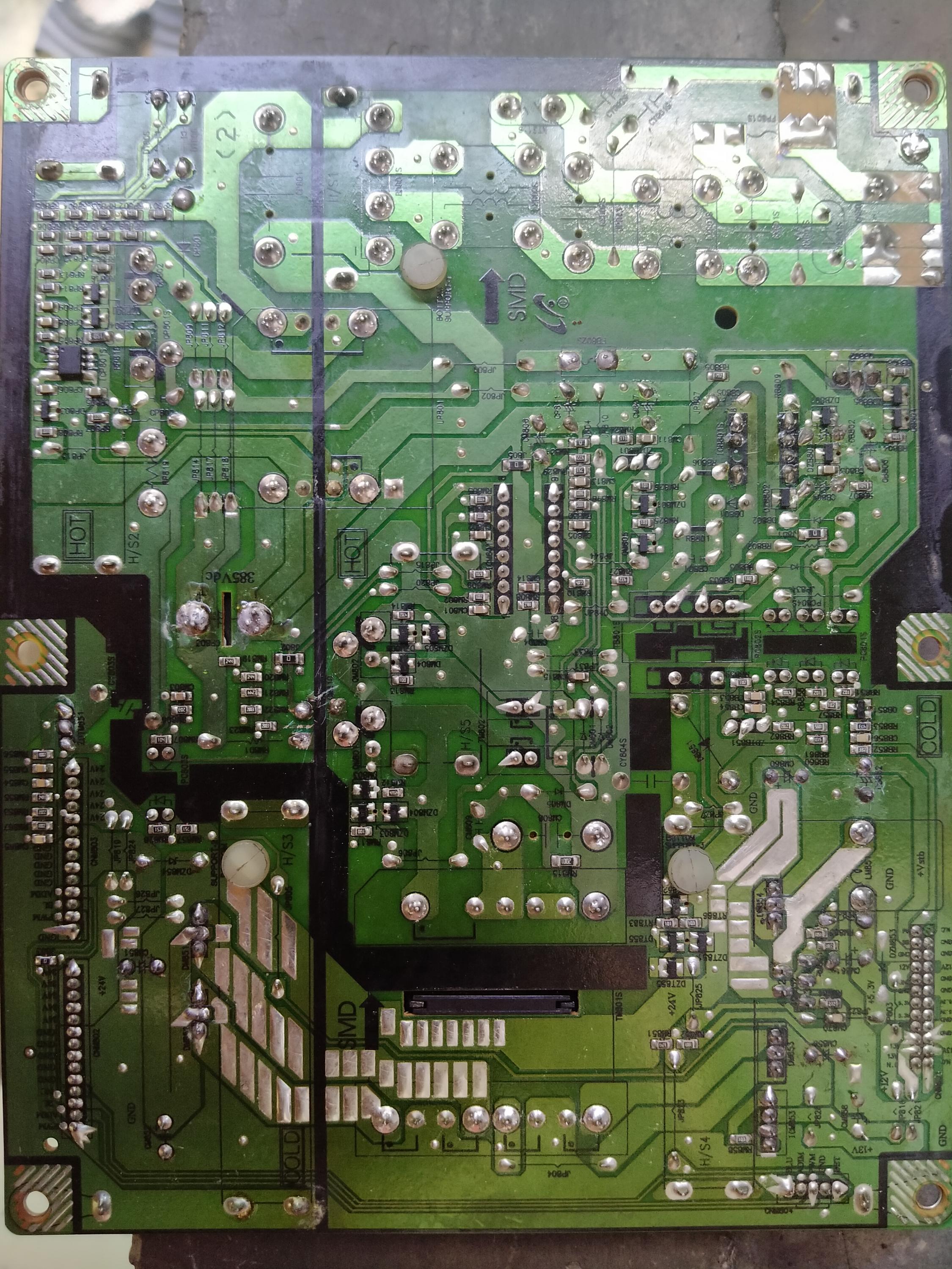

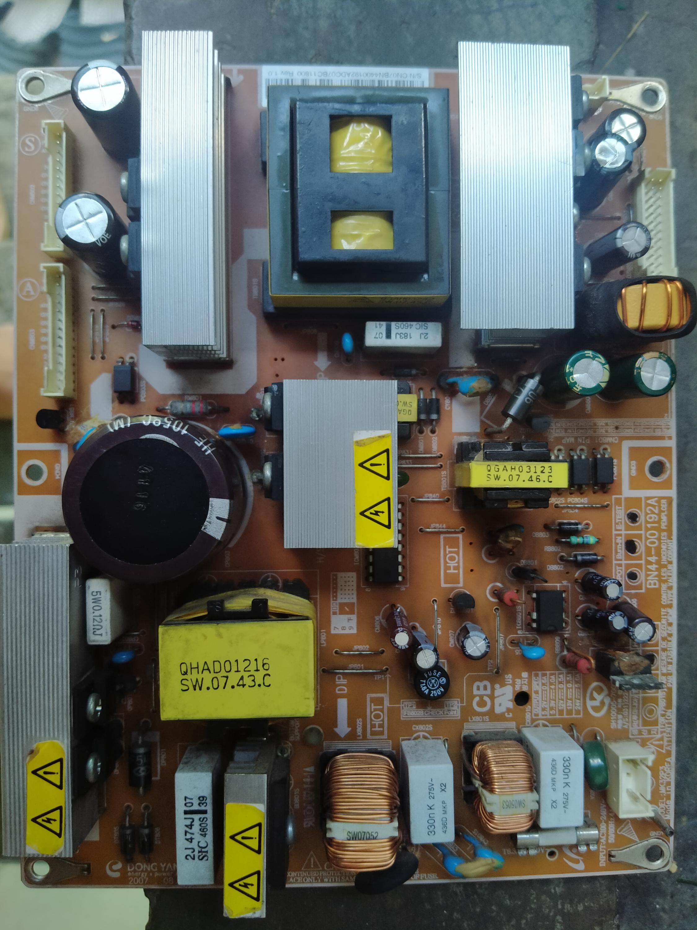

            1) We need to see the straight shots pictures of the whole top and bottom side of the board (BN44-00192A).
            2) The board had bad brown glues that need to be removed, it is conductive and corrosive.
            3) From post #1:Are you sure you count the pins correctly? We also need the Voltage readings of all the pins.

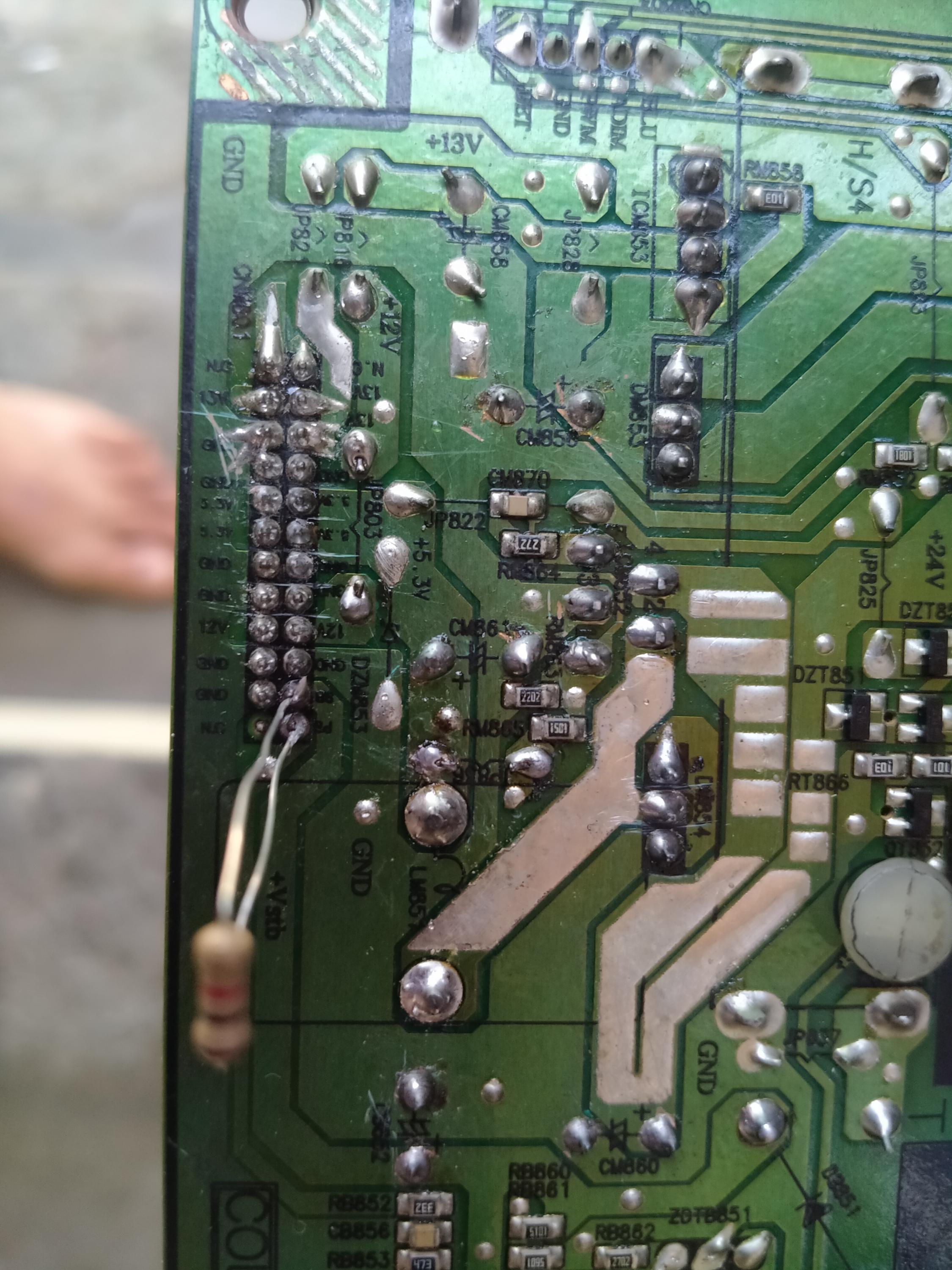

              Re: Samsung LA32R81B Not Turning On
              Tried to cleaned and remove those brown glue as much as I can, bench test the power board and here are the result.
              SB - 5.17
              PS - 4.14
              12V - 0
              13V - 0.49
              5.3V - 0
              24V - 0
              Main cap - 379
              I have those voltage check on the same pin where I put the 1k resistor.
              Thanks a lot.

                Check RM801 (0.22 Ohms MOX).
                • killpatrick
                  • Nov 2016
                  • 40
                  • Philippines
                  Desoldered this resistor and checked using digital meter, x200 and the reading is 00.6, if i short the test leads it will have 00.4 so I think the range is in 00.2. Thanks budm.

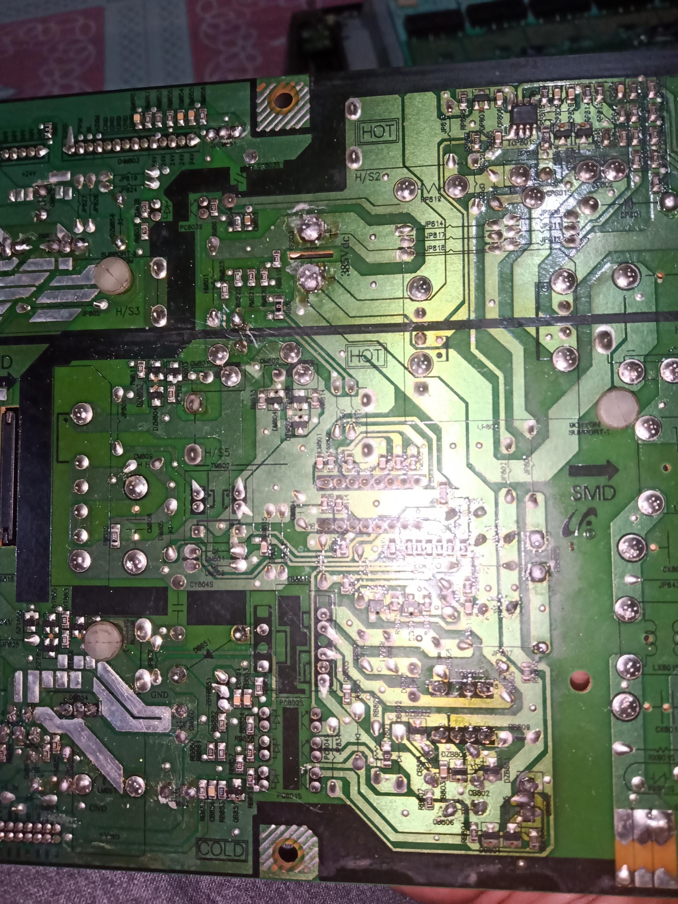

                                    hi, checked for any shorted components, when I put my test leads in the main cap, there is a short in the circuit, so trace the lines, remove the main cap, still shorted, follow all the lines of the main cap and there's a short in the icb801s. pin 1 is shorted to pin 8, so desoldered the said ic and indead they are short, replaced it with same ic but still havent tested the board since I still have no fuse, will it be okay if I used a 5a glass fuse? Electronic shop have no fuse for 6.3a. thanks guys
