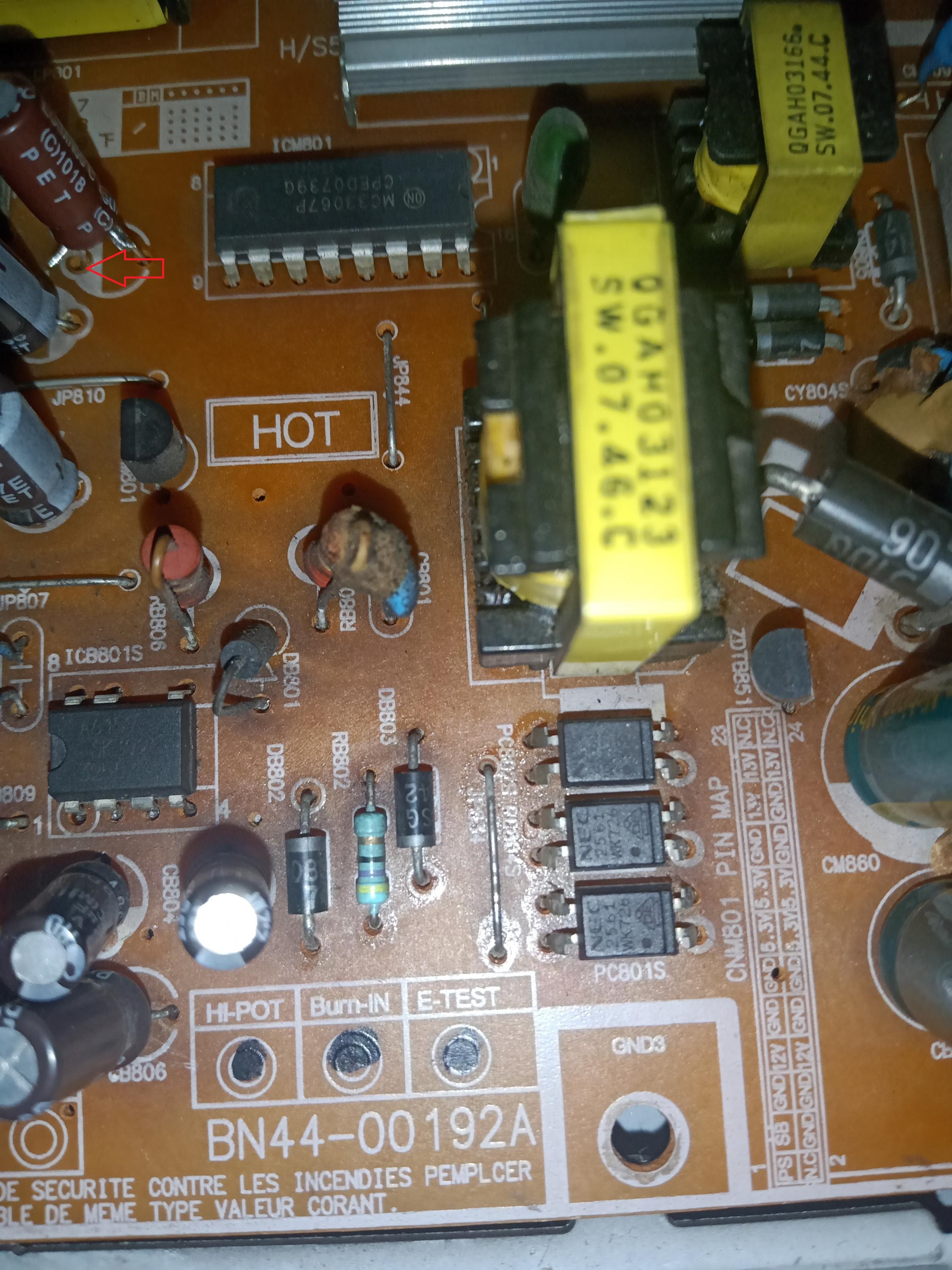

                In the picture (red arrow pointer) there's an electrolytic capacitor alongside the ICM801 which looks as though one leg is not soldered. Can you check it out.
                  Re: Samsung LA32R81B Not Turning On
                  Hi dick, thanks for the response, it is soldered, I have fix that leg sorry bout that picture.
