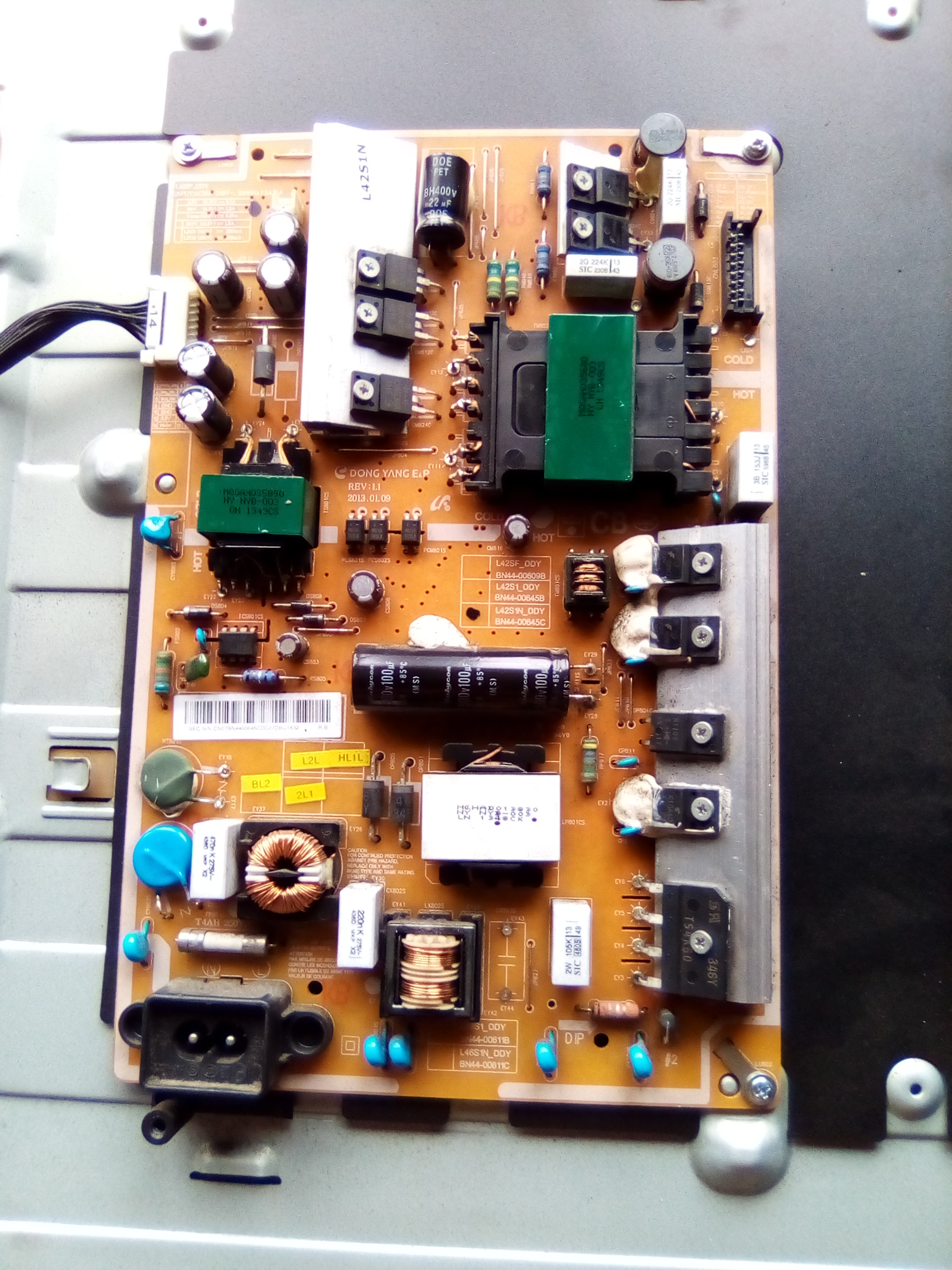

samsung 40f5000 voltage very high
  • hispeck
    • Aug 2015
    • 258
    • nigeria
    Hello i have a samsung 40f5000 led tv, when i opened to the back light i found some burnt led and the white plastic all burnt, so am asking because when i test the back light voltage i got 332v and the back light is haven 91 leds, i stand to be corrected , 3v x 91 =273v , but someone said the voltage is meant to be high without load. i need help
  • dick_barton
    • Aug 2015
    • 6643
    • Wales
    Re: samsung 40f5000 voltage very high
    It's not unusual for the led voltage to be higher when the leds are open circuit and the set is powered up. The voltage often initially peaks and then drops back.
