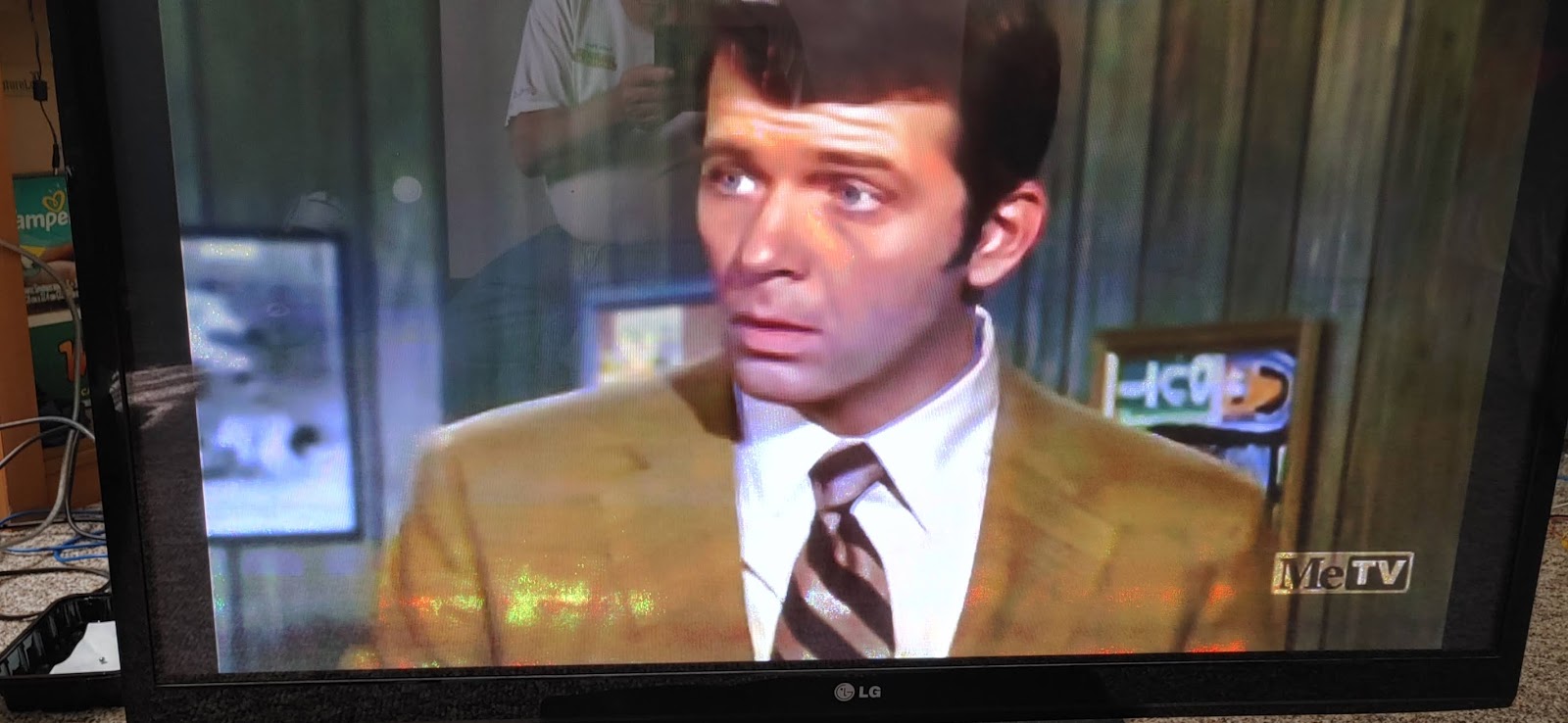

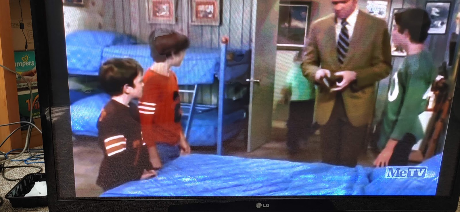

                                      Here are a couple pictures of how the screen looks.

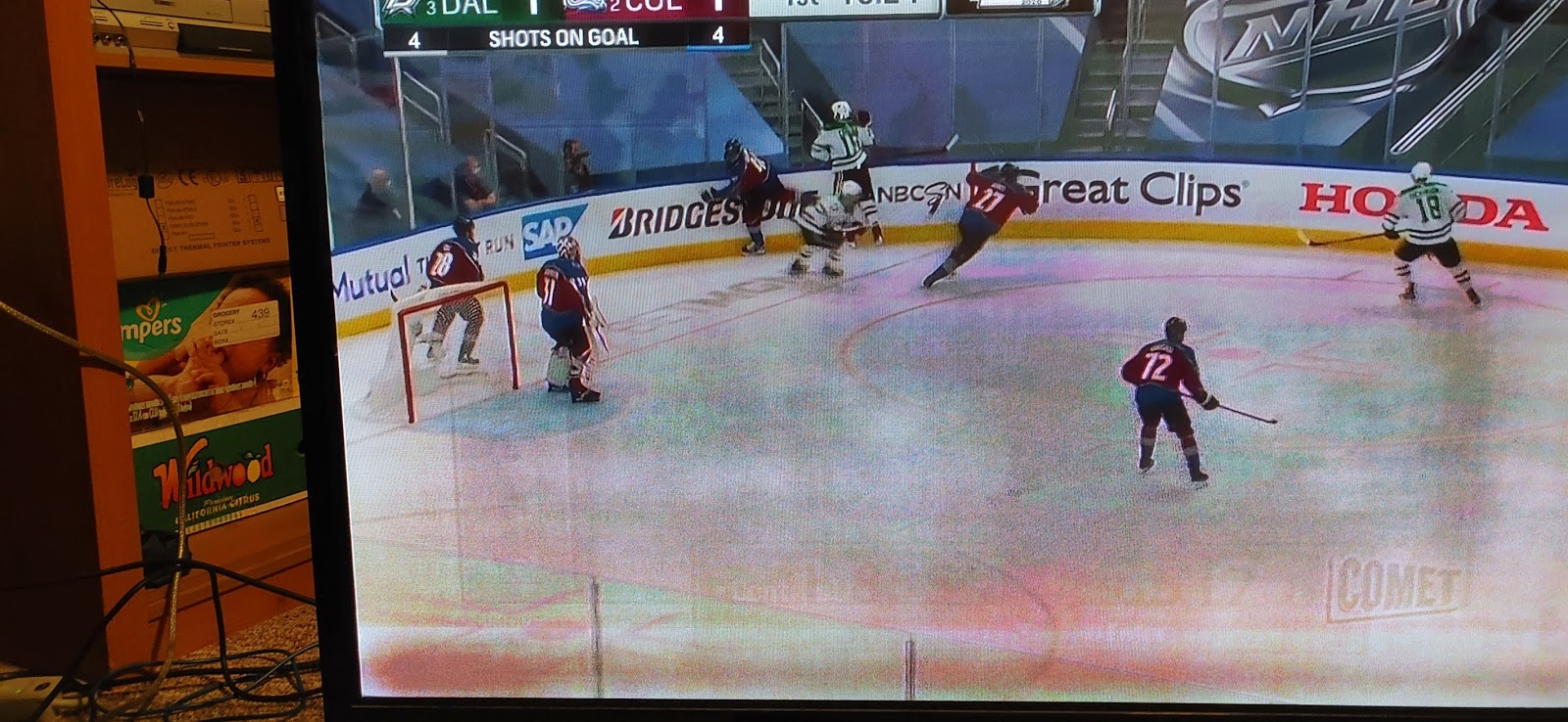

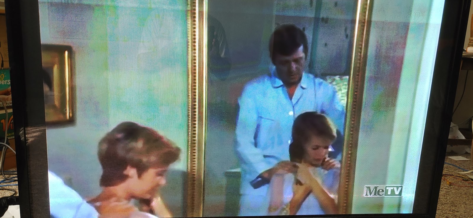

                                        Re: LG 50PJ350 plasma blowing Y-Sustain board
                                        Here are a few more pictures that show the problem a little more clearly than my earlier post last night. The 1st one you can see a grayish shadow in the background of most of the picture, the 2nd one you can see the brighter spots on the blue bed blanket, and the last one the gold blotches on the guy's brown suit coat. Trying to figure out if I have a bad panel, bad board, or something mis-adjusted. I did check and adjust the VA, VS, VSC, and VY to the proper voltages indicated on the panel sticker. They weren't off by much more than 1 volt before I started. I also measured the Z bias on the Z sustain board and it's a perfect 95V just like it should be. The only adjustments I haven't verified yet are the Set-Up and Set-Down as they're very complicated and need to be done with a scope. I do have one but it went through a house fire in 06 and got damp from the water, and I haven't attempted to power it up since so I'm not sure if it even works anymore. Could those Set-Up and Set-Down adjustments being off very likely cause my display problem, or would it more likely be a bad board or bad plasma panel? The "Set-Down" heat sink is still running quite hot and I'm not sure if that's normal because I've never worked on this model before. I ran it around 10-15 minutes at a time and nothing has blown yet but I don't want to go to long until I know if that amount of heat is normal.
                                          The Y-sustain is not working properly, does it make a bunch of noise on the Y inductors? If it does, that also happened to one LG TV of mine.
                                          You can adjust Set UP/DN as much as you want, just remember their original positions or resistance, if the blacks start to get noisy and the white starts to show random pixels while TV is warmed, you need to adjust it.
                                          I suspect some components are partially damaged, but not enough to make the whole board fail.
