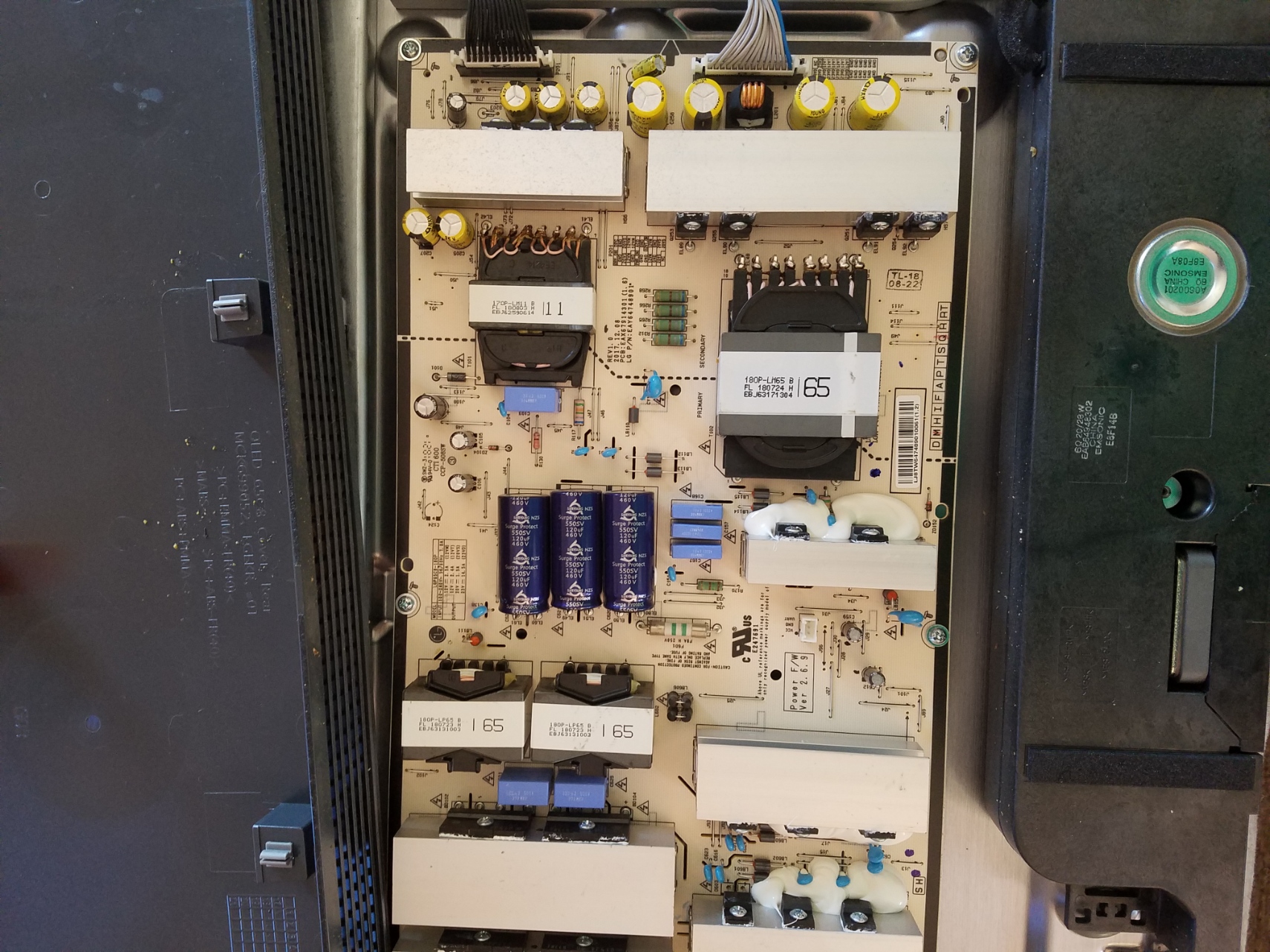

    This TV had a problem where no remotes would work, tried several that were confirmed working, so we were able to control it using the android phone app, just recently when we turned the tv off, some lighting at the very bottom of the tv happened, probably a few mm worth of light was flashing from the screen, despite the TV being off
    I unplugged it and left it that way overnight, i tried the TV again and it was working with netflix, the light flashing started again and then the tv just shut off
    Since the remote isnt working i am using the button on the tv and when i press it, a click noise happens but that is all, tried unplugging again with no luck

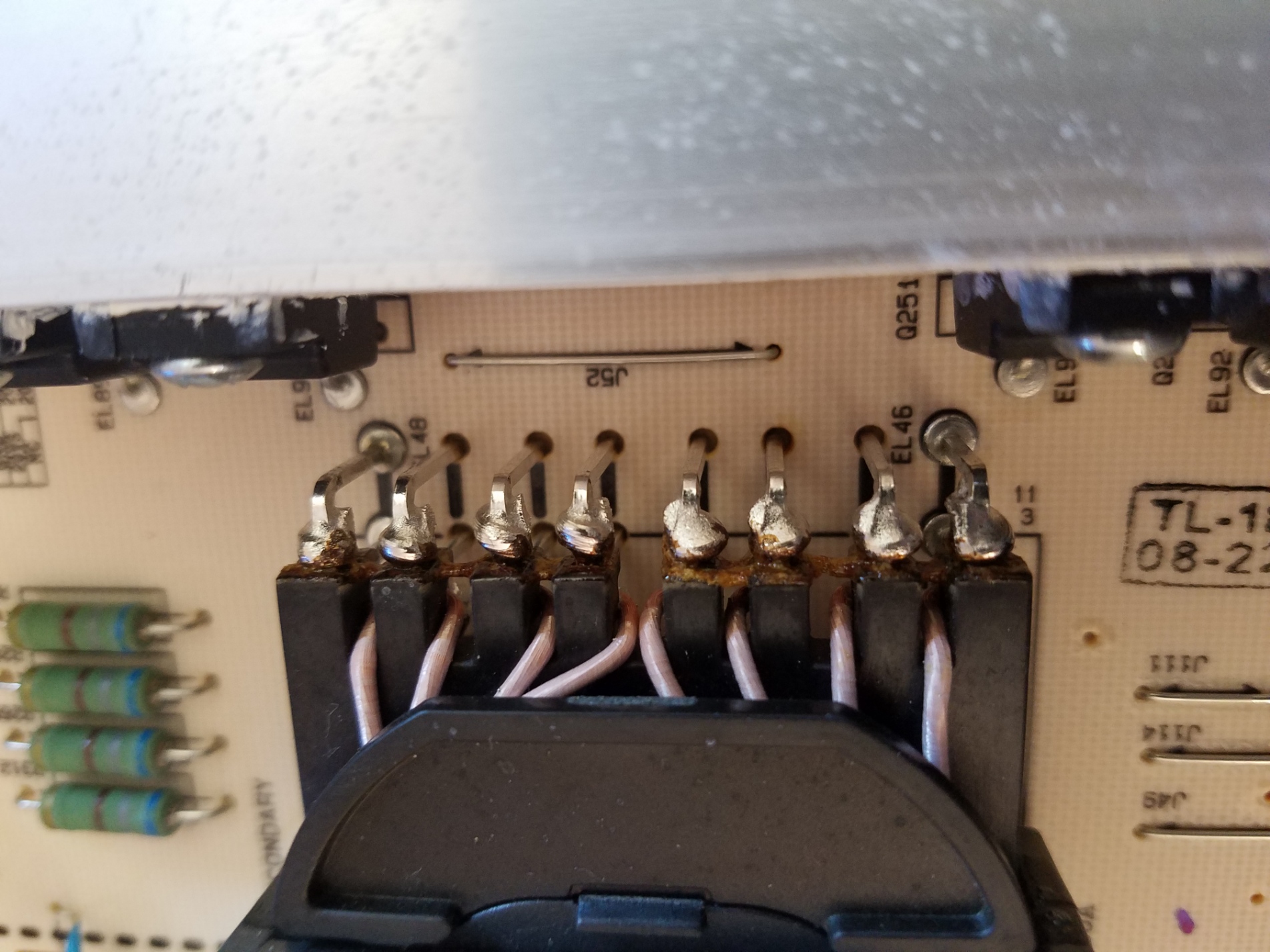

    I found 2 spots on the PSU that had some corrosion, not sure if that is the issue though
    I have a multimeter and can solder, but thats pretty much my limitation of electronic repair

    Do you have the voltages at P201 and at the connector lower down (can't see the number) as given on the power supply board
      the 2 spots on PSU are normal to me.
      few light on some places on screen sound bad to me..
      also do this test: the grey socket on the PSU which its goes to the T-CON driver.. disconnect it from PSU side then turn on the set.. keep watching the Red LED indicator at the front of the set. it will blinking 2 time then went out..as normal tv starting.. you can be sure its starting or not after while the sound optic output socket LED will turn Red. this test the screen will remain black .

        I think when the remote stopped working a few mth ago, that is when the led indicator stopped working as well, but i cant be entirely sure
        I did the test you mentioned, when i press the power button on the tv, it clicks as if turning on and then later another click as if turning off with no led or display
