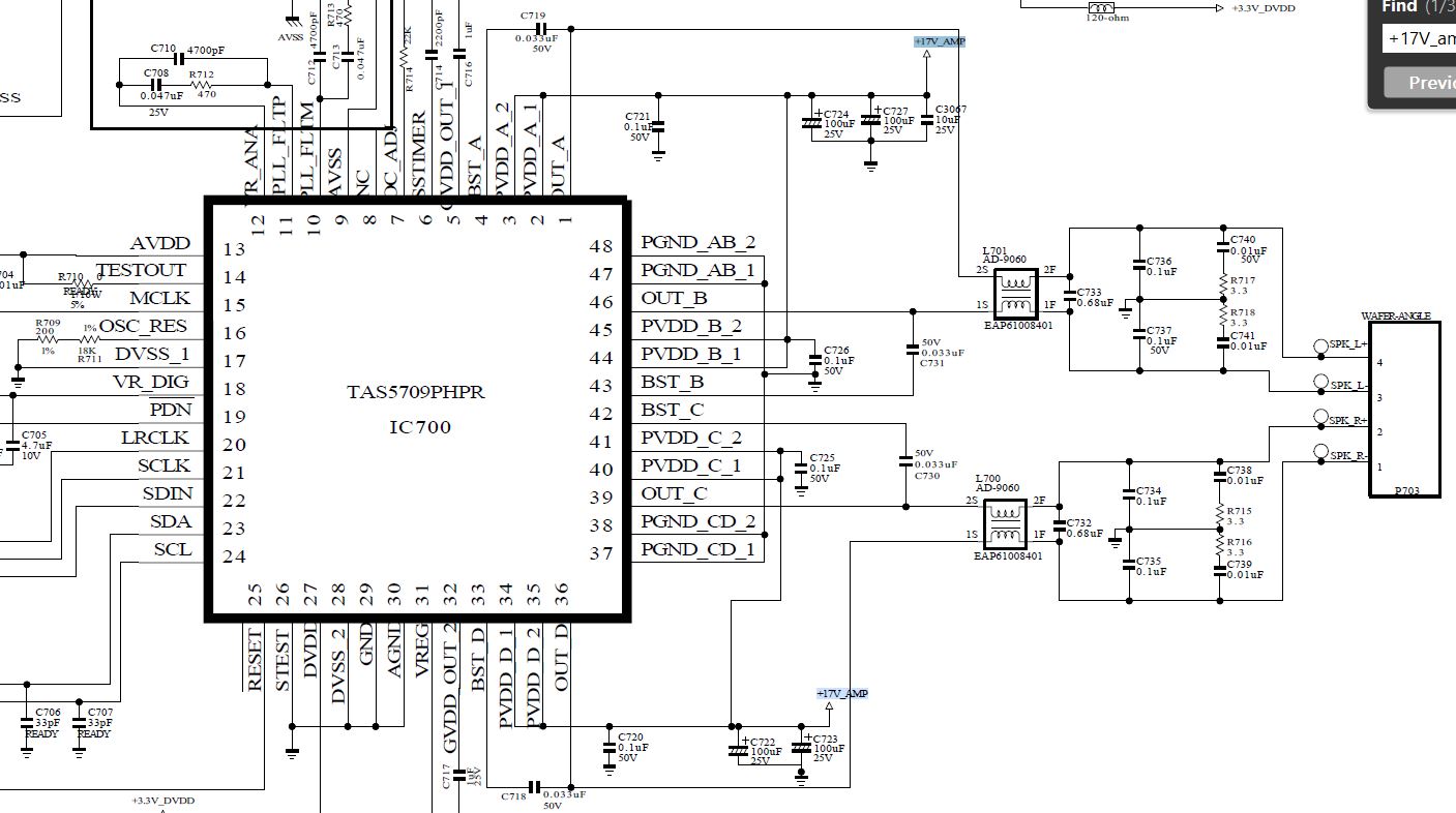

        Do you have the 17V_Amp to IC700

          Re: LG 60PK950 no sound
          Some pics...
          Enlargement of the two red rimmed boards:
          Enlargement of the chip on the last board:
          If more pics are of any help, I'm glad to post them!
          Thanks in advance!
          Richard
            OK, one step further.
            I suspected the lower right board with the tuner and HDMI ports. So I heated it slightly up with a heat gun. After a minute sound came back. So it "must" be a faulty connection/soldering joint.
            Any idea what components to suspect?
                  More than likely the cpu chip under the large heatsink is the culprit.
                    Took the board (eax61141605(0)) off. And heated it firmly on the backside.
                    It still works. Hopefully it stays like that while looking for a spare part. But so far Google links on this part are dead...
                      As tvtimmy pointed out, the main processor chip underneath the heatsink is more than likely the culprit, and I will second that.
                      We have fixed hundreds of these boards with that processor chip being the source of several different issues, from audio issues, HDMI issues, to the TV not even showing any picture on screen what so ever, and no audio at the same time.
                      It's a common failure and your heating did fix it and will fix it temporarily, but unless you either reflow, reball, or replace that chip, the issue will come back within the next few days, weeks or you might actually be okay for a few months if the cracked joint isn't that bad.
                        Thank you all for your answers!
                        Tv is still doing fine, but when it comes to silence again, I will reflow!
