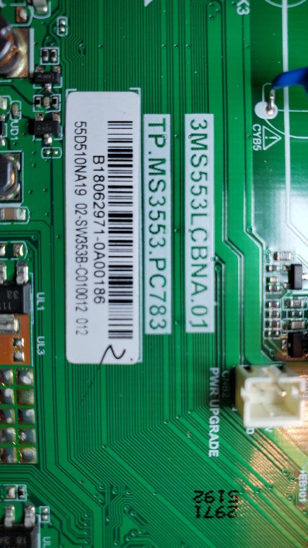

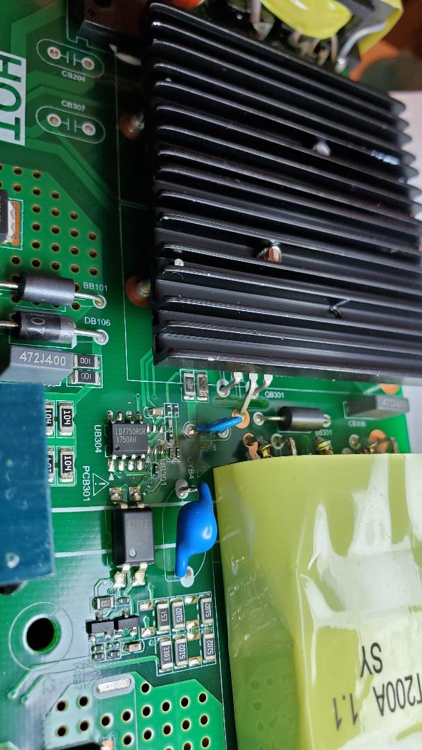

    This Tv came in with no backlights, audio was fine and with the flashlight test it showed the image was fine. Took measurements at led connector CNB801 and nothing. The backlights came on fine using a backlight tester so I pulled the combo PS/Main and put the board under the microscope and found a blown resistor at R8310, blown cap at C6316 and after replacing both she fired up fine. Before you assume it's the backlights look very close especially in this section.
    Re: Insignia NS-55D510NA19 backlight problem
    That is R/C snubber for the MOSFET, good find.
