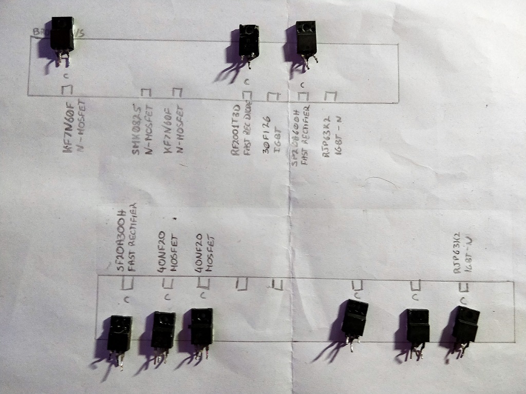

        Thanks I'm attaching a diagram with those that are shorted (marked with a C). I couldn't successfully read the part numbers of some of them.
        I've already removed the bad RJP63K2 and according to a previous post, it seems to be good. I did it like so:
        Continuity between Drain & Source: no continuity (and I am guessing this is good?).
        Then I've tested the On/Off state by charging the capacitor. I did this with the multi-meter by:
        1. Holding the negative on the Source, and touching the Gate with the positive lead.
        2. Then I moved the positive lead onto the Drain to test and got no connection.
        Just want to make sure that the above testing method is correct for all the shorted components?

          The testing method is correct, if the IGBT measured shorted in circuit but looks good when out of circuit this means there is another IGBT or some other failed component.
          Look at the traces to see what else could be the reason for the short.

            Thanks Is the testing of Mosfets and Rectifiers the same? Cause as you can see from the drawn diagram there is only one IGBT that is shorted, and from what I could find, these work a little bit different to Mosfets and Rectifiers.

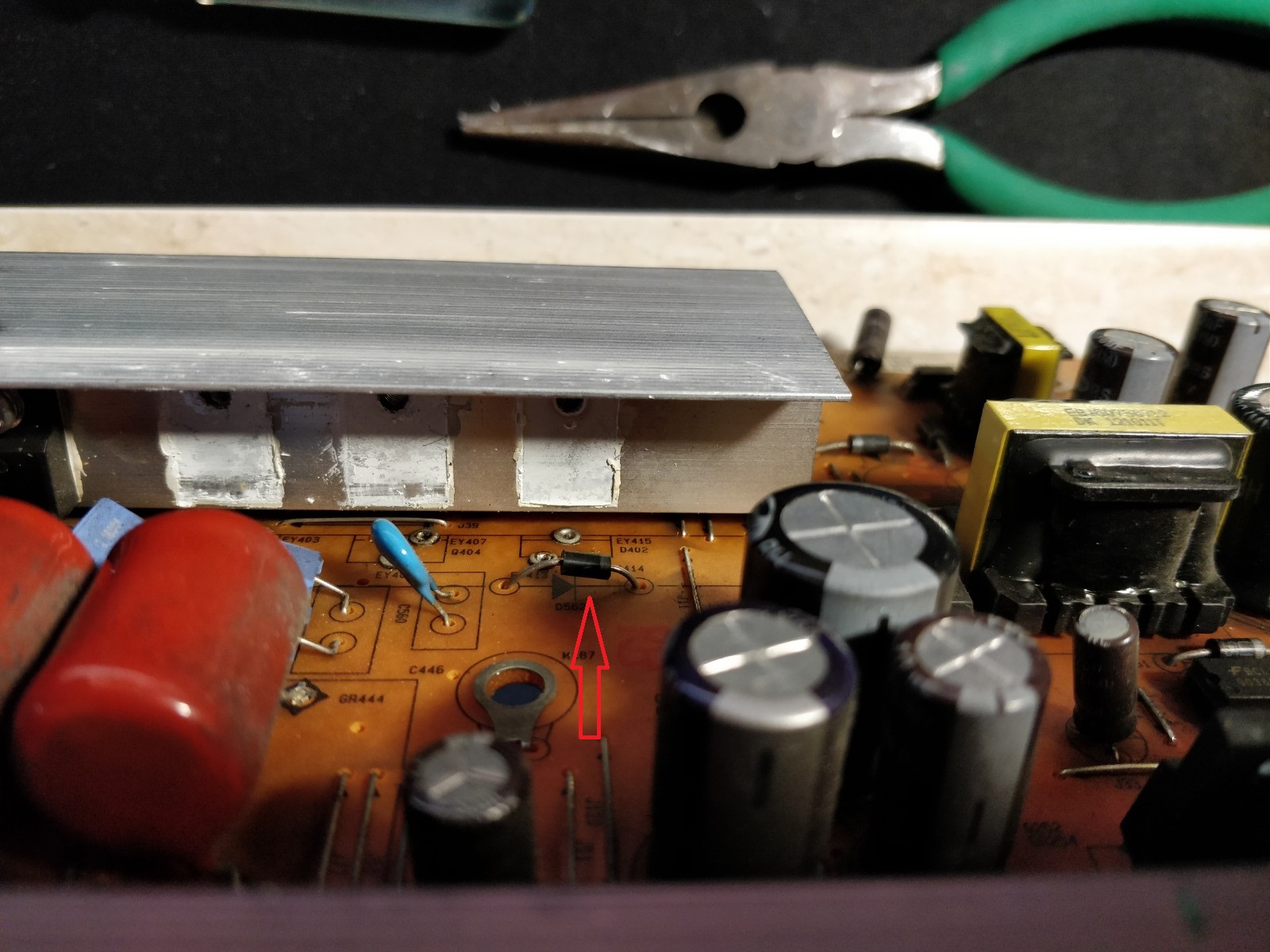

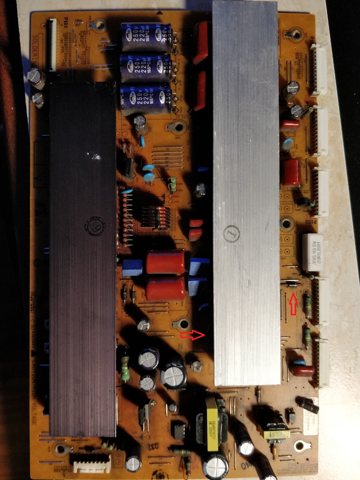

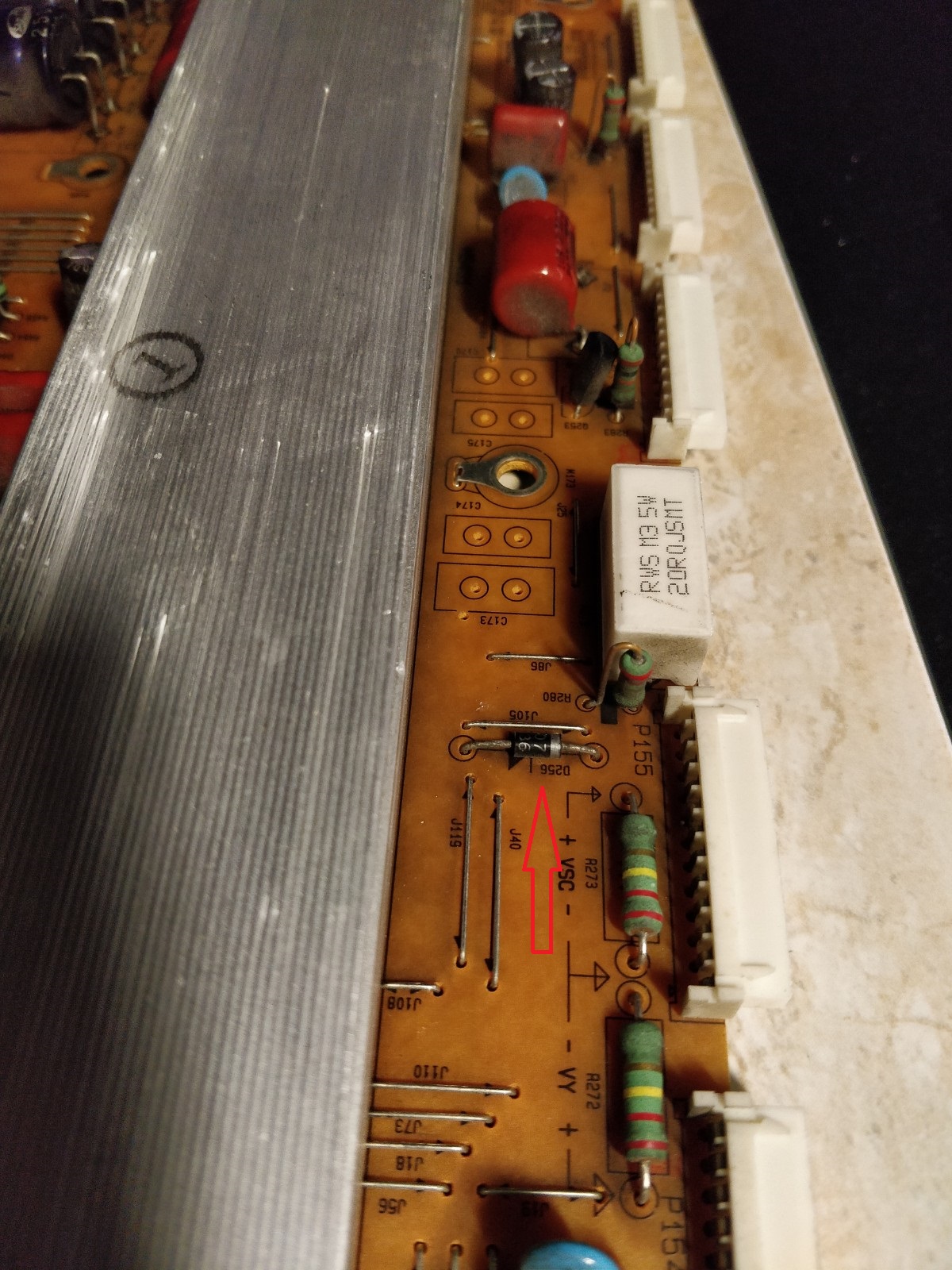

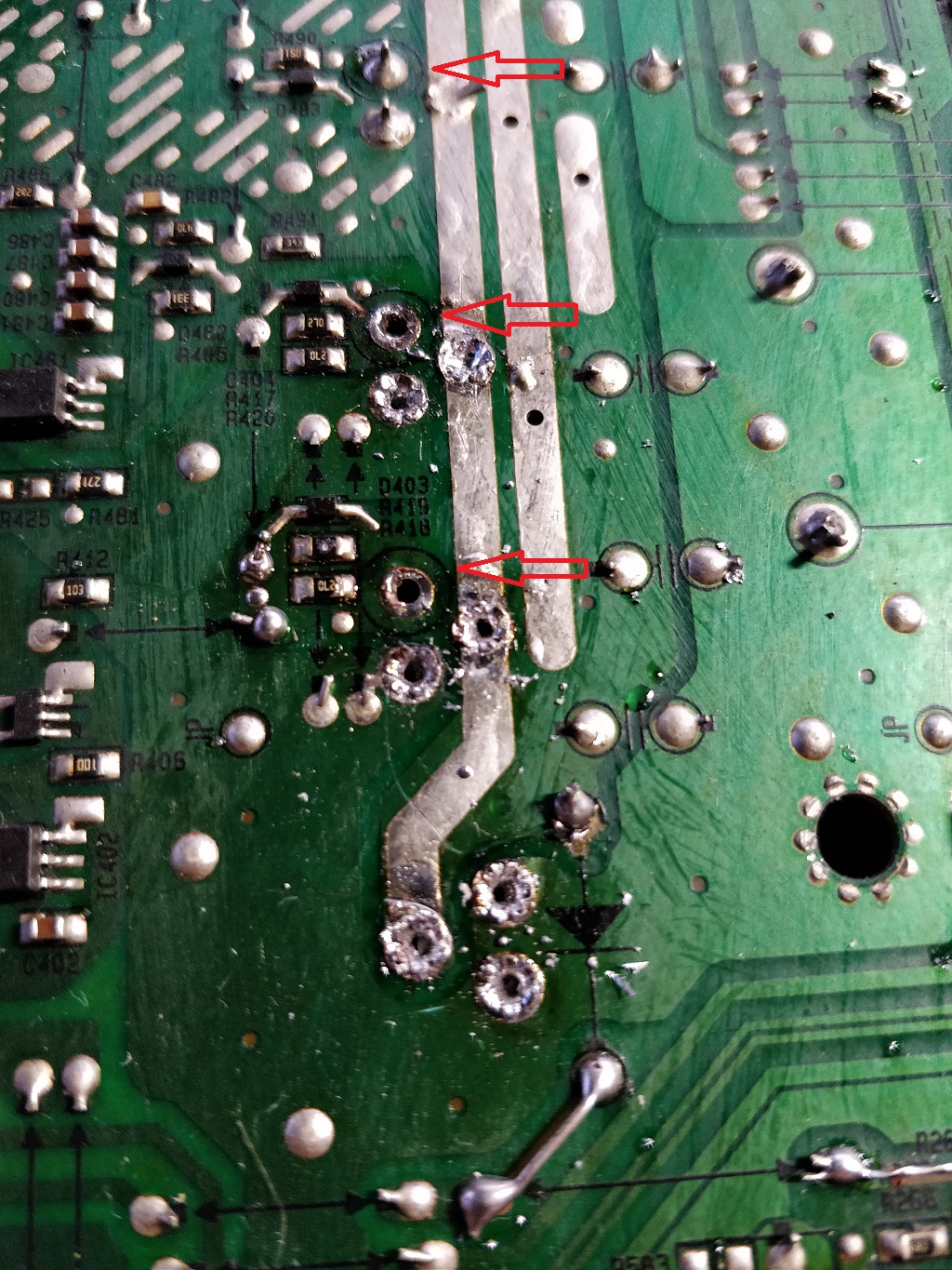

                So following that, I've checked diodes for short (in diode more + beep), and found 2 that "are shorted". I'm attaching 3 photos showing these diodes (one of the photos is a full view of the board).
                • tvtimmy
                  • Mar 2015
                  • 1160
                  • usa
                  Re: Troubleshooting LG Plasma
                  Do the diodes have 3 legs? If so, the outer ones are connected and they will beep or read short. Test them center to an outer then center to the other outer.
                    No the ones I've checked are 2 legged. I've pointed them out on the photos.

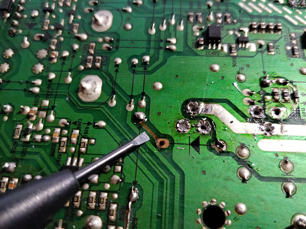

                        You're correct, removed one of them and it measured correctly.
                        But the other didn't, there's continuity from negative to positive, and reading when set to to diode mode shows 0.002.
                        Now this is a funny one (or funny because I've never seen it), cause the Cathode side has a long leg which seems to be connected to some other component which I am not able to see (it's hidden under the heatsink). I'm attaching an image.

                                  Why do I still have continuity on the IGBT / FETs / Rectifer connectors (holes) on the board even with the components out of the board (although not all of them have this)? I also noticed that 2 of the 3 holes of these components are covered in metal, the other is just a hole.
