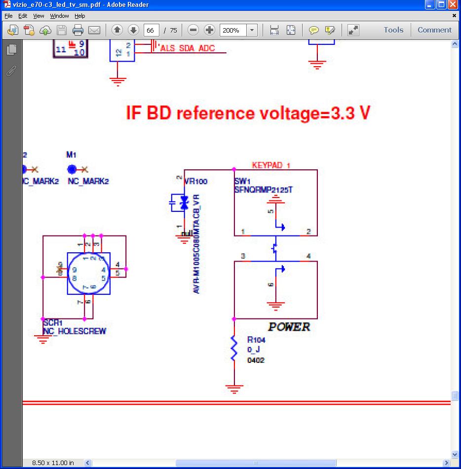

    Preamble: (skip if TL/DR)

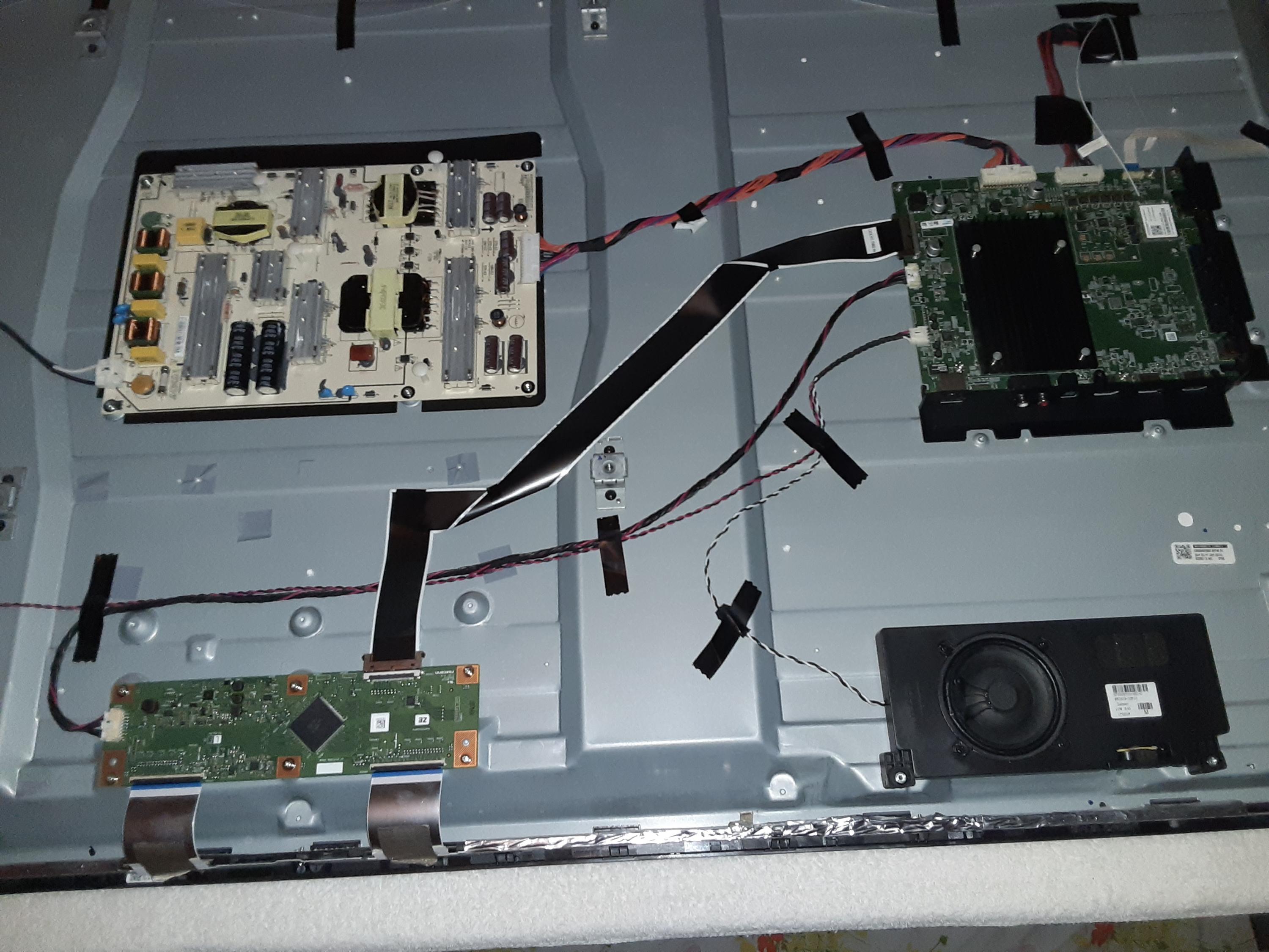

    This project started with a complete LED strips replacement because 6 of the 12 total strips were dim.
    We replaced all 12 strips - then we put the TV back together and it will not turn on. As I said, I have standby voltage but no LED voltage anywhere in the TV.

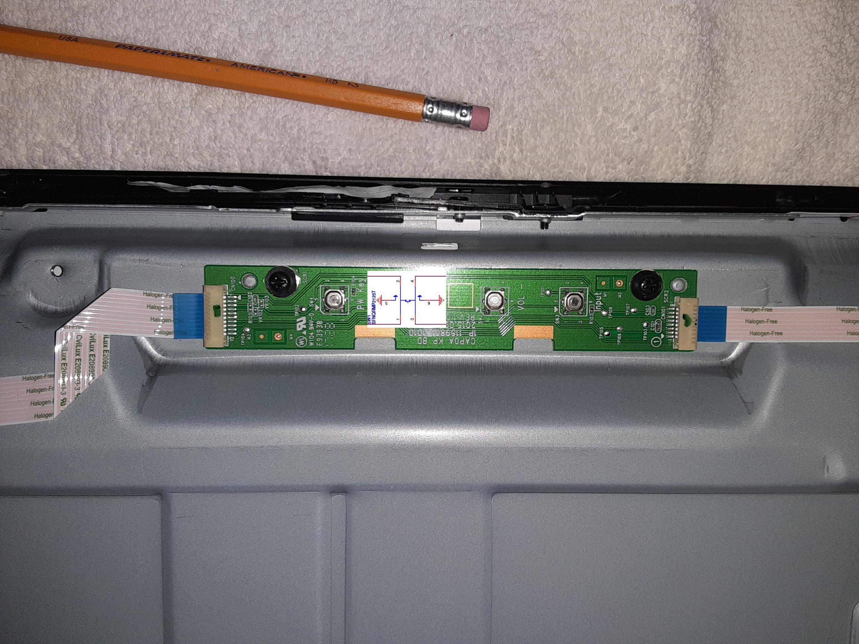

    I noticed the Power On button on the back of the TV was mashed down by the back cover, now one side of the button has broken off, It's just a piece of plastic that presses a metal button. All I could do was take that button off all-together and will use a pencil eraser if I ever need it.
    NOTE: MY TV has only 4 LED voltage contact points on the power supply board. There are 12 LED strips total, but they fit together to go across the entire TV, so it is like 6 long strips. The dead strips (X) were arranged on screen like this. (We were hoping to fix this)

    E70-E3 WON'T POWER UP

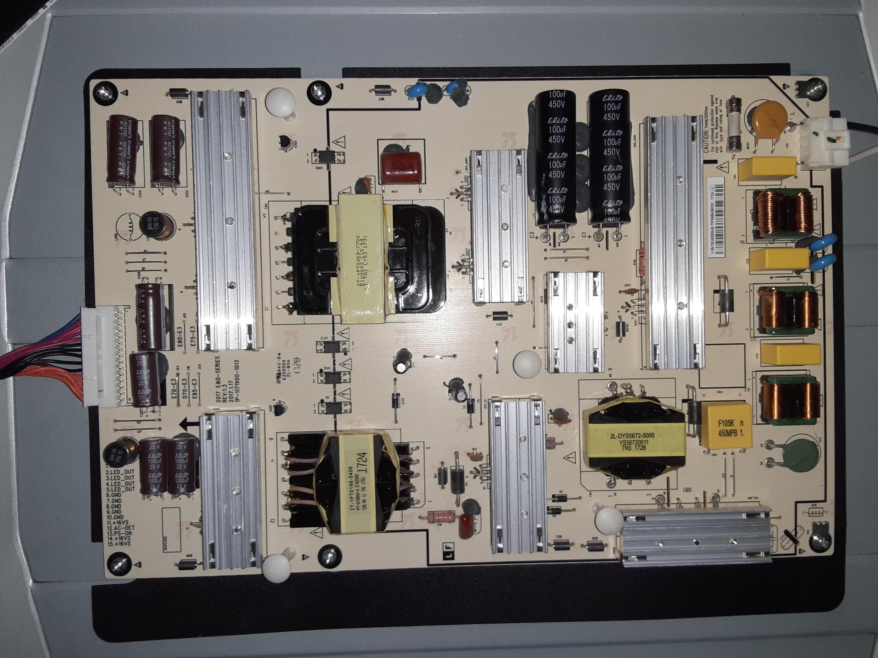

    I also have a Vizio E70-E3 and I have a similar issue to Bobby G but different voltage issues.
    On my Power Supply board, I have the correct standby voltage - 16V. But I have NO voltage going to the LED strips on this board and hence none on the mainboard. I tried disconnecting the main-board and remeasuring, but it made no difference in LED V.
    With power connected my PSB V. are
    LED OUT -- 00
    LED OUT -- 00
    LED OUT -- 00
    LED OUT -- 00
    gnd - 00
    gnd - 00
    gnd - 00
    gnd - 00
    +16VS = 16vs
    AC-DET = 3.94v
    PS-ON = -3.1 mv
    +16VS= 16v
    +16VS = 16v
    I do have 110 V on hot side.
    This is my power board: (plus my actual pictures are attached.

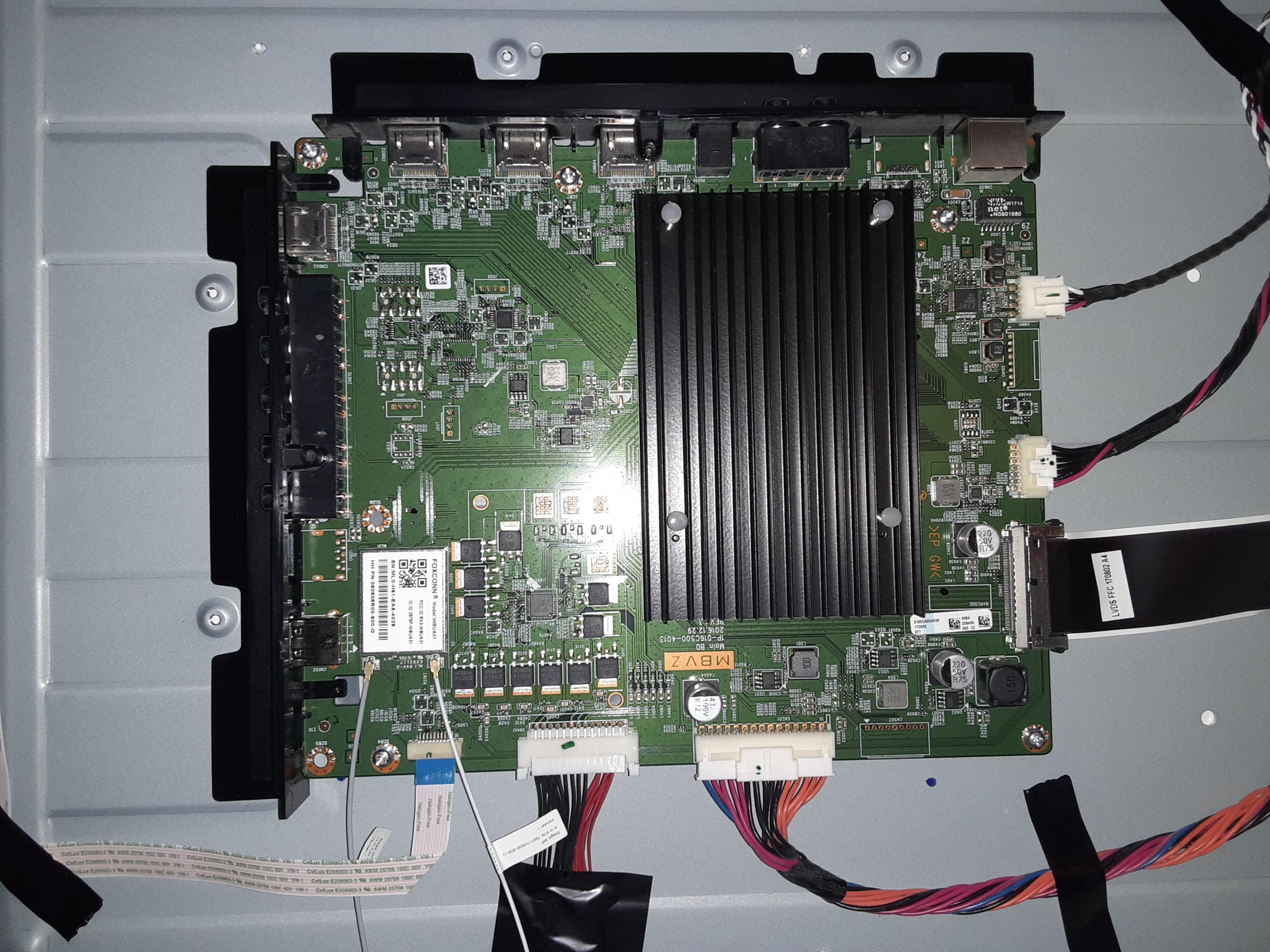

    Your fault is likely on the main board, you do not have the PS-ON voltage, this should likely be 3~5 volts. when the power button is pressed. If the power button is damaged (switch constantly pushed/shorted) it could be preventing the tv from turning on.

        But does the PS-ON voltage change? when the power button, or remote power button is pressed. The PS-ON could be 0 volts in standby, then 3 volts when the button is pressed. or could be 3v in standby and 0v when ON.

                  Well lets see, If you dont turn ON the power supply How do you expect it to have any other voltage than the standby voltage?
                  Disconnect the the power supply from the main board, Do you have a 3v battery around? if you do, connect the - to ground on the power supply and + to PS-ON and see if you get the LED_OUT voltage, If you don't have a battery try using about a 5k resistor between +16VS and PS-ON, this should also turn on the power supply.

                        The main board might be having a problem with bga contacts on the large ic under the heatsink, or it might be an eeprom issue with the main board.

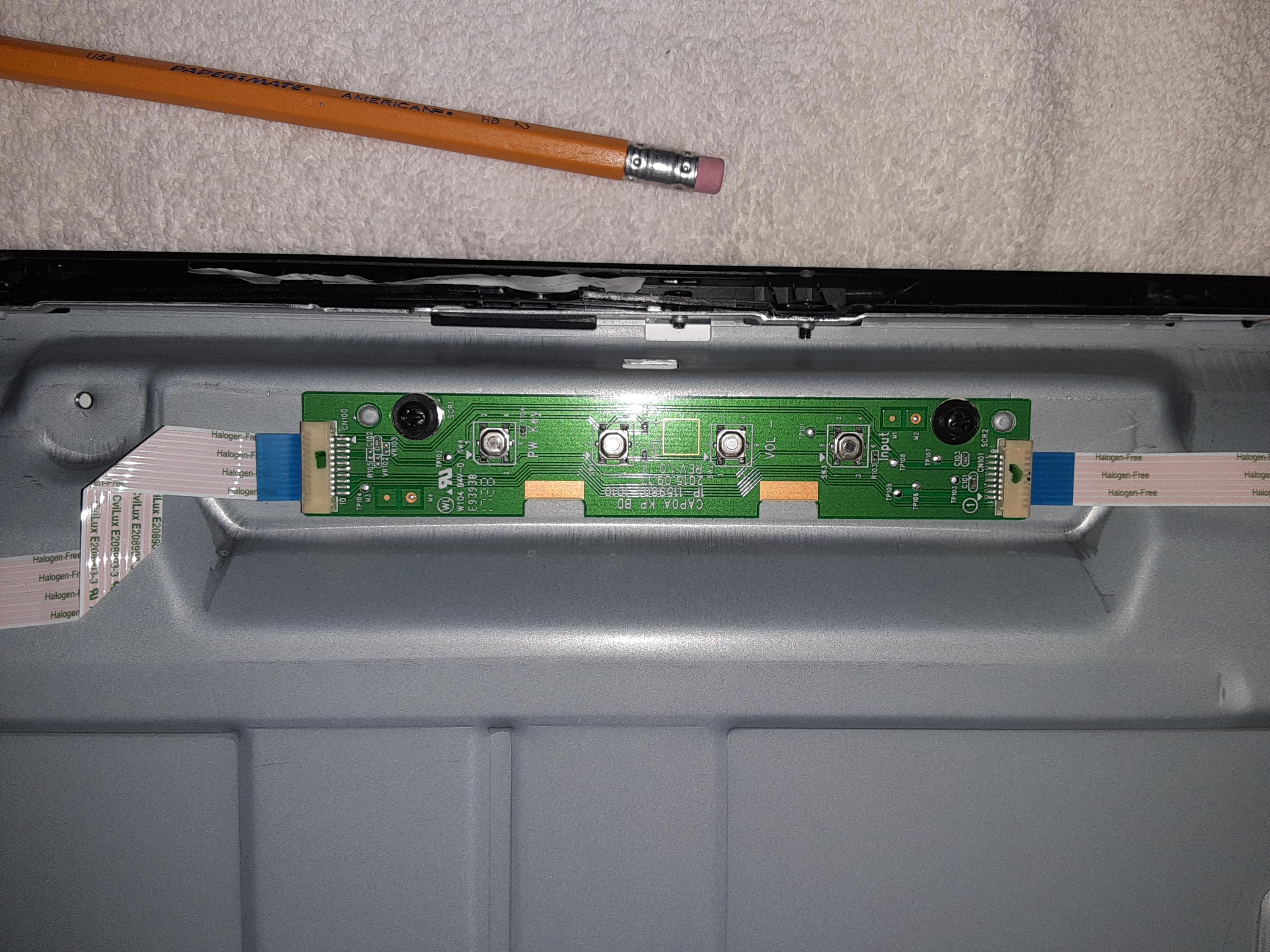

                          Anyway - I tried testing the button, and nothing seems to change when I push it. If I knew a place to check it on the mainboard I could try that. There doesn't seem to be a lot of info out there, though. A replacement is only $10.

                              The PS-ON line is Power Supply ON. This power supply produces 16 volts but in standby, it is at a reduced current (it only has enough current to run the microprocessor basically ) When the PS-ON line goes high, the PFC circuit turns on, the U1 ic also comes out of burst mode so the 16 volts can now supply more current (for audio/video etc.) and the PWM for the backlight voltage turns on.
                              On the switch, there are 4 pins plus 2 shield pins. Pins 1&2 should be connected together, pins 3&4 are connected together. when the button is pressed pins 1,2 connect to 3,4. Pins 3,4 have a 0Ω resistor to ground. So if you check the voltage on pin1or2, and press the button that voltage should go to 0 volts.

                                  The U1 is on the power supply (surface mounted), I refered to it only to explain what was happening on the power supply board. As for turning on the power supply, normally the standby voltage is +5 volts, so a 1k is safe, since this board uses 16 volts I suggested a 5k. The resistor is more for safety, incase you connect it to ground, you won't blow the standby supply, it is aslo to limit the current to the power supply control transistor.
                                  In this tv the 16 volts is sent to the main board where it will be regulated down for the various voltages like 3.3 volts etc.
                                  Some power supplies that Samsung uses, have pullup resistors, so simply removing the main board cable usually turns on the power supply.
                                  It could be that the power switch is damaged and that is why the tv is not turning on?

                                    The control buttons are hard to read consistently, I can get continuity tween 1-2 on the power button, but I can't get 3-4 to connect. That seems to work on the input button, though.

                                      You don't seem to understand. the resistor was used to limit the current for the SWITCH TRANSISTOR that controls the optocoupler that turns on the power supply. it has nothing to do with how much voltage the led circuit outputs. you could have likely used a 10k (or a 3 volt battery for that matter) to turn on the power supply.
                                      The setup is odd - the Power Supply board has four LED V feeds, but the mainboard has six (IIRC) sends and 12 grounds (for the LED strips).
                                      Turn the power supply board over and have a look at it. It supplies 57 volts between two points, GND and the LED_OUT. You can have 1 fat wire or 4 thin wires, it is just to get the 57 volts from the power supply to the main board.
                                      The led strips are all supplied +57 volts, then each of the strips have the negative side connected to a fet which controls the current to each strip. It looks like there are 12 control fets on this model, so I would guess there are 12 black wires from the panel. The first strip plug seems to have 3 connections, one + and two -. so I suspect each strip of 9 led's is controlled separately.
                                      ITS a SPST momentary switch, that's it. they use 4 contact points for better mounting

                                        OK, so if it momentary, I assume that means the only time I will see all four points as connected is when it is pressed down?
